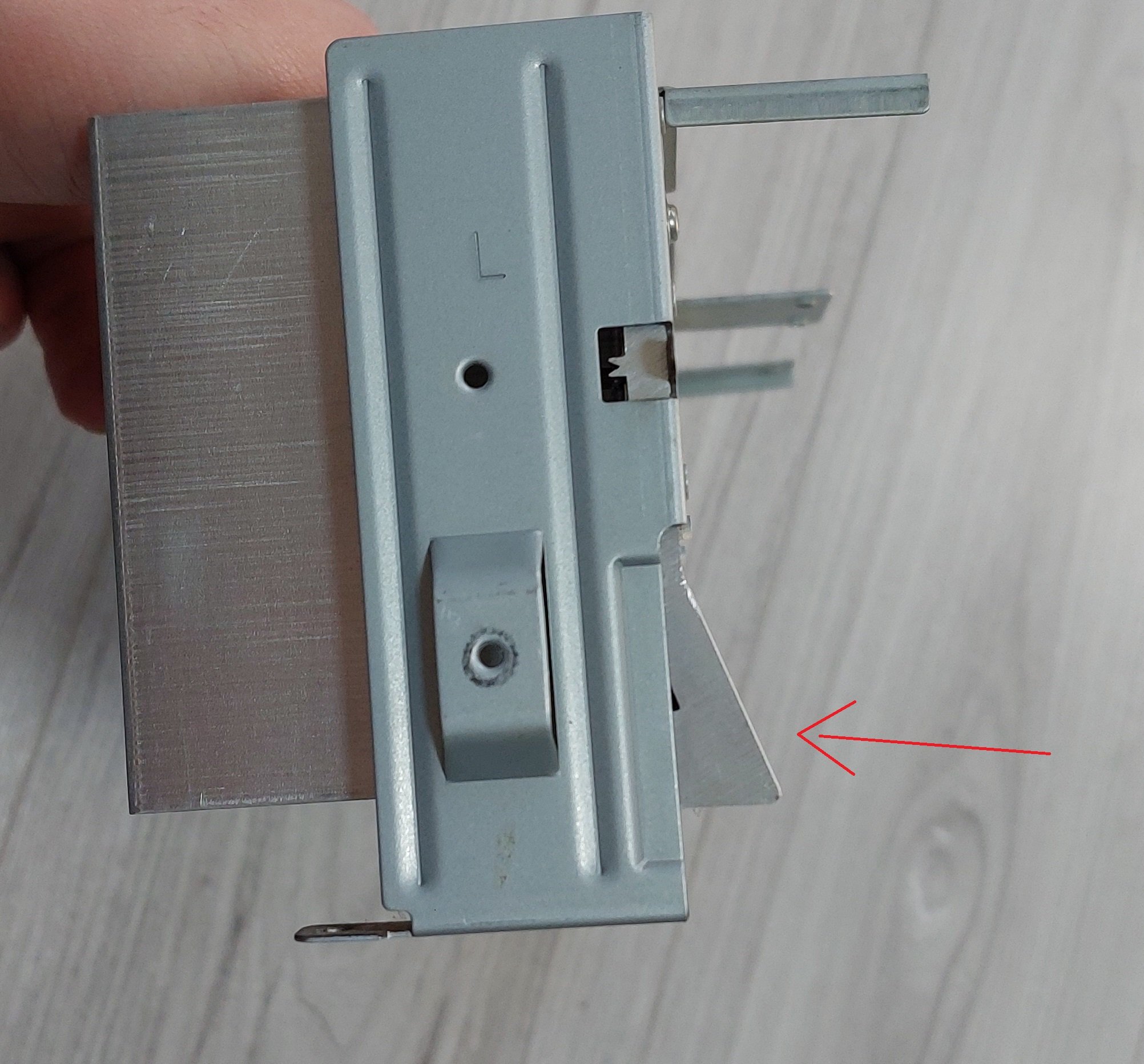

It's a bit tricky to mount he LM's without bending it's pins a bit, or mount the PCB a bit diagonally , because the base of the heatsink were the original Transistors were mounted isn't flat but at an angle. I could file it flat and sand paper it ( very fine grit up to 3000 ) .
Or I could mount them in the middle, where the heatsink is flat, the part on the bottom it's thicker tho.

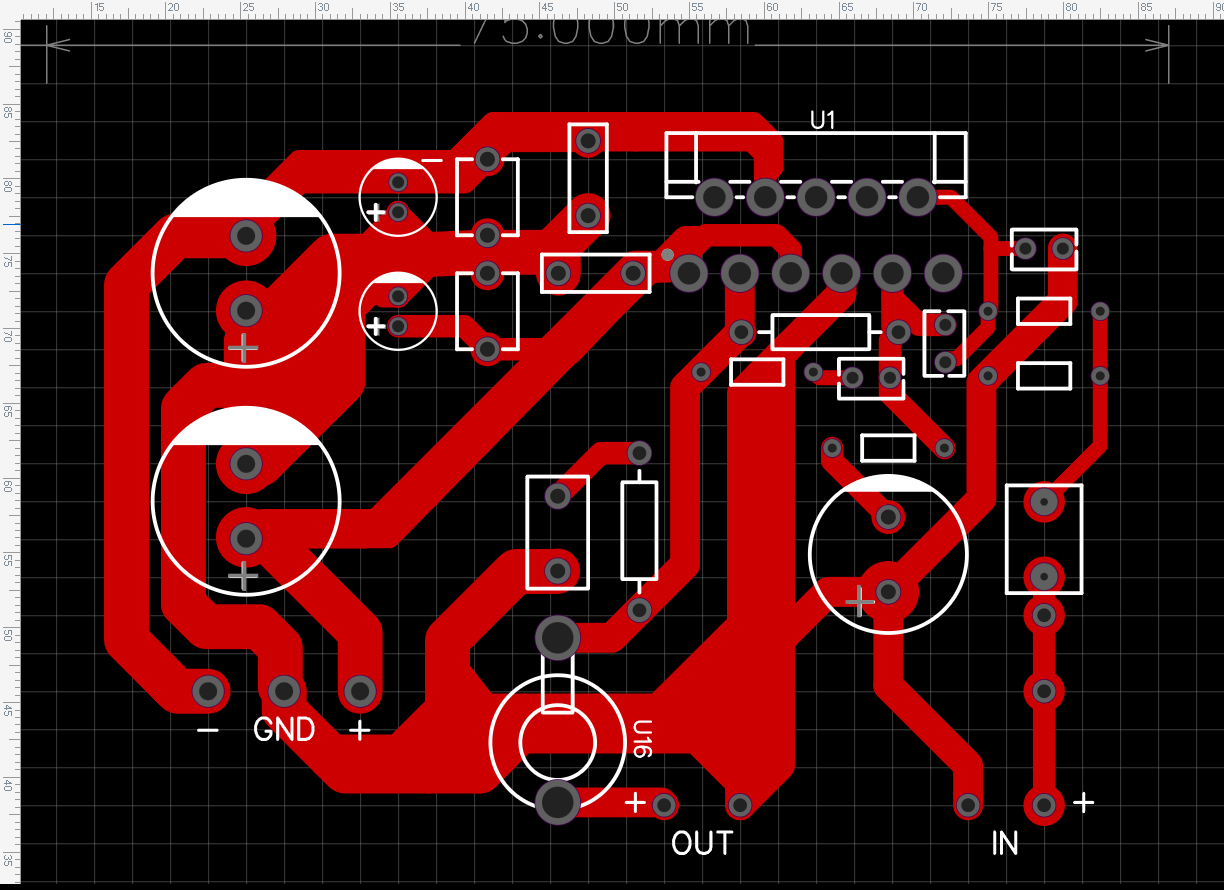

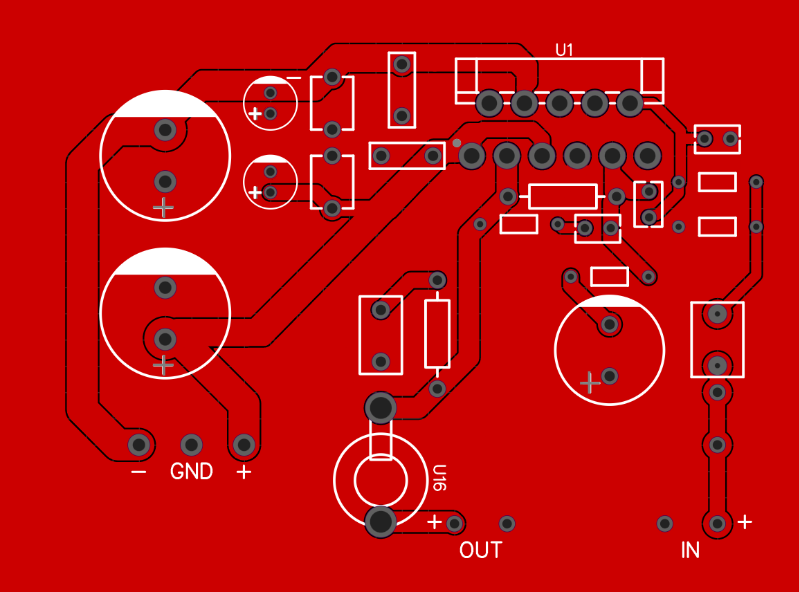

You don't work from a schematic? Creating layouts by drawing polygons in the layout tool without having a schematic (and netlist to connect schematic and layout) is a sketchy practice.
Tom
I did look both at the datasheet and schematic here, I just forgot about the mute circuit at that moment. Yes , I did not use a schematic in the pcb program , netlist, ratlines, etc. For rather simple PCB's like this, I place the component footprint , and go from there , arrange the components , by schematic.
A bad habit , maybe because I used to do the PCB's on 1x1mm paper with a pencil ( old times ).
Also the program that I use is rather limited ( EasyEDA) . I should " evolve" and do it proper , export the files and have the PCB's made by a company that ships them to your door. A nicer way would be photosensitive PCBs and have nicer results or again have them made by a company.
I still like to draw them with a paint marker , that method is outdated tho.
Yes the proper way I should learn to do is what you said.
I used to draw PCBs by hand as well. I then moved to a CAD system and was drawing PCBs from paper schematics. Working in the semiconductor industry where a wiring mistake can cost $1M to fix and delay the project by months (-> $$) changed me permanently. I won't use any tools that don't allow for DRC and LVS (layout versus schematic) checks.
Modern tools like KiCAD are free and good. They support a production workflow and it requires no effort to follow that workflow.
I too used to etch my own boards. I actually had a pretty nice setup with photo-resistive boards, UV lamp for exposure, etc. when I was in college. But these days I let outfits like OSH Park, PCBWay, or the like make my prototype boards. My production boards are made in Canada. I don't miss the mess, the ruined clothes, or having to dispose of nasty chemicals. Having the pros make the boards also makes it possible to use parts with finer pin pitch.
That said, there is some satisfaction in the ability to turn a board in a few hours in the garage.
Tom

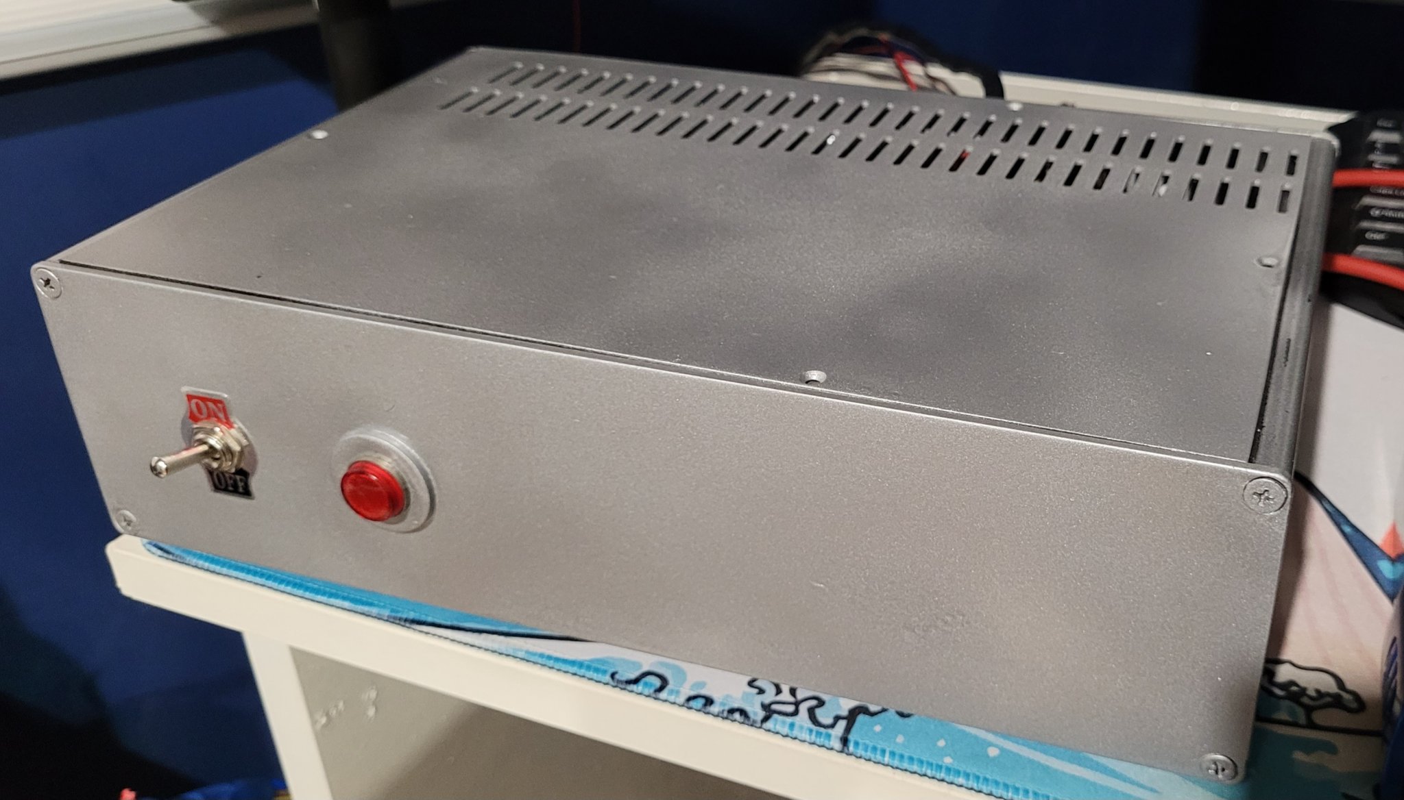

Cry? Pray? Drink more? Or ... I dunno? ... add 470 pF to ground after the ferrite bead? 🙂
Switch sparks emit pretty wide-band RF. You need to prevent that from entering the amp. The way to do that is by a) avoiding large antennas and b) filtering.
Large antennas can be avoided to some extent by putting the amp in a metal enclosure and connecting to it with shielded cables. If you still have the amp as a prototype on a piece of plywood, I wouldn't worry overly about RFI. If you still have issues after putting into a chassis, there might be some action needed.
I was told by a commercial manufacturer that they had to resort to LC filtering on amp inputs to pass the EMC requirements for some of the European standards. That's what I do on my amps. The ones made with SMD components all have LC (or, rather, LRC) filtering. I use the R to tame the Q of the LC filter so it doesn't cause peaking in the frequency response.
I usually aim for >40 dB attenuation at 8-10 MHz. I think I got that from a note on Siegfried Linkwitz's schematics for the LXmini amp/XO. He used three RCs, but I found that too noisy, so I switched to LRC instead.
Tom
Tom, I tried your suggestions and put 470pf in front of the ferrite but there was no improvement. I ground my aluminum can and there was no improvement. It's caused by something, but what?
This is my GND design:
Do you have the amp in a closed enclosure or is the enclosure open? If it's open or if there are large non-conductive openings in the enclosure RF can get in that way. It can also get in through input and output cables.
Tom
  • Thank You
Reactions: FioreDİAlbicocche
Cool! Maybe if you tune it right you can get to talk to ghosts of past inhabitants of your house... 🙂
Well, that's odd. I'd start by making sure that you have proper decoupling on the LM3886. 1000 uF || 22 uF || 1 uF X7R on each rail. You already have the RFI filter on the input, so you should be good there. It still wouldn't hurt to add some ferrite clamps on the cables right where they enter the enclosure. Or wind the input wiring and output wiring on a ferrite core of some sort.
The only time I've ever had RF enter an LM3886 amp that I made was when I was playing around with a point-to-point setup. All my other builds have been resistant to RF.
Tom
