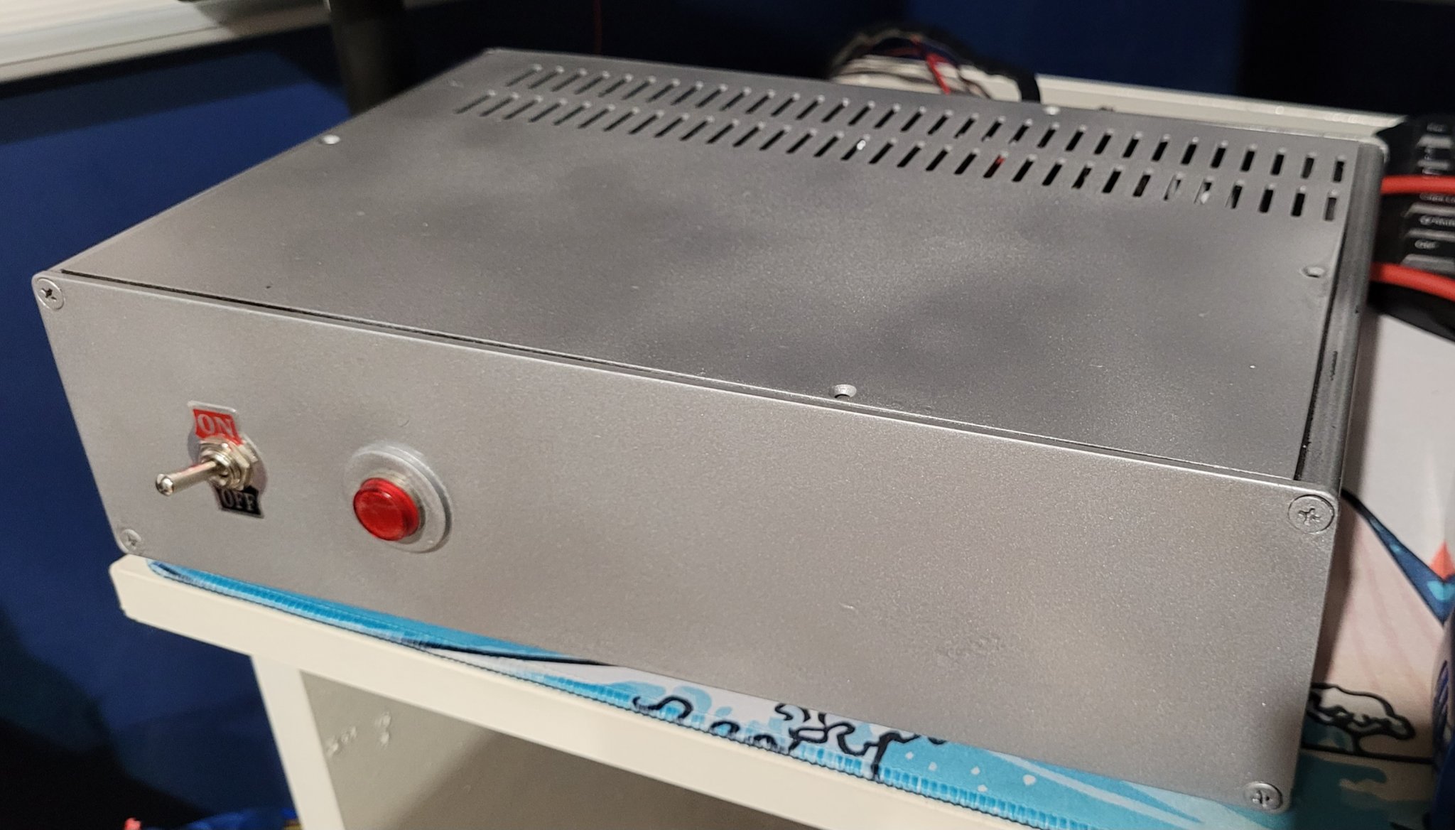

The problem persists on my tom protected box. It's even slightly affected by the planes passing over my house. 😀

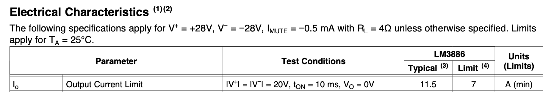

The LM3886 is guaranteed to be able to deliver 7 A of output current.

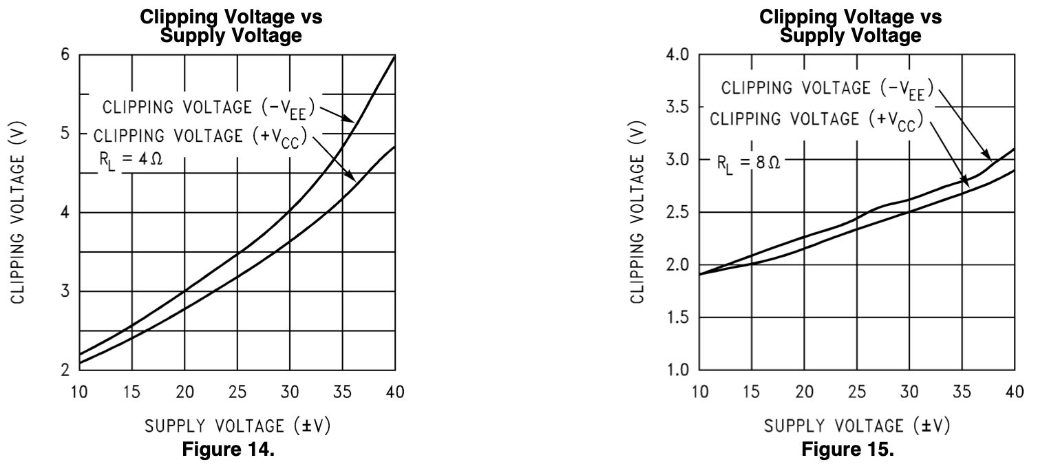

According to its data sheet, the LM3886 can swing to within 4 V of the power supply rail with a 4 Ω load and within about 2.6 V with 8 Ω load. The 1.4 V difference in output swing explains some of why the LM3886 delivers less than twice the output power into 4 Ω as it does into 8 Ω. The difference is caused by the open loop output impedance of the LM3886 and any current-dependent nonlinearities in the output devices. No surprises there.
What this means is that an LM3886-based amp running on ±30 V will be able to provide 26.0 V (peak) output swing into 4 Ω and 27.4 V (peak) output swing into 8 Ω. That's 85 W and 47 W, respectively, so pretty close to the 65-70 W, 40-45 W obtained in reality. Note, however, that the clipping voltages in the data sheet assume DC operation, whereas the power figures are for operation with THD+N below 0.1 %.

I added 22uf and 100uf and changed the coupling capacitor C1 from 22uf to 4.7uf. The problem still persists.Also, what is the value of that Cin? 1-2 uf should be enough.
Is there any chance that the large area of the heatsink at negative potrential creating any interferance to the circuit?. If you soldered the LM3886T to the heat sink, you would get a better thermal connection for sur
Do the lights in your house also flicker when your domestic heavy load appliances turns ON? I had similar issues , little tightening of terminal screws in the AC mains fuse box sorted this outI added 22uf and 100uf and changed the coupling capacitor C1 from 22uf to 4.7uf. The problem still persists
Have you observed any differences by shorting the RCA inputs or supply voltage drop across the LM3886 or the power LED blinking?

The heat sink should be grounded to the chassis. I have occasionally seen that pop up in THD measurements, but it's not been a very repeatable effect.Is there any chance that the large area of the heatsink at negative potrential creating any interferance to the circuit?
If heavy loads switching on/off causes RF interference the cause is more likely to be arcing of the switch. If there's arcing in the fuse box you have different issues. Been there. Done that. 🙂 Some douche forgot to tighten the neutral connection to one of the circuits in my house. Worked great with LED lights but not very well when I plugged in a 1 kW heat gun.Do the lights in your house also flicker when your domestic heavy load appliances turns ON? I had similar issues , little tightening of terminal screws in the AC mains fuse box sorted this out

Won't that make the whole metal chasis negative? LM3886T's bare metal tab without the mica washers -> heatsink -> grounded to chassisThe heat sink should be grounded to the chassis.
Or am I getting something wrong?
I never connect bare metal tab to heatsink. Always use insulator.
Unless you're making a "double insulated" amplifier you should connect chassis, any part of it, to safety ground. So you need to use an insulator between the metal tab and the heatsink. Of just use a TF package.Won't that make the whole metal chasis negative? LM3886T's bare metal tab without the mica washers -> heatsink -> grounded to chassis
I was under impression that T package heat dissipation would be better without those insulators, else I see no benifit in metal package
