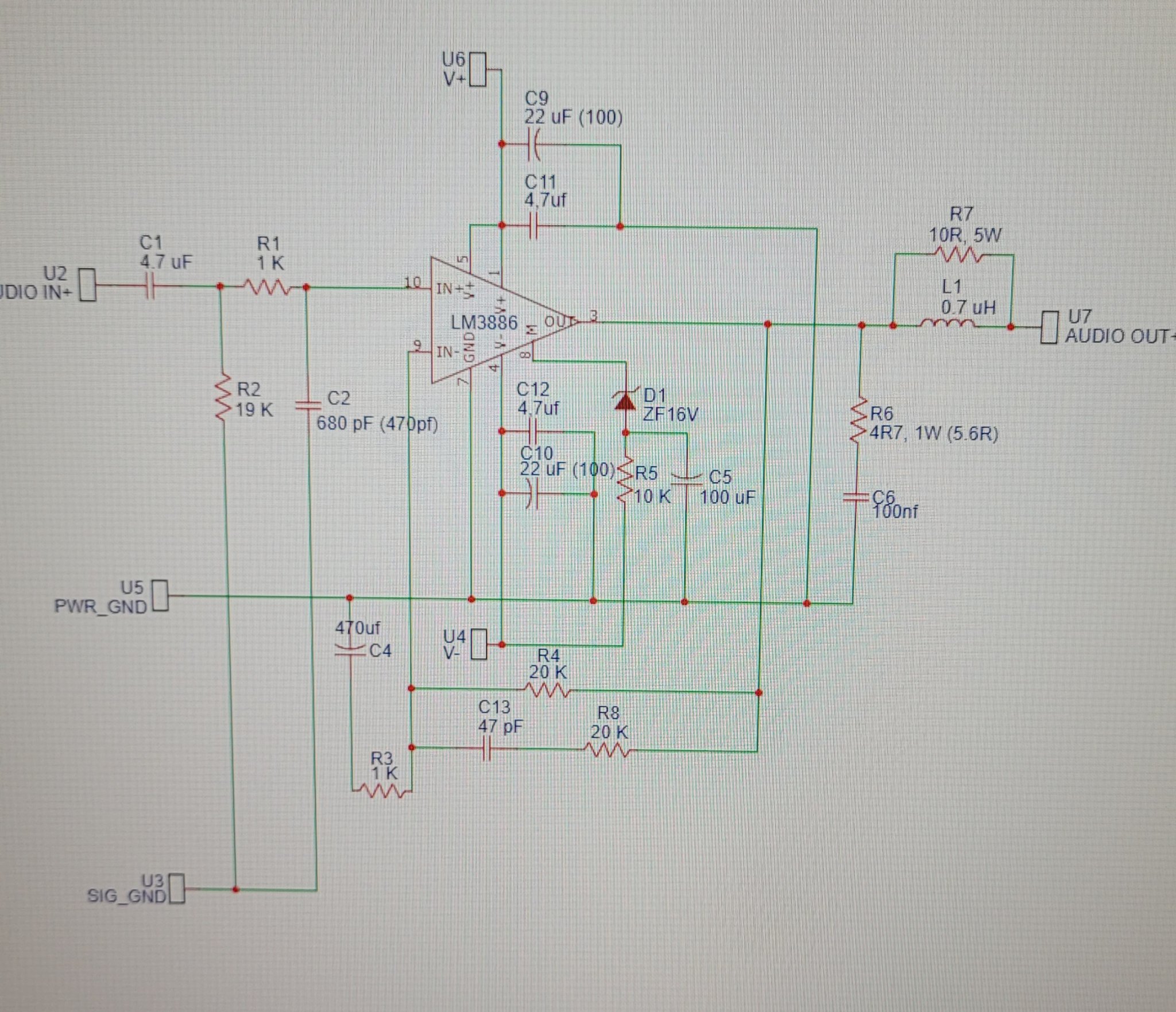

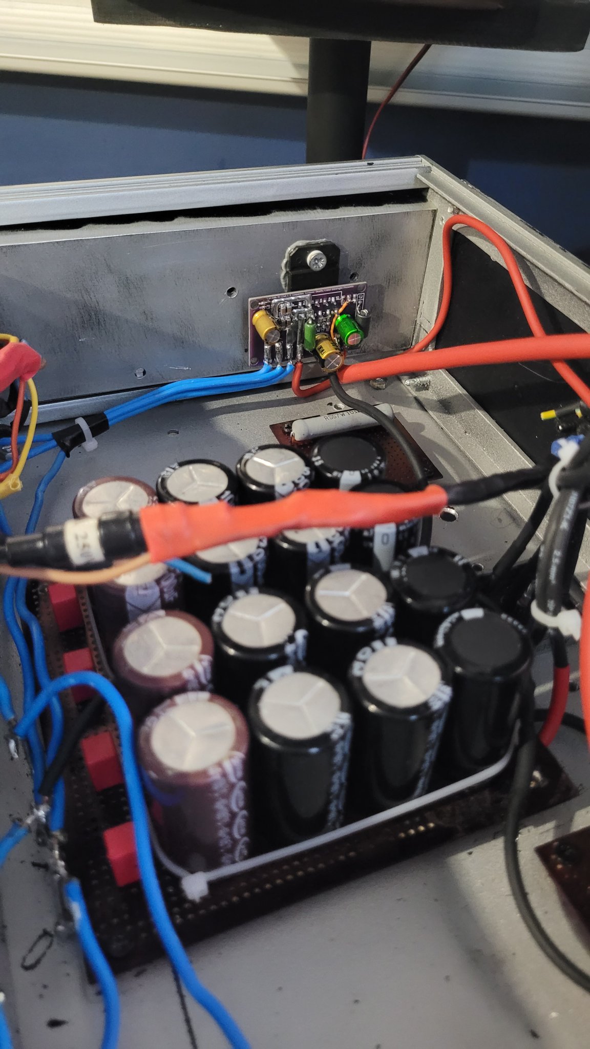

Where in the schematic is that inductor from your picture?
Power ground and signal ground should connect somehow.
"Signal GND and Power GND are combined in capacitors. Some funny scheme."
I don't understand that.
Cry? Pray? Drink more? Or ... I dunno? ... add 470 pF to ground after the ferrite bead? 🙂I used the same filter but not the 470pf. What do you think I should do?
Switch sparks emit pretty wide-band RF. You need to prevent that from entering the amp. The way to do that is by a) avoiding large antennas and b) filtering.
Large antennas can be avoided to some extent by putting the amp in a metal enclosure and connecting to it with shielded cables. If you still have the amp as a prototype on a piece of plywood, I wouldn't worry overly about RFI. If you still have issues after putting into a chassis, there might be some action needed.
I was told by a commercial manufacturer that they had to resort to LC filtering on amp inputs to pass the EMC requirements for some of the European standards. That's what I do on my amps. The ones made with SMD components all have LC (or, rather, LRC) filtering. I use the R to tame the Q of the LC filter so it doesn't cause peaking in the frequency response.
I usually aim for >40 dB attenuation at 8-10 MHz. I think I got that from a note on Siegfried Linkwitz's schematics for the LXmini amp/XO. He used three RCs, but I found that too noisy, so I switched to LRC instead.
Tom
Yeah. It should be in series with either C1 or R1. Sounds like that's how you have it.The inductor is connected in series to the audio signal 😀
You'd get better performance (lower THD) if you connected SIG_GND to the Speaker(-) output (which is also connected to ground).Signal GND and Power GND are combined in capacitors.
The wire connecting SIG_GND is an antenna, by the way.
Is the LM3886 board exactly as shown in the schematic? If so, you need to add at least 470 uF on each supply rail. I prefer 1000 uF.
Tom

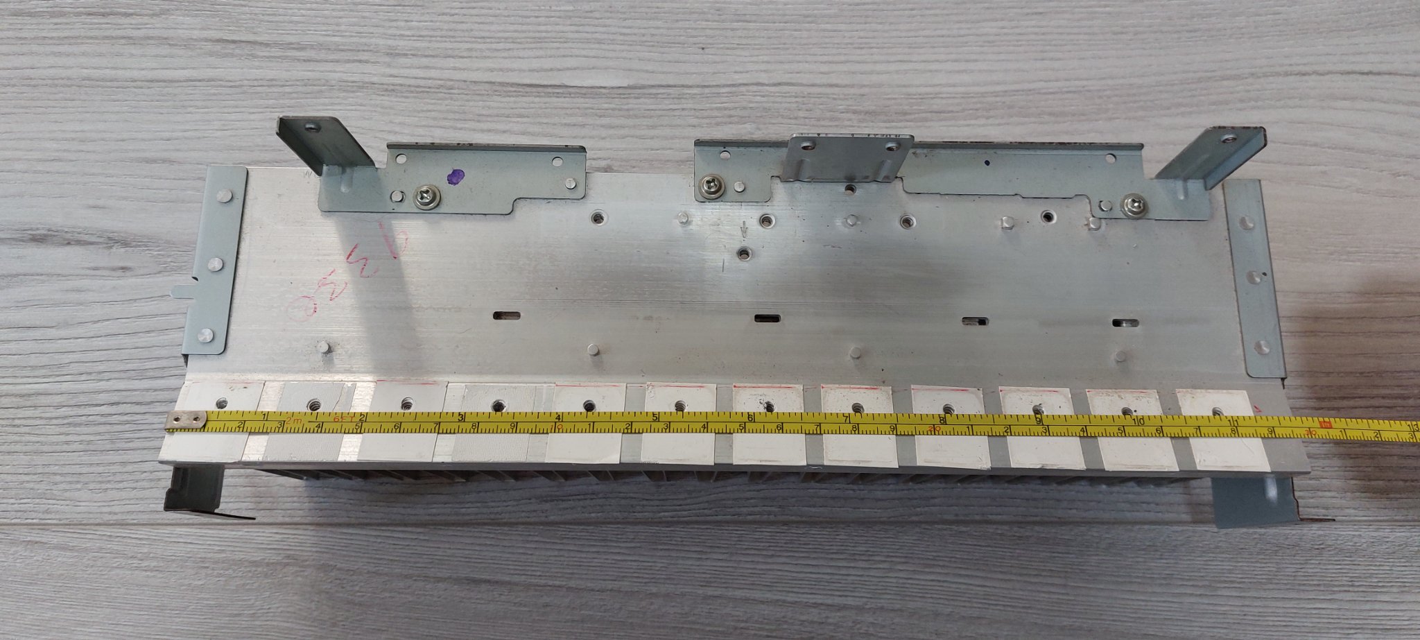

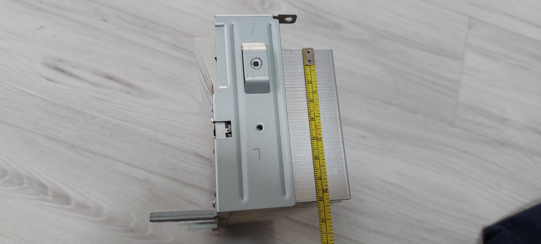

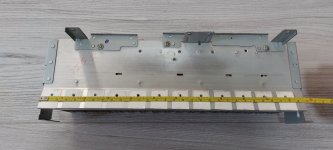

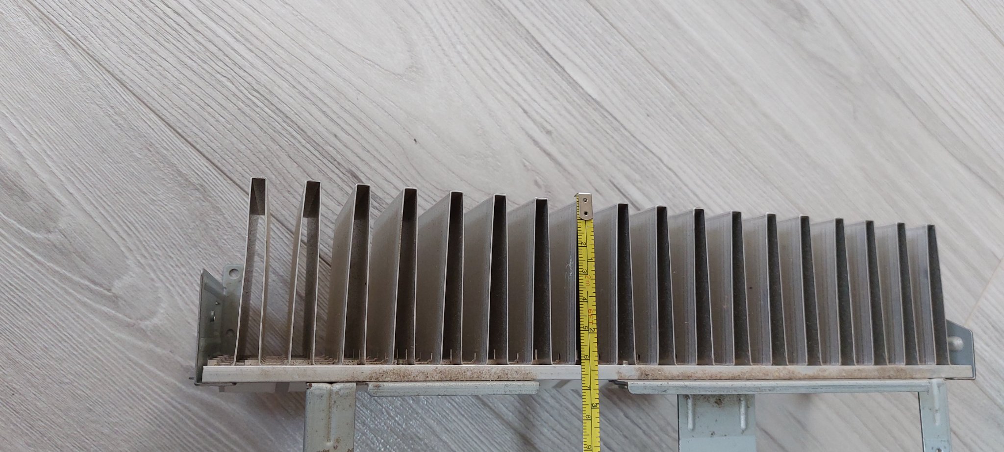

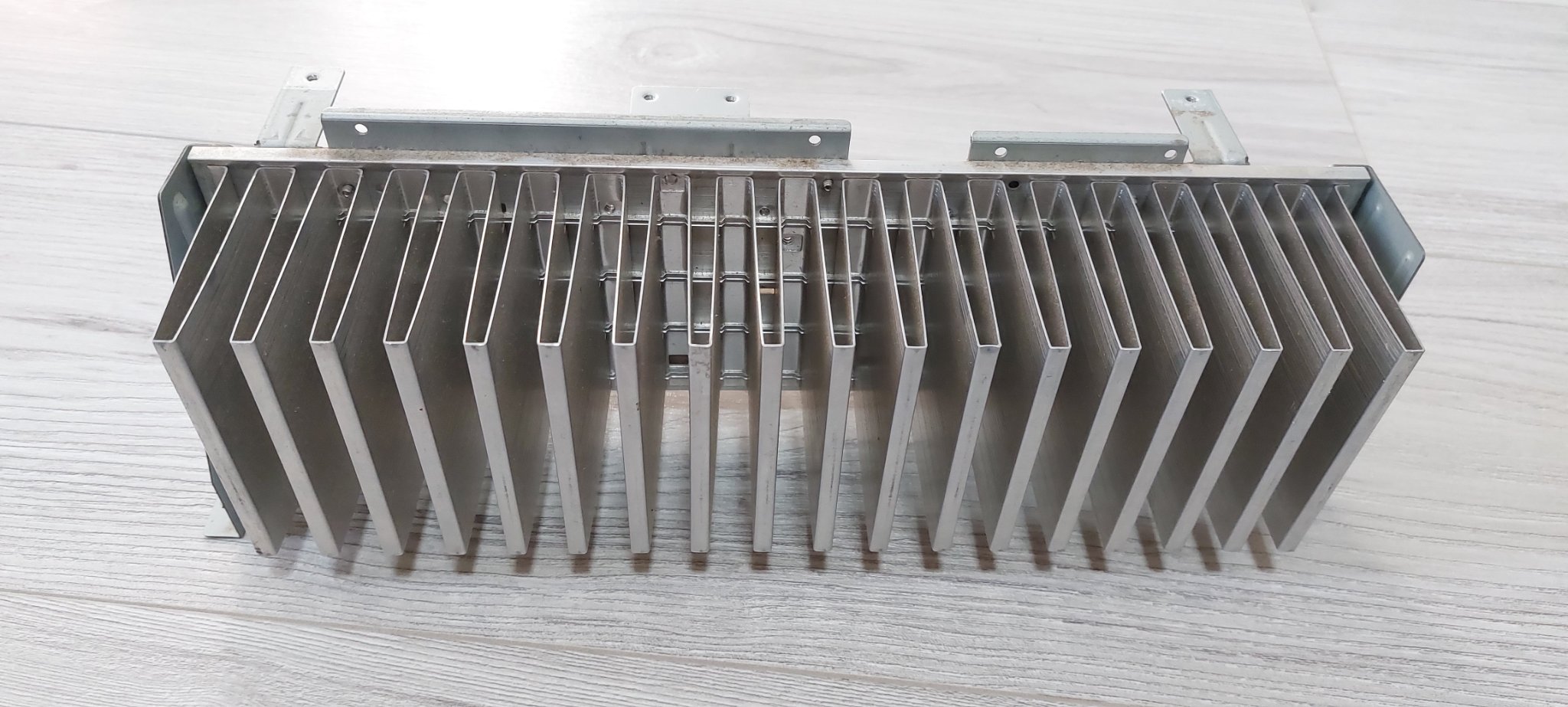

Would this heatsink be enough for two LM's ? . ( thinking about 24 or 28 Vdc Rails . ) I dont really like this design ( not made from one piece , having the " fins " soldered to the aluminium sheet. ) Anyway. this is what I have at hand , if not good enough I'll buy something better.
