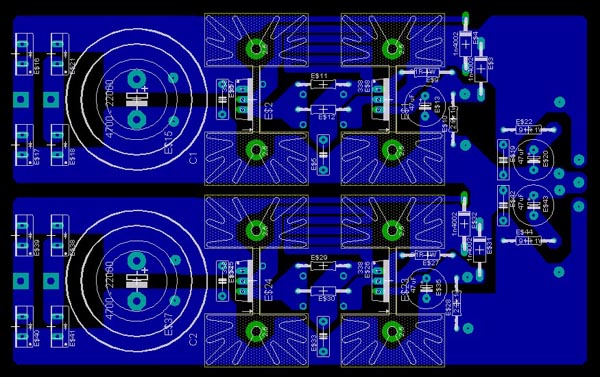

I "snubberized" this regulator board i made before.
it has a (optional) tracking preregulator but that would be more for when it was used with less powerful regulators for a preamp supply.
maybe ill make a short version that follows the snubberized supply exactly. the board is one sided and has no bypasses.
It was left over from a board that has 3 regulators on it working in parrallel for 15 amp output . you need a very small value "ballast" resistor to even the outputs of the regulators (much like the way parrallel amps have a resistor)
anyways i left part of it in on this board because i want to see if there is any difference with the sense resistor for the preregulator before or after that. if it has an adverse effect just being there it can be shorted out with a heavier wire
the 15 amp regulator was going to be for a BPA200 type amp but the last carlosfm (big cap) PSU convinced me i did not need one (3886 is fine!)
Nice boards!
Nice boards idefixes !
How are they coming along? I read that they were going to be checked out for errors. I'd be happy to help if it is still needed.
Or if they are good could you e-mail me a copy?
Mark
Mark
Re: Nice boards!
They need to be checkked and correct. I will reroot them under eagle. When they are Ok i will share them
Marc

Thanks for the reply Marc
I'll look forward to your posting. I'm not a PCB pro either but I do have Eagle pro. If it will help you I could take a look to. An extra set of eyes never hurts!
MArk

Dear neutron 7 and all,
Would you please post the schemtic !
Thomas
