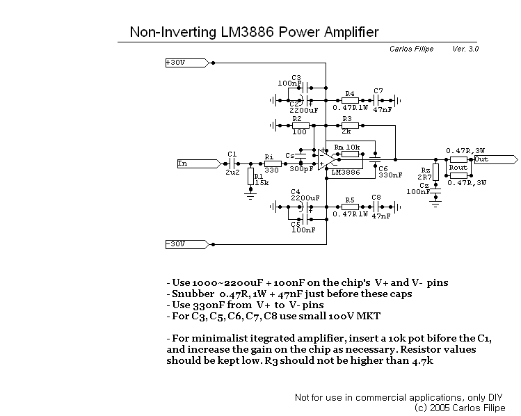

What do you think of an LM3886 with an 35V transformer ?
This will give (35x1.41) almost 50V

Well, after two weeks I can say that I like snubber more then plain LM338 regulated PSU.
Stage depth, details and bass are really improved. But there are some sounds, like a punch at the bongo's which are slightly different from LM338 in a bad way. They are not as much loud as they were with regulator and timbre is different. Whenever I do something with m GC's I try to listen to some of my reference materials which I know to the bone.
I made my snubber exactly as Carlos recomended, just haven't bypassed elco's at the chip (0.1u). Haven't had any left in a drawer. Will do this weekend. Hopefully. I haven't used MUR860. Instead I put MUR420.
Overall: A little of magic in highs that dissapeared after i put LM338 regs has been brought back with snubber. But I do have a feeling that sound is somehow compressed. I don't know how to express myself in another way.
It is important to say that with LM338 I've had exactly +/-24V (transformer is 2x21V), while with snubber I have +/-29V and we all know that sound of this chips changes with voltage too. So I can not speak about the same conditions anymore.

I will go in vacations in July.
Meanwhile, lots of work for you.😀
Try the LM338 PSU again, it's quick and easy to put the snubbers on the output of the regs.
And don't forget to use 1,000~2,200uf+100nf caps on the chips, snubberized with 0.47R+47nf.

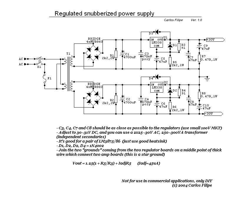

I have started my work in the regulated PSU 😀
(because I was forced to do it.....)
My chip can only handle an 31.5V transformer! 😛
My new toroid is 35V-340VA. I will have to regulate for 30V
I hope to finish this in the next few days 😉 for now, I am enjoying unregulated snubberized PSU.
If I could understand, before the caps near the chip I must use an 0.47R+47nf snubber.
Carlos, after the rectifier what values should I use, the same you advised?

XELB said:Carlos, after the rectifier what values should I use, the same you advised?
Just follow the schematic on this thread, no need to snubberize before the regs.
I Just asked because I will use this PSU for a different chip(that can only handle 45+/- V)
This PSU is regulated for how much output voltage ?
Lets see if I am correct:
I have an 340VA - 35V transformer, this will give aprox. 4,86 Amper in each rectifier... they will get hot
What should I buy, LM338T or LM338K STEEL ?
XELB said:This PSU is regulated for how much output voltage ?![]()
It's on the schematic, isn't it?
XELB said:I have an 340VA - 35V transformer, this will give aprox. 4,86 Amper in each rectifier... they will get hot![]()

I think you mean 340VA - 2x35V, right?
The rectifiers have no problems with that.

carlosfm said:
What a confusion...
I think XLEB was asking about max current handling, not max voltage handling. Yes the LM388T could handle 35VAC * 1.41 = ~50VDC.
But the question is, could it handle all the current that that the trafo is capable of sending its way?
35 x 2 secondaries means: 340VA/(2*35) = ~4.85 A (same result that XLEB got)
LM388T can handle continuous up to 5A and peak at 7A. So this means you will reach your trafo's max before you reach the LM338T's limit. As for heat, i have no idea.
