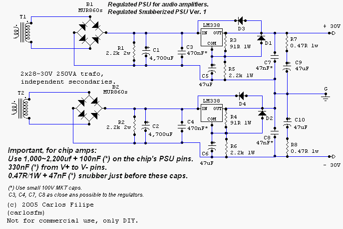

carlos, why dont you try a tracking pre-regulator version . It is a cheap way to get quite improved noise performance. since the pre regulator is referenced to the output of the main regulator. the main regulators input also benefits from the regulation of its output,. (and who knows maybe the snubberization as well 🙂 ) and the error amplifiers in those things need as much help as they can get, they are about the quality of a 741!
i hope that makes some kind of sense.
you need to have a bit more of a voltage drop though.
you just need another 338, a cap and 2 resistors per rail.
its on page 12 of here
http://www.national.com/ds/LM/LM138.pdf

Try some LT1083s which have better HF impedance characteristics than the LM338 which are not as high performance. The snubber values will need to change I imagine. The LT1083 is unfortunately more expensive though.
Here's one example with no snubbers.
http://shine7.com/audio/gainclone.htm
The LM338 reg Ic is more expensive than the LM3875 power IC !

XELB said:Carlos, you have 8 Ohms speakers. Don't you ?
Mine are 6 Ohms, and normally I test the amp with 4/2 Ohms speakers(this ones have 5 drivers but 98dB sensitivity).
Do you think 10,000uF per rail will work fine with this speakers?
I think 10,000uf will do, even for 4 ohm speakers.
Btw my speakers are 8hms, but not easy to drive.
You can ask to anyone who knows, has or sells Epos ES11 speakers (discontinued, ES12 later, M12 now) if it's easy to find a commercial amp that really makes them sing.
There are some, but $$$$$$.
Alcaid said:Carlos
Secondary on T2 is shorted in the diagram.
No, it's not.
Go back to the first post again and check it out.
When I opened the thread and posted the schematic I saw that I had a reversed bridge (B2).
I corrected that and edited the post.
This was a question of minutes, maby you downloaded the first one.
The last think I want is to post a PSU that explodes in your faces.😱

Alcaid said:Carlos
Carlos, it's still shorted.
SvErD said:Carlos, it's still shorted.
You are right.
Who would spot that one?
Congratulations, you have just winned... an unshorted trafo.😎
PS: maby the moderators could replace the file on the first post?
Thanks.
