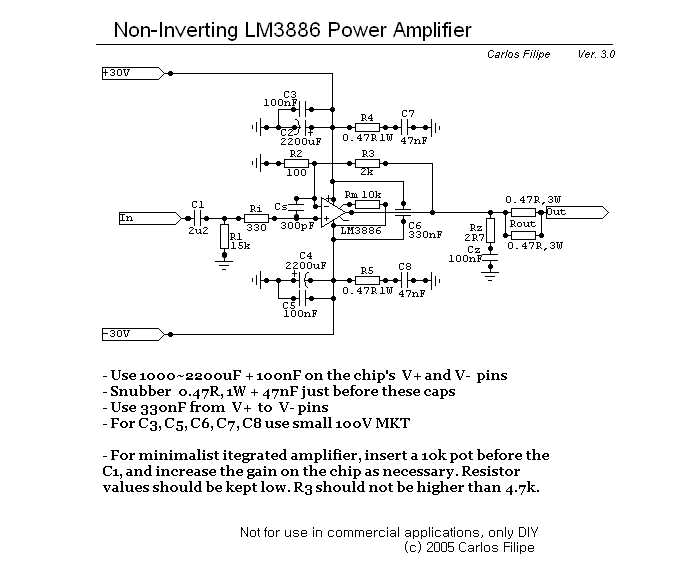

carlosfm said:Here it is.
Results are impressive, this elevates the chipamp to a league of it's own.😎
Notice that I recommend 1,000~2,200uf caps on the chips, snubberized.
I'm using 2,200uf.
Just curious what the cap you using on the ships are? Do it still need those good quality cap (e.g. FC, BG, Nichicon, low impedence XXX brand) on chips ... or just NORMAL xxx-brand cap with snubber are fine?
Re: Re: LM338 regulated snubberized PSU for audio amplifiers
I used Jamicon 2,200uf caps on the chips, on this amp.
On another amp I'm updating I'm using Philips caps.
"Normal" caps are fine, as long as you don't use too "normal" ones from unknown or dubious brands.
The snubber makes it's role there.

Carlos, many thanks for this idea. It works really well a big
from me.
I had to change the caps at the chips to 2200µF (Pan FC) from 100µF then add the 330nF as recommended.
The amp has improved across the board, most noticeably in the HF then the midrange. The best ‘gainclone’ sound I have heard to-date, thankyou!
