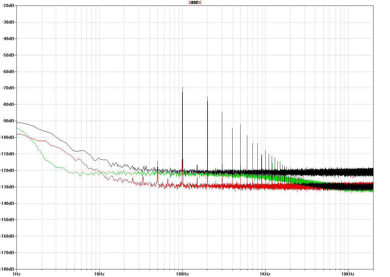

I just received the Sipex 431 from SGK and promptly did the measurements. The final diagrams have to wait till the evening, but here's a teaser (or spoiler 😉) for you:
#302 from the previous run in black
#302 with the Sipex in red
#400 in green
Nice, just as expected, a lot better than the standard TL431. 😀

That's it, the graphics are online. For your convenience again:
click here
Yeah, the SPX is actually a lot better than the ET, but not with Mark's circuit (#320). There's some strange low-frequency rumble there which doesn't look nice in the time domain; step response is also impaired.
Now that was quite a bit of work, more than I had imagined. Gotta find a bulky 10 to 15 ohm resistor for pergo's load test now... 😉
I'm planning to test a 7815 for comparison, too, and if I'm really bored over the next weeks I might even examine the benefits of a capacitance multiplier downstream. Maybe even a noise shunt. Getting complicated now, circuit-wise 😉
