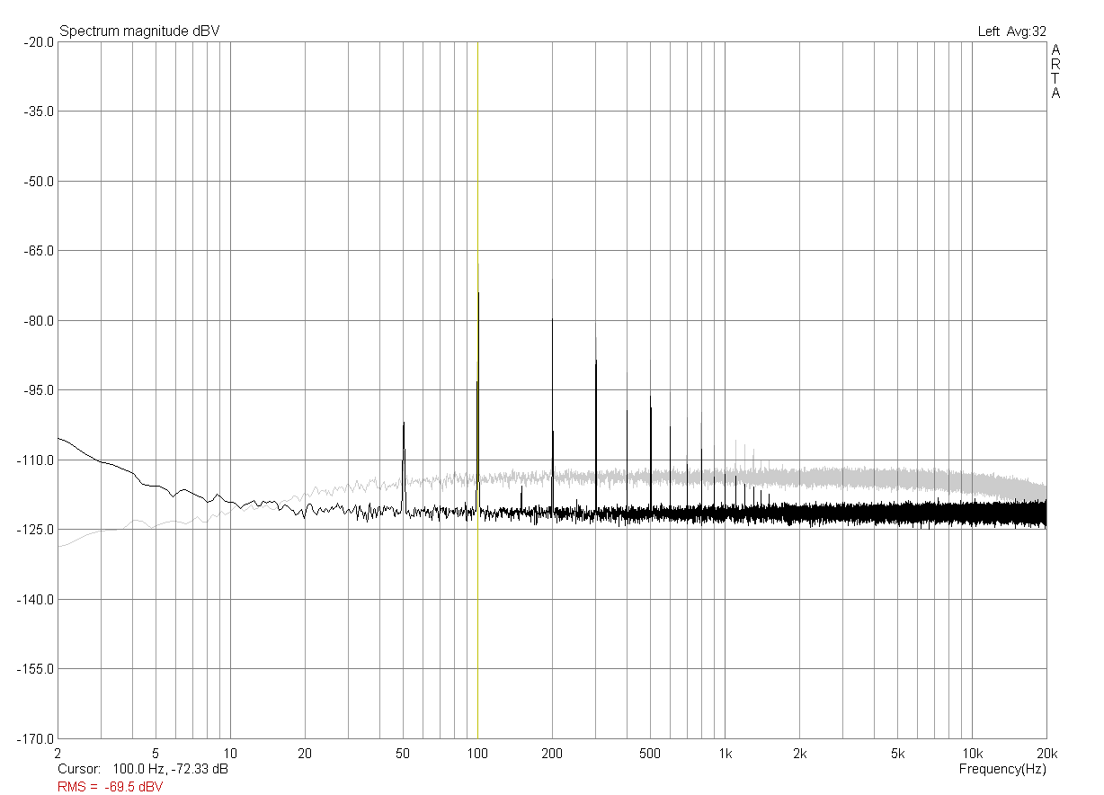

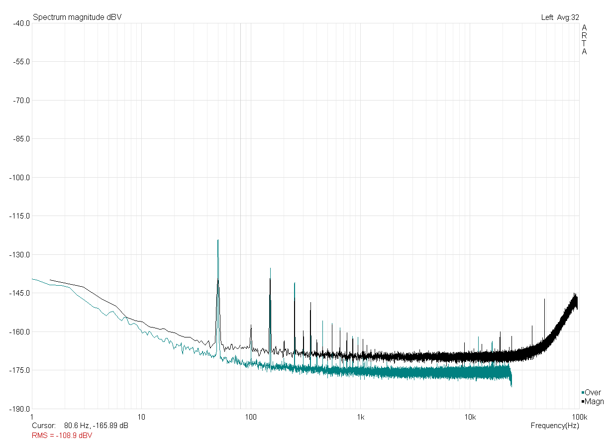

Now this thread really caught me 🙂. I simply had to hook up an LM and do some real-world measurements.
Please have a look at the results here: LM317 regulator under test

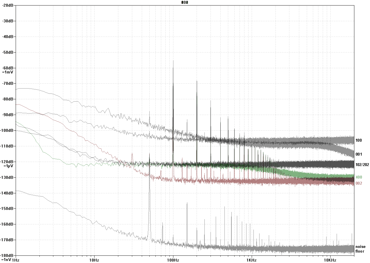

I've attached an overview of the tested circuits and the noise results here. To sum up, I'd say that "no TL431 is best", at least noise-wise. A simple Zener is at least as good, partially even better, while a simple cap outperforms both of them. Regarding the load step response, it is better to put a cap between TL431 cathode and TL431 ref instead of between LM317 out and TL431 ref.

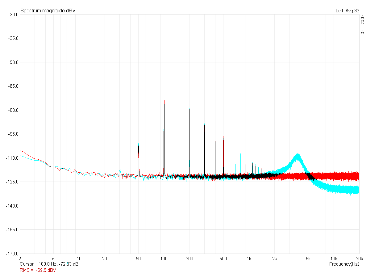

The traces in red are the ones (in the second diagram I posted here), but please have a look at LM317 regulator under test preamp.org, there you'll find more detailed information, like step response and actual recorded flac's for your personal enjoyment.

Don't get this resistor variant to work 😕. Added 100R for the first measurement you see here (the cyan trace). Looks weird so I measured the current: >13mA, like without the resistor. Hm. Substituted a 500R pot, >13mA at every position. Tried some 4K, still >13mA. Eventually gave up on it 🙄.

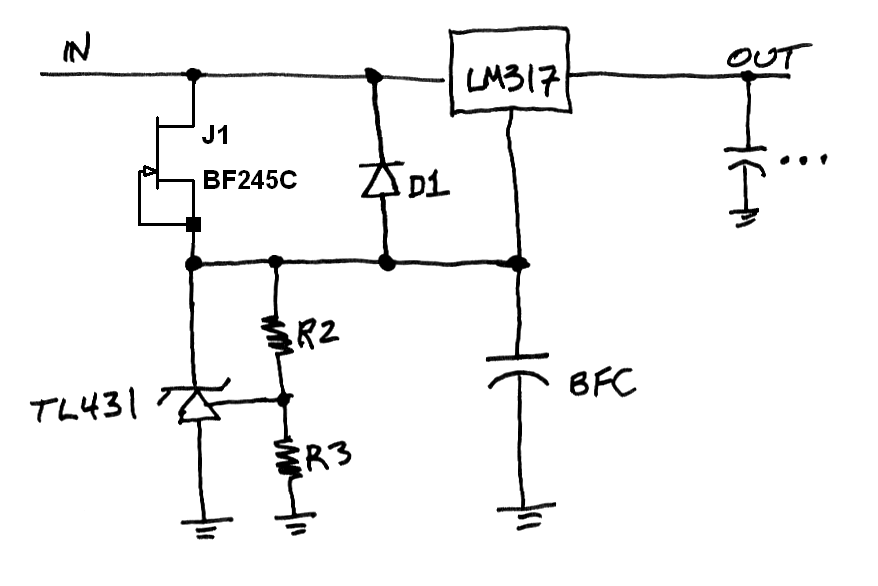

So if you need very, very high rejection of low frequency noise, you can replace the Zener with a shunt voltage reference IC. One example is the TL431. Post #58 of this thread, shows a schematic.
Mark, what about using my 13.??mA BF245C instead of the LM334 in the schematic you supplied? If this is almost as good, I'd happily try it.

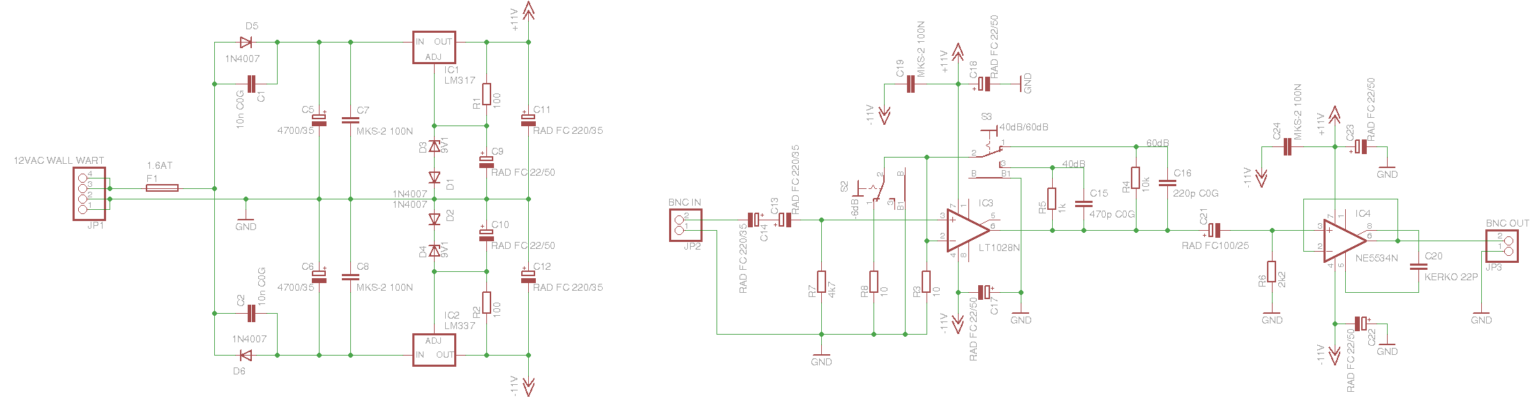

If anyone is interested in or likes to make some suggestions, here is the schematic of the preamp I'm currently using.

This is what i meant.
Sure, and I tried a 500R trimpot for R1, but it didn't change the current at all. The result above is for a 100R fixed resistor.
Yes you can use a BF245C NJFET, whose IDSS is 13 milliamperes, to bias the shunt voltage reference integrated circuit. Just be certain to bypass the IC with at least 33 microfarads. This ensures stability, filters noise, and lowers impedance at high frequencies.
B.F.C. is an acronym for Big Fadjective Capacitor; i.e., any capacitor whose optimal value is infinity. The bigger the better.
Remember that Vout = 1.25 + (2.5 x (1 + (R2/R3)))
See attached schematic diagram.

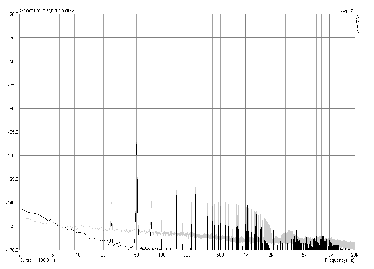

Here's a quick comparison of the noise floor using 48k vs. 196k sampling.

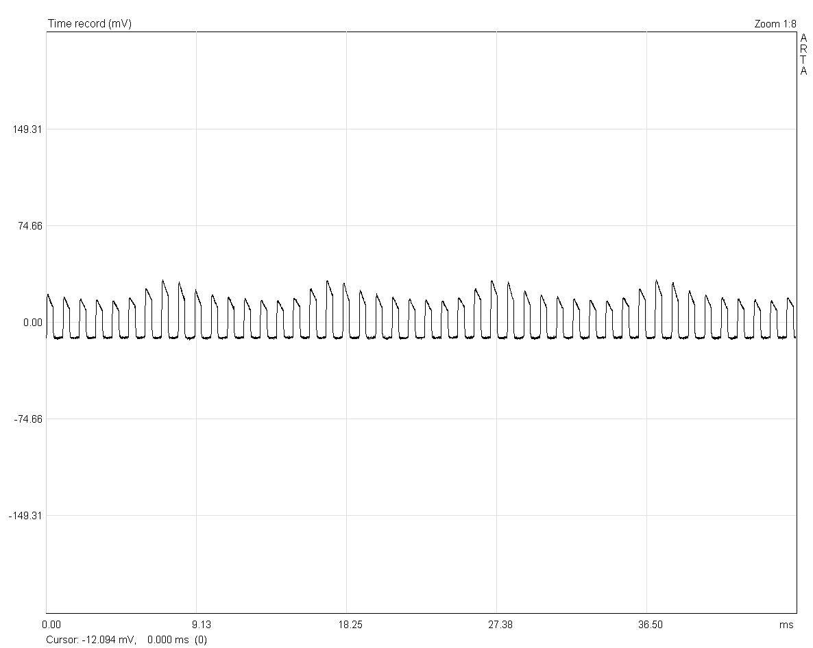

Seems like the LM317-approach is not working. I've made a quick test with several frequencies and the results mostly look rather bad. The sine gets badly distorted by the first 317 already and what's coming out of the DUT looks even worse. Attached is the result of 1kHz 1V-pp.

While doing most of the measurements again, I somehow managed to kill the TL431, so I couldn't redo pergo's version or test mark's at all 🙁. Will fix this tomorrow.

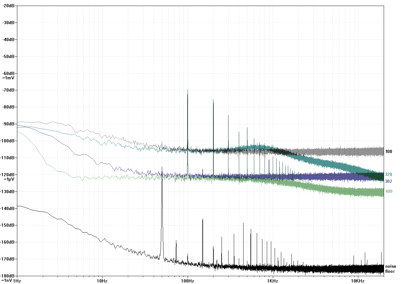

Anyhow, here's another crowded overview of the circuits I tested this evening. This time the scale in dBV should be accurate (I tested it beforehand). For better readability I create the graphs using LTspice from now on. This allows me to keep the same scale for every measurement each time. Added bonus is that I can supply you with the RAW-files for your personal delight 😉.

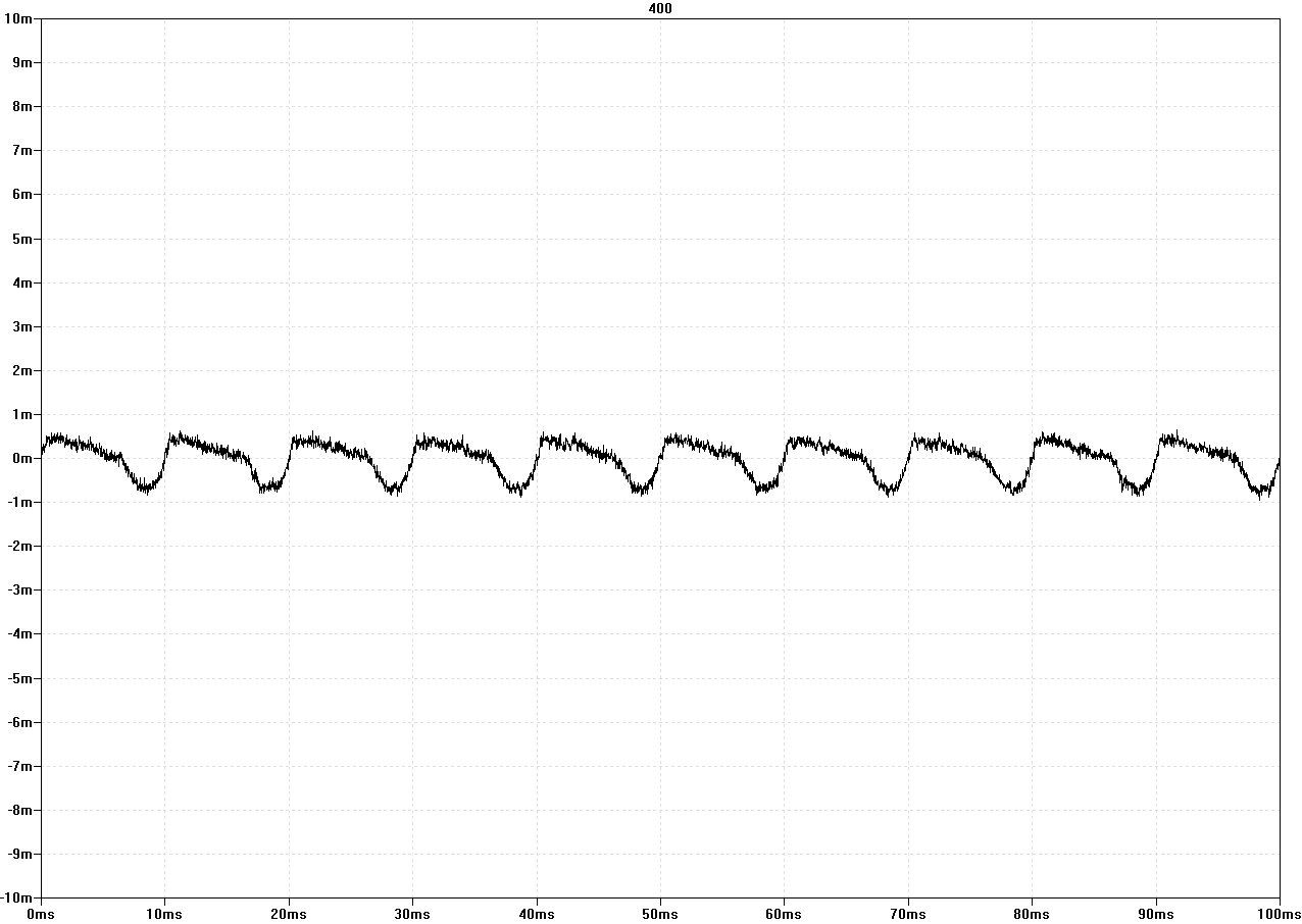

An update to my website with the new graphs for transient and step response will follow soon.

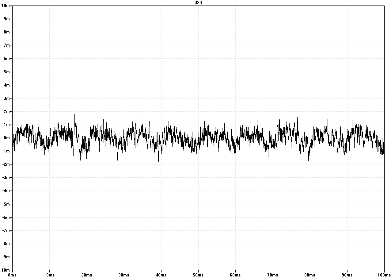

Mark, your circuit is not performing well on my bench (#320, colored in teal). Maybe this is a good example of the difference between simulation and reality? Or do I need a better performing TL431 to see the real benefit of this topology?
Looking over the waveforms, I still think the Zener-version (#400) is still performing best overall.
