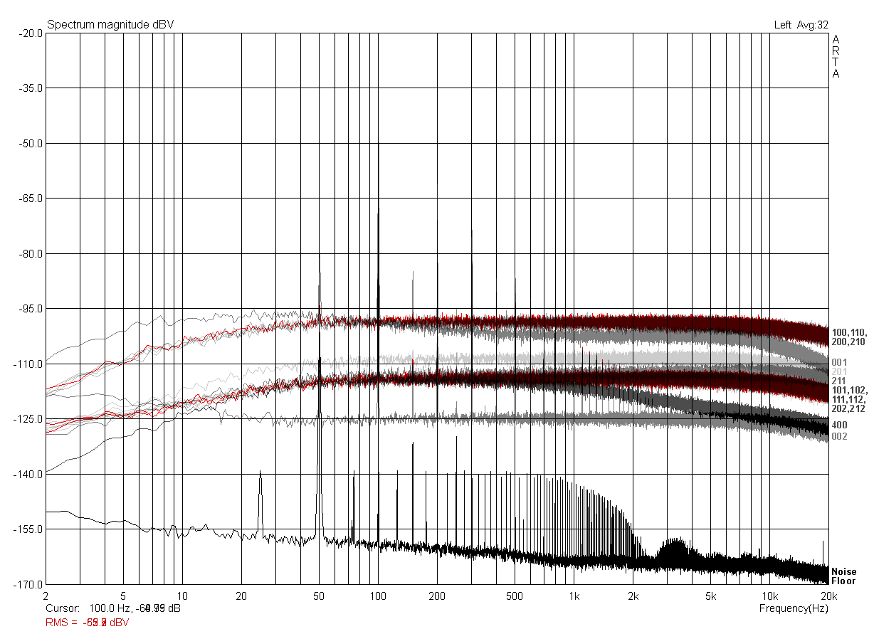

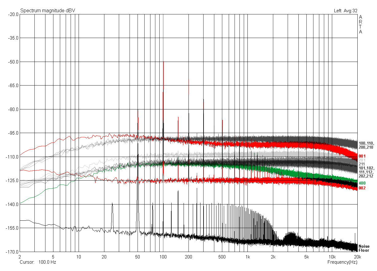

Now this thread really caught me 🙂. I simply had to hook up an LM and do some real-world measurements.

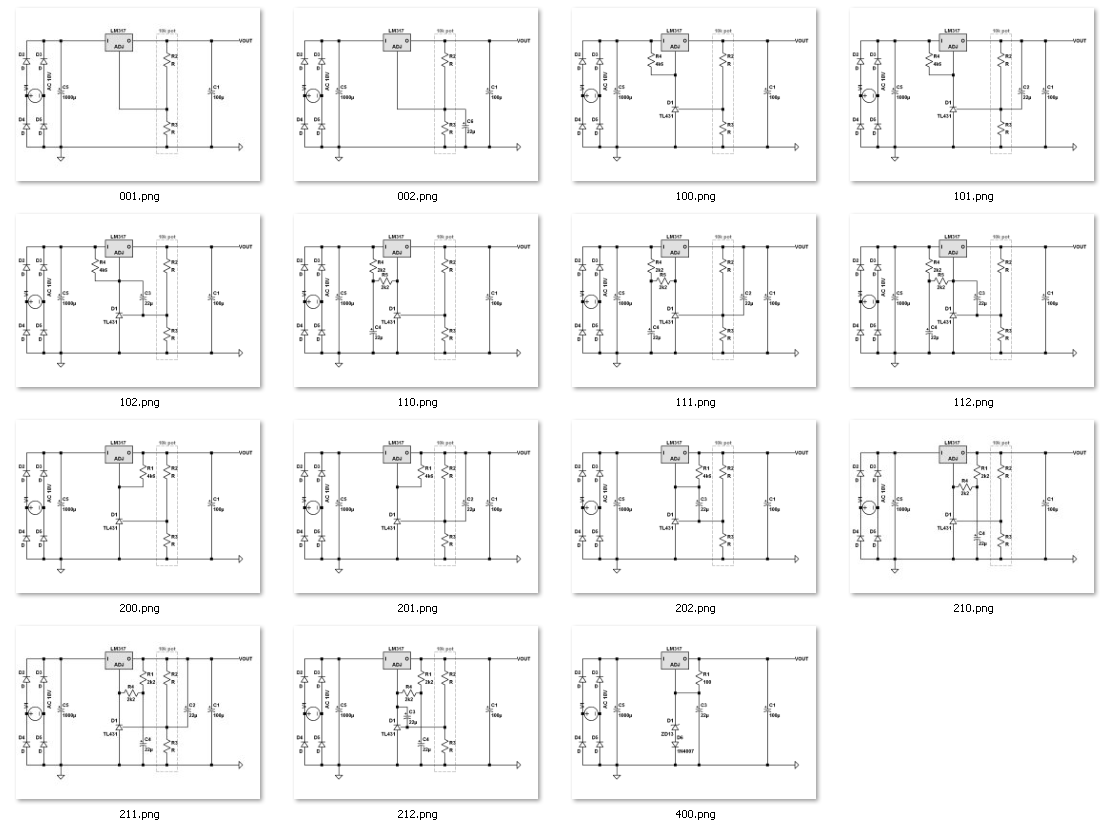

Please have a look at the results here: LM317 regulator under test
I've attached an overview of the tested circuits and the noise results here. To sum up, I'd say that "no TL431 is best", at least noise-wise. A simple Zener is at least as good, partially even better, while a simple cap outperforms both of them. Regarding the load step response, it is better to put a cap between TL431 cathode and TL431 ref instead of between LM317 out and TL431 ref.

LM+TL has worse noise figure because there are 2 complex active component and not only one (LM). It's normal.

SGK, you're welcome 🙂.
The traces in red are the ones (in the second diagram I posted here), but please have a look at http://preamp.org/diyaudio/lm317-regulator-under-test, there you'll find more detailed information, like step response and actual recorded flac's for your personal enjoyment.
