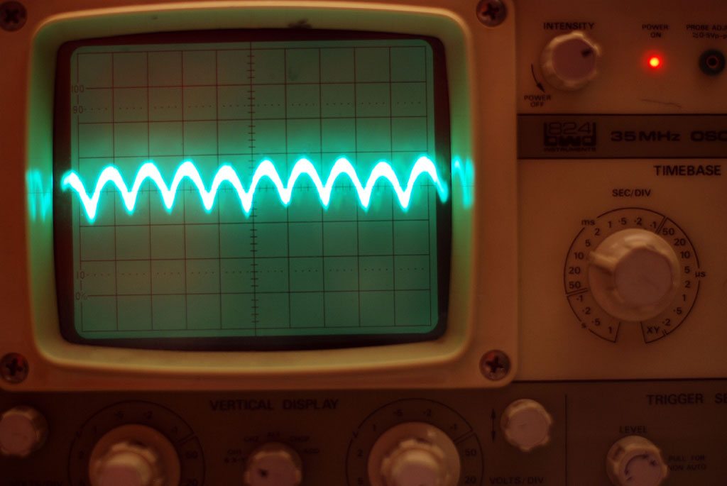

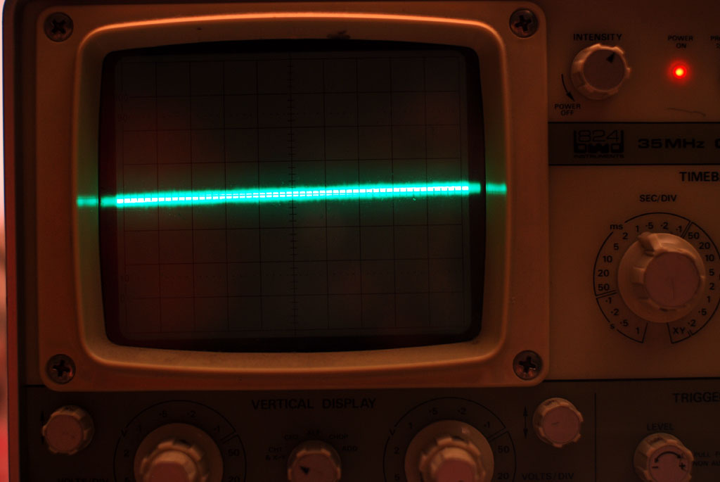

OK so tonight I did some more measurements in the case with the IEC filter connected. The results are much better 🙂
I tracked the weird waveform (in post 92) down to the spare PC (or it's monitor) So I know to make sure it is off if I am doing any measurements.
First pic is of the output of the positive rail. 2mV/div 1ms/div

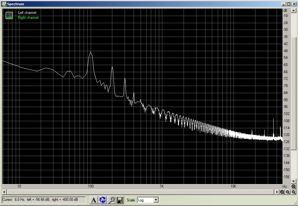

Second pic left is +10V rail right is -10V rail recorded in audacity, 10X gain on the preamp. the dreaded 50Hz anomaly is back though, but can be ignored, its probably an earth loop between the PS and the PC.
Third pic is taken on the 3r3 resistor at the output of the second cap. This is to get a reference point for the pc measurements.
Fourth pic is the spectrum on the pc for the same point as the thrid pic. 10X gain on the preamp. So 3mV p2p is about -48db on the spectrum.
Overall I'm pretty pleased with these results 🙂 though I will have to take some more with a real load. The built in pre load resistors only draw about 38mA.

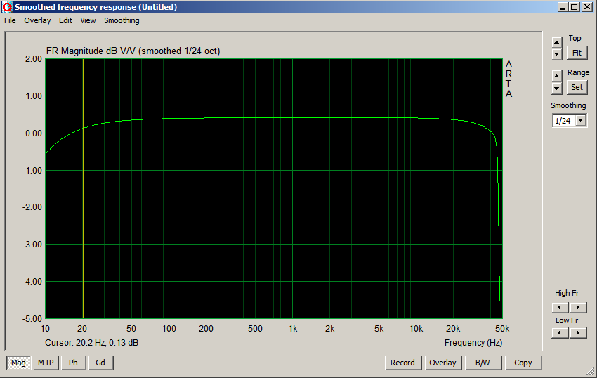

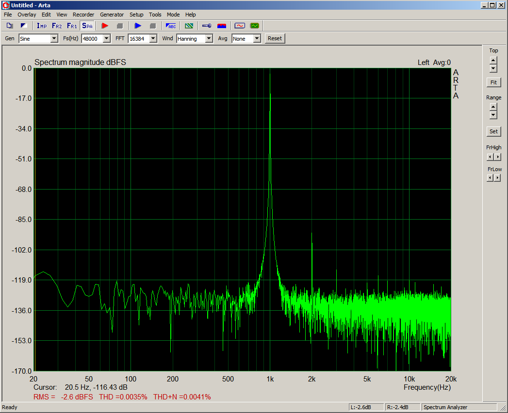

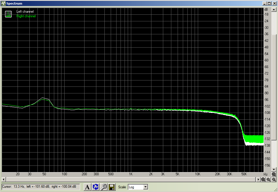

Tony, would you mind taking some more measurements? ARTA Download - this software should help you. It would be also intersting to see loopback measurement of your soundcard.
Hi Dunwenbleidd which measurements would you like? Attached are loopback measurements done in ARTA (I have 1.7.0 latest is 1.7.1)
1st is spectrum analyser mode.
2nd is an fr plot.
I set the levels using holm impulse to the highest reading I could get without it telling me it detected digital clipping.
I'm not sure how I can use ARTA for doing measurements of the PS though 🙂
Tony.
2nd is an fr plot.
Tony.

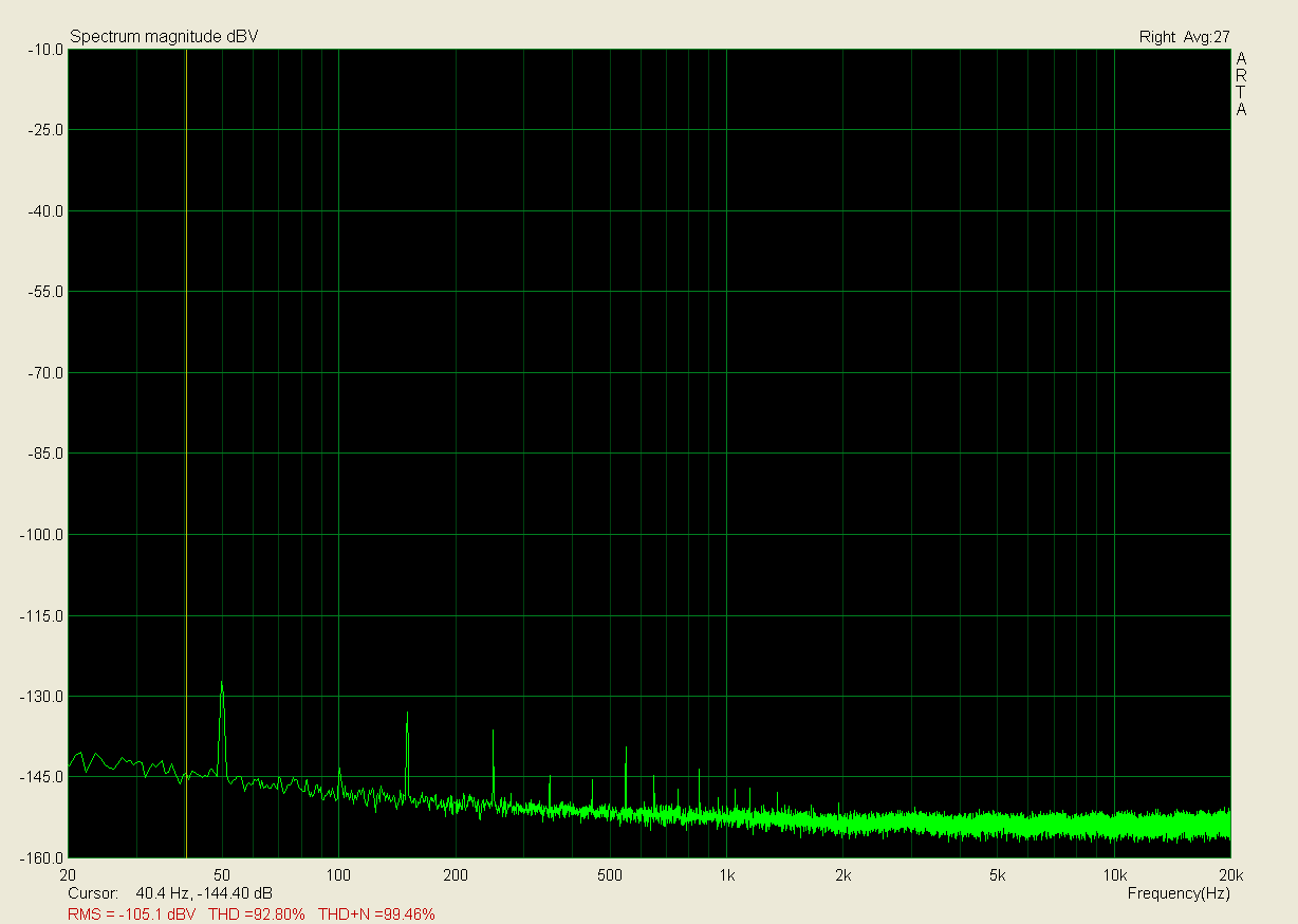

It's just the same as measuring in loopback. A little example follows - LM317 with Vbe multiplier. Maybe I've made a mistake somewhere, but I have calculated that it shows 5,6uV (at 50Hz)... That doesn't seem quite possible with such a simple design... 😕
