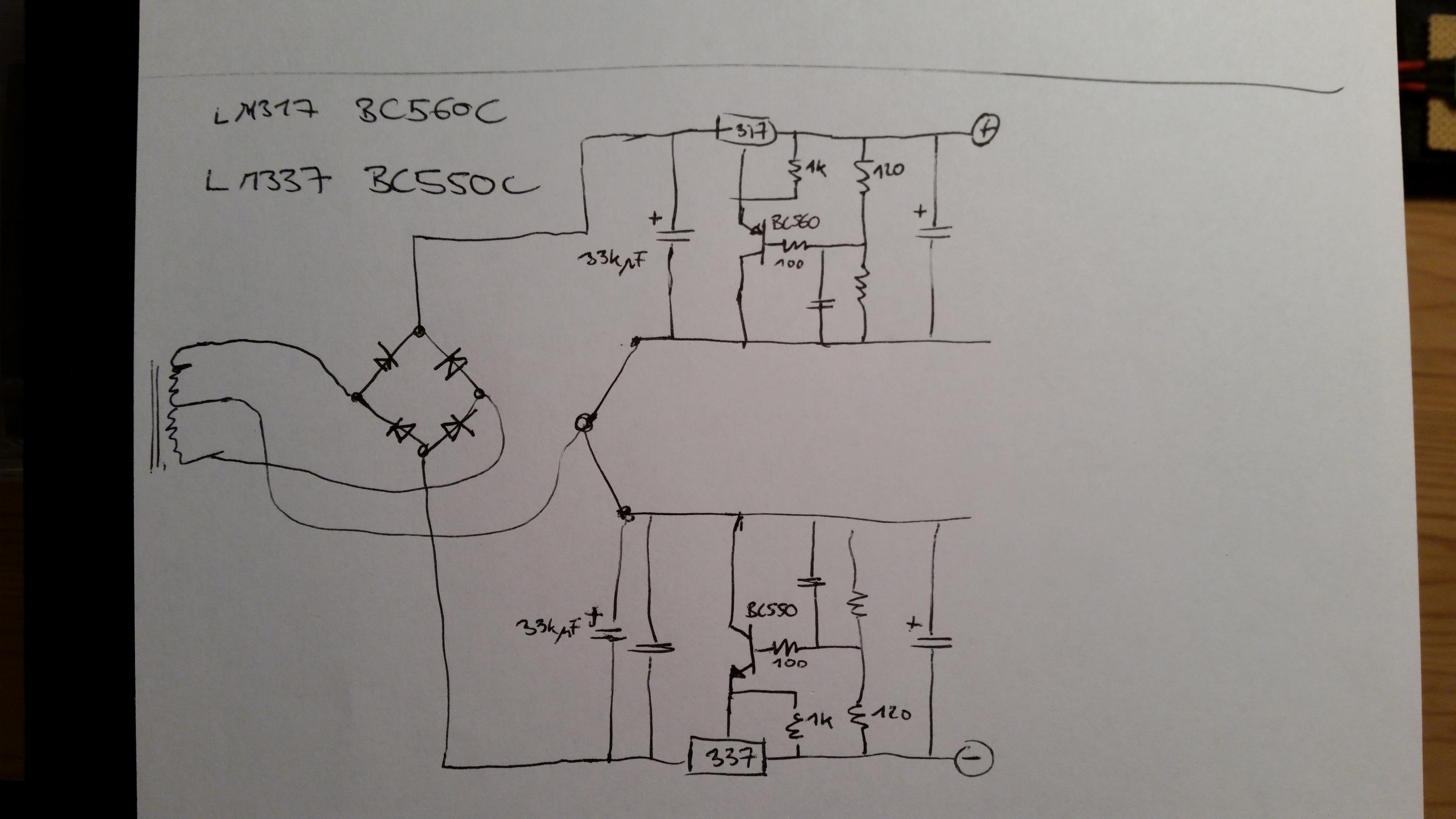

No, it doesn't work.
The last 4 tappings to the +ve side Zero volts and the last 4 tappings to the -ve side Zero volts, must all meet at a star point.
You then need to take a single wire to the junction of the smoothing capacitor and from that junction another single wire to the Centre tap of the transformer.
Electrically this layout looks identical to what your sch shows. The difference becomes apparent when you assign values of Impedance to every wire in your sch. The performance will be very inferior and that's why I said it won't work.
Thanks for pointing that out, the layout in my schematic is bad in regard to grounding. It was hastily scribbled down during breakfast... I'll hand in a proper version later.

How do we change this if we add a follow-up shunt circuit after it? Let's say an Active Regulator, does the Star Ground point on the right remain the new Star Ground, is there a new one or is there an additional one?
the post126 diagram becomes the Source of power for the next circuit/receiver.
Connect the source to the receiver using a twisted triplet.
Design the receiver circuit to minimise it's own loop areas.
Look carefully at that post126 diagram.
The transformer is connected to the rectifier with a triplet, make it a twisted triplet.
The rectifier is connected to the first smoothing bank with a twisted triplet.
The smoothing bank is connected to the regulator with a twisted triplet.
The regulator output is a twisted triplet.
All the inter module connections are twisted triplets.
That's the effective way to minimise interference.

If you were to try designing a PCB layout to match the performance of the hardwired version, you must take equal care to minimise the interference effect of the loop areas. The traces between the modules must be laid out to minimise the radiation of emi.
That is achieved by placing the flow and return traces adjacent to each other, or one above the other if a multi layer board.

OK, I think I understand how to minimise this loop area from the LM317, the adjust connections, the cap around the lower divider resistor as well as the output caps, with one star point for these. Then I can use this point to connect straight to the Load Return for the -ve sense line as well.
What do do with the tiny cap at the input of the LM317 though? Do I also connect its lower pin to the star point above (and additionally not to the bulk cap star point prior to it, correct)?
The input side cap is just to maintain a defined lowish impedance at higher frequencies. As the datasheet indicates, if you have a power supply cap nearby then no need for that extra cap. As such, that input cap can connect to 0V anywhere upstream of the 0V star you have.
OK, so it wouldn't be good to connect it to the ref post-regulator, right?
