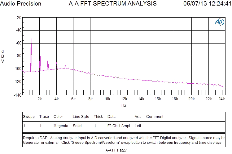

This is why you shouldn't use LM317 :

Ah that would make more sense 🙂 Could also be a square wave. I know when I ran a 1Khz squarewave through the DC-B1 that my LM317 based PS was powering that the scope trace on the PS rails post reg was definitely ugly. I don't remember if I tried a sine wave as well. It has me thinking I need to pull out the test gear!! I kinda went silent when I decided I needed the PS to actually power something that reproduces music, and further testing went out the window when I didn't encounter anything I didn't like 🙂
Tony.
Sine wave on the positive supply rail from the AP SYS2722 -- you can see that the LM317 error amplifier is inadequate. Discrete regulators like the Jung, Sjostrom and Sulzer perform much better.
LM317 fared poorly in the regulator bake-off which was written about in Linear Audio -- it made a hash of percussive instruments.
YES! I remember, ok, I'm a bit of an idiot here for forgetting...
Because I'm the guy who read your Linear Audio article on regulators and sent Jan an email saying "hey, why don't you measure THD on the output of your regulators?" and then he told you and you did measure, and the results were damn interesting.
FYI I tested plenty of LDOs and they all have more or less the same behaviour, ie, output impedance decreases with increasing load current, which means high THD on the output.
This is logical, as pass device Gm increases with current. Loop gain is enough to control output impedance, but they're not designed for low THD.
If it supplies anything which draws a distorted current anyway, we don't care. But if it's a class-A stage which draws a current which is an exact replica of the signal, we might as well not have THD on the rails.

I have a hunch that I might well care - opamps are classAB so fit into this category. And potentially the poor SQ that jackinnj noticed for the LM317 might be down to this. Stages which draw distorted current put lots of distortion on the rail, the amount depending on the output impedance of the reg + associated caps. It seems very likely to me that a high THD regulator also has high IMD and so possibly adds additional HF noise to the rail.

I assume that the injection of the sine wave onto the rail, is to simulate PS modulation by the load. I'm not 100% convinced as yet of the significance of this test. I would have thought that feeding the actual device (which uses the PS) a full magnitude sinewave and then doing the fft on the rails would be more telling...
I also note in the link above to jackinnj's other post that the fundamental on the super-reg is lower than it is on the LM317... It is not clear if this is because the LM317 is amplifying the fundamental, as well as producing harmonics, or whether the fundamental supplied to the LM317 was higher than the one supplied to the super-reg...
In the end, yes the super-reg handles this test better, but is it relevant?
