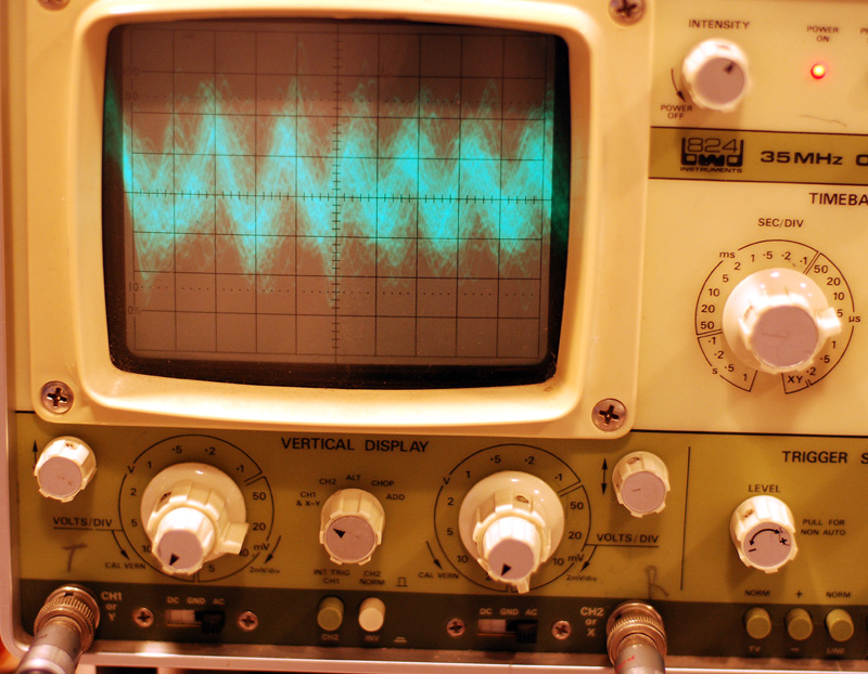

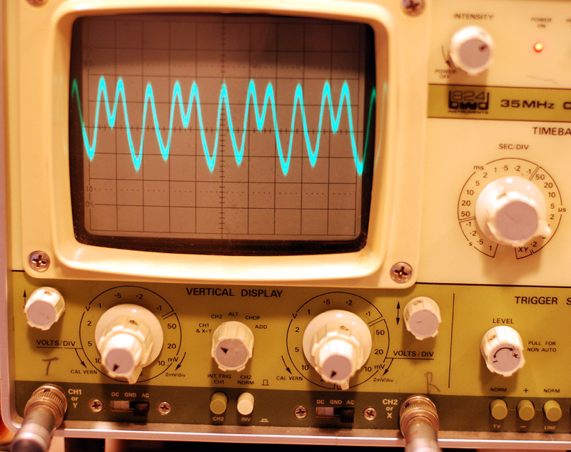

Well I haven't posted any more measurements because I wanted to get to the bottom of my 50Hz problem (which is proving to be rather difficult to track down. I also smoked the load resistor on the -ve side of the power-supply (and haven't checked if everything is alright. I decided I needed a break from it.
This afternoon I decided I'd try and get a baseline for the levels. Unfortunately that has lead to other issues. The output on my sound card (both actually) seems to be very noisy (strange considering they measure well with RMAA). If I plug the output of the card directly into my scope the noise levels are around 120mV p2p 😱 for the audigy and around 20mV p2p for the on board sound. Both appear to be some sort of high frequency oscilation (or oscilations) The oscilation on the onboard sound card seems to be maybe 3 fundamental frequencies, the audigy seems to be maybe 10-20.
It might be time I bit the bullet and bought a nice USB sound card. This would also have the advantage that I could use it with my laptop and run it off battery, completely eliminating the possibility of earth loops with the mains, as well as 50 Hz contamination. I will be back with more once I have things sorted 😉
1st pic is the audigy scope settings are 20mV/div and 5uS / division
2nd pic is the onboard sound. scope 5mv/div and 1uS/div

...that is PC noise injected into the ground loop.
You need a floating ground 'scope when playing with PCs.
I use an isolation transformer on a regular 'scope.
Yes, I know, this is NOT recommended!, this is not NOT safe!, do NOT do it!:
Tektronix: Technical Brief > Floating Oscilloscope Measurements ... And Operator Protection : Part 3
Used to have an audigy 2. IIRC the noise was <2mV, difficult to see on the 'scope with a 10x probe.
RMAA may measure OK regardless, as this noise is mostly outside the measured bandwidth. Or you did not have the 'scope connected during the RMAA tests?

Thanks discrete, I'd wondered about problems with ground loops with the PC. The thing I thought was a bit odd was that the audigy's noise seems much worse than the built in sound card, but on rmaa the noise floor is actually better on the audigy. Scope was not connected for rmaa tests, just a 10cm loopback cable.
I assume that the card itself picks up internal noise from other components of the pc and then injects into the ground.. I might try moving the card around (although I only have a a few pci slots to try).
Do you think a laptop with a USB soundcard would have less of a problem?

Much more likely is that you have a ground loop somewhere in the analog domain- between power supply, computer, test leads, scope, soundcard...

Hmmm I'm wondering whether the comments on the noise are the original 50Hz problem or the latest high frequency noise problem I've noticed. I have a suspicion Discrete is talking about the high frequency noise, and SY about the 50Hz?
The original 50 Hz problem there is no ground loop (that I am aware of) as the preamp ran off a 12 V battery, and the PS 0V was not connected to safety earth for the tests (when it was there was a massive earth loop problem with the noise floor being around -6db at low frequencies!!!
The high frequency noise however there is almost certainly a ground loop between the scope and the PC, now that I think of it. When doing amp measurements I have to have a low ohm resistor in series with the earth line of the SC preamp input to suppress the earth loop issues. They are permanently attached to my dummy loads.... I probably should try the same for checking the output of the SC...

I saw both 50 (60) Hz with harmonics and HF.
ARTA also showed a component around 44 kHz (coincidence?), that disappears when I play with the grounds.
Laptop will have step up/step down switchers for reasons of efficiency and heat dissipation.
