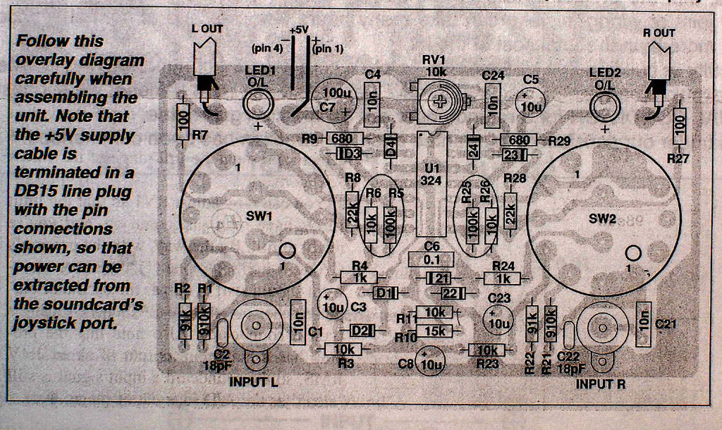

The attachment is the board layout, I don't know enough about layout to know whether it will be good/bad/indifferent for a higher bandwidth opamp.
Tony.
It is not OK for a high bandwidth opamps (but it will work with NE5514 and the likes)

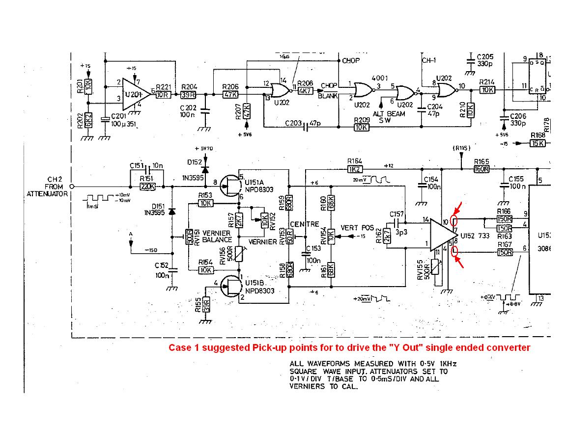

Now for the oscilloscope “Y out”
Some manufacturers -TEK is one of them- implement “Y out” as a buffered out signal of Input 2 channel. They pick the signal just after “Input 2 preamplifier”.
Lets call this “Case 1”

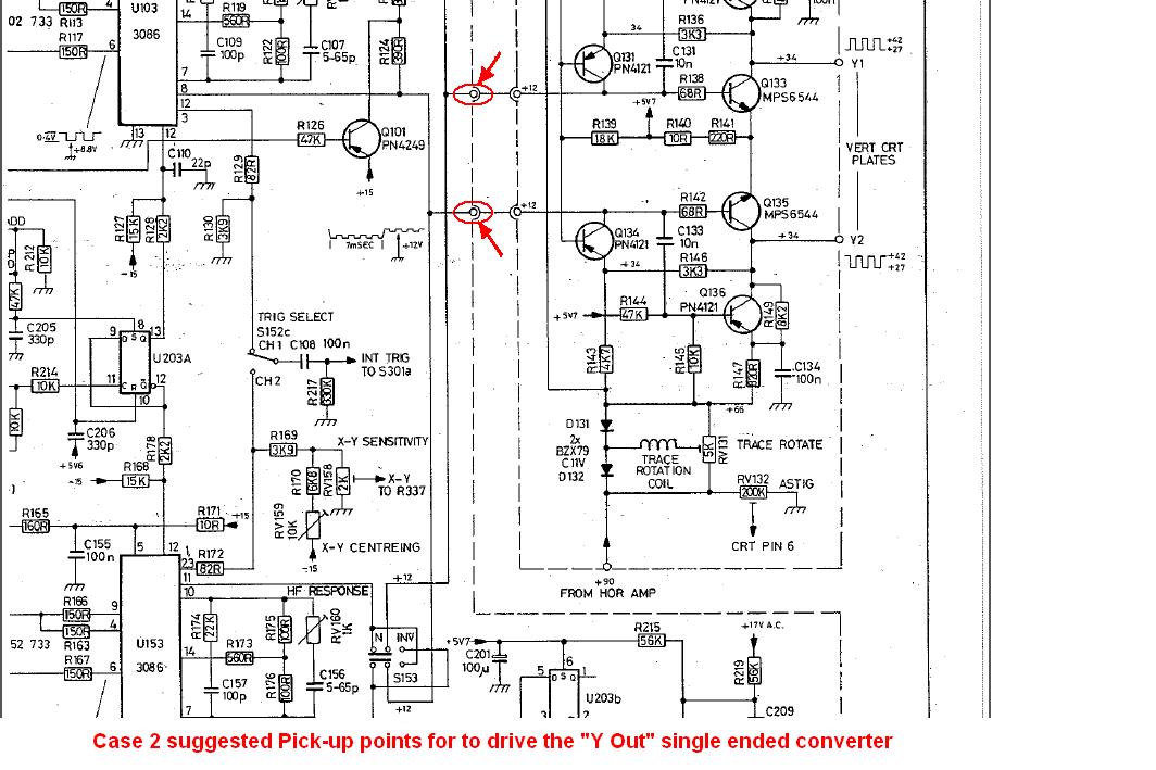

Others, implement “Y out” as a buffered out of whatever is channeled to the screen.
That can be Input 1, Input 2, Inverted Input 2, Input 1 minus Input 2, Input 1 plus Input 2 ect. They pick the signal just prior to the “Y main Amplifier”.
Lets call this “Case 2”
In all the oscilloscope schematics I’ve seen, at the pick-up point (both cases), the circuit is differential. So they use some form of “differential in to single ended out” circuit to bring out a single ended “Y out” which is specified as 50Ohm out.
The signal amplitude is 50mV per screen’s vertical division (mV/div) when the attached load is 50 Ohm, or 100mV/div open circuit.
Note here, that the maximum signal coming out the “Y out” can be much higher than simply (100mV/div) X 8 divisions. This is the case of high “Y amplification”, when only part of the waveform is visible on the screen, while the upper and the lower parts –or one of them only-are above and below the screen respectively, thus invisible.
At the schematics you provided for your oscilloscope:
For “Case 1”, I would suggest pins 7 and 8 of U152 (page 48/54 of pdf) as the pick-up points for the “differential to single ended converter” circuit which will bring out the single ended “Y out” See first attachment.
For “Case 2”, I would suggest the drive signal of the Y Output Amplifier (page 49/54 of pdf) as the pick-up points for the “differential to single ended converter” circuit. See second attachment.
Any objection or suggestion from members who have an opinion is welcome.

EDIT: Actually, TEK provides a buffered Input 1 signal to "Y Out" and not Input 2 as I wrote above. My bad, sorry

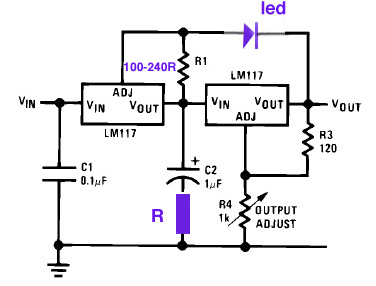

Interesting configuration Piersma! I think I'll have to sim that because I don't understand how it works.... What's the value for R? 1 ohm or less??

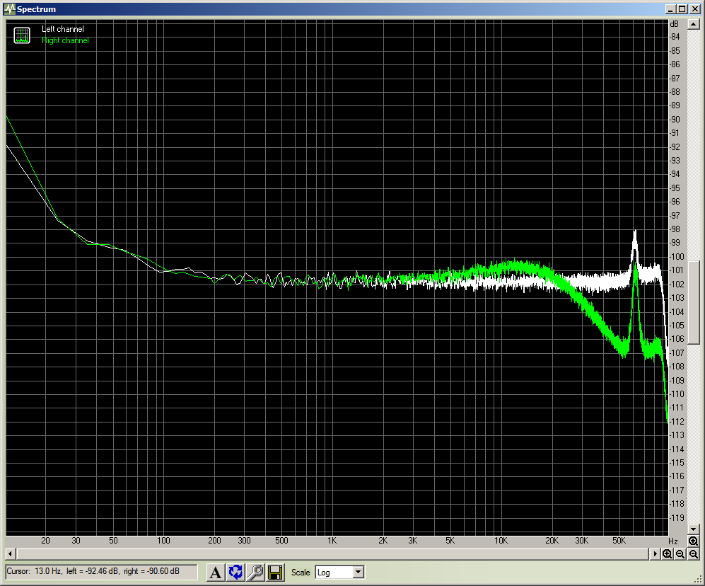

As promised here are a few more measurements.
1st pic is comparison between 100uF cap on the output with 0r33 in series (left channel) and no resistor in series (right channel). Note that for some reason subsequent measurements with this cap did not get the flat noise floor and instead started to drop at higher frequencies.
2nd pic shows 100uF output cap with 0r33 left and 0r66 right channel in series.
3rd pic is one I did last night, it is a comparison of a single 1000uF cap as post rectifier filter (left channel) vs a single 10,000uF cap post rectifier filter.
I love how this one objectively illustrates the high amount of noise (harmonics of 50 Hz) created by using an over-sized post-rectifier filter cap, and that it shows no reduction in noise at other frequencies. Some people think that you can never have too much capacitance in a power supply, but this clearly shows that more is not necessarily better. The effect on the audio will depend on the PSRR of the devices being powered among other things, but the supply is clearly more noisy.

Dual LM317 configuration
A little explanation is in order:
The configuration of the 1st 317 results in a constant voltage differential for the 2nd 317, rather than a constant voltage input. What this effectively means is that the 2nd 317 does not need to perform any line regulation (the 1st 317 takes care of that), so it only needs to control the load regulation. The result is better overall regulation at the 2nd 317 output.
(a much better explanation is at Using 3-pin regulators off-piste: part 1 on page 4).
Scrounge up a modest value Oscon cap, say 150uF/25V and try that as the output filter (if the voltage isn't too high). I think you'll see a marked improvement in noise at the higher frequencies. Big electrolytics aren't as bad as many think, but the low impedance of the Oscons can be a real eye opener.

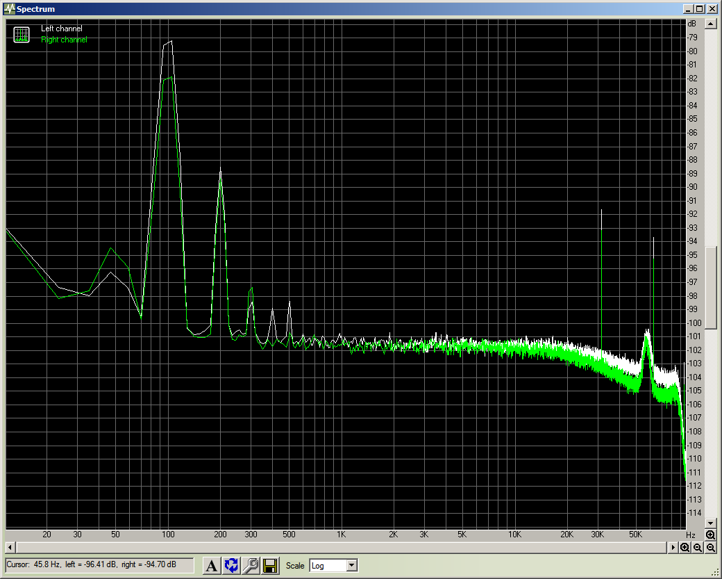

Just another Moderator
Joined 2003

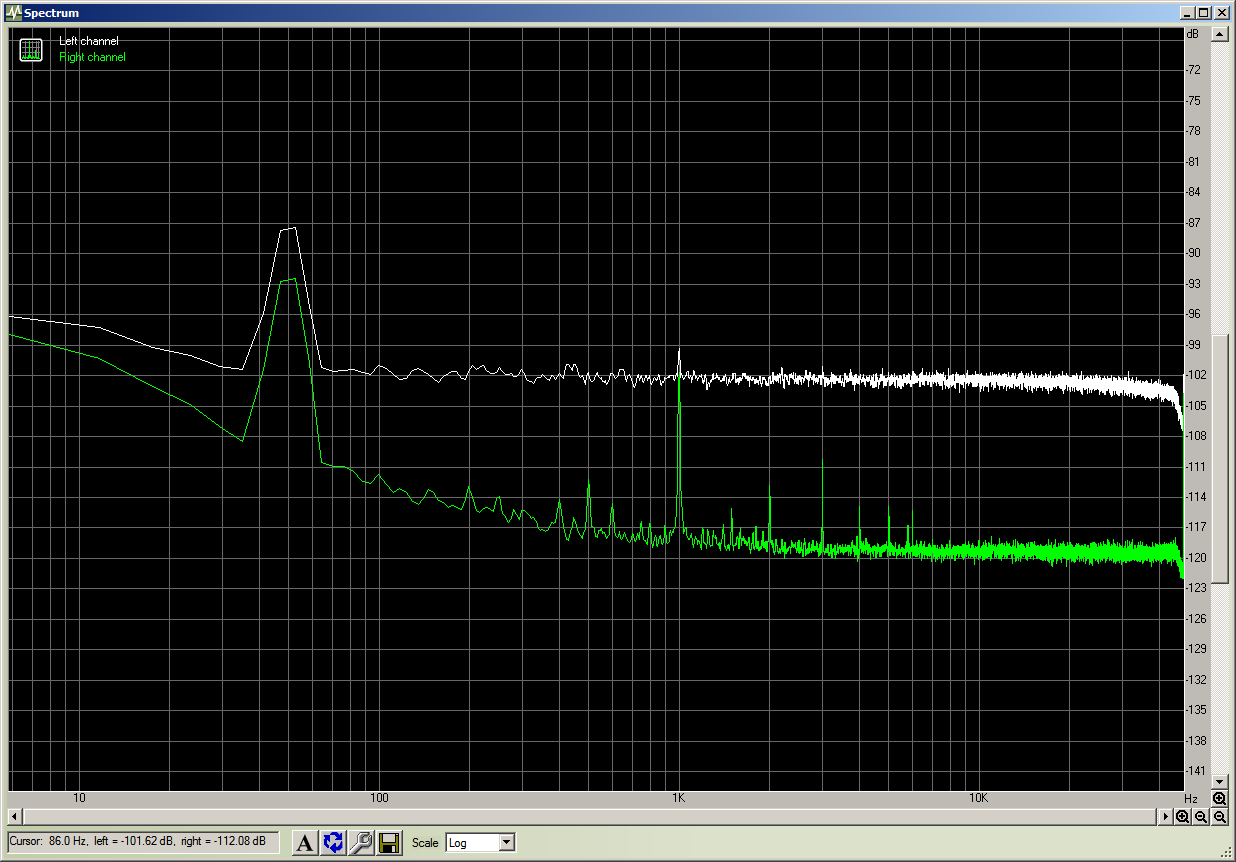

Hi Macboy, I'm not sure I'd trust the 50Hz stuff, it's been bugging me, because it comes and goes. I'm not sure its coming from the reg circuit. I just decided to give my audigy II ZS another try and in most respects the results are better than with the onboard sound card, but the 50Hz is worse... Having said that though, I do believe that the bigger cap did result in more 50Hz. I'll test again to see if I can get repeatability.
The graph shows (left) output of the reg, and (right) scope probe shorted. As you can see, most of the 50Hz is there with just the preamp and the input shorted (and the PS completely disconnected from the mains as well).
SY, the layout is hideous, have a look at post # 10 ;) it is on breadboard and the component leads are "full length". I hope this doesn't make all the measurements worthless :( Also the first pic in post #7 illustrates what you are talking about perfectly! It shows the difference with just a move of the scope probe earth wire to a different point on the "same" common earth (the measurements up to that point were basically useless). I did make a post asking for feedback on my proposed layout here --> http://www.diyaudio.com/forums/power-supplies/186019-obsessing-about-layout.html but I never got any feedback :( BTW I'm probably going to change that after these experiments, but haven't got around to it yet. The 10,000uF's will more than likely go, and it will become 4700 3r3 4700 3r3 1000 (though I also think the third cap is largely irrelevant based on some early results I haven't posted yet.
Conrad, no I haven't seen the app note you mention, but I have simmed the effect of the output cap (especially with low esr) on the output impedance, very low esr results in significant resonance (and the bigger the cap the lower the resonance point) due to the cap forming a resonant circuit with the inherent inductance in the output of the reg.
Also although it now only goes to 48Khz (due to the audigy's 96Khz max sampling rate) , I think you will see that the problems in the higher frequencies were inadequacies in the on board sound card, rather than the noise on the circuit. Post #3 Pic #3 shows the comparison of the shorted input to the on board sound card with the reg output, again the noise is present in the sound card (or perhaps the preamp). However next order I do place I'll add in an oscon :)
anyway it is way past my bedtime so I'm heading off for the night. Perhaps more tomorrow :)
Sorry if this post is a bit incoherent, It's late, and I've had a couple of glasses of red ;)
Tony.
