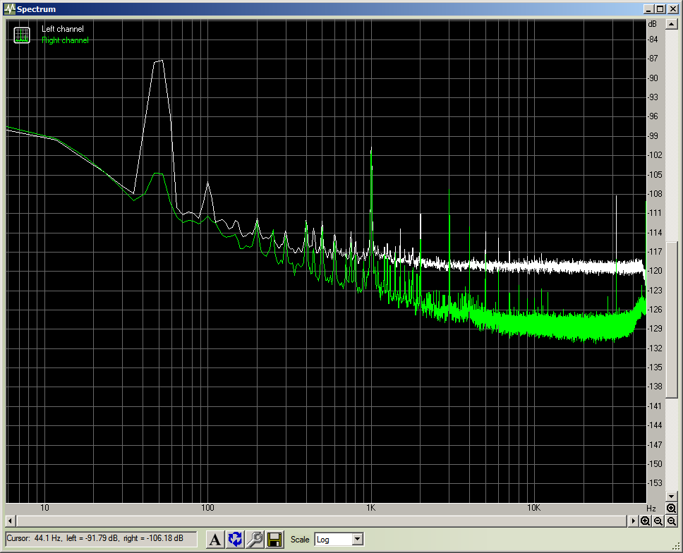

OK the plot thickens with respect to the 50Hz. The preamp is definitely compromising the results in the 50Hz region. Also I opened it up and checked the chip, and it would appear that I have upgraded it at some point (even though I don't recall doing so) as it has a motorola LF347N in it, which is a relatively low noise opamp with 4Mhz bandwidth, compared to the original very pedestrian, LM324 I also found I have a TL074CN from ST micro in my junk box...

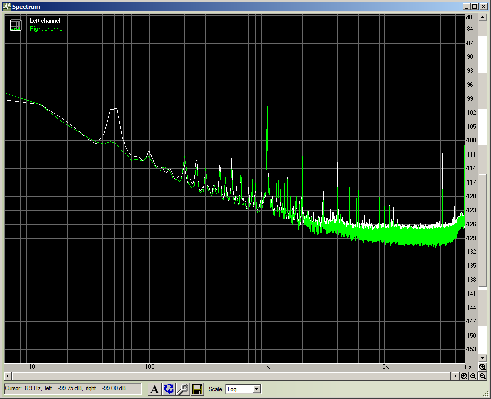

Anyway below are a series of measurements of the preamp with the scope probe switch in the ref position (shorted).
1st pic (left) no connection to sound card, (right) preamp connected 10X gain

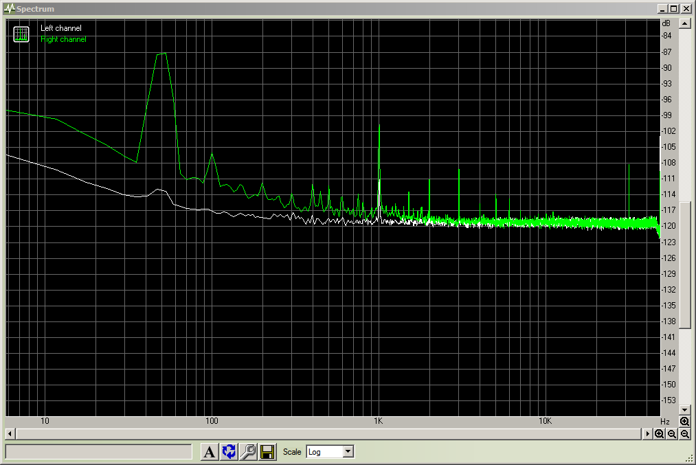

2nd pic (left) 10X gain position, right 1X gain position.

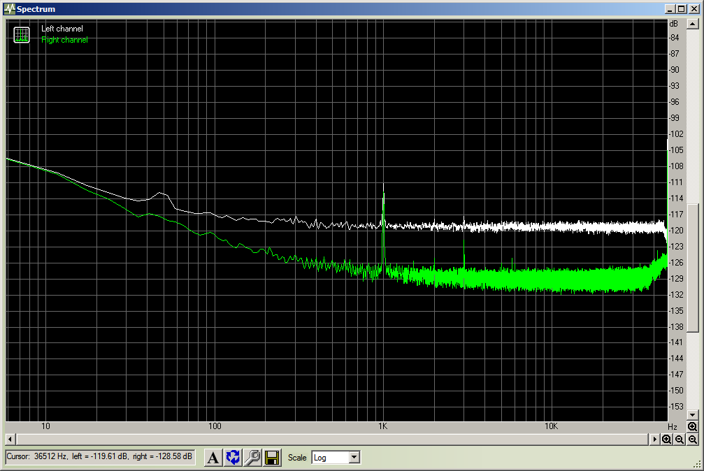

3rd pic (left) 1X gain position, right 0.1X gain position (interestingly with this one the noise is worse in the 0.1X gain position)

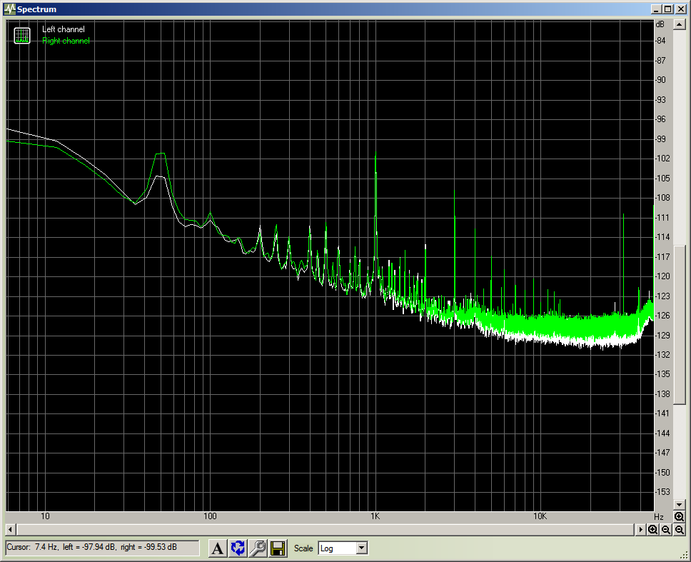

4th pic (left) 0.1X gain position, (right) 0.01X gain position.

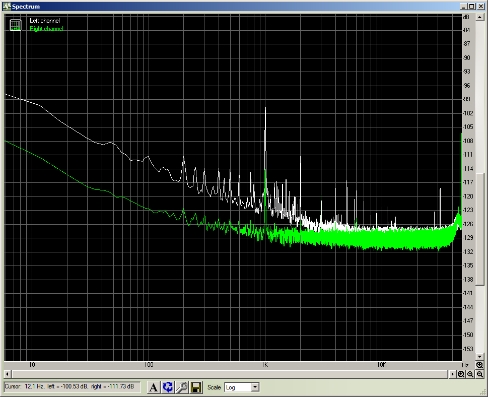

5th pic (left) 0.01X gain position, (right) no connection to sound card.
The very interesting thing about this is that 0.1 and 0.01 gain positions just attenuate the input from the scope probe.... The opamp runs in unity gain.
I'm thinking that there may be 50Hz coming in on the shield from the sound card connection and poluting the ground connection. The preamp itself runs of a 12V gell cell Lead acid battery.
The good thing is I have plenty of bandwidth to increase the gain, the bad news is, if I increase the gain to 100X I'm going to have a big problem with the 50Hz noise.... sigh...
Tony.

If it was a 100Hz fundamental then why is the 50 Hz dominant? 😉 Yes there will be 100Hz harmonics as a result of the 50Hz problem. Do note however that all the previous measurements were done with the on board sound card which doesn't seem to have as much of an issue at 50Hz (another reason I think the noise is coming down the shield from the input of the soundcard, to the output of the preamp.
I unfortunately forgot my comment from last night about disconnecting the TV aerial, and the soundcard preamp is in bits right now (cant see the chip without desoldering the BNC connectors). I will re-try with the TV aerial disconnected, I know I DID get some 50Hz free measurements early on, and I suspect I had disconnected the TV aerial.
Also whilst there will be some contamination of the 100Hz measurements those that show 20db or more at 100Hz have the actual 100Hz noise completely dominating any polution.
I will of course endeavour to get some clean measurements. I think whilst the preamp is in bits I might swap a few parts as well... perhaps up the 68n input cap to 100n (or possibly bigger if I have one handy). Also might up the decoupling cap to 47uF or swap it for a nichicon FG 10uF...
Also I just checked and I didn't change the voltage divider for the 2V reference when I changed the PS to 12V (from the design spec of 5V) I'n getting 4.4V instead of 2V. Will fix that too, I've got 0.66V dc on the output.......
Tony.

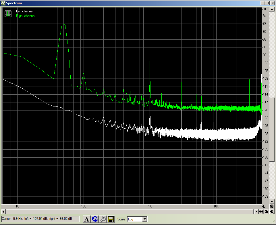

well now I'm just confused... I decided to take a measurement without the battery connected. The 50Hz is still present. If I just put an extension cable on the sound card input without the preamp plugged in there is a small amount of 50Hz but not as much.
Where it gets really weird is that if I change the gain from 10X to 1X the 50Hz gets lower.
However I just turned everything off (including the monitor) The only thing running in the vicinity is the ethernet switch, and I have a much more acceptable result.
below shows comparison of 10X gain setting on preamp, compared to nothing attached to the soundcard input. scopte probe set to ref (shorted) position for the 10X measurement.
Mods I made to the preamp were:
replaced feedback caps with 47uF nichicon FG's
replaced 100uF filter cap with a rubycon YXA
replaced 10uF reference voltage cap with a 10uF nichicon FG
replaced input caps (oring 68nf wima polyester) with 100nF vishay MKP1387's
changed both resistors in the voltage divider network (for ref voltage) with 22K
added 1uF axon polyprop caps on the output (otherwise there would be 6V DC)
All this from stuff I had in my junk box,.
I don't think I'm going to completely eliminate the 50Hz problem, but I do think that this is an improvement, and If I can replicate later future results should be just that bit more "reliable"
edit: added 2nd pic to show previous 10X gain measurement compared to current. left is latest measurement 😉
Tony.

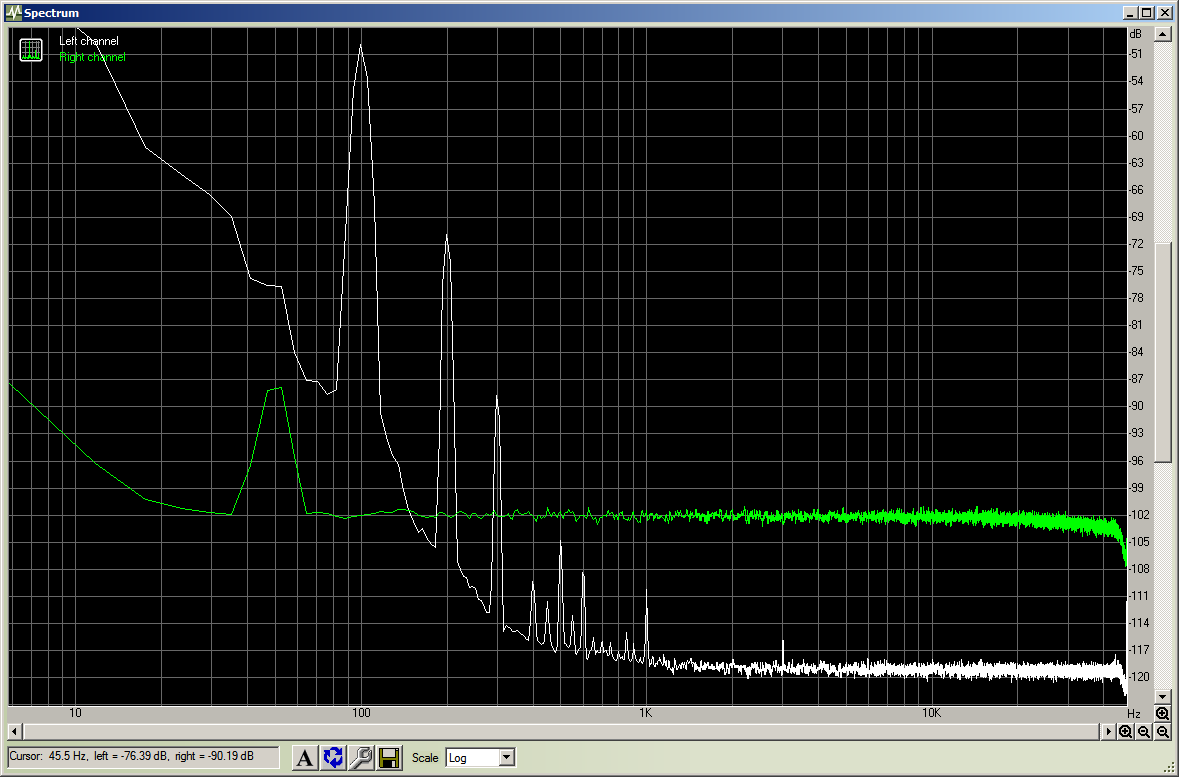

Well I'm even more confused after tonight 🙁 I've been getting consistent measurements (around -111db for 50hz with the scope probe shorted) also put a 22uF bipolar (shock horror) on the output and it is now almost the same as the sound card for frequency response down to 10Hz.
So I did a measurement of what I had previously measured... all looked good except for -88db 50Hz didn't matter what I did it wouldnt go away... This on what was previously giving around -99db at 50Hz 🙁
The thing that has me stumped is that I measured the input of the reg and then the output, and the reg is completely removing the 100Hz and its harmonics, and also cleaning up below 50Hz, it just seems to have this 50Hz spike, as if it is completely incapable of filtering out the 50Hz! Also the noise floor (at higher frequencies) pre reg is close to 20db lower... I guess that could be the 20db of gain in the preamp, but pre-reg also had 20db of gain...
Pic (left) reg-input (right) reg-output.
:scratch: Tony.
