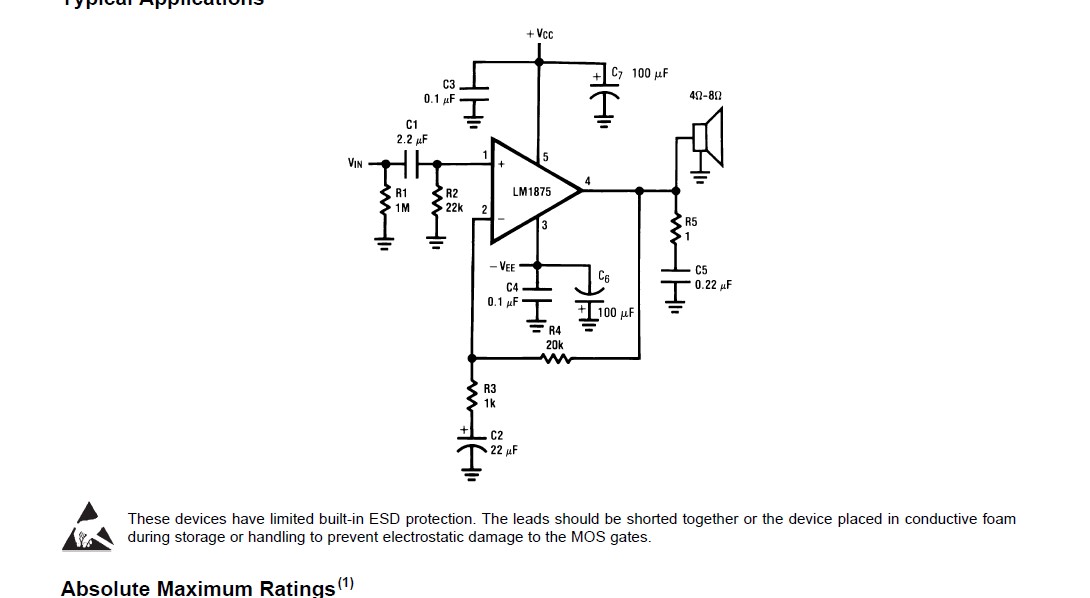

Have you looked at the data sheet? There are designs within that document.

Its a model that should work correctly. I'm not sure there is any such thing as 'best' because that means different things to different people.
The data sheet diagram is correct and fully functional and should be used as a starting point.

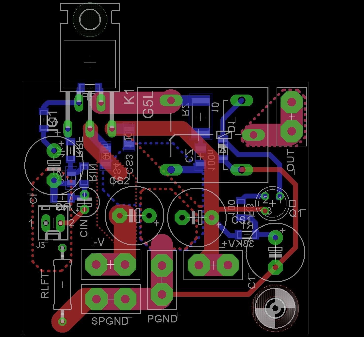

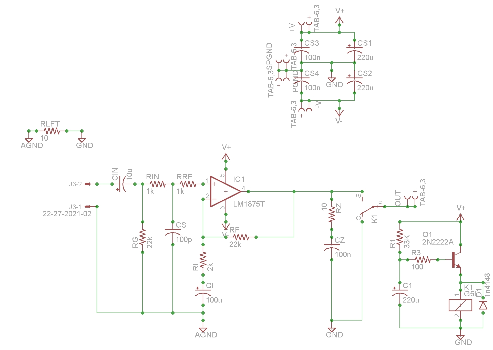

Anyway here's my schema and PCB, works pretty well. The relay is optional but avoids the very loud turn-off thump.

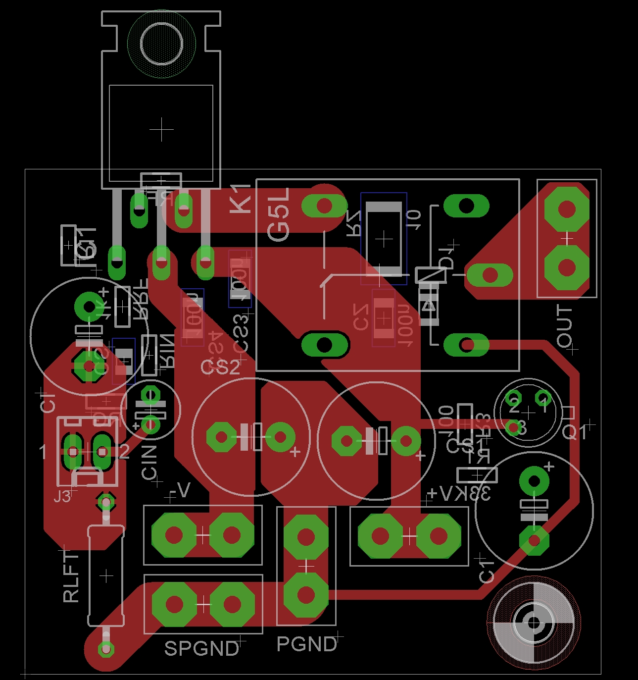

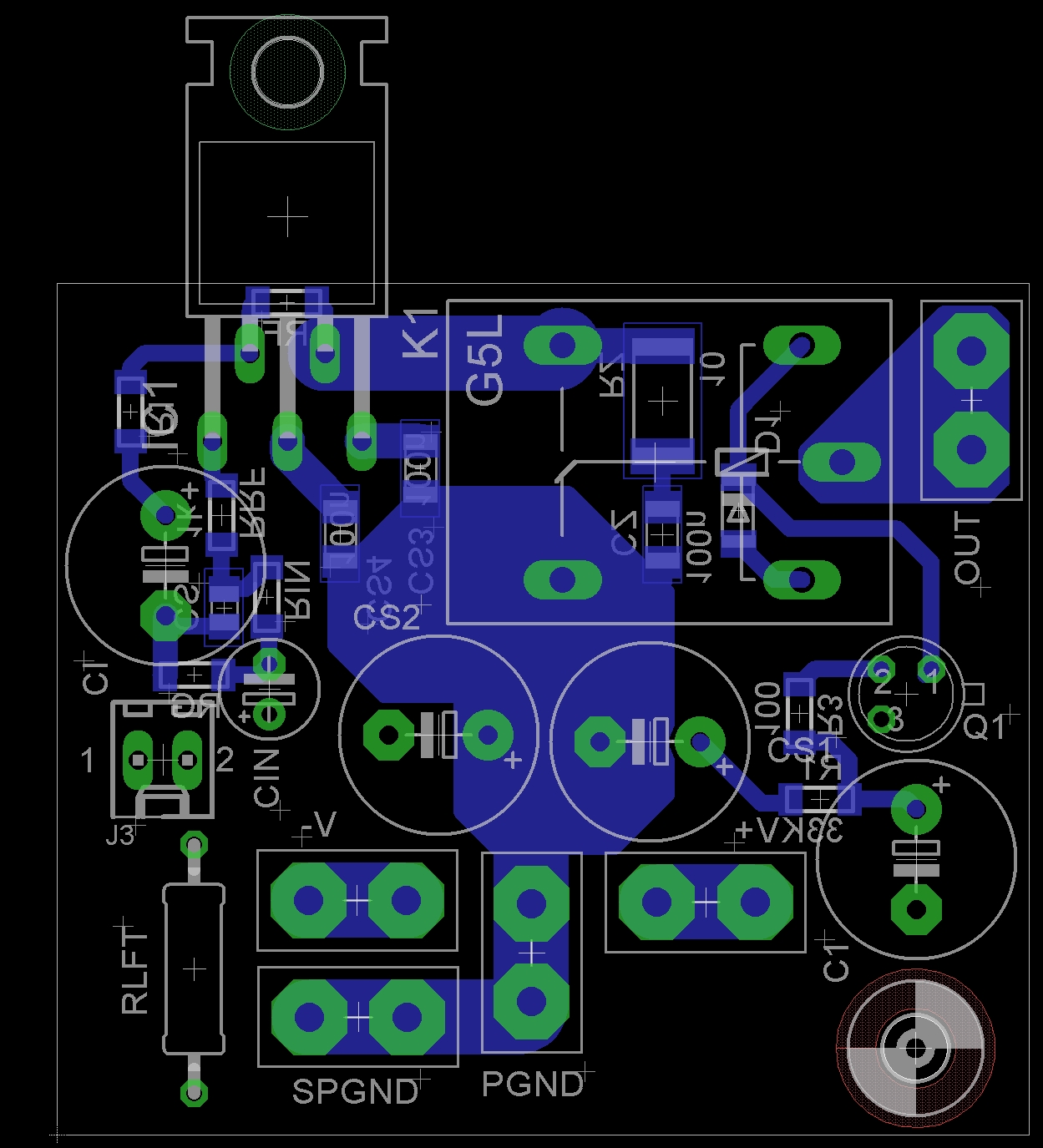

Here's some views with the top copper and bottom copper. It might be helpful to visualise the effective current paths.
In hindsight I would have liked a different way of routing the signal ground, but even this works quite well.
