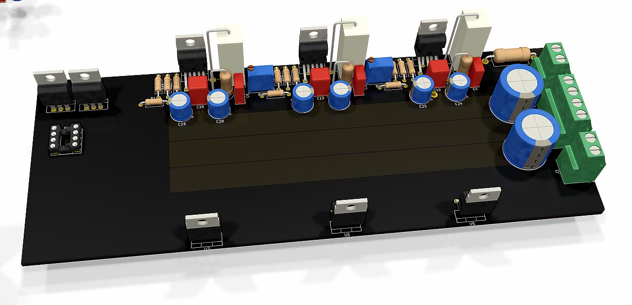

I just finished redrawing schematics to KiCad. Can someone take a look and verify if I didn't missed anything before I proceed with layout?
There is one thing bothering me.
PCB going to be big, I estimate around 25x10cm. There are 10 trimmers on schematics. Because of that, project becomes really expensive, defying the idea of good performance while being dirt-cheap. I wonder if LM1875 is worth the effort. Theoretically more expensive LM3886 could possibly be better and cheaper option as it's going to be much more compact and won't require trimming resistors.

You are right that the pcb is not small. If you look some pages back to FF prototype its not really small.Yes the LM1875(3 euro) is not as good as the 3886. no mute...less power rating, no mute pin, small package...
a UTC 2050 is still available for 1 euro at reichelt and then the power chip is not expensive anymore.
maybe if you will to a second version with nearly all SMD parts then you can shrink the pcb.
but the initial idea by FF was that every power chip could be scaled to a power amp (BTL !!) and if you understand the principal you can do this for other chips too!
chris

the gain should be -3,5 at the power chip
Small update. Board probably going to measure 200mm x 75mm.
Value errors at schematic are possible, but not really an issue until component shares same package.
I tried to use universal footprints. Most resistors are metal film 0.6W type (DIN0207 like Vishay Beyshlag SMA / BCcomponents MRS25 series).
Small film capacitors can be both with 2.5mm or 5mm lead spacing. Larger 4.7uF gonna be ceramic X7R, just didn't had that 3D model.
