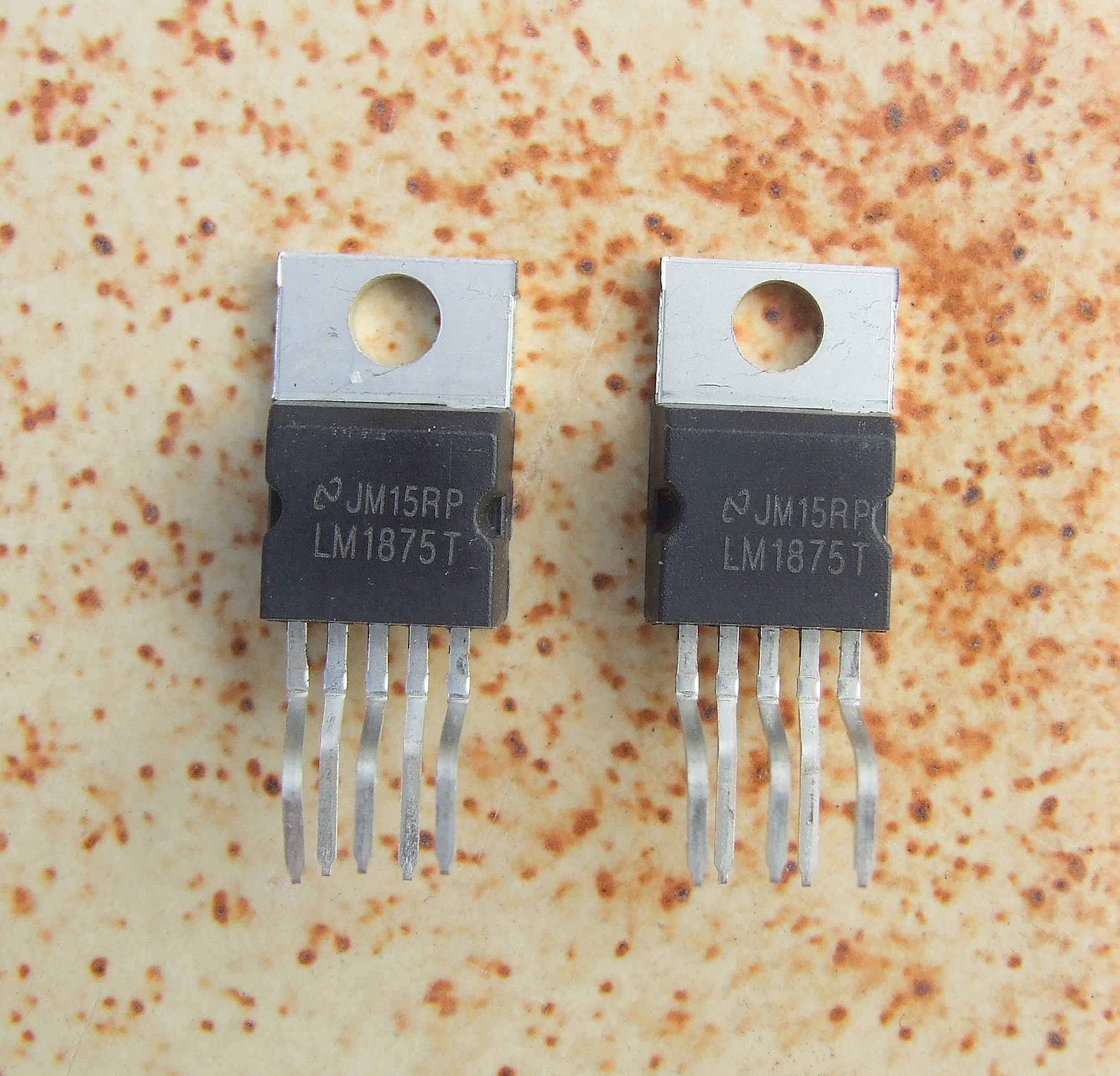

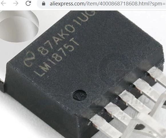

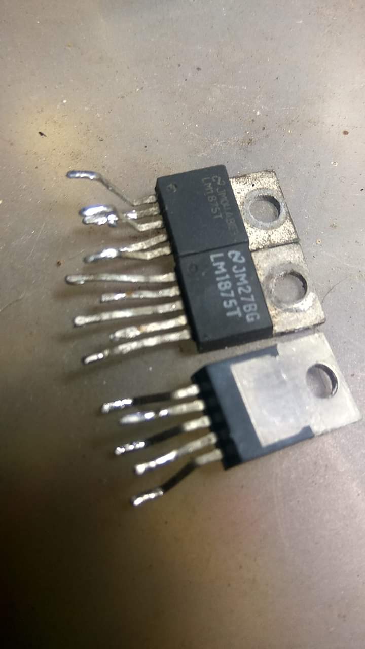

This was the picture of fake ones. Does the original resemble to this?
Yes! Don't trust on eBay.
Authentic natsemi 1875
The marking(number and latters) colour has changed from white to brown, laser marked maybe. Beware of fake lm1875 from eBay or chinese vendors, fake white colour version is also available there. I never heard a 1875 amp so this is the first time i placed an order for it, definitely genuine lm1875t!
