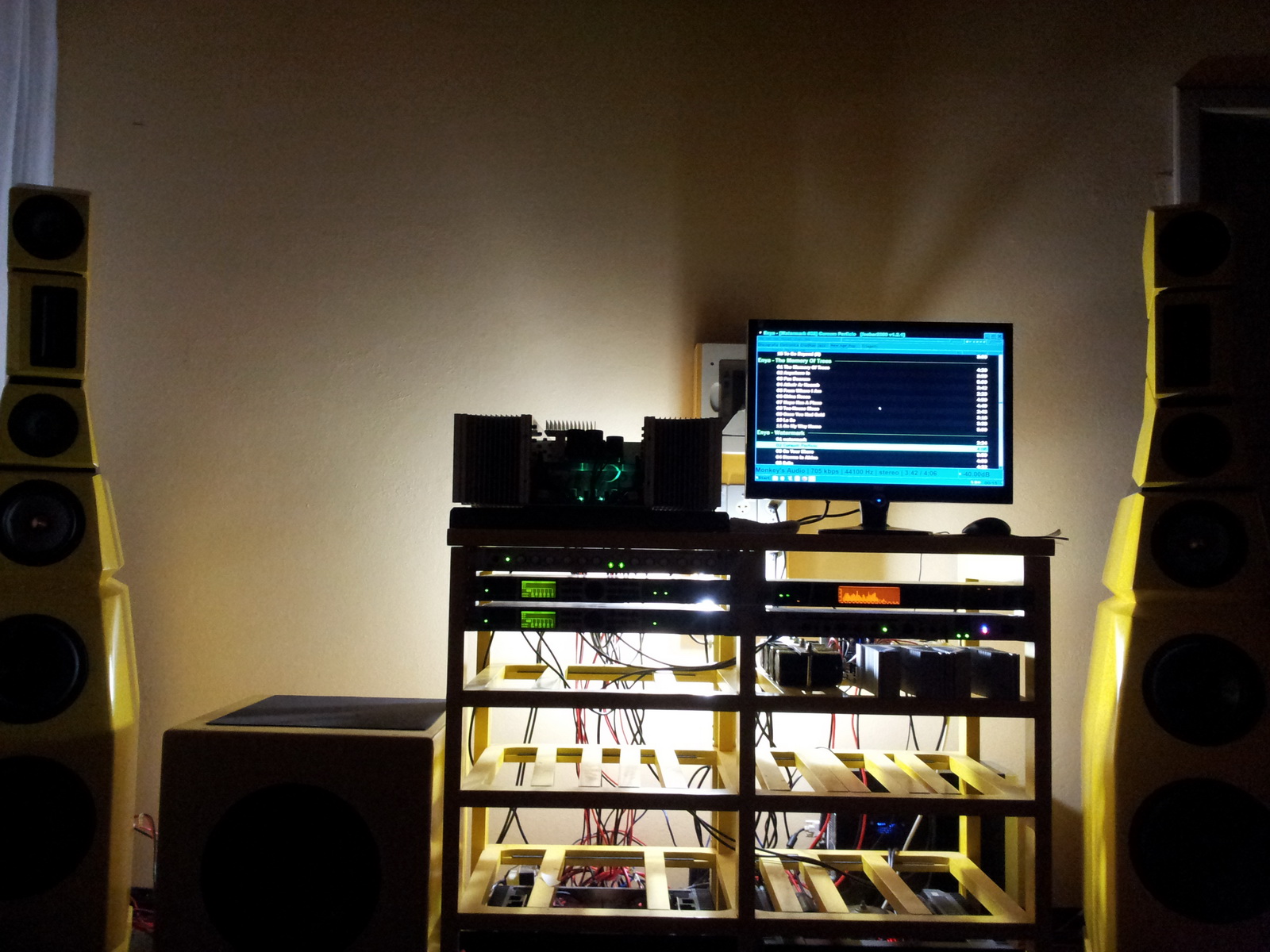

Hi everyone
Yesterday , had a day off work , instead of drinking + BBQ I spent my time in hot weather to assemble the board , I bought the one with complete PSU + Speaker delay ( Protected ..not test ) + sanken output devices fused, filtered caps .. complete in one single board , the assembly process went smooth as the kit is well prepare down to screws fuses ..etc , took me around 3 hours to complete , it use 2SC5171 + 2SA1930 instead of 669/649, power it up no problem the output transistor run so cool that I think it is not working , connect to a pair of speakers 4 ohms and play all night , there is no hum or noise, and the sound is pretty good for the price paid 😀 , I think the price is hard to beat if someone want a budget amp to play with , things I have to change is I/P cap that use a tiny 10uF/16V samyong to a better quality one , the bias is so low that it barely get warm , DC offset is 6mV for both channels relay delay is around 3 seconds , I match HFE of the BC556B and got two pairs out of 4 pairs supply , I think I can put it in a box without heatsink , I can't comment much as I am not in electronic ( mechanical ) .

i only have a 40V AC transformator from an old denon receiver. So if i replace the 50V capacitors with 63V ones, does it function or are there problems i oversaw? I do not intending to use more than 10-20W per channel.
No reason for paranoia! I am sure that this amp is stable, reliable, very good sounding and has just enough (or more than enough) power for home listening in average sized rooms with most loudspeakers, even with little heatsinks or chassis mounting of output transistors.
Also repeat the same opinion about the MX-50SE LJM designer: it's a great, fast, and its loyal amp output transistors(sanken) heat up slightly with power from 30 and 35 VDC. I use several multi amplification home system on middle-bass, middle and treble ranges.
nice design loudspeakers... Bought or DIY?Also repeat the same opinion about the MX-50SE LJM designer: it's a great, fast, and its loyal amp output transistors(sanken) heat up slightly with power from 30 and 35 VDC. I use several multi amplification home system on middle-bass, middle and treble ranges.
mx50se it is a cfp output .so , it is not have The distortion.
