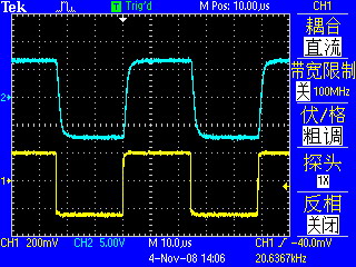

Did not try that one...
Just changed the Rl into 2 Ohms and the frequency to 20Khz 😀
Came out like this...😕
Ignore the circuit picture.
It is my free graffiti. Not really circuit diagram.
The actual measurement.

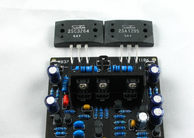

Hi guys i've built this amp and it is great!!!
I want to ask can i use a pair of 1943 5200 instead, and if yes am i going to get more watt from this amp?
My tranformer is 2*34v ac.
It can use many transistors. Including A1943 C5200
Of course. Can also be this. Smile.

Hi LJM,I design the amplifier. Named MX50.
The reason is I put it in the design of 50 w eight r amplifier.
So it's circuit for more than 50 v dc.

I'm glad to discuss with you.
MX50SE MX50X2 and they are not the same circuit structure.
I can purchase all kinds of transistor. Of course, their prices vary widely.
I choose, performance and sound close to, but to sell the lower model.
Their prices vary widely, but using the difference is not imagination in so big.

From my test results.
MX50SE work + - 30V DC 4 ohm impedance is not a problem.
At maximum conditions, it outputs a voltage of about +-28V, 4 ohm load. You can get about 100 watts power.
MX50SE recommend not more than 100 watts output power.
So that we can calculate.
It is the next 8 ohm load, it is recommended voltage +-40V.
4 ohms, recommended voltage +-28V
2 ohms, recommended voltage + - 20V
Transformers suggested more than 250VA, stereo.
Under transformer power remains unchanged, the lower the voltage, current increases.
Reduce the voltage, increase the current, is a method to cope with low-impedance load.
Of course, the power output is always close to it. If you need a low-impedance greater power, you need to select the parallel transistors. Or more power transistors. They are always more expensive or larger volume.
