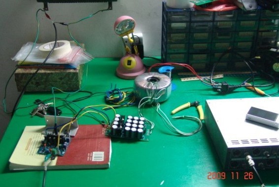

Greeting, I received my MX50-se kit today and stuffed the cards. I now need to mount it to my heatsink. I'm using an old Radio Shack receiver for a chassis & pwr supply. +-43VDC. What size tap do I need for mounting screws for outputs. I have the old mounting screws, that are metric fine thread. The mounting hole looks to be 3mm. My taps on hand are too big. Hopefully I can buy one tomorrow & keep progressing. OK, I'll be updating as it happens.

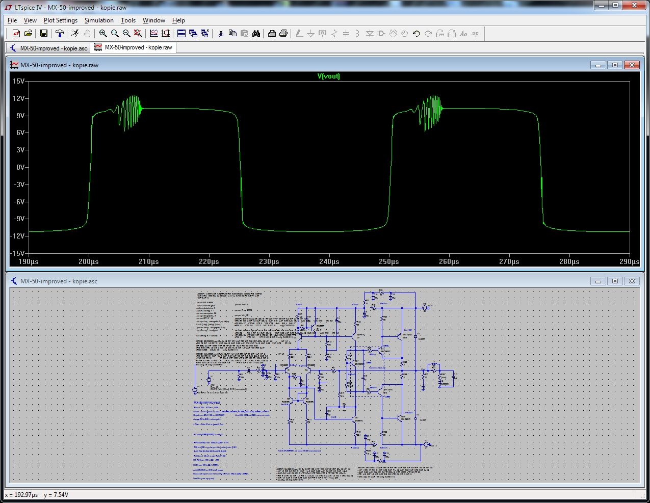

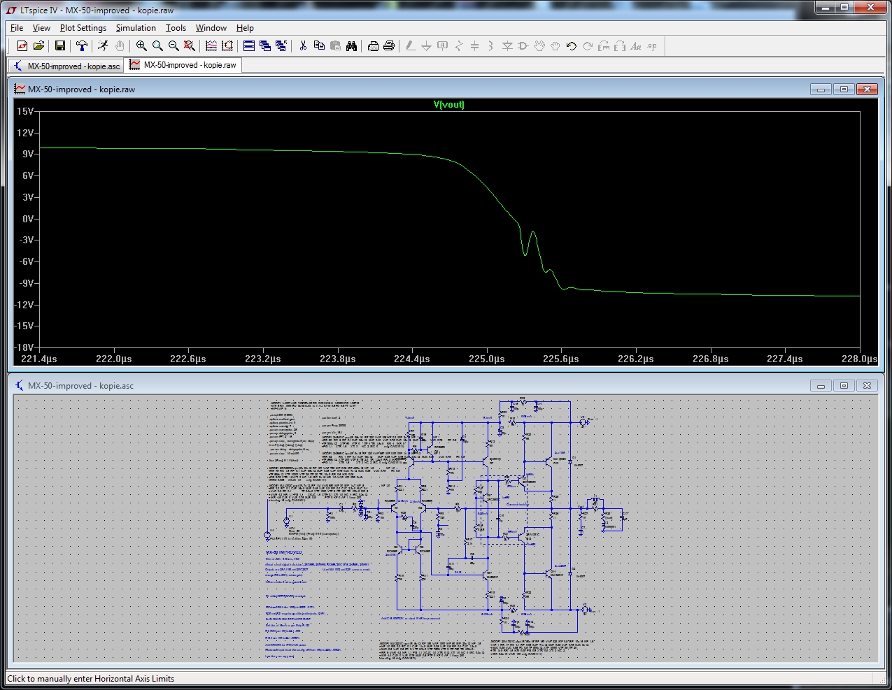

Be sure it is still stable. With a 4 Ohm load, be sure you don't get any issues at hard clipping. Then put in a square wave ( half a volt will do) to be sure you are OK. Unless you are driving an 8 Ohm resistive load, you could be in for a big unhappy surprise. I go for 2 Ohm resistive load as a fair margin considering an 8 Ohm speaker is about 6 and it is a complex impedance. I have been trying to work up a realistic "bad" load.
Reducing the compensation does really make a difference, but you may find you have to jack it back up for stability.
If you can get the Tian probe technique to work, better test. I also look at the AC zero gain point and then put in a AC at that freq ( about 12 meg) and look for peaking in the AC test.
To get the square wave to work, you have to bypass the input cap and short the LF feedback cap

Did not test for stability yet. I certainly will. Actually it was one of the questions I asked myself reducing the values of some capacitors. It sure made the amp faster, but what about stability and oscillation issues? :(
I, however , am quite sure of the modifications on the input differential stage. The little tweaking on the current-source made some difference in the THD figures, as well as the emitter-resistors of the lower transistor pair.
I did check on clipping. I did not mention raising R6 to 720 Ohms. Output 20Vpeak and no clipping.
The 68pF's, with the Q7 emitter resistor, appear to be an optimum value (under these conditions). Distortion drops some further ten- thousands of a percent.
As far as I'm concerned about .005% (at, about, full power and 20Khz into 8 Ohms) is about the maximum this design yields. Quite nice.. ;)

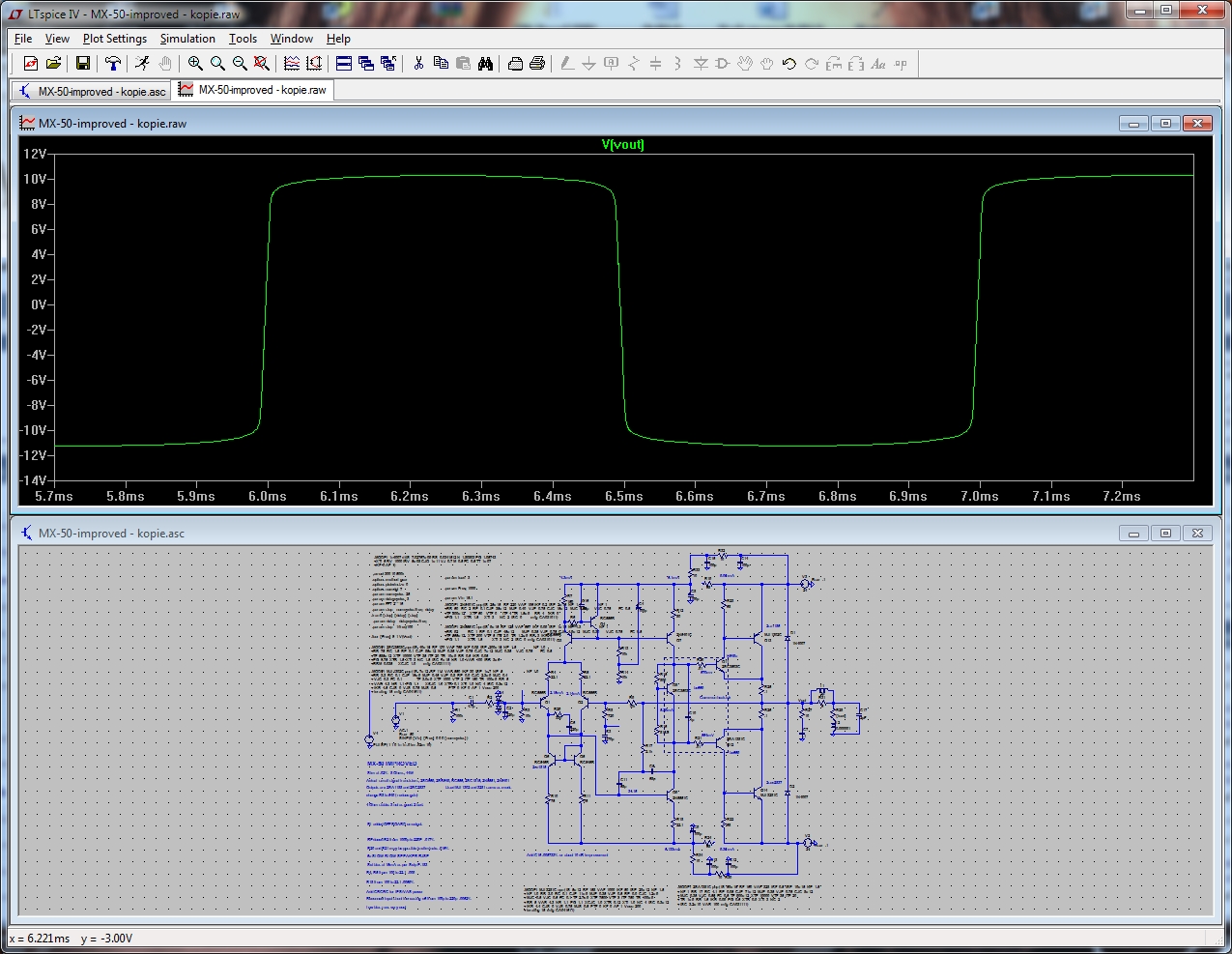

Just tried this one:
Load : (3 Ohms in series with 4mH) // 2uF (= shitty loudspeaker :cool:)
Input : 1000Hz @ +20db clipped with 2 diodes
Result : a nice "squarewave" with perfectly rounded top/bottom and an approx. -.8V offset :h_ache: but further no unwanted symptoms...

We look at 20K as that shows us how fast the knee is rising. In my speaker building experience, I am also concerned with the first couple of harmonics that land above 20K as they excite tweeter breakup. 20K right below clipping is a worst case calculation.
The goal is not so much the number, as anything below .01 is probably more than good enough, but how it behaves. How it approaches clipping. How it recovers. Is it consistent? These are the secret sauce the experienced folks know we don't learn just from simulation. Number chasing gives us the lifeless "transistor" sound of the 80's Japanese receivers when numbers were for bragging rights. Look at the FFT and see how the higher harmonics fall away. Do they steadily decrease, stay about the same, or actually rise? Lower the freq of the test signal and see what lands in the 2 to 5K range when yo hit it with clipping in the bass. Here is where you are not looking at absolutes, but comparison between simulations with identical FFT parameters.
Chasing the number, for a given topology is useful. Look at all the currents right below clipping into a low load. Be sure you are not starving something, like the driver base. Go back and do the noise simulation after changing currents to be sure you did not trade one problem for another.

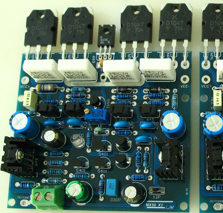

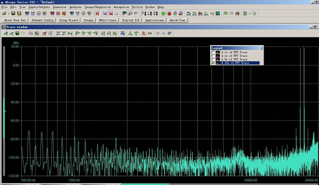

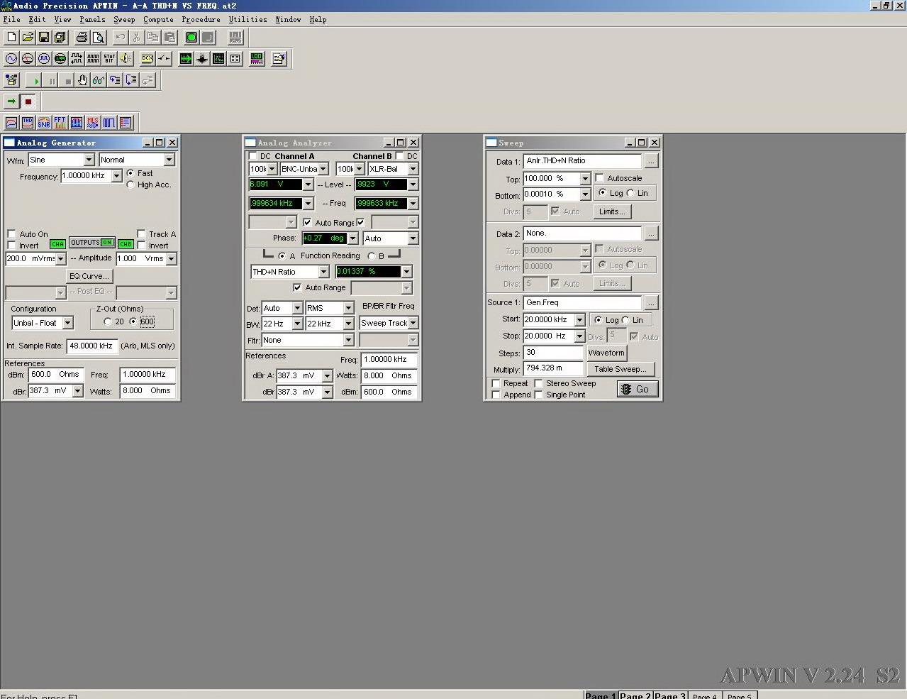

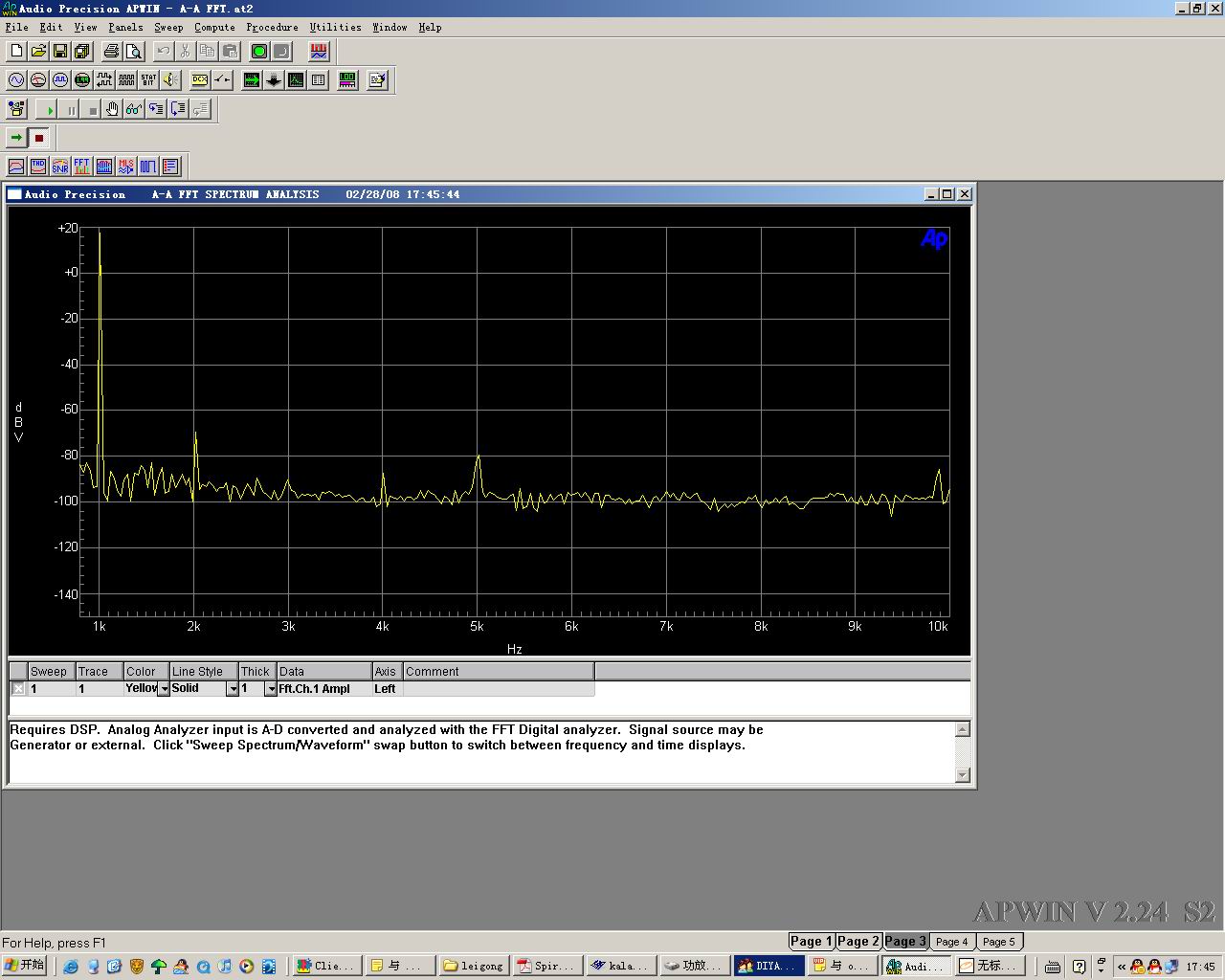

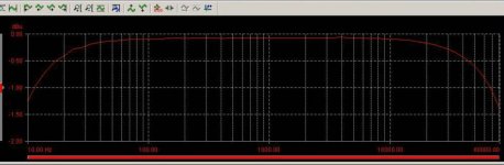

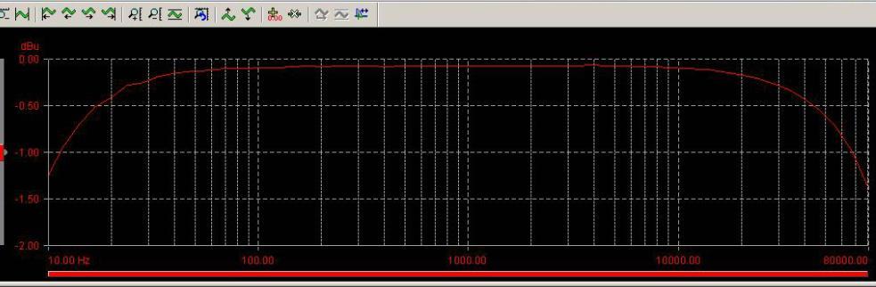

About MX50X2 test pattern.
The original design MusicalFidelity X-A50
It is a quasi complementary amplifier.
The name is very similar to MX50. But different circuit.
MX50X2 TEST: AP SYS 2700
