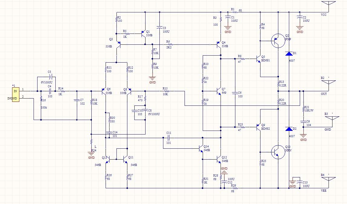

Any bias adjustment would depend on what current you calculate from the voltage drop across the output emitter (or rather collector here) resistors, R13,R20. It may only be a few mV, so measure voltage instead across both resistors in series, using the total 0.44R value and of course, Ohms law. Make certain that there is no signal or load connected when making DC measurements like this.
A CFP design should have around 13-20 mA bias current for optimal class B operation but it might be interesting to learn what LJM thought was optimal and what substituted transistors like your D1047/B817 copies could sound better with. I suspect they are nothing like the original specified transistor types (Sanken 2SA1186 and 2SC2343) or even original Sanyo 2SD1047/2SB817.

I'm surprised the bias current is only a small fraction what it probably should be. I've linked a schematic posted at #4, assuming it's still applicable to your kit. http://www.diyaudio.com/forums/atta...771d1343053135-ljm-mx50-kit-amp-schematic.jpg
Locate and check that resistors R10, R22 & R19 are the correct values in their locations so that the voltage divider formed can set the right bias current. If necessary, measure the resistors in position with the power off. Are they in the same positions and giving similar current in both channels if you have a stereo pair? What is the voltage across C106 or between the bases of Q5, Q9? It should be in the region of 2.7V if those transistors are in fact darlingtons as shown on the schematic. If they are other than darlingtons like BD681/682, that could be the problem there.

My reading across the 105 cap is 1.3V. The 2 resistors off either end of that cap are 1k and 100 ohms. It's a bit tricky to trace as it is difficult to get to the underside of the pcb without dismantling the amp. It appears there are many diff values and components on this board (MX50 se version) compared to the original schematic.

OK, here is the SE version schematic, or rather a reverse engineered one borrowed from this thread: http://www.diyaudio.com/forums/solid-state/273821-mx50se-ljm-2015-a.html

I suggest you read that short thread since you have the SE version and the question has been raised before. Thanks for the hint, mt490, you're right about those generic copy D669/B649 transistors. They also are available cheaply as D667/B647 in a TO92L package and they're everywhere because they're all quite cheap and probably sell on the reputation and similar logo to the very popular original Hitachi/Renesas driver types.
As the drivers aren't darlingtons, the bias voltage across C106 should indeed be around 1.3V, so that's OK for a CFP output stage but are R21,22 both 1k? It would screw up the bias current if they weren't but you still could need to trim the resistors as shown with an additional 68R in the MX50 schematic, which likely increased the current to a more correct level.

The emitter resistors are most likely 0.22R and the normal CFP bias for those is ~13 mA. 11mV would be on the low side according to Self so I don't think there would be any problem. In a very good low distortion design, 13-20mA will give lowest THD and sound excellent. In simpler designs where THD is higher, it seems you can use higher bias to advantage and as you say, the P3a is an example of that approach and a high bias of 70 mA is recommended - the sense transistor is not attached though and that changes the thermal compensation slope considerably.
Driver operating temperature range is important in CFP designs. It provides the thermal compensation slope and thus controls thermal stability. The driver current varies with power so it's not like an EF stage where the driver's own bias current holds its temperature virtually constant and you can almost do as you please with the fixed driver bias - assuming they are not attached to the output transistors or their heatsink.
Depending on where the temp. sense transistor is mounted, bias here should be running close to the designed range of current for safety reasons at least. From previous experience with LJM CFP designs, he uses 10 -20 mA with 0.22R and I'd stay within that range unless he suggests otherwise.

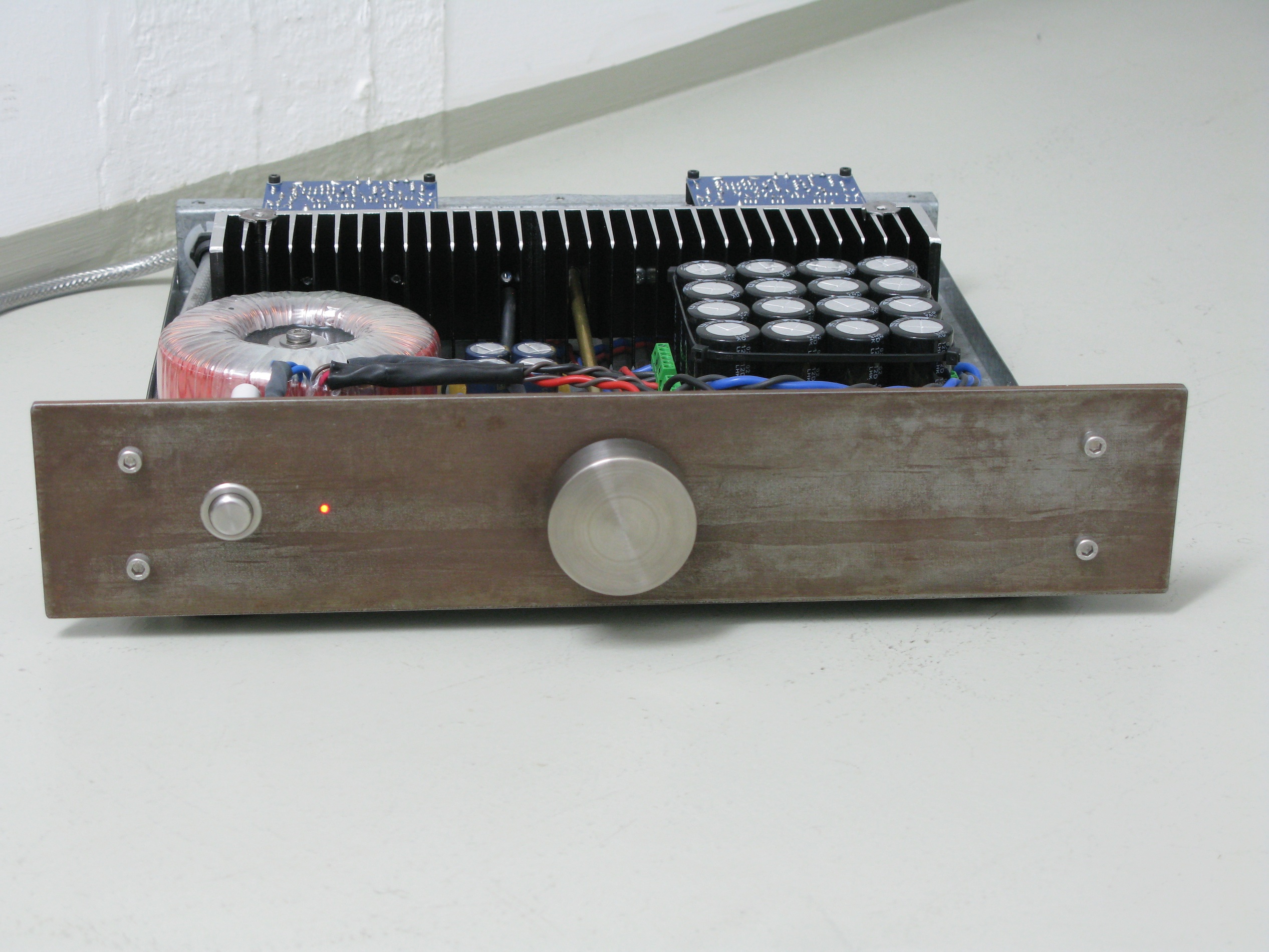

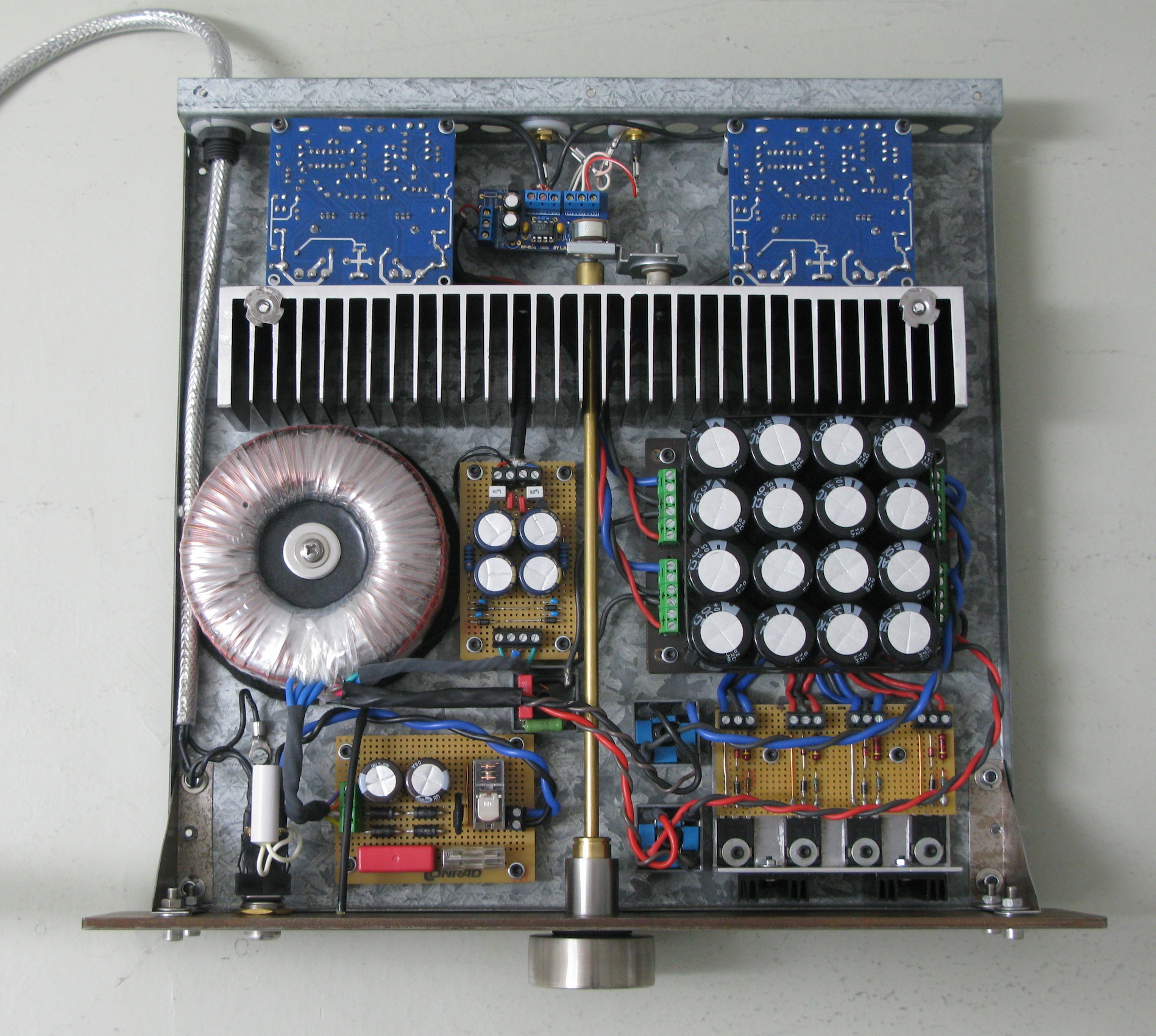

my MX50SE
i did this amp a while ago for my friends desktop.
since i wanted something different for the front i decided to take corten-steel
that was bathed in bathroom-cleaner for a few hours
and then dry-cloth-polished: fantastic stains!.
the volume knob is an abused v2a doorknob.
great amp; thanks to LJM!

Nicely built, looks very organised. Did you compare the sound quality with any of the commercial offerings?
Regards
Bilal
