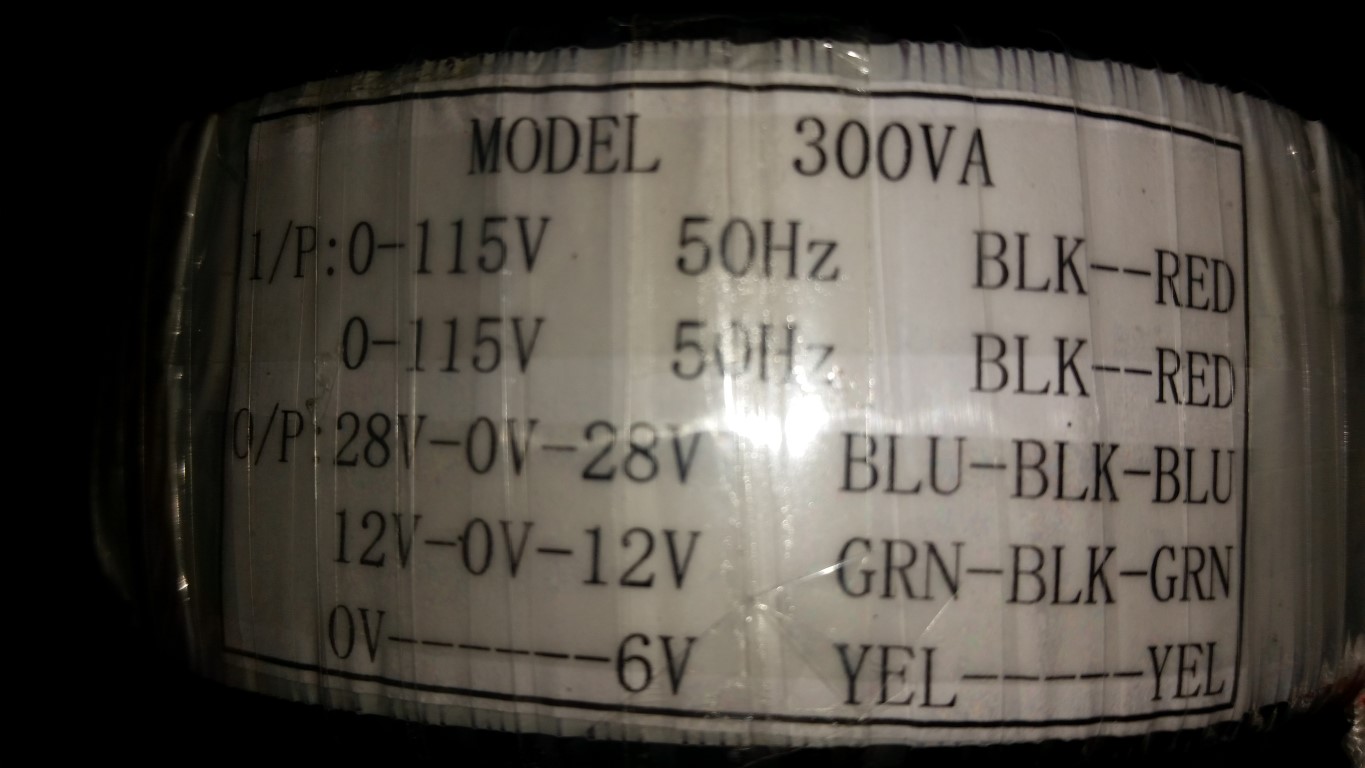

Transformer questions
Help Please! I may have received the wrong transformer. 😕 I swear when I ordered it the specs said 115-0-115 input with secondaries as stated on the label. Can this transformer be used for USA 115v and if so how? Any loss of output? A giant thanks to anyone that can help. 😀
Okay I answered my own question so I'll add the basic information to help anyone facing the same situation feel free to correct me if I'm wrong.
Dual Primaries: connect in parallel, red to red and black to black for USA 115v then the red goes to Hot/black on the mains and the
black to the neutral/white on the mains. 50Hz windings can be used on 60Hz but not the other way around.
