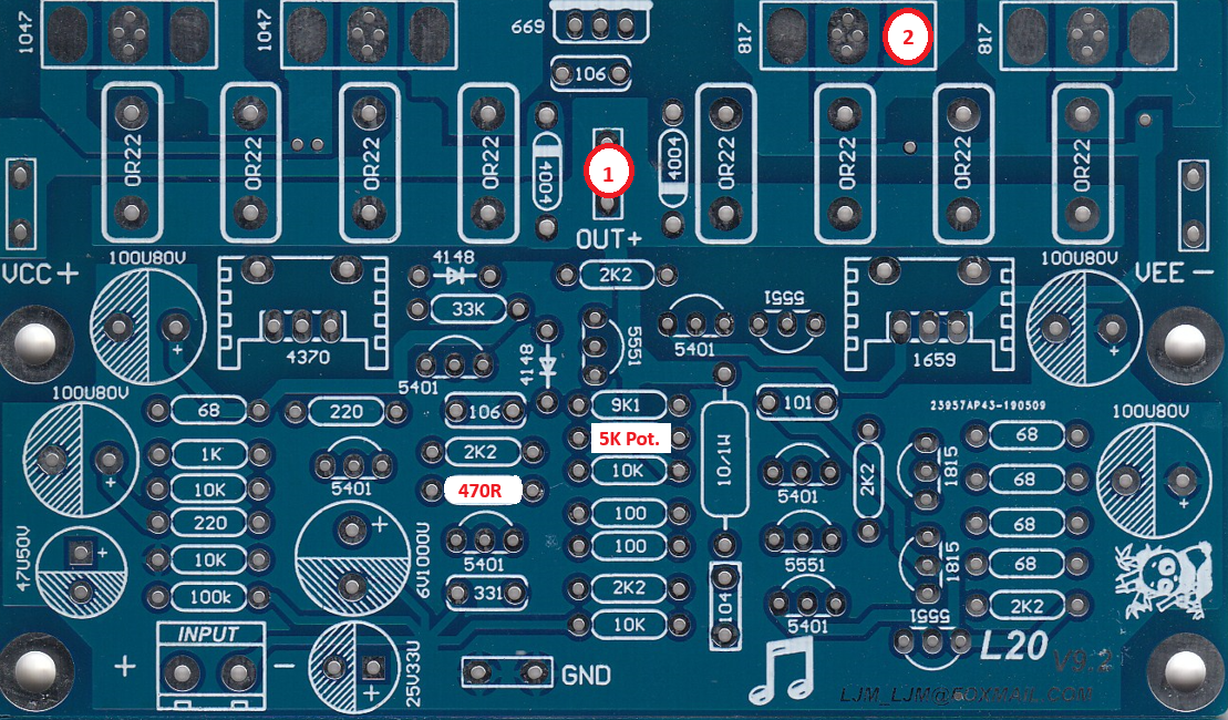

Here is the complete mods that can be done on the 9.2 board itself.
Caution with Rb2/3/4/5, they will increase the temperature of TR2/3/4/5, check them.
Super caution with the green mod.
There is no room to add a Cascode to the VAS.
To achieve the NSCB operating mode, the output pairs must be removed. Too messy. I do not recommend it.

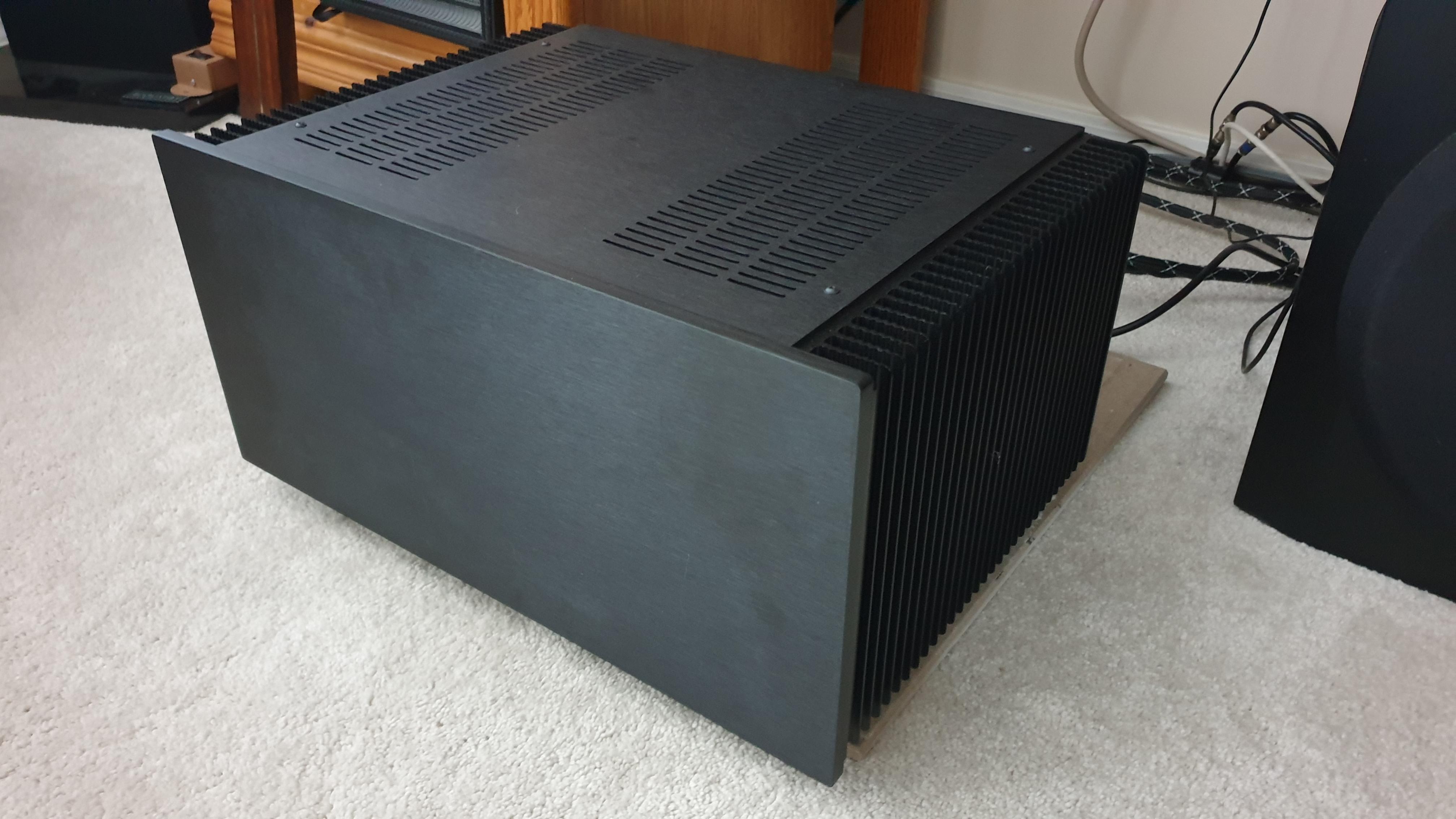

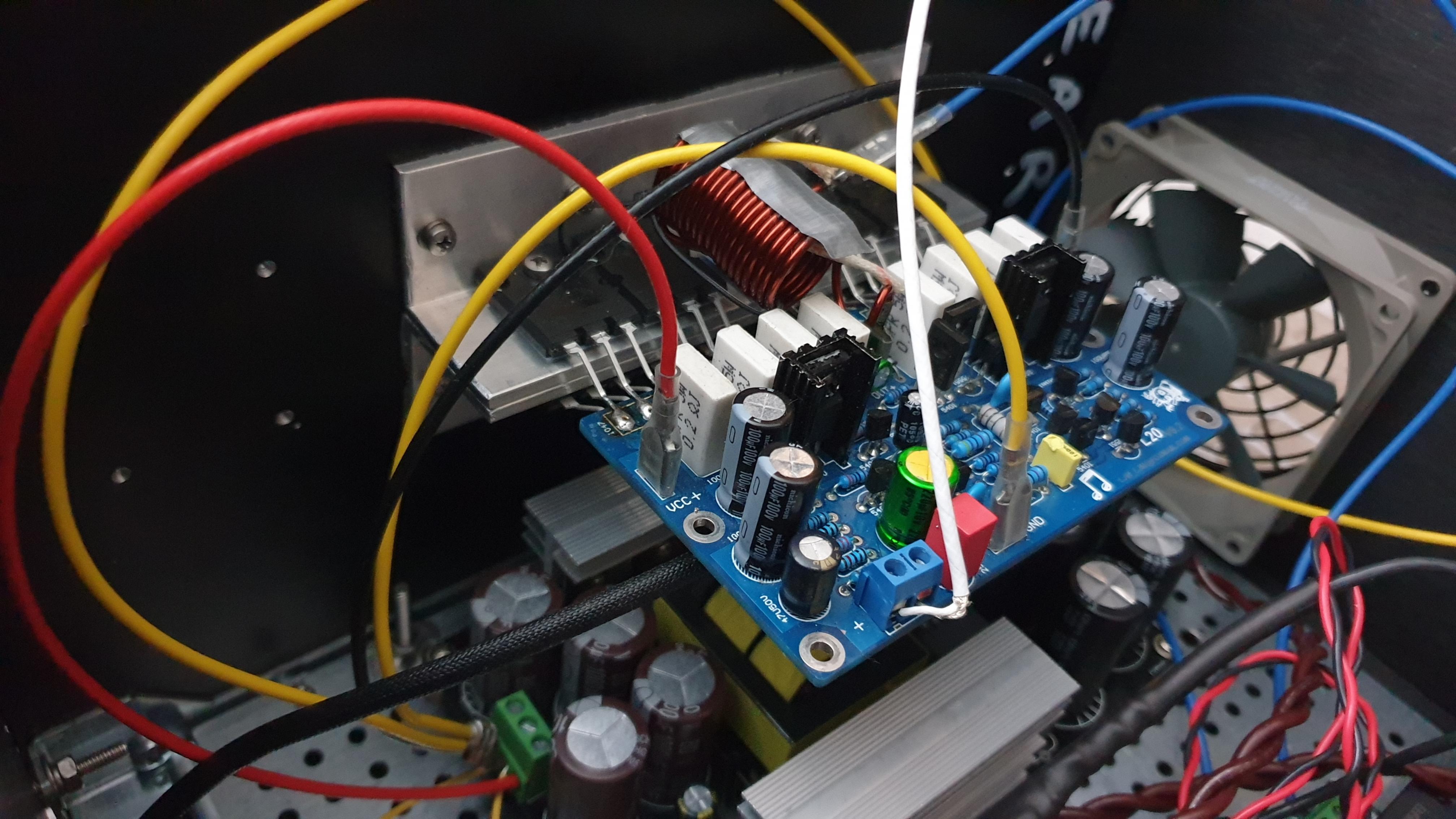

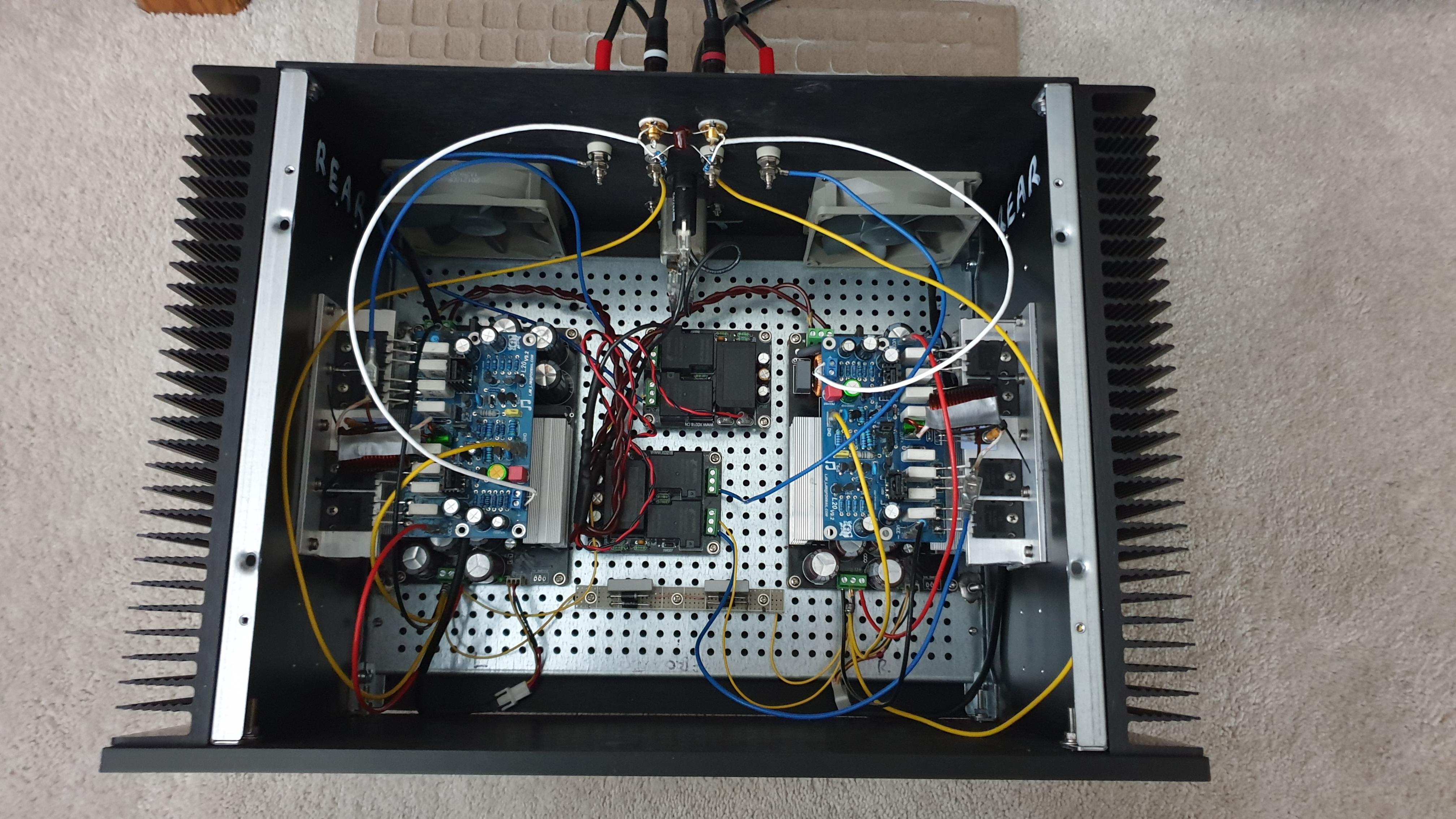

Some months ago I built an ultra-thin version of the L20 V9.2, with a very soft power supply: 65+65Vac 200VA in total for both channels, and a small heat-sink.
I made some mods to the original values: REs 0.1Ohm resistor in place of 0.22Ohm and recalculated the feedback network with 33KOhm, 1KOhm, 150uF NP, in place of original 10KOhm, 330Ohm, 1mF; the input cap was replaced by a poly 3uF one.
I could trim the bias at a very low value, almost B-class, without cross-over distortion.
The amp was good to be my lab amp, with 8Ohm speakers, but not able to drive my Acoustat 1+1, it overheated.

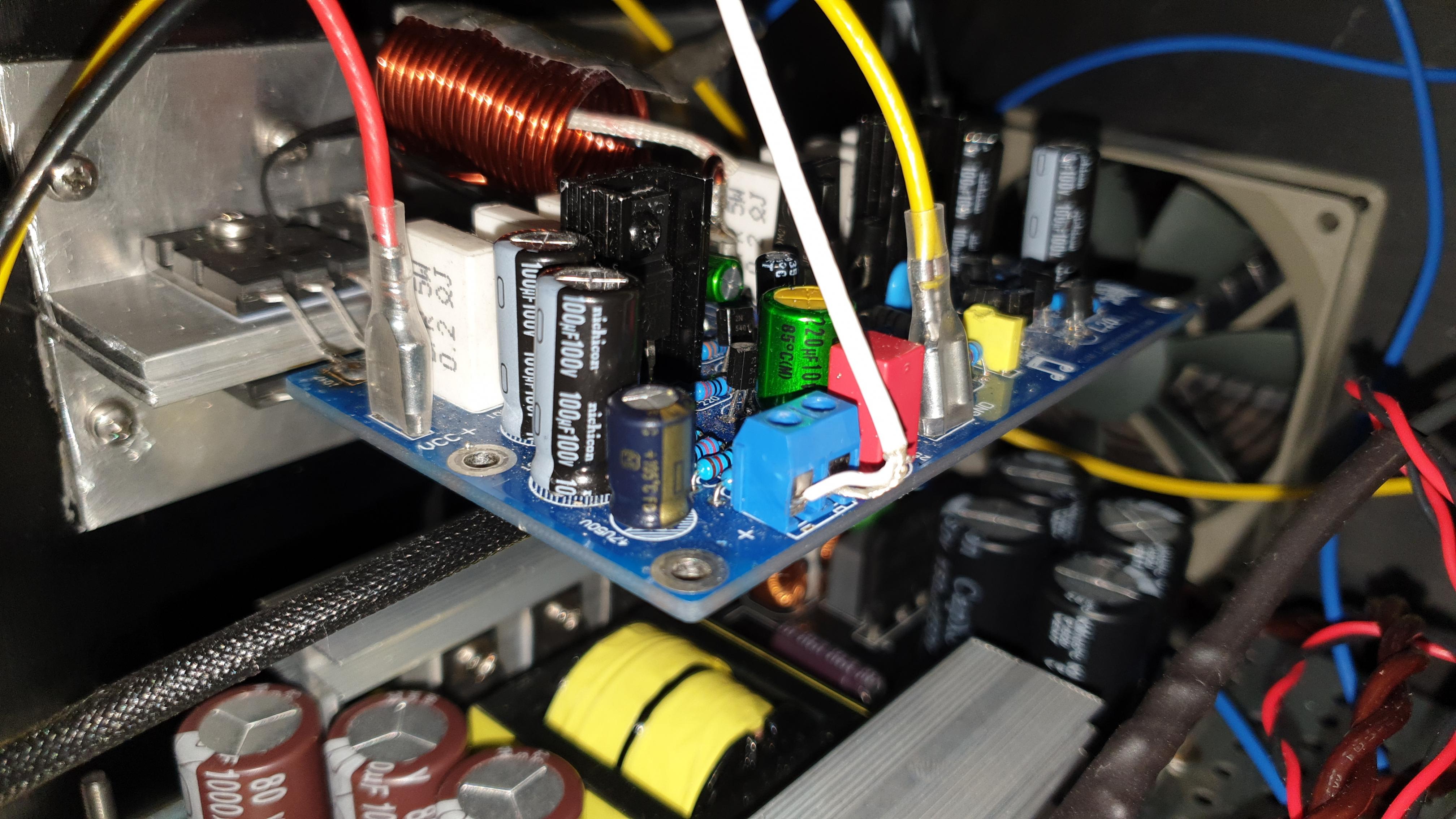

In order to drive my Acoustat 1+1, I decided to move the two boards to a bigger cabinet (HiFi2000 "Dissipante" 5U/300mm), and build a dual mono amp using two LLC Switching power supply +/-70V 1000W (eBay) and two speakers protection board 30A 110/220Vac (eBay), where the relays of each board are paralleled to serve one channel. I doubled the aluminum angulars in order to achieve better thermal conduction from final pairs to the heat-sink. The cabinet is connected by a dual ground coupler to the central 0V of each channel.
The two power supplies are very tough, and the first happening, after raising the volume, was the blowing of two final transistors, a PNP each channel. So I decided to put in place again the 0.22Ohm REs and to insert a 2.2Ohm resistor between the driver's emitter and the final pairs' bases. The bias was increased to the original value, almost 140mA total, 200mA for the whole board.

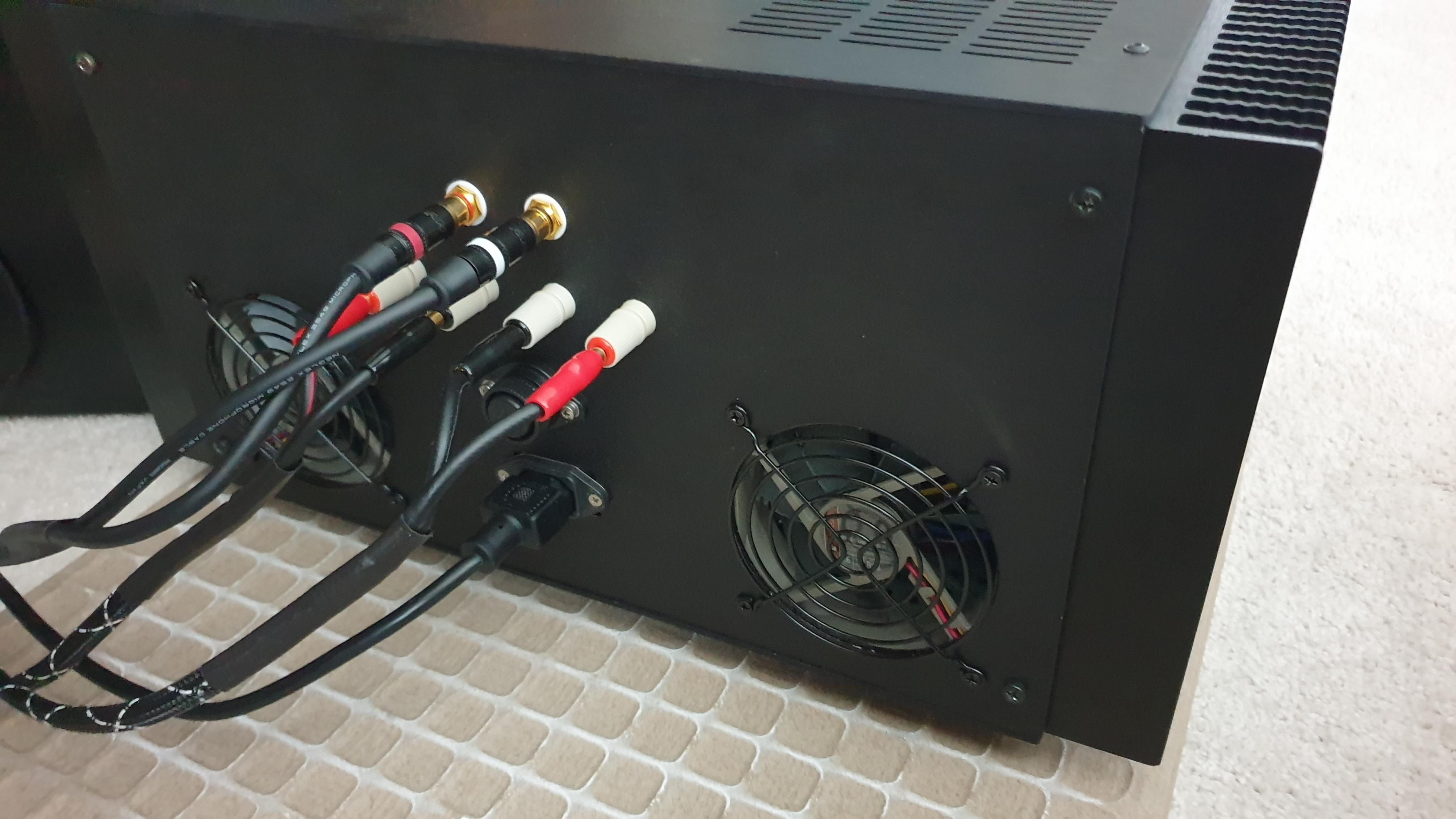

Then, the second happening was the triggering of the thermal protection on the power supplies: they have two heat-sink each, with horizontal fins, that is not a good idea, in order to dispose of the heat. The triggering happens even when idle, once the cabinet is closed. So I put in place two 92mm fans (Noctua Redux), powered by the 15V outlet of each power supply, crossing a 150Ohm resistor. Now, when idle, the whole cabinet is almost cold, and, when listening, depending on the volume, the thing warms up but never becomes hot.
The result: despite the switching power supply, I must say I love the sound, clear and authoritative.
BTW: I changed the final pairs to MJL3281A/MJL1302A, but just because I had some in my drawers.

Thanks for your appreciation!

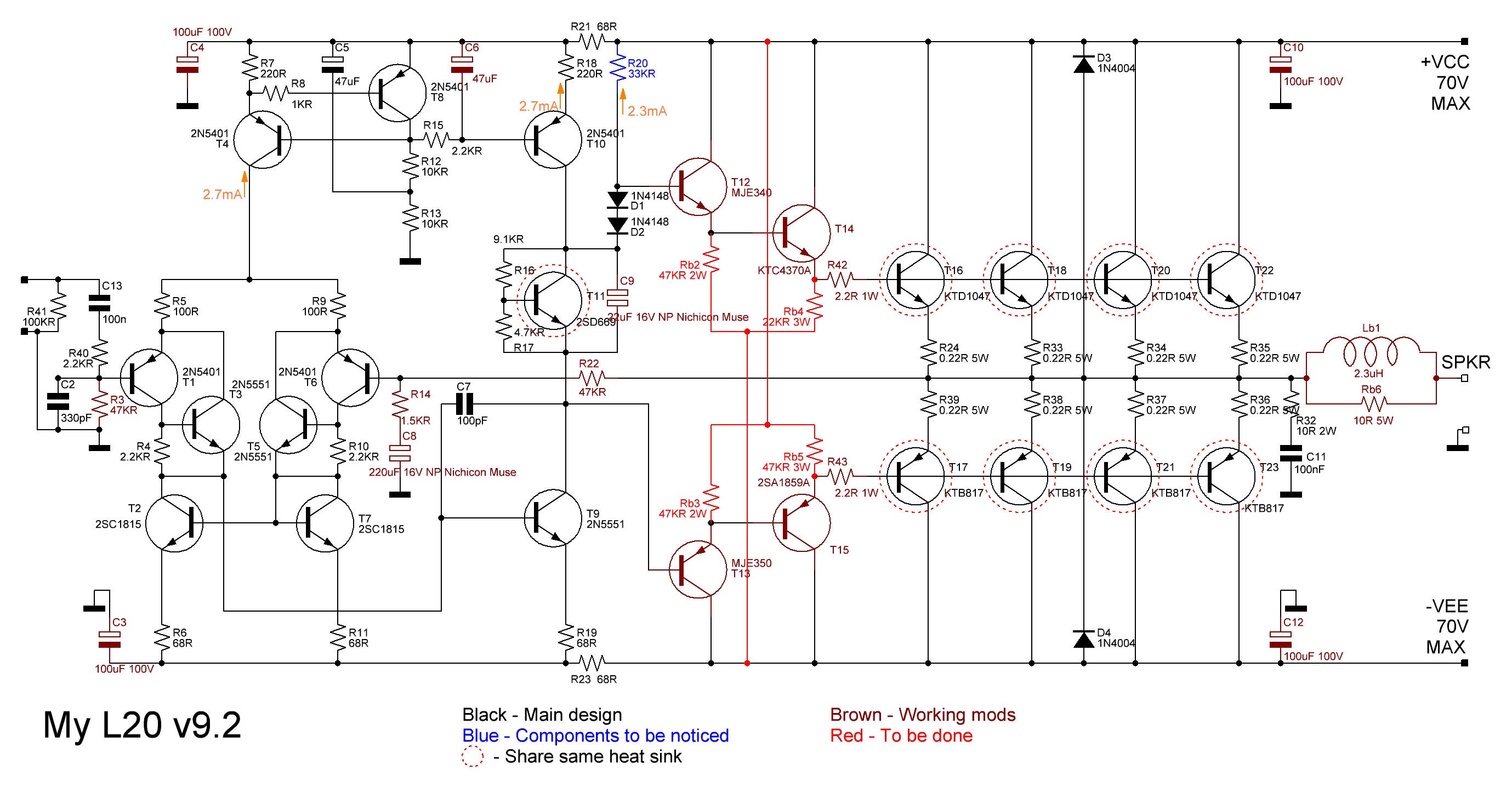

This is the schematic which I missed posting last time. The brown items are the mods I made, the red items are to be done when I have time.
The L20 is connected to the Audio-TV set and is on almost the whole day; its temperature is very low at a normal listening volume, almost cold with the two fans.
I learned that fans are mandatory in a power amplifier to let the inside cool down.
