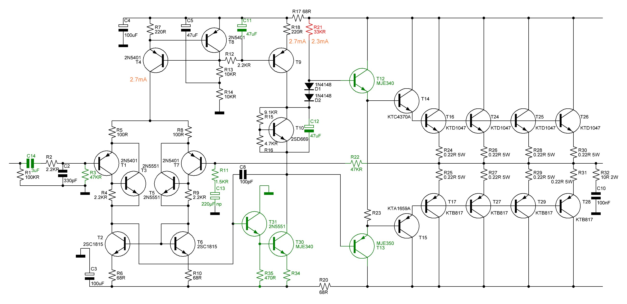

Adding a buffer to the VAS
Hello,
first of all I have to say I like Douglas Self's theories a lot and the modification I made were inspired by reading DS.
I'm working on the 9.2 board.
I just finished to assemble two couples of L20 V10, one couple is almost untouched original, I modified only the Re's by putting 0.1Ohm in place of 0.2Ohm resistors and added a 0.23uH inductor bypassed with 10Ohm 5W resistor; these boards are powered with 126V 240VA total for both channels (very soft, weak power supply), the result is no bad at all for a main analogic amplifier only one unit high.
The second couple of boards is like the first one but I changed the final couples with 11 (per channel) couples of 2SC3264/2SA1295; these boards are powered individually with 152Vcc, single transformer 625VA. Very impressive, the sound is very good on the Acoustat 1+1 Mediallion Mod.C even with zero bias. By the way, I had to add a 47pF silver mica capacitor paralleled to the 12pF Cdom, the field generated by the Acoustat lead the board to auto oscillation.
I think the old version 9.2 should be better that the new 10 one, that has two less transistor, i'm sure they removed the two Sziklay CFP leaving in place just two regular transistor. I modified the V9.2 essentially in the VAS by adding a buffer. Take a look to the schematic, the green components are those I modified. So far I could test only one channel at time, stable a 135V and it seems ok. If everything is ok I will replace the V10 boards in the big main amplifier. Did anybody try to add a buffer to the VAS? You could add a cascode too but there is no space on the board and the pcb tracks are so delicate that it is very easy to damage them. So, no cascode for me! Everyone noticed that the VAS is loaded in an odd way, I think the 33KOhm resistor does not limit the swing, just reduces the amplification but enhances the open loop bandwidth.

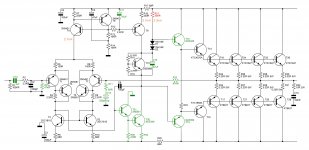

Hello,
In your Darlington VAS modification what is the value of R34 that you used? (It is not marked on the schematic.)
