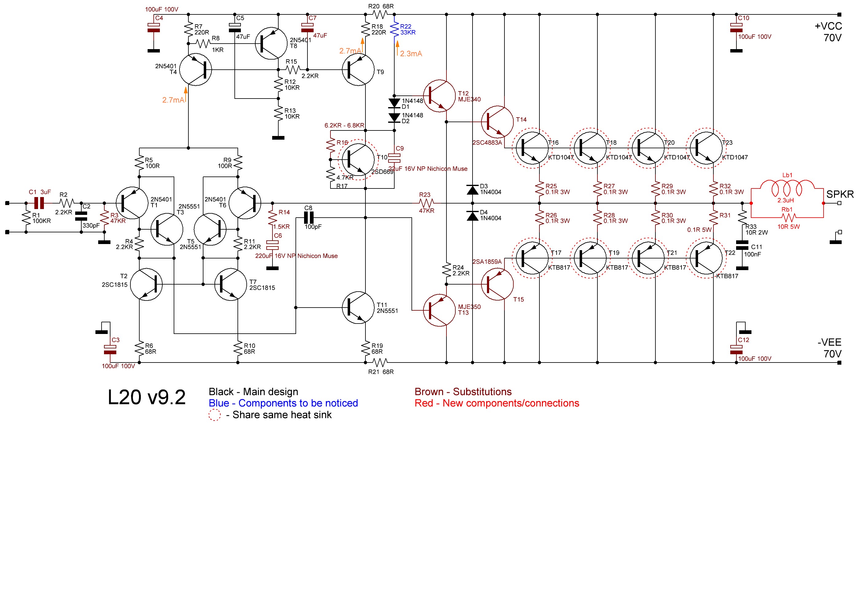

the value of R34 is 68Ohm.
Do you recall where you connected the ground for T31 when you made the modification and added the MJE340 (T30)?
I soldered a wire on top of R3's gnd side. R3's original value is 10KOhm.
Be very careful when modifying, the copper tracks of the PCB are very very delicate.
To power up the assembly for the first time, you should use a variac!
The mod enhances the V9.2 performances and, in the V10 (no triplet output), it is mandatory, if you want to obtain a HiFi amplifier.

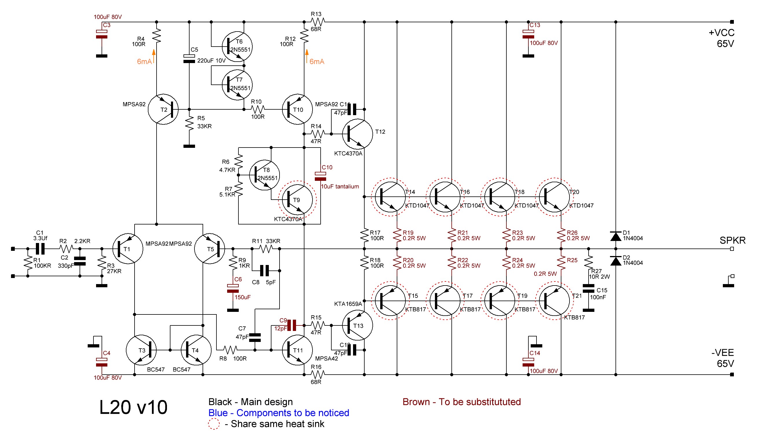

The only good thing in the V10 is the xVbe, all the rest is really bad compared to the V9.2, which is a "state of the art" design of asymmetrical - with feedback amplifiers. Both versions can work up to 140V.
Check both the schematics and you will notice that V10 has no more triplets in the output stage, the differential front-end is no more made out of Sziklai couples and degeneration resistors were omitted.
Do yourself a favor, see if you can change your order.

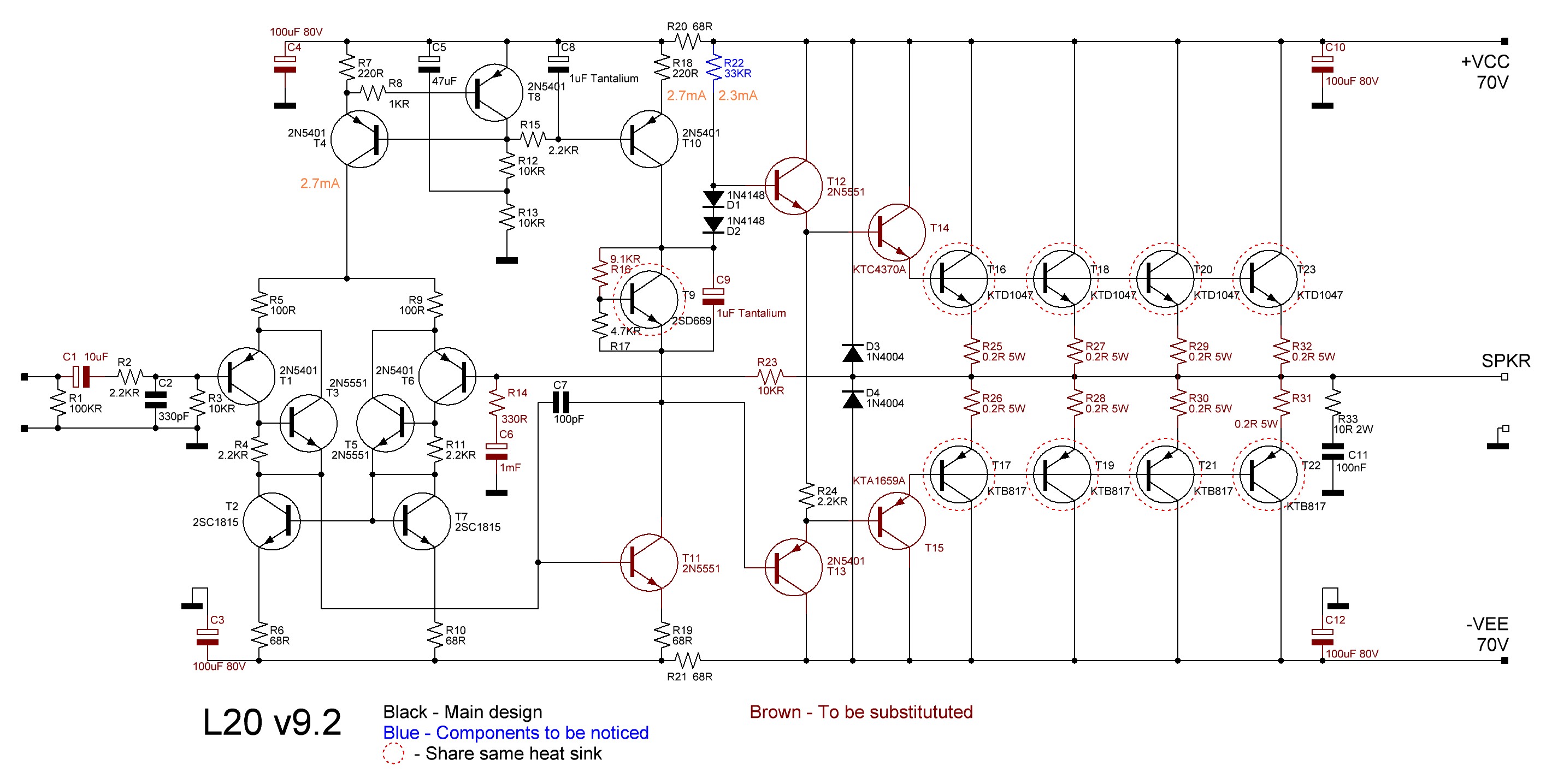

I suggest some mods to the V9.2, you see in the schematic. The mod on R16 has the purpose to have a lower bias, because I lowered all Re from 0.22 to 0.1Ohm. Never use a higher bias than the needed one (read D.Self), there is no pro, perhaps some cons.
You can ignore all transistors substitution, the originals are good. The L is 10 turns of awg14 on 1" diameter.
This will be one of the best diy-able amplifiers based on feedback.
140V-200W/8Ohm.

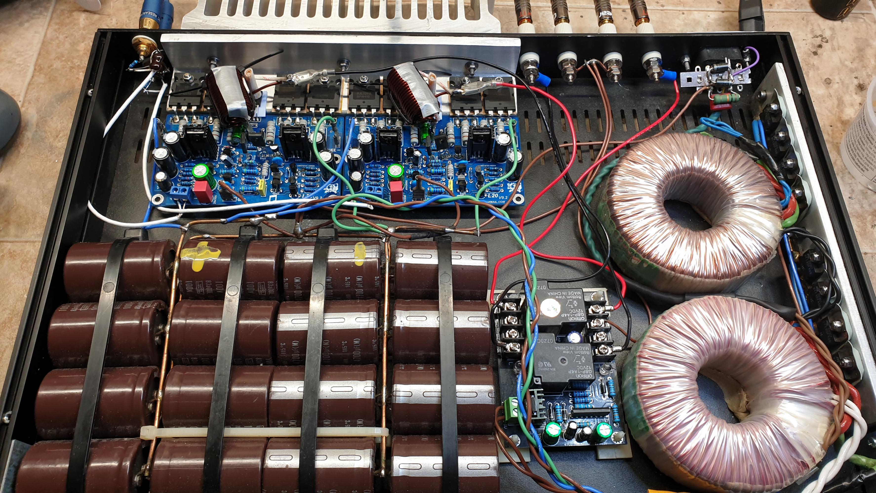

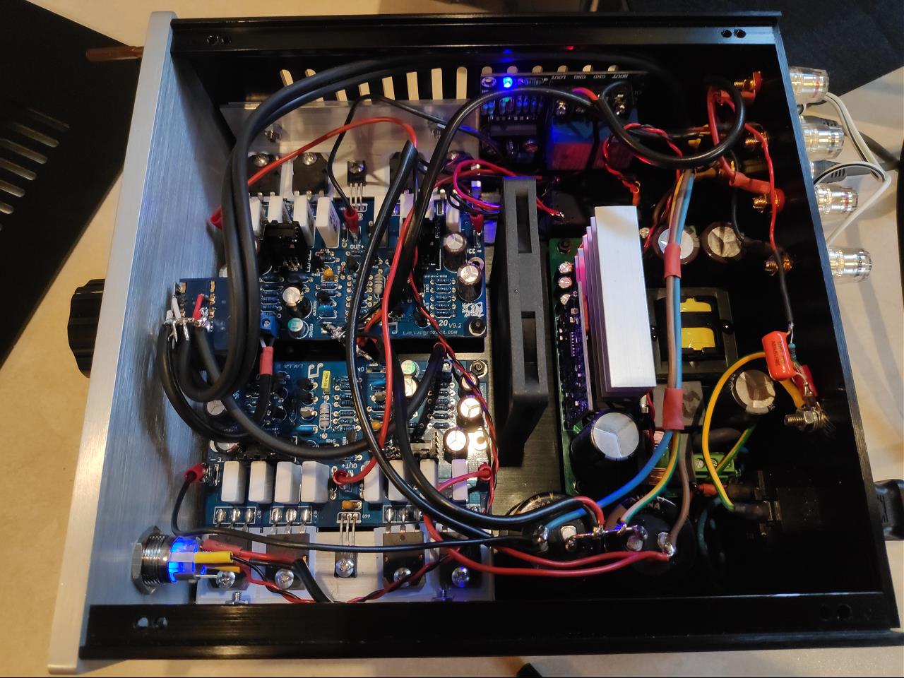

Take a look at mine. The heatsink is too small but for normal level listening, it's ok.
The two Ls were recalculated to have a smaller diameter.

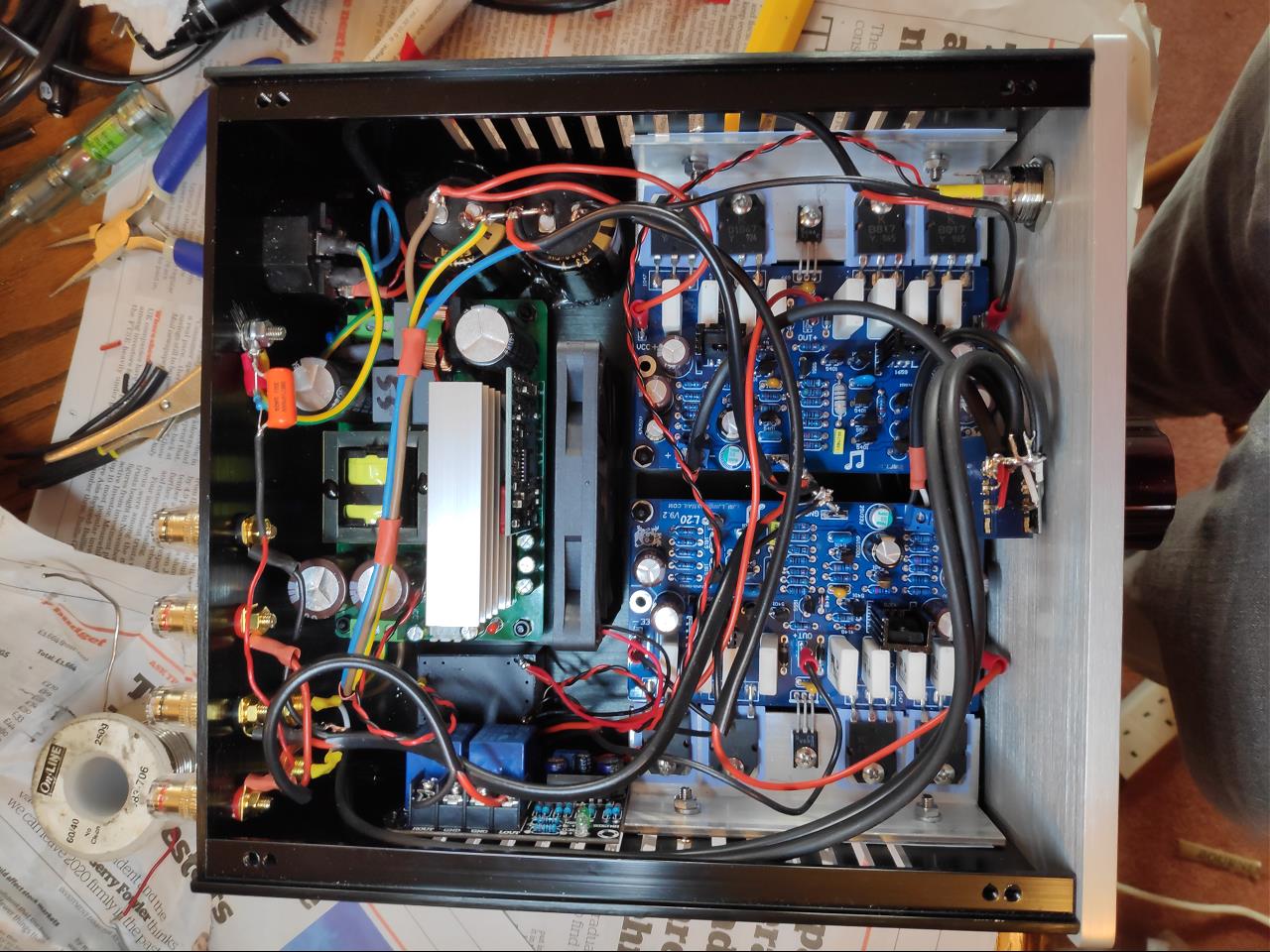

Hi Marigno - an interesting construction - I guess two power supplies? Ive attached the Mk1 version of mine again - Its a deeper box and by luck the slots in the case act as fins when the fan blows. I changed the fan to a quieter one that is fed all the time via a resistor so that it is even quieter. I found that the amp under normal conditions hardly changes temperature. I have a 50C thermostat on the power supply heatsink - that would switch on full fan power. This would not be audible at about 100dB in the room! A friend of mine wondered if a small inductor should be used on the output - maybe. I'll keep the output quiescent at 90mA as I'm not sure how the hfe of the output transistors drops off at very low currents. Certainly heat is not an issue. Jo
Also another point - I notice there are no Base-Emitter resistors in V9.2 - see R17, R18 in V10. To add even 220R B-E resistors to V9.2 should be easy and not add too much dissipation to the drivers - though they are only 2W ! Perhaps 470R is better than nothing at HF.

The poor L20 does not accomplish to drive my Acoustat 1+1 but drives well other traditional speakers, even if the power supply you see is greatly undersized (0.83x), it is not a double one, it is made out of 2 transformers 42V/100VA each, 200VA total for a total output power of 240W both channels, if you do't ask too much, the amplifier has a super-wide dynamic range.
But, if you use a 2x sized power supply, you should have no problem with any load.

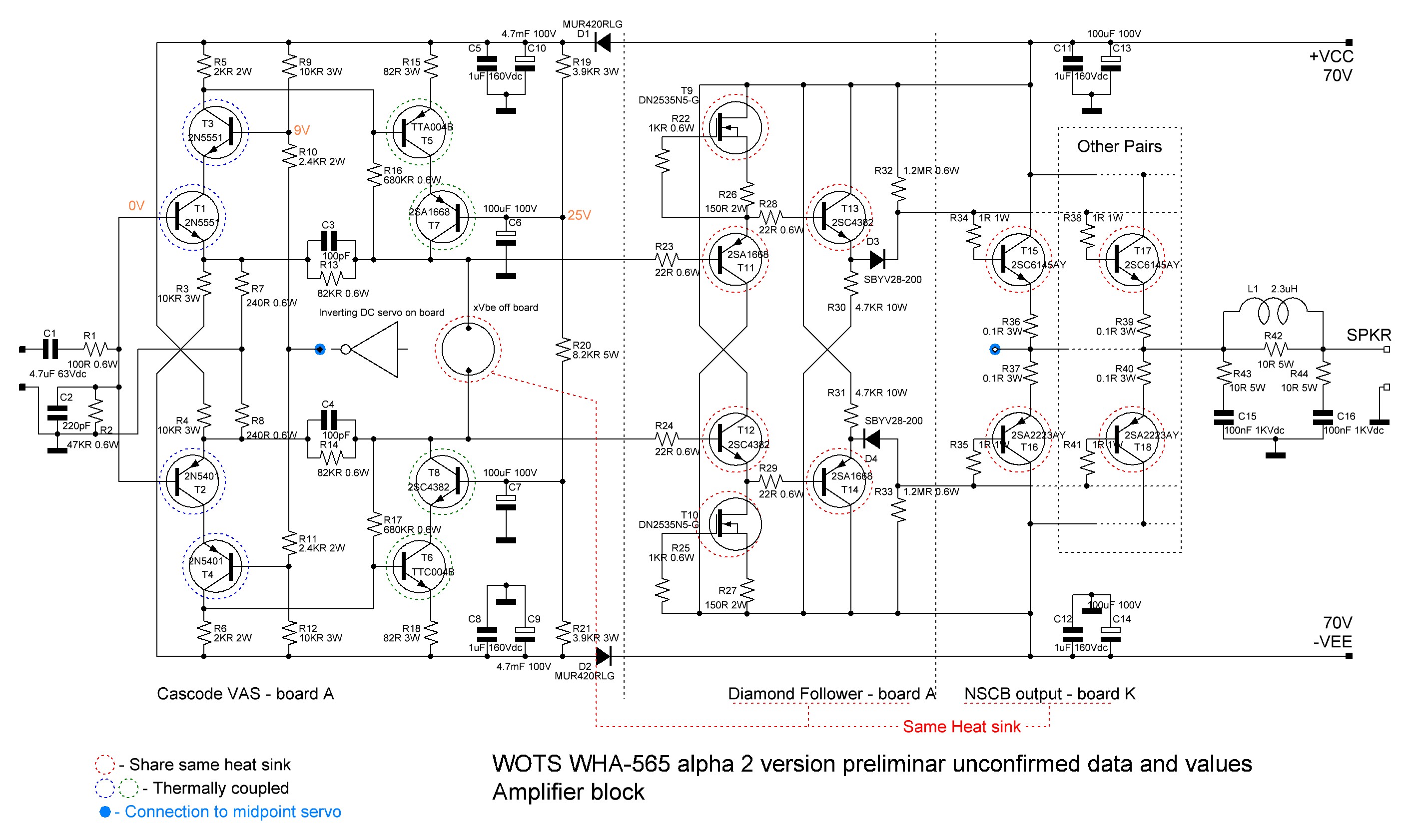

I must answer by posting another scheme where you see how all is working in A-class except the final pair, working in NSCB.
If you want to improve significantly the triplet you should put a couple of resistors from the emitter of the drivers to the opposite power rail.
The schematic if about a diamond follower but the concept is the same, for the triplet you better use another couple of resistors with the pre-drivers.
But you need to better dissipate both the pre-drivers and the drivers. Try, it is worth! Perhaps with higher value resistors. Even a very high value (in order to not generate too much heath), prevents the transistors to switch off.
