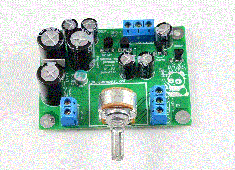

I'm shopping 2 L15 boards from Aliexpress and looking for a preamp without tone compensations following you idea. Do you have any model to suggest-me?You can actually use L15. It is better than L7.
You mean you need high pitch adjustment. Bass adjustment function.
I don't like amplifiers with high and low tone adjustment functions. So I can't recommend it.
If the high tone is necessary, the low tone is adjusted. I recommend using EQ software in the computer.
I'm using a power supply with toroidal transformer with 20000uf for neg supply and 20000uf for positive supply. I think that those capacitors are sufficient.

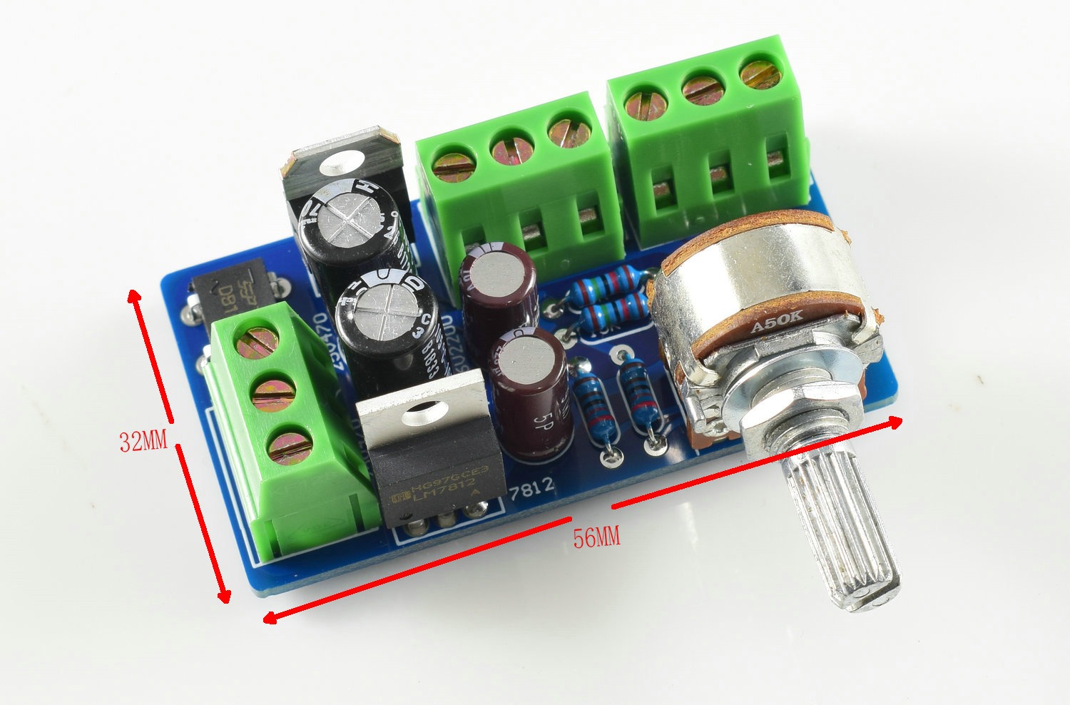

P7MINI pre amplifier is recommended.I'm shopping 2 L15 boards from Aliexpress and looking for a preamp without tone compensations following you idea. Do you have any model to suggest-me?
I found on Aliexpress this item I Think is correct. Below is a link for the product:P7MINI pre amplifier is recommended.
https://pt.aliexpress.com/item/1005...00020375357379!sea&curPageLogUid=v0LaFbEg3wf6

Could you confirm this is last/best version of 9P9 preamplifier?
Thank you
Because each batch of capacitors is purchased. The brands are all different. Photos can't be updated frequently.
Yes, there is no problem.I found on Aliexpress this item I Think is correct. Below is a link for the product:
https://pt.aliexpress.com/item/1005002369425322.html?spm=a2g0o.productlist.0.0.77a726fdncwgZu&algo_pvid=a31a5148-4847-43ba-89b9-5e97a64f55ed&algo_exp_id=a31a5148-4847-43ba-89b9-5e97a64f55ed-8&pdp_ext_f={"sku_id":"12000020375357379"}&pdp_npi=2@dis!BRL!88.1!70.48!!!!!@2101e9d416641419321514773e40b8!12000020375357379!sea&curPageLogUid=v0LaFbEg3wf6
We need to believe in operational amplifiers. That is to say, the technology of semiconductor manufacturers is OK.
We do not need to use complex preamplifiers.

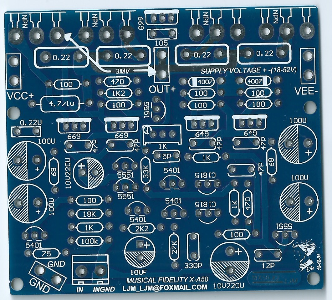

Question regarding the Quiescent Current (Iq) of MX50X2. PCB photos included here. I purchased 4 sets of the PCB about 2 years ago with the Kit, components included. I source the NPN output transistors with MOUSER, the Toshiba TTC5200.
I measure the voltage (as V1, V2) between Output and TTC5200 Collector, and the voltage (as V3, V4) between Output and the TTC5200 Emitter. V1= 5.3mV, V2=5.8mV, V3=6.6mV and V4=4.8mV respectively, after working 30 minutes, input connect to ground while measuring. Before sold to PCB, all Toshiba TTC5200 tested with small current (Ic=6.4mA), hFE seems matched pretty well, 80~88.
Is this measurement ok?
Try match 5401's above 27k in the middle perfectly . This should also optimize DC offset to within a few mV of 0 .
What I measured V1 ~ V4 are Quiescent Current (Iq) over the Re (which are 0.15 OHM on PCB), the Iq value are 35mA, 39mA and 44mA, 32mA. Is there any method to reduce those variance?
Could be slight variation in resistors . 1% resistors could could make a difference . Take reading again , noting position of each reading , then swop the 2 resistors of highest and lowest reading and see if your measurement is affected . Can you post a schematic ?
Matching the 669's and 649's to eachother , respectively , should also even things out .
Swapping the highest with the lowest is a good idea. Thanks@fredeb. The schematic has been posted many times on this forum.
