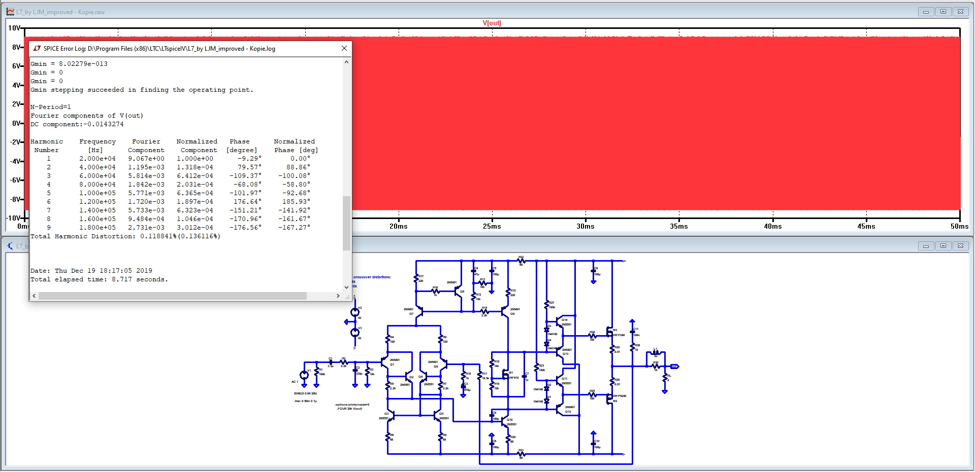

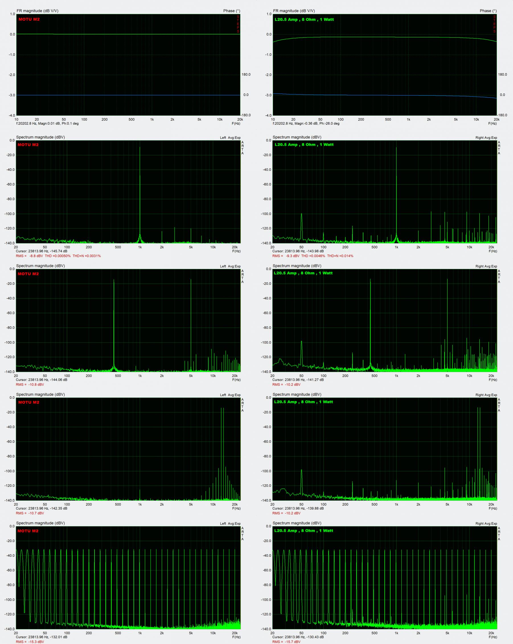

Sorry, it is not "my" simulation. Nevertheless, I am able to reproduce what you did and got your result.
You thought, that you replaced the transistor models by the command .include model.txt
As a matter of fact however, that didn't happen in the program. Because the default models are in LTSpice with the same name, the models were not replaced but the default transistor models got used despite your .include command. You can check it by pointing on the respective transistors in the schematic and then right click. I.e. for the IFPR240 (and the other MOSFETs) it will in your case show the manufacturer as "International Rectifier". However, if the correct models are used, it shows as manufacturer "VishIH1906" as given in the model.txt file.
Therefore your simulation with my file ends up with an enourmous idle current (check it,350mA) so that your THD results looks good at first glance, but is an artefact of the too high idle current resulting from a non adequate transistor model. I pointed to that issue in my earlier post.
I attached the result you would see, if the models were correctly replaced by those from my model.txt
Regards
Reinhard

I have changed the names of the transistor models to avoid mix-up with other models for these types. With the unique names there is no confusion anymore and the right model can be chosen safely.
I recommend to add below transistor models directly into the "standard.mos" file in the "cmp" folder in the "lib" directory of LTSpice. It will then show up and can be chosen with the new unique names listed when with pointing to the corresponding transistor in the schematic and selecting "pick new MOSFET".
I am using now unique names (attachments):
IRFP240VISH for Ian Hegglun's model for IRFP240 dd. June 2109
IRFP9240VISH for Ian Hegglun's model for IRFP2940 dd. June 2109
IRF610_IH for for Ian Hegglun's model for IRF610 dd. June 2109
The result for the modified L7 with doubled NFB (half gain) and higher idle current (attached .asc) at 20kHz, 1W output into 4 Ohm load is THD=0.014% with LTSpice XVII (latest LTSpice version). Input amplitude is 204mVp for 1W output / 4 Ohm.
For the Original L7 (latest Version by LJM) it gives at 20 kHz, 1W output into 4 Ohm load, THD = 0.09%. Input amplitude is 106mVp for 1W output / 4 Ohm. Thus, the improvement with more NFB and higher idle current is very substantial (6x lower THD).
The old LTSpice version IV sometimes delivers a strongly deviating result with the same asc. file and same transistor models and sometimes works correctly. I couldn't figure out, why. The latest version XVII works consistently.
I also found that my first simulations used a different IRF610 model than the one I specified here. All of this contributed to deviations. The deviations however did not change the validity of principal conclusions and countermeasures and the crossover distortion of L7 at lower output unless modified.
Your THD 0.0195% result could be a consequence of running LTSpice with an older software version (not XVII) or it's still using a different model for IRF610 or both.
We see a considerable variation in simulated THD depending on the actual simulation models for the MOSFET parts. That's a weak spot and shows that in the MOSFET case simulated THD is less reliable.
Nevertheless trends are more valid if the circuit is changed in other parts as long as the MOSFET simulation models remain unchanged. So take simulated THD here with a grain of salt.

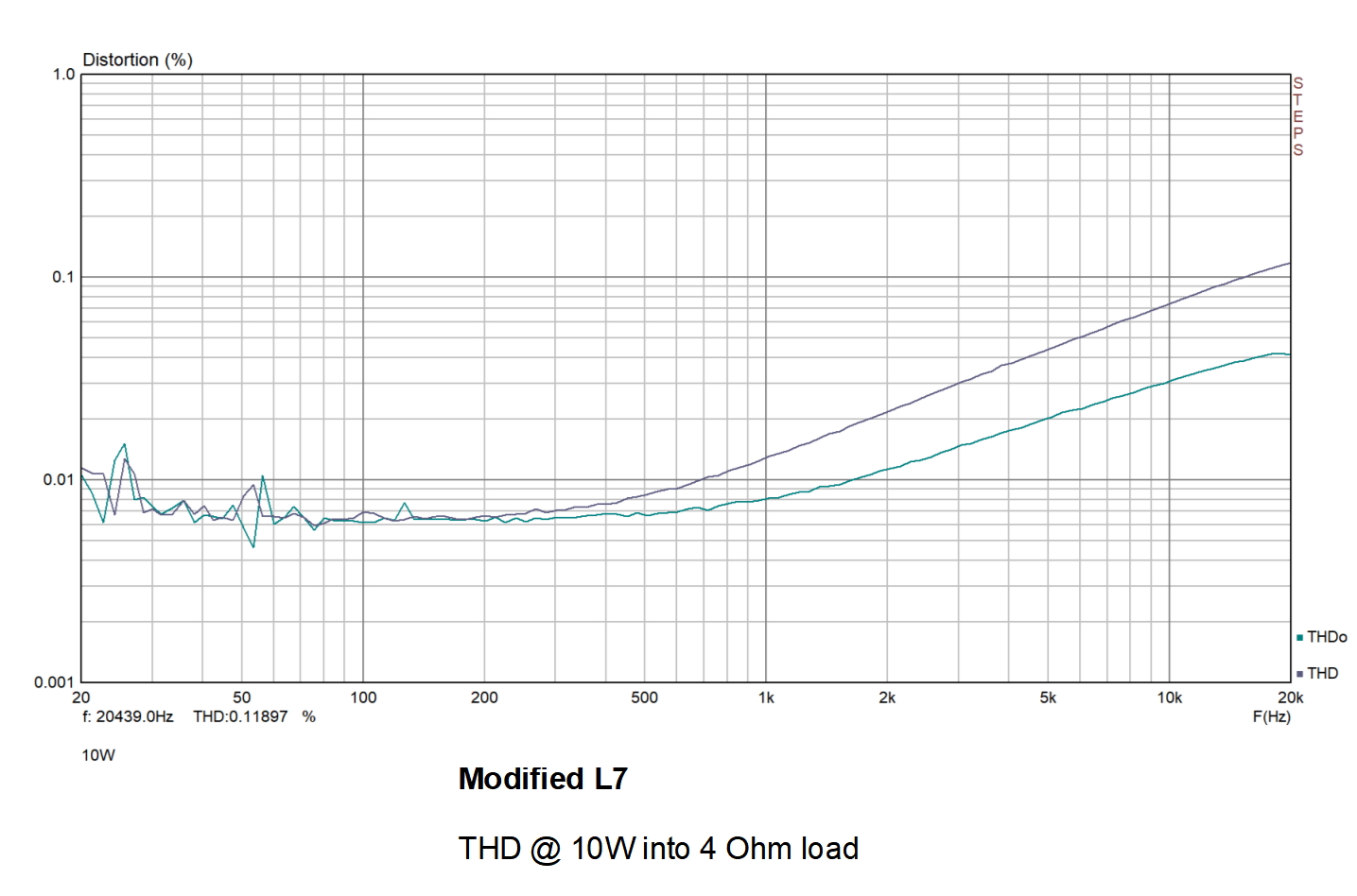

Keeping that in mind, I am attaching actual measured THD on my modified L7 circuits. As described, modification consisted of reducing the negative feedback resistor to half of its original value, which helps the input differential amplifier stage to counter distortion better. The other measure was changing the 9.1k/10k bias divider resistor pair to 10.00k/10.00k. In my experience, that was the most I could go without causing too much idle current/warming.
There are two THD curves in the attached plot. The upper one (higher THD) is typical for the modified L7 and represents measurements on three of my four modified L7 modules. The lower one (smaller THD) is a "lucky case" I found four one of my four modules. There is no known difference in the parts. I suspect that the "lucky case" represents by chance a well matched power MOSFET pair. I have no other explanation.
I don't have the THD of the non-modified L7 documented. I measured them also and I can assure that THD was (under same measurement conditions) for 1W output higher by a factor of 2-6 times as mentioned at the beginning of this thread. For 10W output power and more, the THD difference between original L7 circuit and modified L7 schematic decreased.
Best Regards,
Reinhard

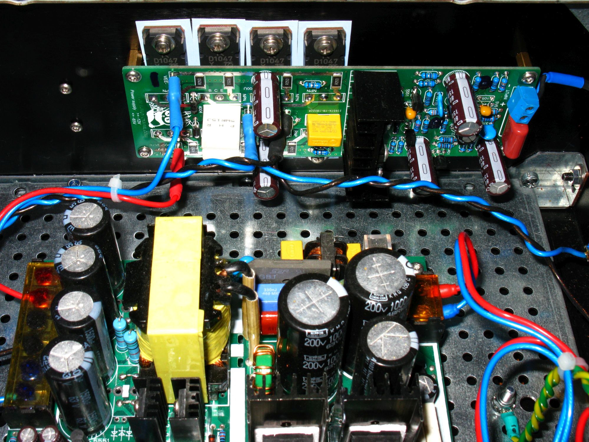

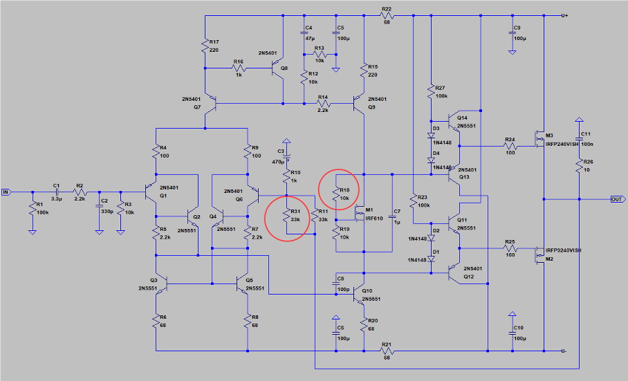

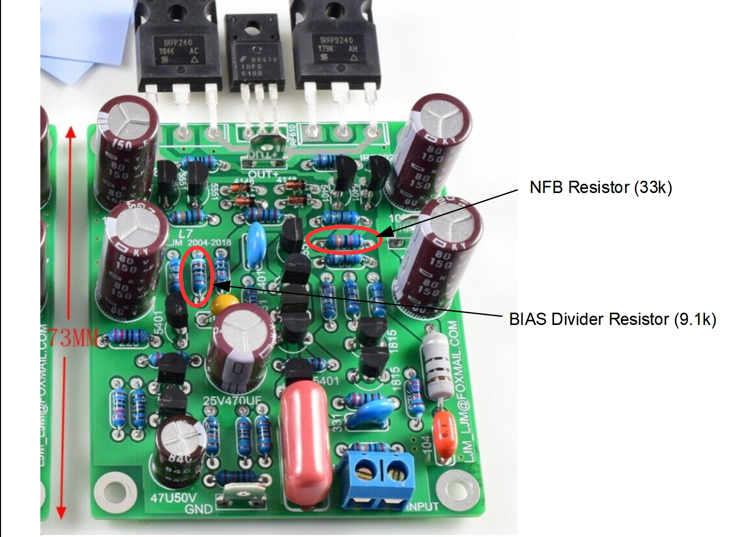

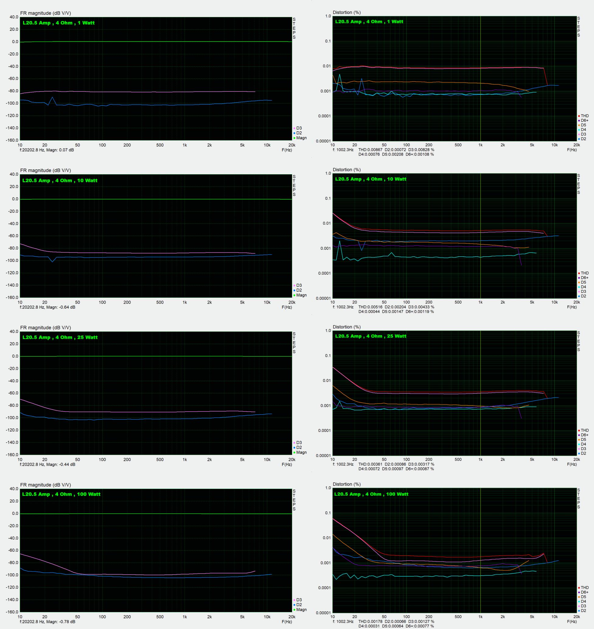

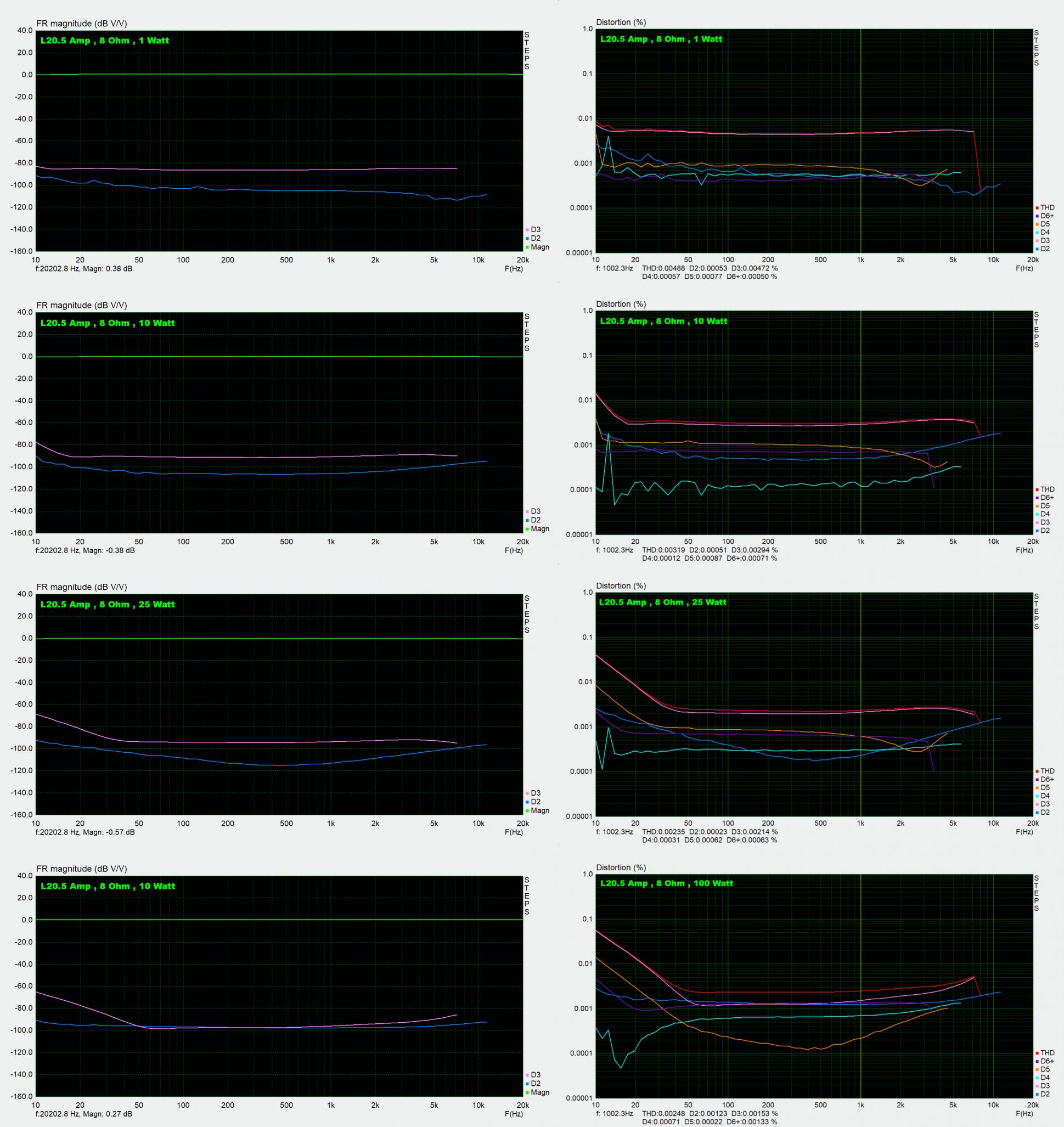

is it possible to have the schematic of the changes you made?
The only changes made are encircled in the attached schematic.
Please be aware that the transistors named 2N5551 are in reality NCC5551, which are electrically identical but have a different pin-out.They and the 1815 transistors are not changed, of course.
Only changes are:
1) A 2nd 33k resistor is soldered backside parallel to the already existing 33k resistor (negative feedback line).
2) The 9.1k resistor is replaced by a 10.00 k resistor. Care must be taken to match the resistance precisely (within +/- 0.5%) to the already existing 10k bias divider resistor (the one which has a common joint with the 9.1k). I.e. if the 10k bias divider resistor has an actual value of 10.13 kOhm, the one to replace the 9.1k resistor shall read between 10.08k min. and 10.18k max.
With the latest L7 boards by LJM, there is only one 33k reistor (only the one in the negative feedback) and only one 9.1k resistor (only in the bias divider) on the board, so that mixing up parts is not a concern.
NOTES:
1. Feedback Resistor
There are older versions of the L7, which have as negative feedback resistor instead of 33k (in this case there is 1k in series with the feedback foot capacitor of 470µF) 10k (in the latter case there is a 333R in series with the feedback foot capacitor of 470µF or 1000µF).
Note, that in both cases, the divider ratio 33k/1k, resp. 10k/333R is almost the same, namely 30-33. This results in a total amplifier gain of 29-30 (30dB).
The modification changes the ratio to 16.5k/1k, resp. 5k/333R, thus 16.5-15. Therefore the total gain of the modified L7 is reduced to 14-15 (24dB).
If the board is of the earlier generation with the 10k feedback resistor, then the parallel resistor shall be also 10k, of course.
2. Bias Divider Resistor
I noticed that there are early versions of L7 which have as bias divider pair 10k/11k instead of 9.1k/10k in the later version. If these are modified, it is also important, that both resistors of the bias divider are closely matched within +/- 0.5%. Either both 11k or 10k.
If you want to apply these changes, it's on your own risk, of course. No warranty from me. Just to mention, although it shall be clear anyway.
Idle current is increased, effective heat sink is important.
Only changes are:
NOTES:
