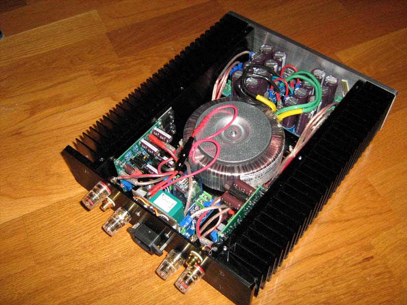

Just another L7.
This is my ljm-L7 power amplifier:
- 2 ljm-L7 DIY kits;
- 2 ljm 63V 2200uF Supply board kits;
- 1 stereo speaker protection board;
- toroidal transformer INDEL 300VA, 2x28 Vac;
- DIY aluminum case from ebay.
No problem, it sounds good🙂
Many thanks to LJM.

If there is only one group of voltage, AC28-0-28 I think a power board would be more appropriate.
If a group of voltage and the connecting two power panel, earth may form interference noise.
Use two power boards with a single AC may be an unusual choice and with little or no benefit.
I started to make two independent channels, this is why I bought two power boards. In the end I tried to use two power boards equally, with the uncertainty of producing noise.
Really there is no audible noise🙂

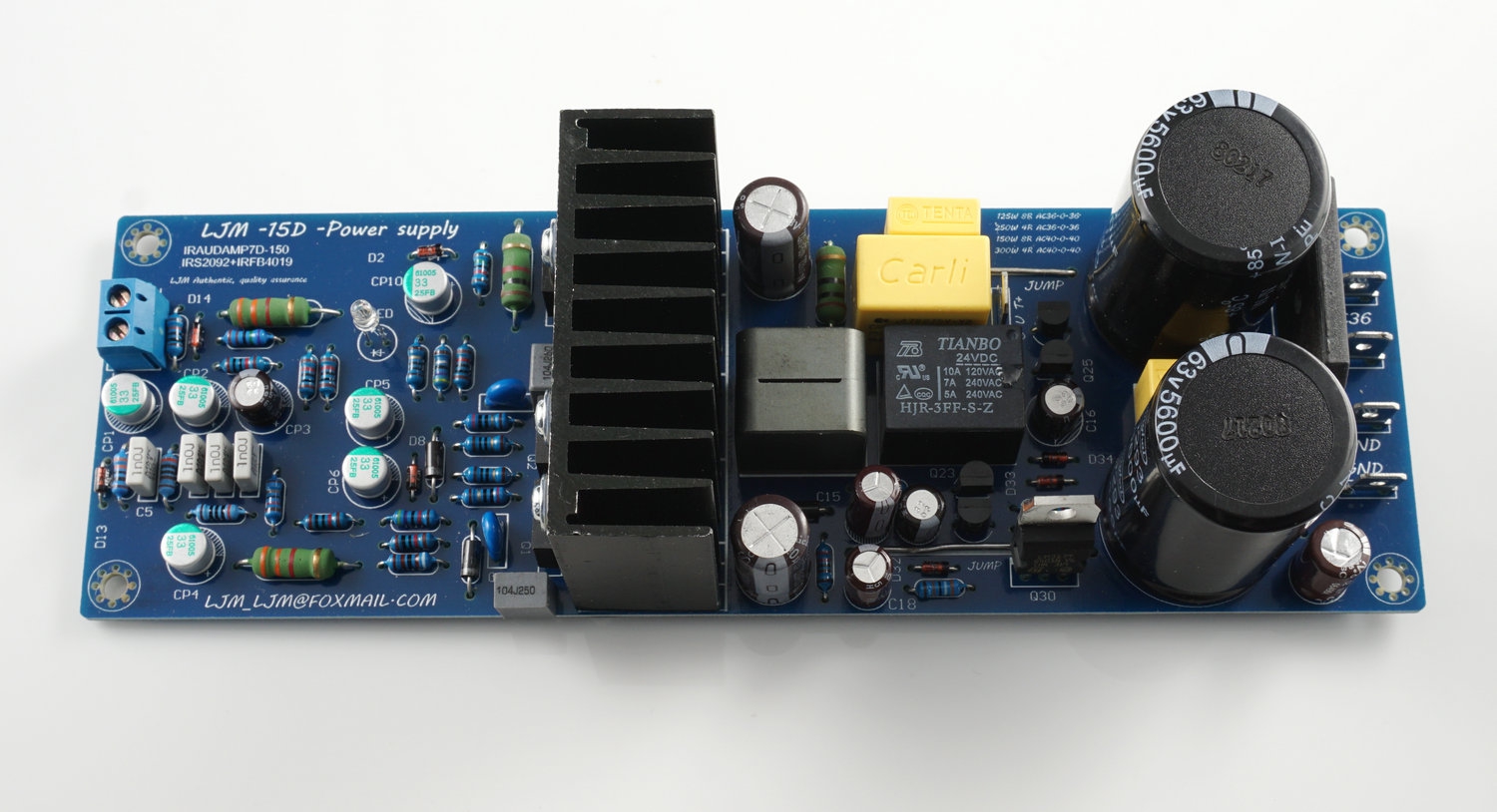

You may want to consider L15D - POWER ,But 2 stereo need 2 *transformer. AC 36-0-36

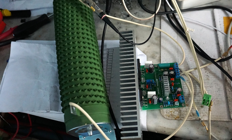

LME49810 AMP BY LJM
ME 49810 is the United States, the national semiconductor's latest flagship amplifier chip.
Due to the common IC power amplifier is a single integrated circuit chip.
In other words, audio amplifier input stage amplifier stage, output stage, are all on the same chip.
Power output stage will produce larger quantity of heat, and the heat will feedback to the same chip small signal input stage, and the signal amplifier stage at the corresponding level.
The mechanism of distortion is called thermal distortion. This in SELF book also have detailed records, and testing.
So NS national semiconductor in order to solve this problem, in later products launched in 49810, the LME LM49830 series power amplifier IC.
49810 is the small signal amplifier stage, the design of the separation of the current output stage,
This has greatly increased the power amplifier ?

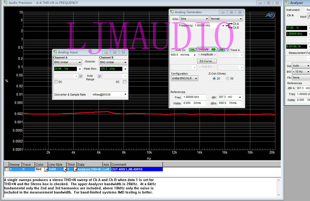

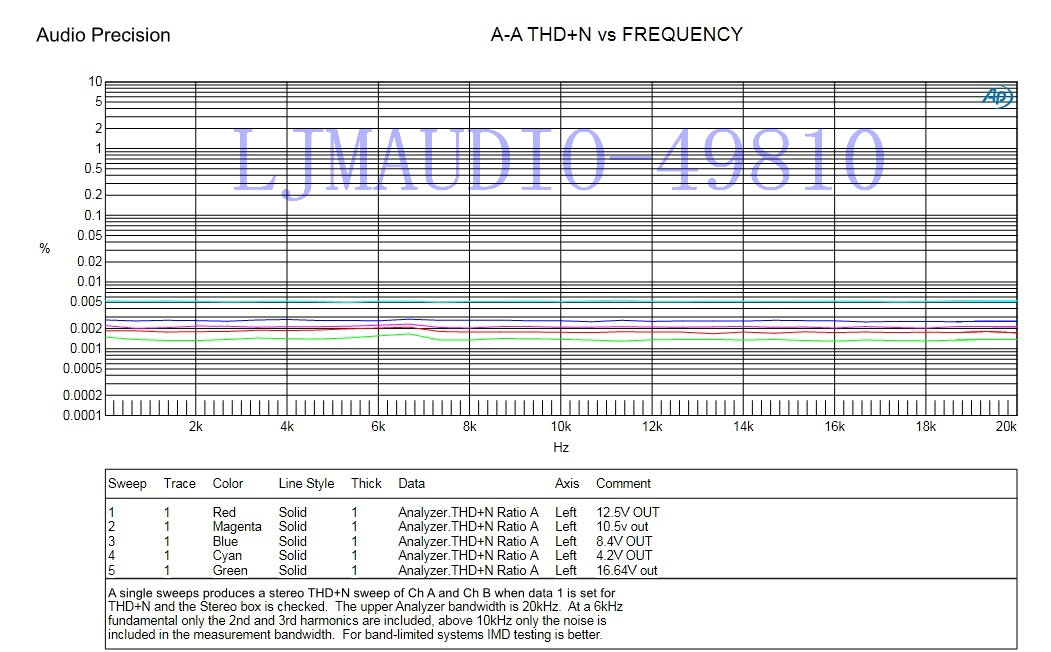

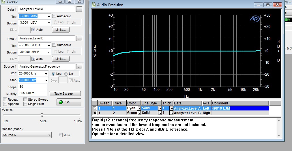

I use a 1000 w 8 ohm resistance.
audio Precision 2 test:
Frequency response: 20 HZ - 25 k HZ - 0.1 DB
10 hz to 0.4 DB
THD+N= 20W RMS 0.0015%
15W RMS 0.002%
THD+N = 40W RMS 25.5VP 0.002% 20HZ-20KHZ
