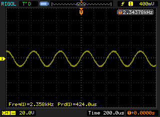

Hello ljm, its nice to see your well known amplifier in a even smaller SMD version. Can you tell us something about the difference in performance compared to the non SMD version?
I could read in a description: Frequency Response: 20HZ-35K HZ + -3DB.
I have measured the 15D where the upper frequency was about 22K, so does it mean the output filter has changed?
Please refer to my test. Have photos and video.
2.3 K and 23 K is no attenuation frequency voltage.
About 0.5 DB less than 23 k.

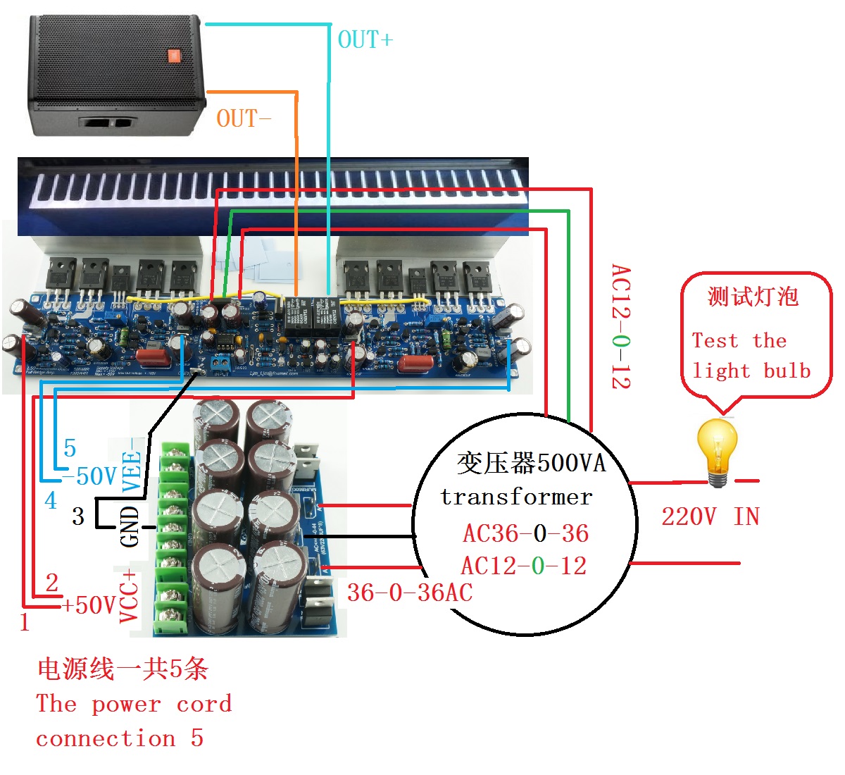

Hi Anton,
I have posted the links just because there are new versions of IRS2092 boards. The board you have posted is for sure the one that needs less effort to build a complete amplifier.
I did understand that you want to use two 600W transformers that is not necessary because one would be enough for two channels. If you want to use one transformer for each channel than 300W are enough.
For the configuration you describe I would also place the L15D close to the Transformer, use a short signal cable and longer cables for the speakers.
But I am sure many people use long signal cables for their subwoofer amplifiers without problems because only a limited bandwidth is required, so all noise above 200 Hz or below can be filtered out.
You don't in the test of time attention to too high output voltage.
Keep no more than + - 10 v test.
Because of actual use of power is very low, 20 k speakers also too won't big power.
Any music 20 k proportion of frequency information won't be too high.
So don't use a larger output voltage to frequency response test.
There may be more reliable L15D DIP parts performance.
Because DIP resistor, capacitor temperature change is small. Accuracy is higher.

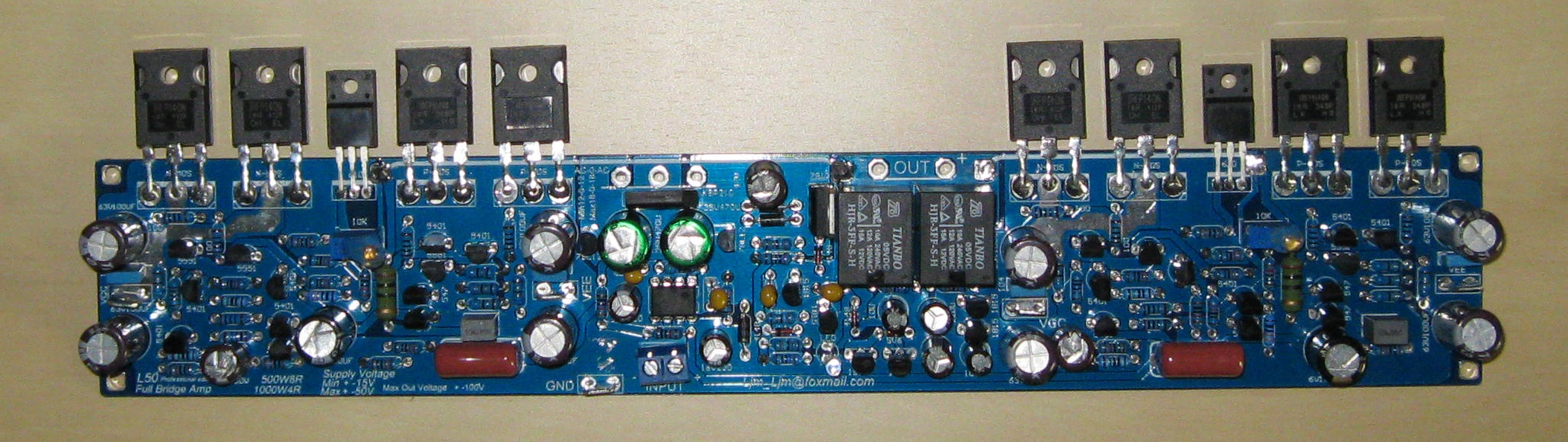

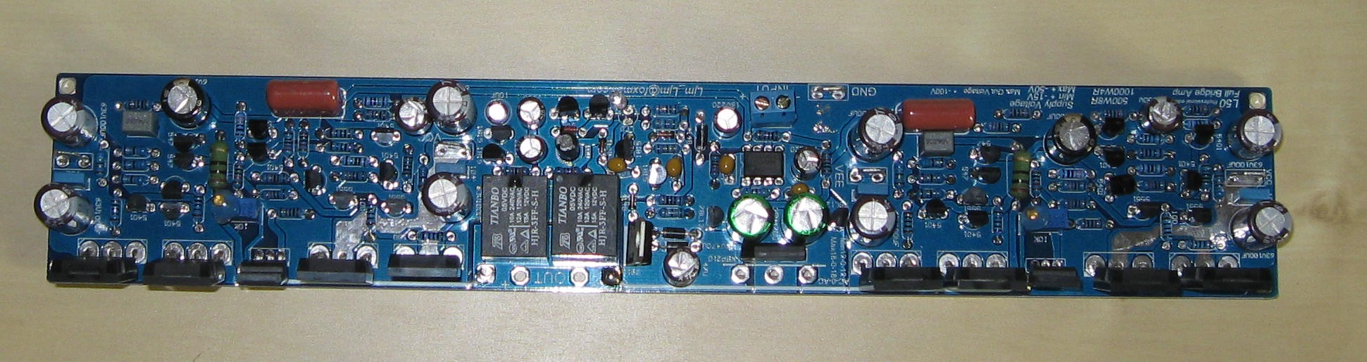

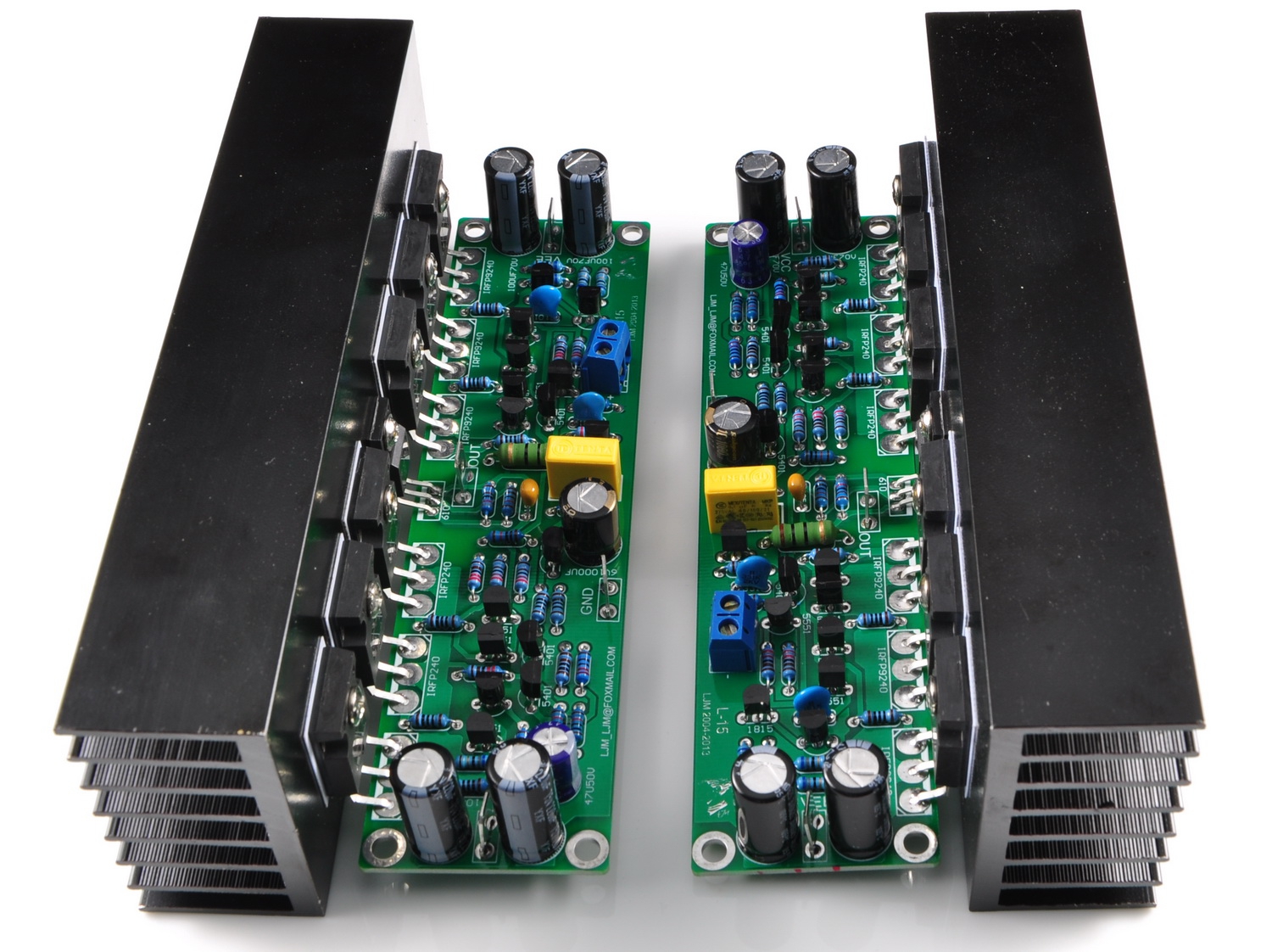

Trigger pulled. Amp boards arrived today. I'm waiting on some new +/-50V regulated power supplies to arrive, and then I have to find the time to mount the output devices to a heatsink, etc. I am considering testing the amp with the surplus ABLEtec power supplies that are available these days. They are slightly over voltage at +/-53V but I assume that should still be within the safety margin of the amp's design and the amp was tested at +/-54V by the designer (see page 1 of this thread).
I now have both the power supplies and the amp L50 boards.
After looking over the L50 boards I found a couple of concerns:
  • The board has several bare traces that carry high current. These are typically coated with solder to enhance the cross sectional area, yet none are.
  • The output devices were soldered to the board on the top side. This seems backwards to me because a heatsink that spans all of the would also be very close to other metal parts like the speaker output thru-holes, the 12-0-12 AC inputs, and the wire that connects each half of the board (this seems to be installed on the "wrong" side as well).
  • The board is shipped with the output devices perpendicular to the plane of the board, however, they don't clear the board edge - some kind of "adapter" seems to be necessary, perhaps an "L" of aluminum, in order to use them this way. I carefully bent all the devices and their leads 90 degrees into what seemed like a better orientation. This could crack or break leads.
It would seem to make much more sense if the devices were installed below the board instead. That way the entire board could be mounted to a large heat sink instead of hanging off at an angle.
This has nothing to do with how the board functions, it's just an assembly thing. I may need to buy a new set of output devices, remove the existing ones, and install the new ones in a more convenient orientation. I will try to take and post some pictures to demonstrate what I am talking about.
LJM, can you comment on this?
Attached are a couple of pictures. First, this is the board with the output devices oriented as I received it:
attachment.php
In the above pic, if the heatsink was attached to the output devices the edge of it would be above the board and would interfere with the holes for the speaker output (at center, bottom of pic below relays) and the AC 12-0-12 input (right of center at bottom). It could possibly touch the solder points of the wires that bring the outputs from each side of the board to the output relays. Any of these could cause a short down the road if the heat sink slides down and touches the board.
Below is the board with the changed orientation for the output devices. The problem is that the leads are still going into the board through the top side. It seems to be that it would be much better if the devices were below the board and the leads came UP through the holes. Then you could mount the board via some short standoffs, and the devices, on a large heatsink. A large heatsink is what this amp board needs afterall.
attachment.php
If the board could be mounted by 5-7mm standoffs to a heatsink this would keep them separated enough to prevent any shorts from occurring.
I would very much like to hear thoughts from amp builders/designers about these issues.

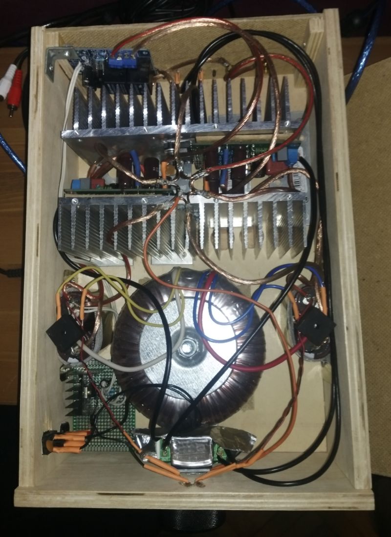

My L7 amp
Hi
I have finished my amp based on this kit.
The parts I used:
- kit containing 2 pcbs and all parts soldered by myself
- 2 of large aluminium heatsinks
- 200W transformer 220/4*25V
- 4 of capacitors 10000u*50V
- 2 of rectifiers KBPC1010
- speaker protection board kit soldered by myself
- ALPS 27 potentiometer (not fake I hope)
- large 44mm knob
- input and speaker terminals
- some speaker wire
- some microphone wire
- power socket and switch
- 2 little leds with resistors
- plywood cabinet, handmade
Finally, it was worth it. The sound is so clear and so nice that I decided to send to retire my Sony reciever that served to me for 10 years. Goodbye, Sony )
PS: while writing it, I realized my error: I shoud use 2*50AC power. Although, then I should buy other filter capasitors for 80V or 100V (50V ones was on hand). Yet, I like the result. Maybe, one time I make another amp, using right transformer, right cabinet, and add some new features. Likely, it will be another L7.
attachment.php

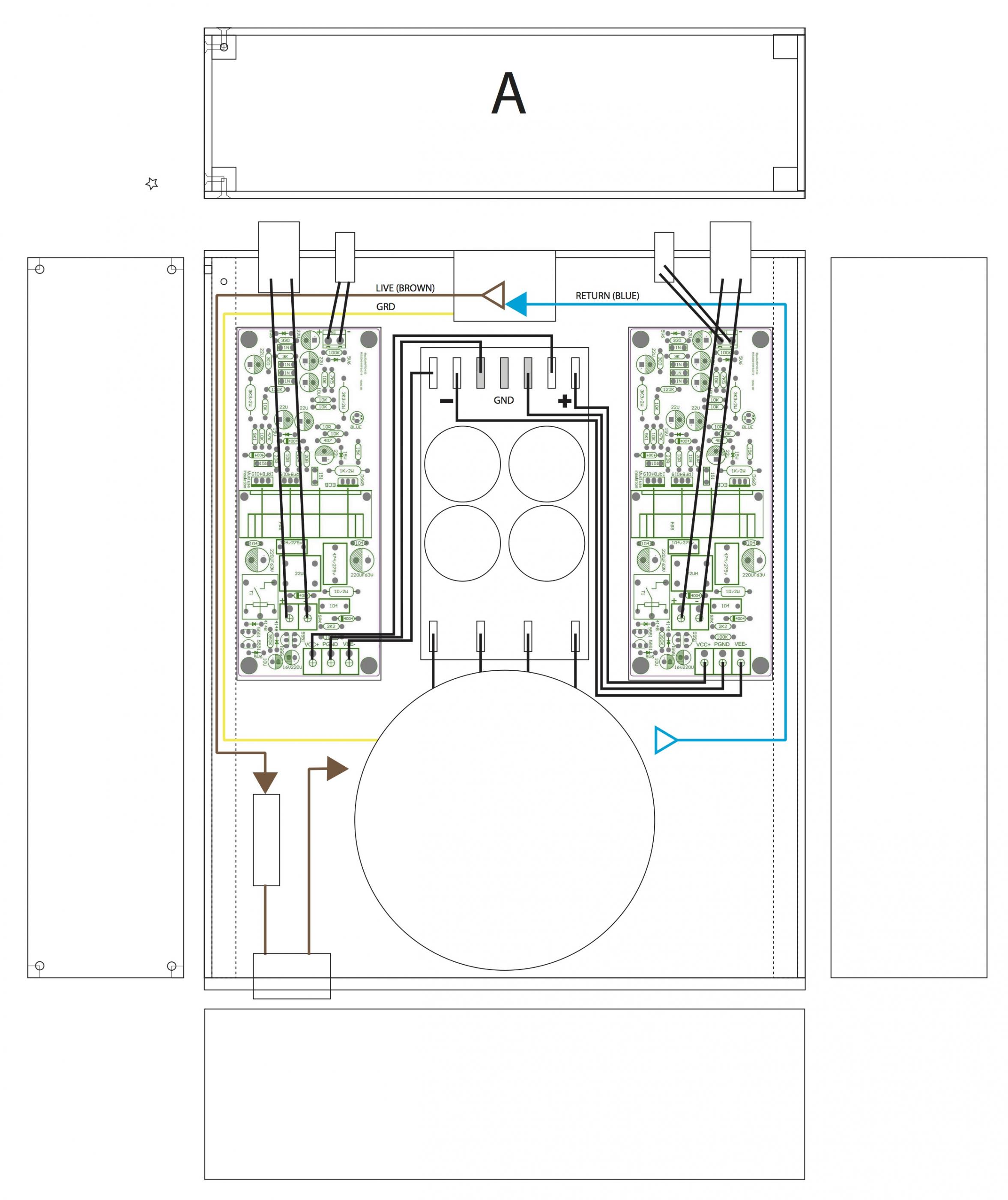

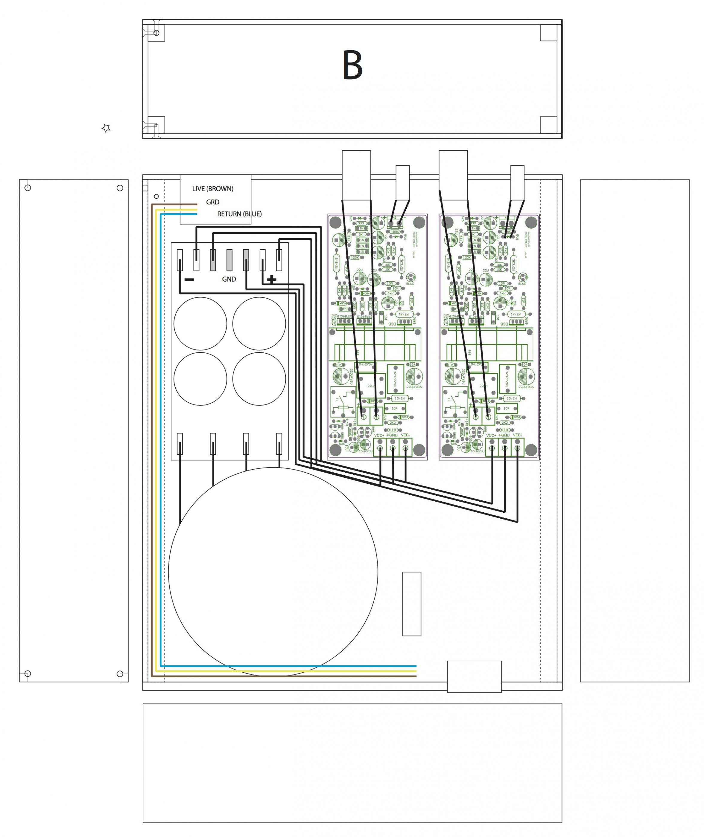

L15D Pro chassis and layout
Hello,
I've been using a L15D Pro for a while now on a breadboard. I finally decided to build it a proper chassis as I love the sound it makes.
I did some drawings to figure out how to route the signal and 220V cables and arrange the amp boards and the PSU elements.
I read somewhere that the amp boards should not be too close together. If that is a myth, then I guess, version B would be preferred .
Thank's
Version A
Signal and 220V cables cross each other but amp boards are further apart
Version B
Signal and 220V cables don't cross each other but amp boards are very close.
The chassis is about w250mm x d300mm x h70mm

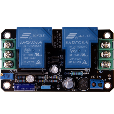

Hi r100,
I forgot to answer regarding the power supply. Yes, most of the protection boards need a separate (12V) AC supply. It can be a separate winding of a transformer. If you would use the DC voltage after a capacitor bank the stored energy of the capacitors will take a while to unload so the relais will switch off to late and you might hear some noise from the speakers when you switch off the amplifier.
