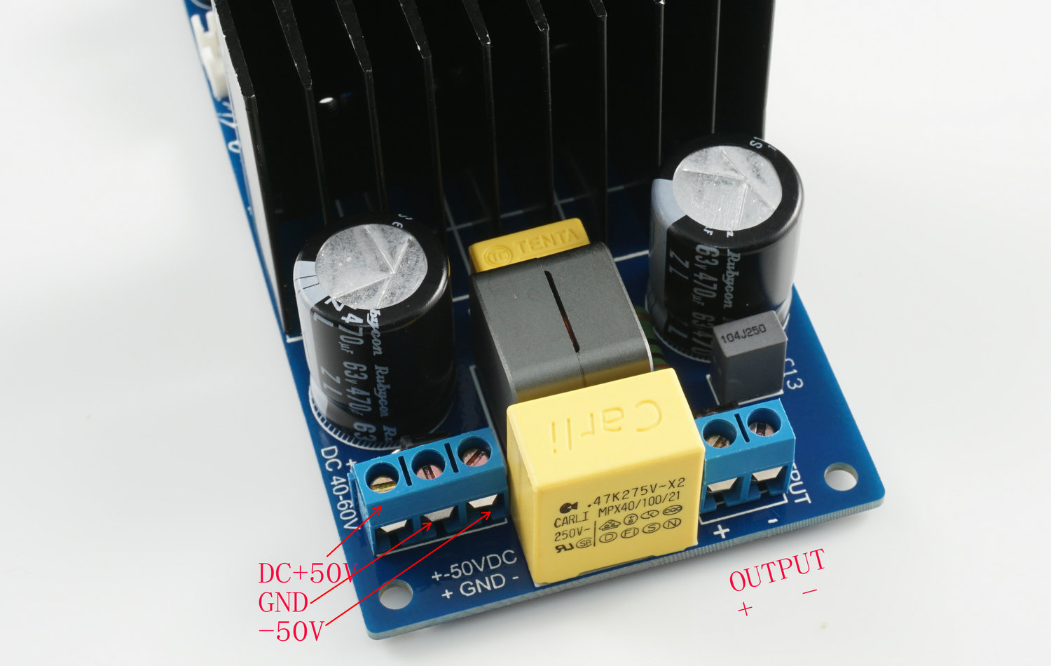

Its capacitance has more high withstand voltage 75 v 220 uf
So it can use 50 v transformer.
If your low voltage transformer, recommend 63 v2200uf capacitance 8 only that one.
Because it has the better rectifier, MUR860G

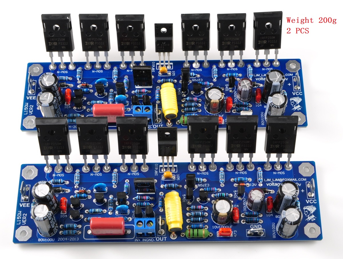

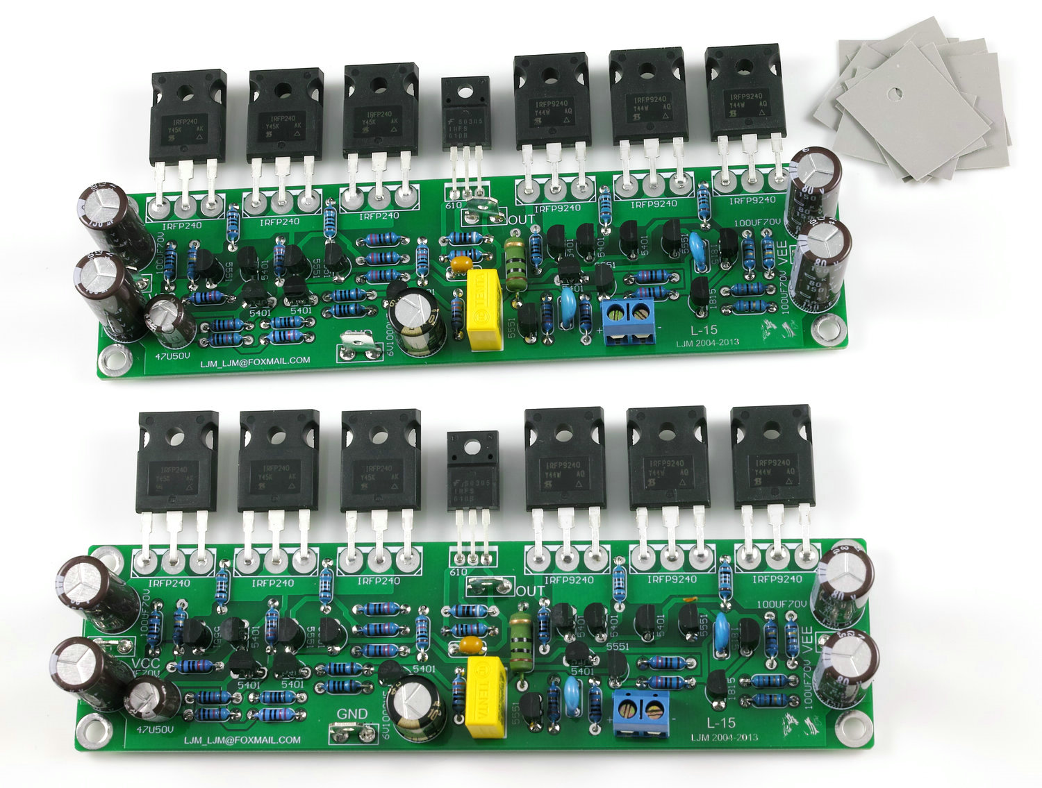

Hi ljm_ljm and others,
What would you say about this L150W?:
Assemble Dual Channel L150W FET Power Amplifier Board IRFP240 6 with Radiator | eBay
Personally I like its design, the look and the fact it isn't made on complementary MOSFET pairs, just 6xIRF240 per channel, much resembles my old NAD208.
Any possible downsides?
This is my design in 2013. My name is L150W.
It is to use a total of 6 IRFP250 power tube, perhaps the businessman is not very professional, the model made a mistake.
I recommend more relatively L15. It USES IRFP240 IRFP9240 six altogether.
From my test conclusion, the N + P mode is better than all use N field-effect tube performance.

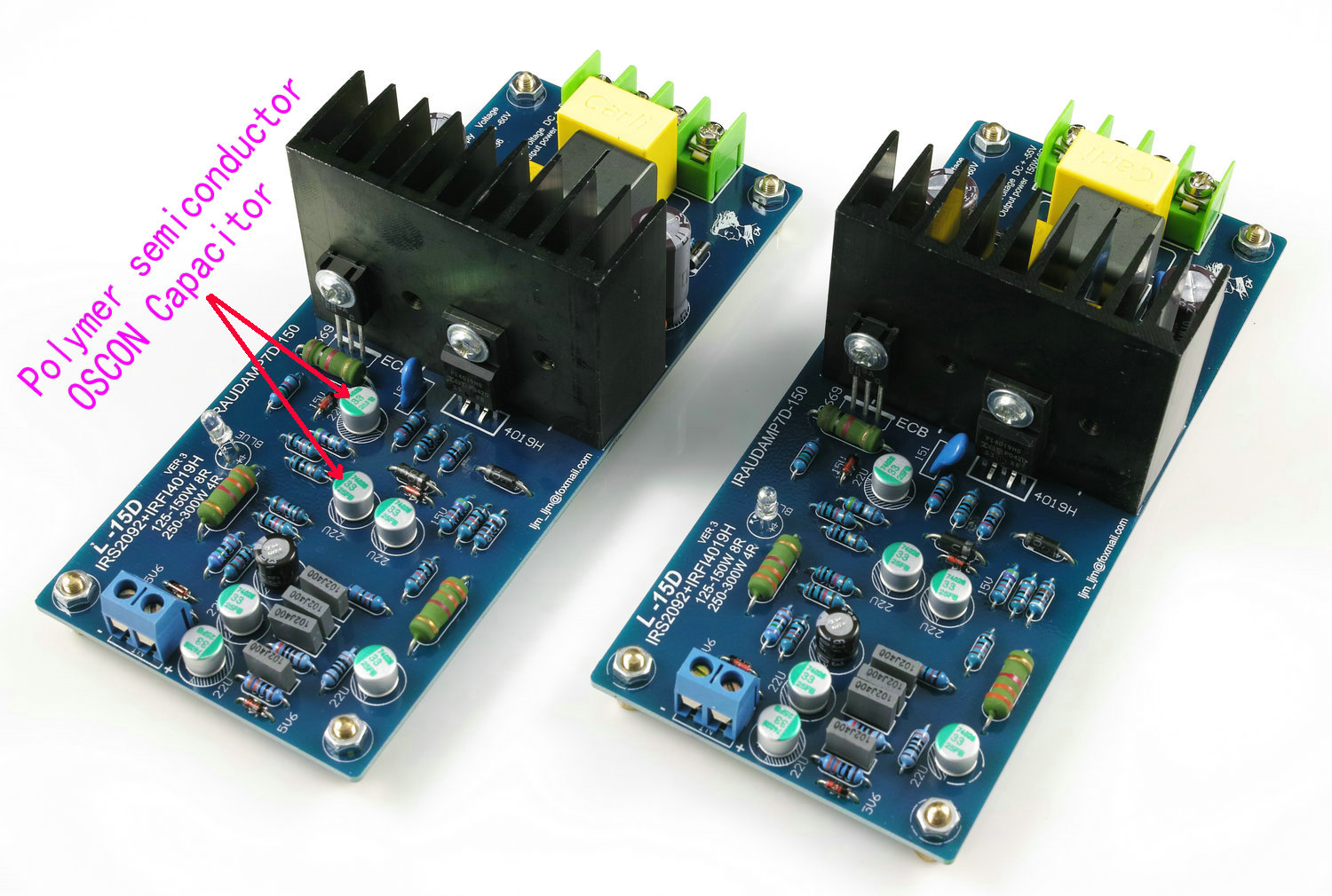

Like right now I've been using OSCON 25 33UF instead of aluminum electrolytic capacitor ,The original is 22 uf

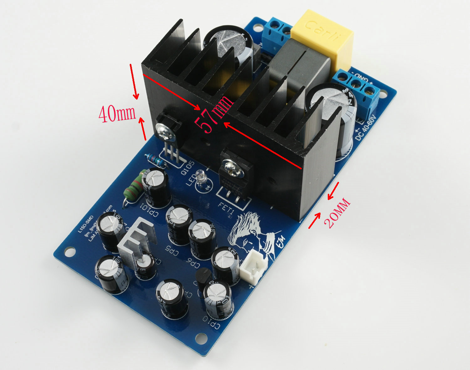

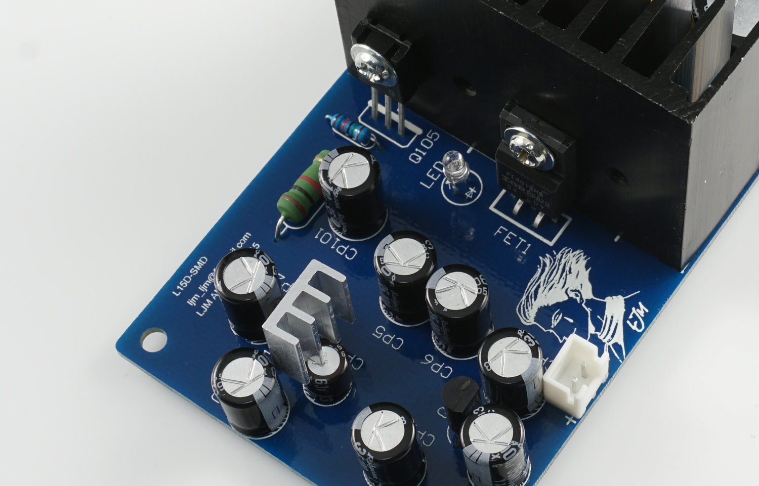

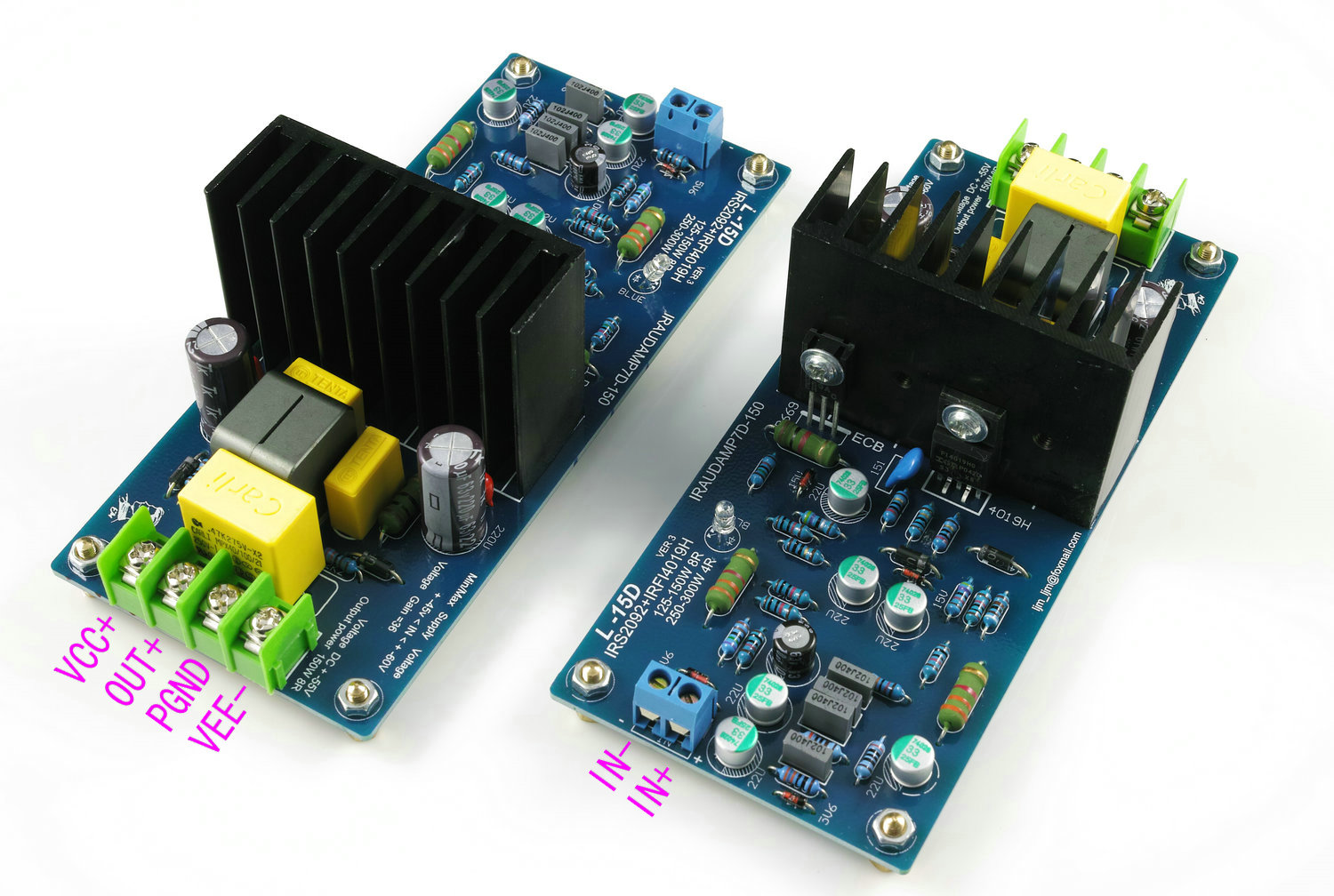

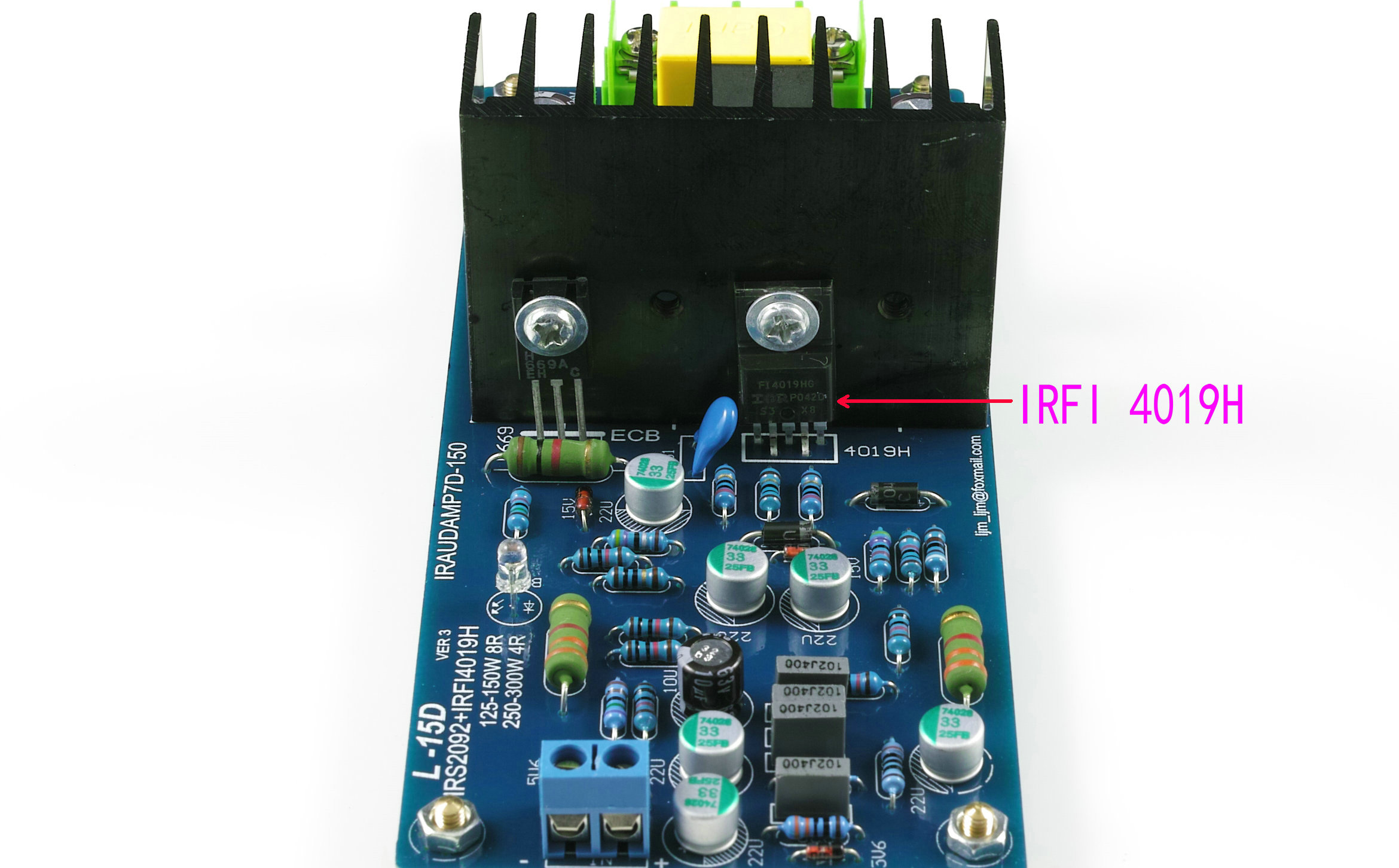

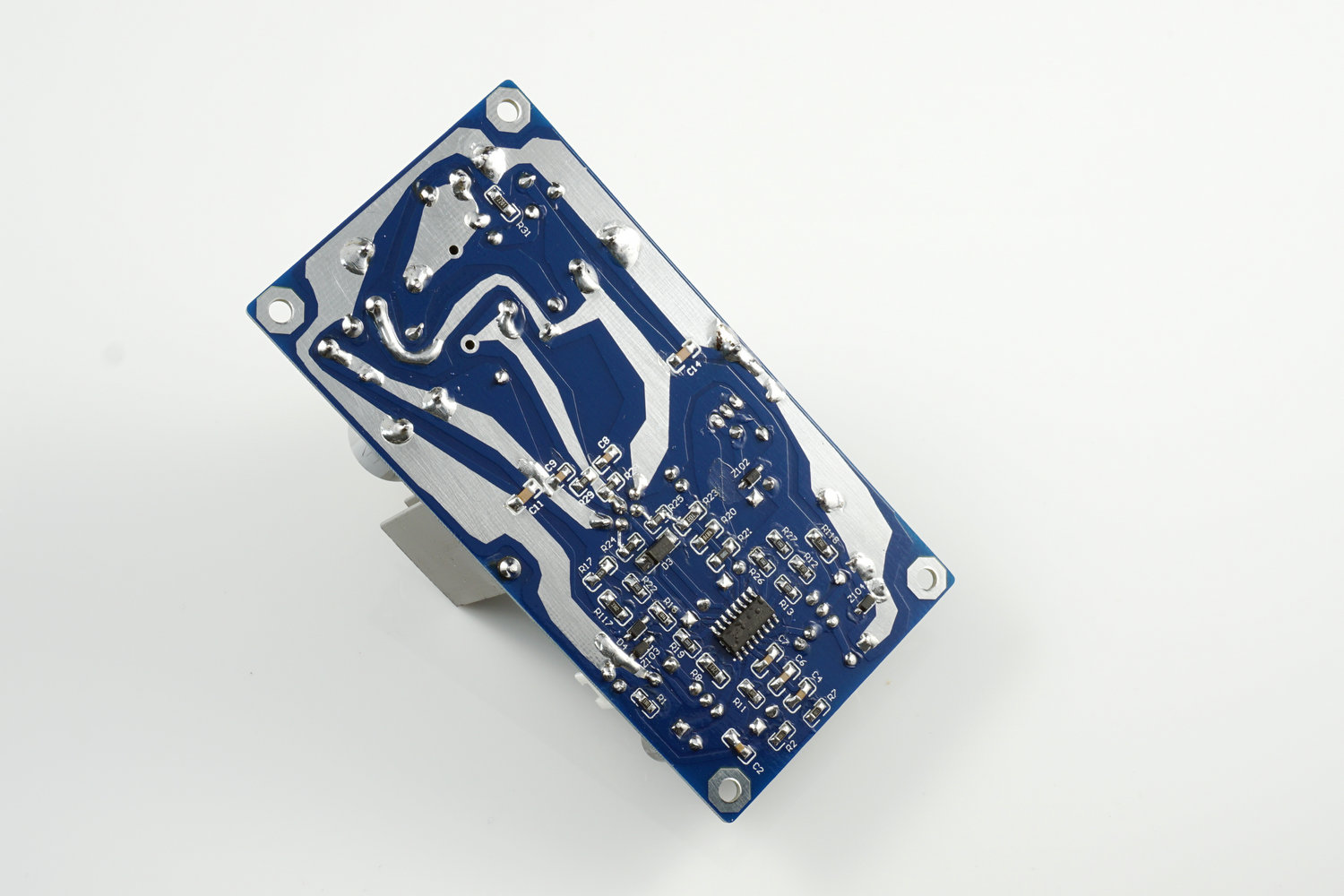

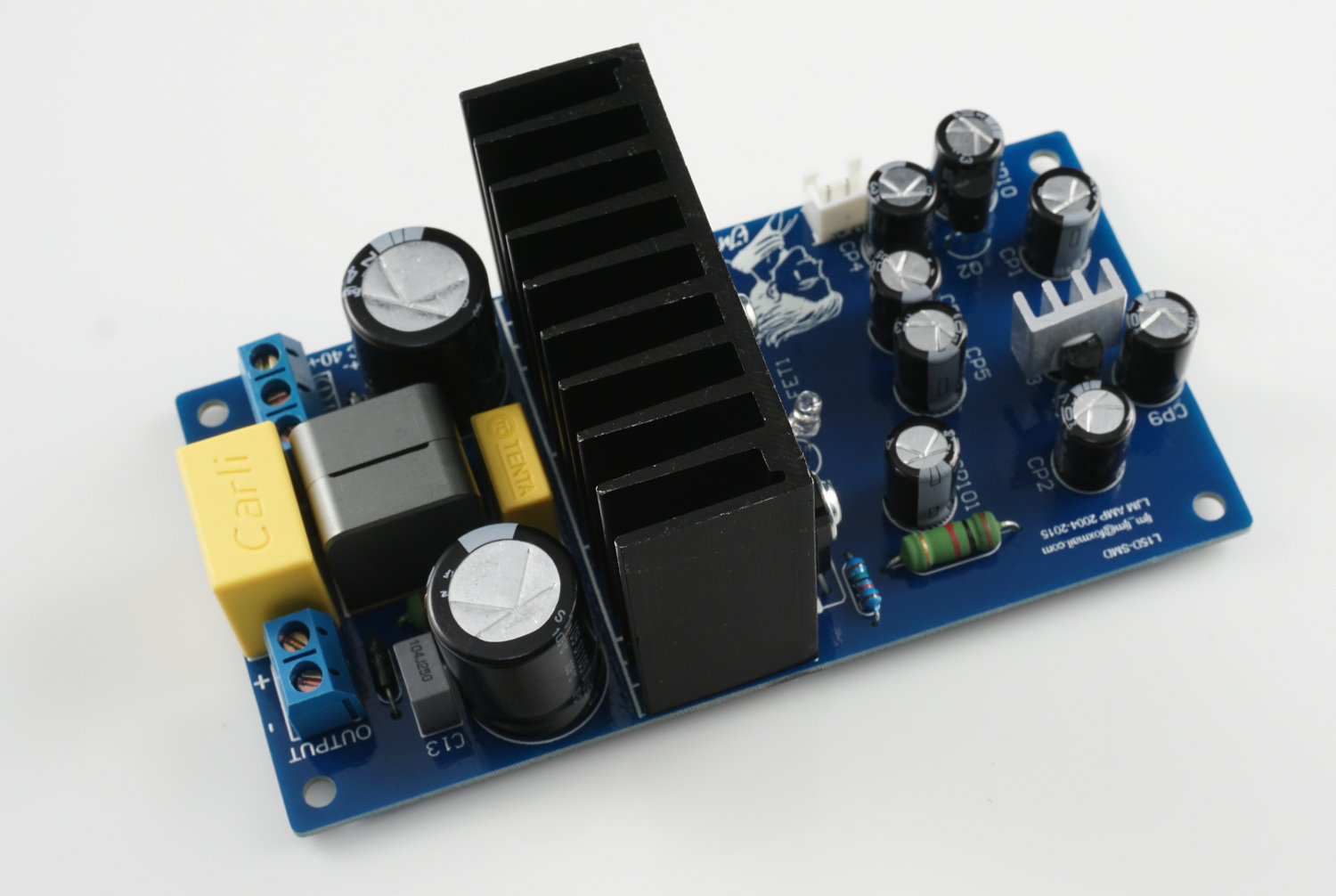

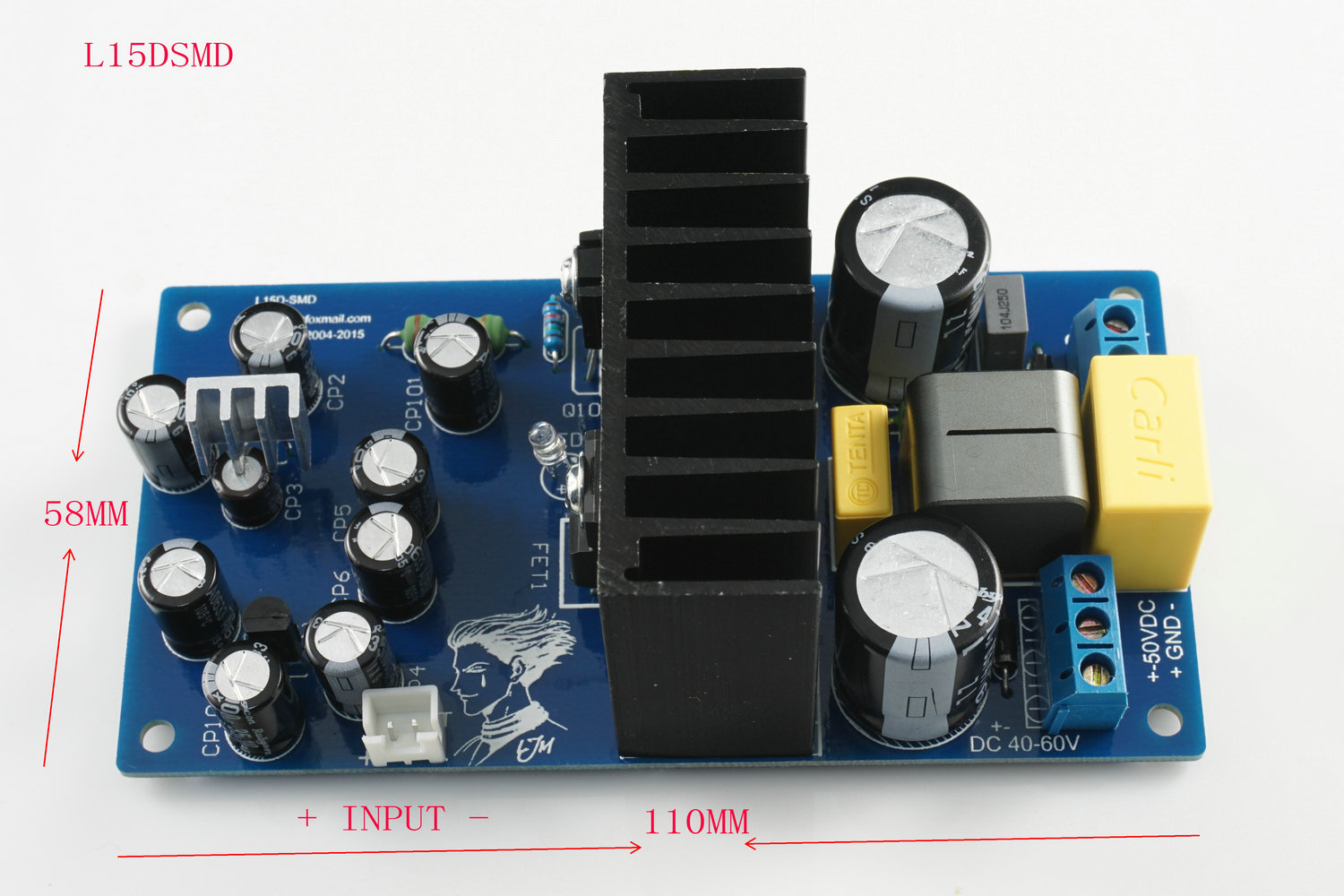

IRS2092 IRFI4019 L15DSMD AMP BY LJM
It is a SMD version L15D model.
The same structure.
By IRS2092S IRFI4019H composition.
It is a MINI version, the position of the element is similar to IRAUDAMP7S.
It suggested that + - 40 v to + 60 v voltage
Recommend + - 50 v voltage.
Can obtain 125 8 r w, 125 w 4 the output power.
Details about the test and can reference IRAUDAMP7S data.
