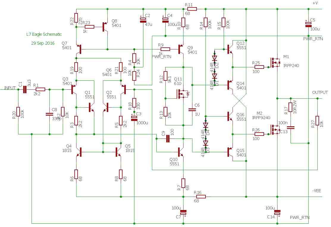

L7 Schematic in Eagle Revised

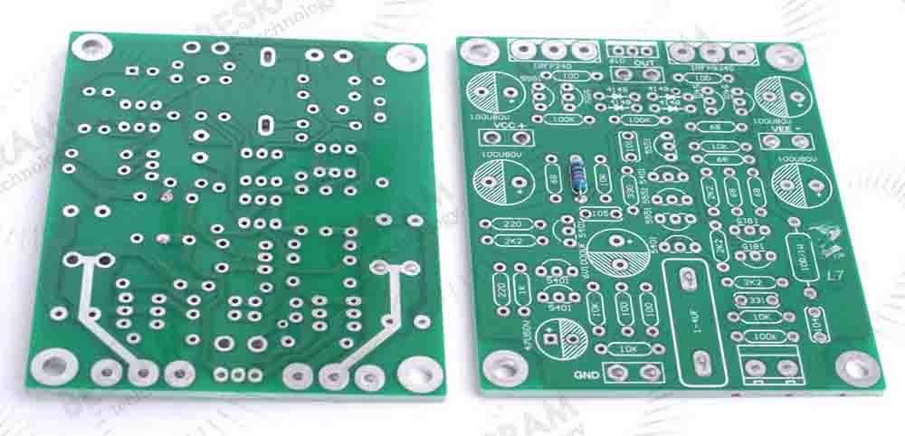

This is a revision of an earlier schematic, based on inspecting photos of bare boards on ebay. There is a little guesswork still, since I don't have actual boards to check. Anyway, here is the bare board photo, and revised schematic in Eagle format.

I made mistake - reversed 10k resistors and K33.
Here is an updated version of scheme.

Maybe you have a different board than the one I found on ebay. There are slight differences in resistor values here and there. Compare the one I just posted, before I saw your post. I read the silkscreen for parts values.
If anyone else has a different board, please comment. I'd like to get an accurate schematic to run Spice on. I like the front end of this design very much, but the back end scares me. And some people have had bad luck with it. So I would change a few things to improve reliability, later on.
Bias Voltage Generator: The MOSFET "Vbe multiplier" uses fixed divider resistors. But the MOSFET threshold voltage varies from 2 to 4 volts, typically 3 volts. A fixed divider may work fine for a typical part, but not for ones with threshold voltages at extremes of 2 or 4 volts. So adjustment is needed. The output devices have the same 2-4 volt range of threshold voltages, so the circuit needs to be adjustable over a 4 to 8 volt range.
Actually, I would switch out the MOSFET in the bias generator for a bipolar transistor. The range of Vbe is small for bipolars, and it has a well defined negative tempco, which I prefer. It won't self oscillate like MOSFETS do. Since the pinout is similar, it's an easy swap. I'd just add a pot in place of the lower divider resistor and a 2K pot would be fine with a bipolar instead of MOSFET.
Floating MOSFET drivers: Very cute, but these will probably burn out due to cross conduction and no current limiting at all. I'd just change the driver transistors to higher current ones and bypass this mess for now. I think I could make it work with a lot of extra parts and bootstrapping, but first let's make this amp reliable.
I will post the changes I suggest, after testing on real boards. It will take several weeks to get boards, so there will be some delay.

I consider this a nice design, but there were some reports of spontaneous failures at idle, so I looked at it. The front end and driver seem fine. The floating buffer circuit seems elegant in concept but shaky in implementation. It depends on perfect matching of the bias diodes to the transistor Vbe over variations of devices, voltage, temperature. With a lucky match, it survives, but without, it can fry itself and your speakers. I think the buffer is the problem area, not thermal issues with the output devices.
I have 3 approaches in mind.
Approach 1 is to bypass the buffer, and put some zener protection on the gates, plus my usual obsession with ferrite beads on gate leads A subvariation is to upgrade the drivers from 2N5401/2N5551 to MJE340/350s. It is doable on the existing board, but two leads have to be swapped and one insulated, so it's ugly. But this allows me to kick up the driver currents and drive the MOSFETs faster, which may or may not improve performance much. This has to be tested, but that's the concept. These changes basically make this just like any other complementary MOSFET amp. except it's tiny and ridiculously cheap.
Approach 2 is to tweak the buffer to allow random parts to work together safely. I like the way the buffer efficiently drives the MOSFETs. It does not draw continuous high current but pulses on demand. Let's keep that. I want it to be only modest rework to the existing board, so I'm keeping changes minimal, but there are some things in the buffer that I think must change. I have that as an Eagle design now, unproven. I will do the changes to actual boards and get some hours on them before showing this.
Approach 3 uses the reworked buffer, but triple output pairs. This design is very scalable, so this is trivial except it's a new layout. Stay tuned.

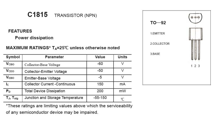

Max Safe Voltage for this Amp is +-45 VDC

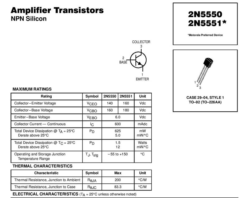

The two 2SC1815 transistors are rated 50v absolute max. If you want dependable operation do not run this amp on DC voltages greater than about +-45vDC (= 32-0-32 v AC). Using +-50VDC could be fatal. So don't. A transformer rated 28-0-28 AC is the safer bet for this amp with those 1815 parts, resulting in about +-42v DC. You also run into heat problems as voltage rises. The current source transistor and both drivers get pretty hot and are near their 600 milliwatt dissipation limit. I would make small changes to drop dissipation. It's worth it, the front end design is excellent and this is a great compact amp, but I feel it needs little fixes.
For higher voltage, change two 1815 transistors to 2N5551s. Beware that the pinouts are different, ECB for 1815 vs EBC for -5551. You must switch two leads, B and C, insulating one of them. In repair jobs I've had to do this for some old Japanese transistors for which I could not find exact replacements. I would advise this change if you want to run voltages above +-45vdc. To reduce dissipation, I suggest adjusting the current source for less tail current by changing the 220 ohm to 330. I also suggest changing the driver emitter resistors from 68 to 330 ohm for the same reason.
However, I remain skeptical of the safety of the floating buffer. It can short +- power with absolutely no current limit. If that happens, the gates of the output transistors blow. I believe this is the source of random failures noted. I am working on a mod to add emitter resistors as a quick fix limit current, and it looks OK on paper. Once it's proven, I will share it.

Here is my experience: I have three L7 pairs, all of them bought from the same ebay seller, running safely since two years (the oldest) with 18-0-18 and 26-0-26 trafos and working many hours every day.
Running the amp with a 36-0-36 V transformer the 1815's went well, while the NC 5551's and 5401's in the driver position just exploded in seconds.
hmmm maybe I will get a different trafo then!
EDIT: infact, i have loads of 2N5551's at home, so I will swap those first.
