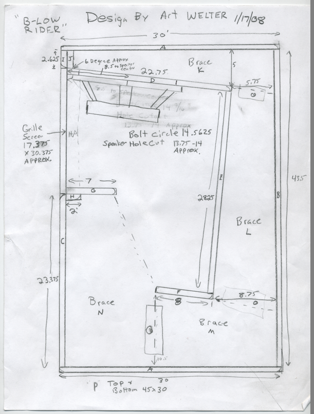

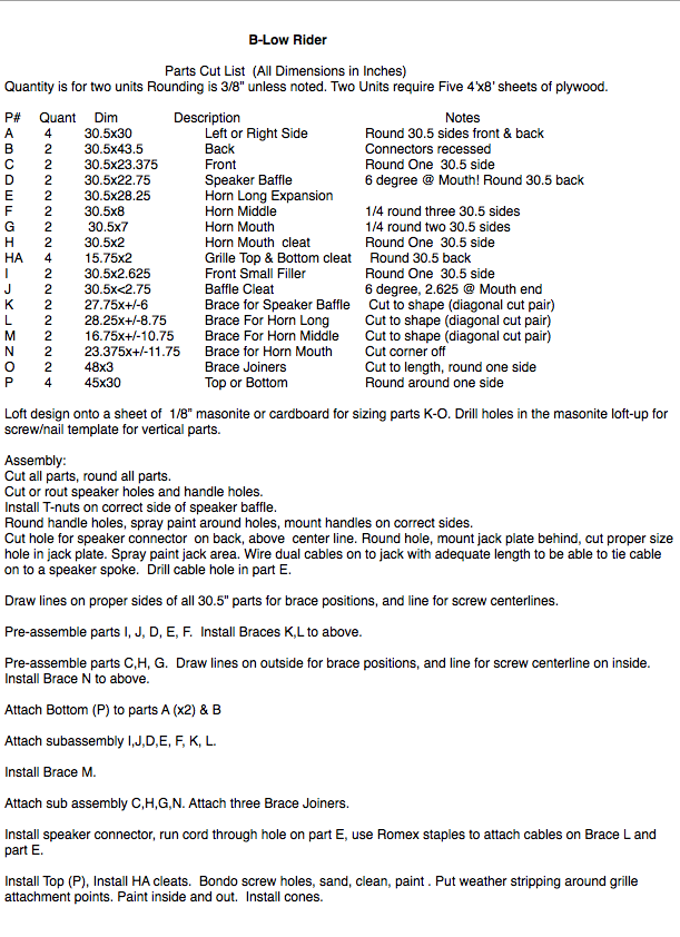

Eight years ago yesterday designed a dual 15" tapped horn sub for Peavey Low riders for a friend, named it the "B-Low Rider", as it can do the low B on a 5 string bass justice.
You could just make larger speaker cut outs and scale the height up to fit your 18" (30.5" dimensions go to 36.5" or 37") and be stomping.

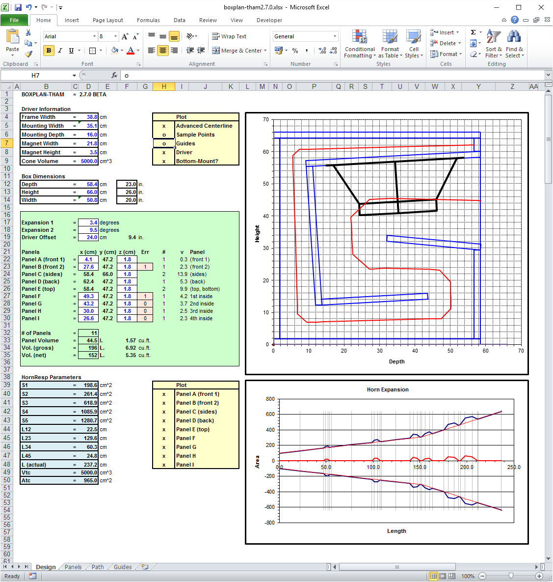

That looks like a THAM-style fold. If that's the case, my THAM spreadsheet can probably be used to lay out the box dimensions and folds, and translate that to a HornResp sim. See attached.

Brian,That looks like a THAM-style fold. If that's the case, my THAM spreadsheet can probably be used to lay out the box dimensions and folds, and translate that to a HornResp sim. See attached.
You mean the Tham (October 2010) is a (January 2008) B-Low Rider style fold 😉
These were the test results, done while a light snow fell, and snowmobiles were ripping past the speaker scaffold:
20 volt sine wave was applied, 100 watts at one meter.
Freq 30 35 40 45 50 55 60 70
dB 116 119 121 116 116 121 123 122
exc. 10 2.5 6 7 7 6 5 1 Excursion peak to peak mm.
dB 96 99 101 96 96 101 103 102 (one watt one meter)
The Low Rider X max is 9.6 mm. 9.6 x 2=19.2 mm peak to peak.
It looks like the cabinet could take 6-10 dB more power before reaching X max, so at 1000 watts 133 dB output would be expected.
The 15" Low Rider is rated 93.6 dB one watt one meter, two cones in a ported cabinet should do 96.6 dB, so it appears the horn is adding another 2-3 dB, good considering the low frequency extension.
At 25 cubic feet, this box is not for sissies. A dual 18" version would be really big, mon.

ROFL - I'll need to adjust the name of the spreadsheet accordingly! Maybe call it the "ART-B-LOW" sheet 🙂
Just make sure you keep the hyphens 🙂ROFL - I'll need to adjust the name of the spreadsheet accordingly! Maybe call it the "ART-B-LOW" sheet 🙂
