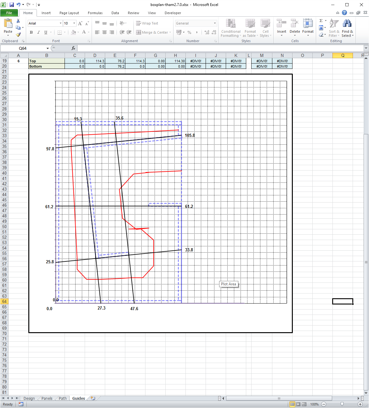

Eight years ago yesterday designed a dual 15" tapped horn sub for Peavey Low riders for a friend, named it the "B-Low Rider", as it can do the low B on a 5 string bass justice.

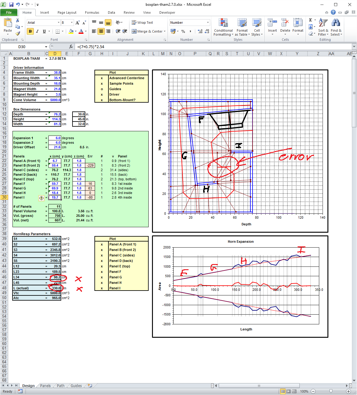

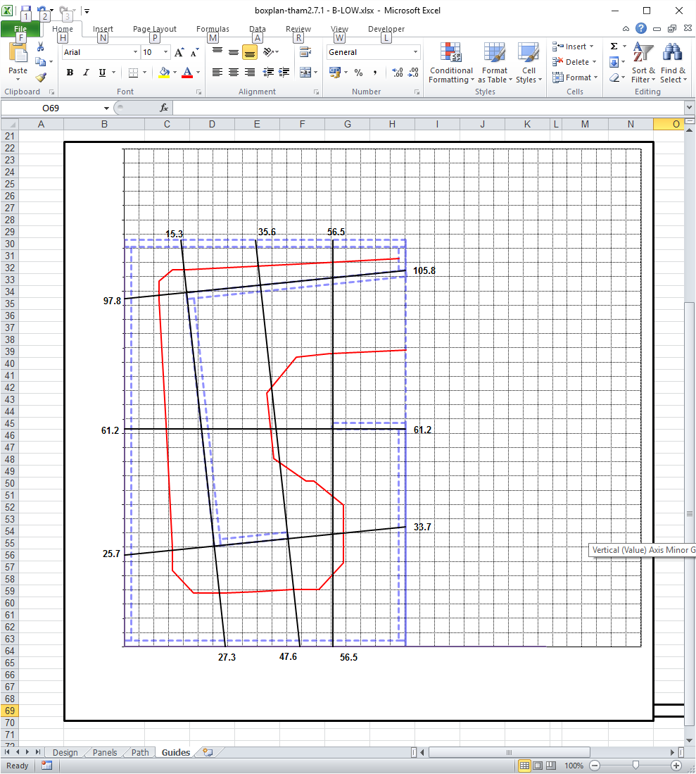

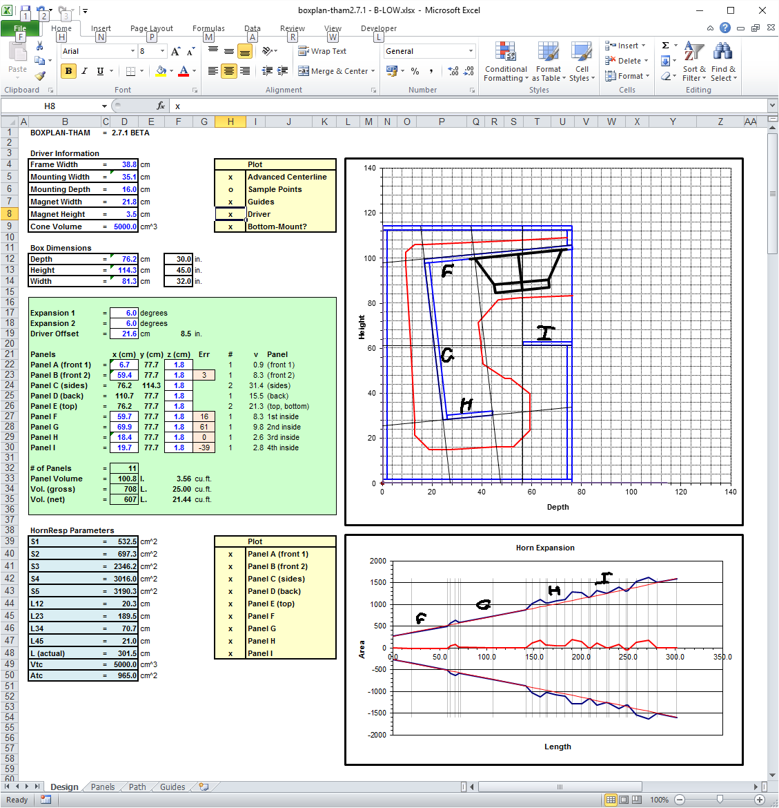

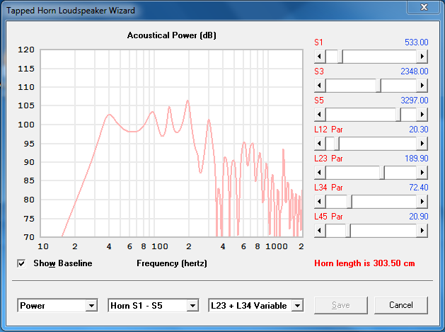

For chuckles I tried to map your design into my THAM (LOL) spreadsheet and came up with the following (see image). The spreadsheet has a computational error in it because I assumed that Panel I would always overlap Panel H, which doesn't happen in your layout. As a result the path length predicted by the current version of the spreadsheet (as well as L34) will be a bit too long. I might update the spreadsheet to correct that later when I get the time.
Otherwise it looks pretty decent, with a smooth expansion (forget about between H and I - see note about the computation error above). Mouth looks slightly small by about 213 cm^2, but maybe I got one or more of the dimensions slightly wrong.

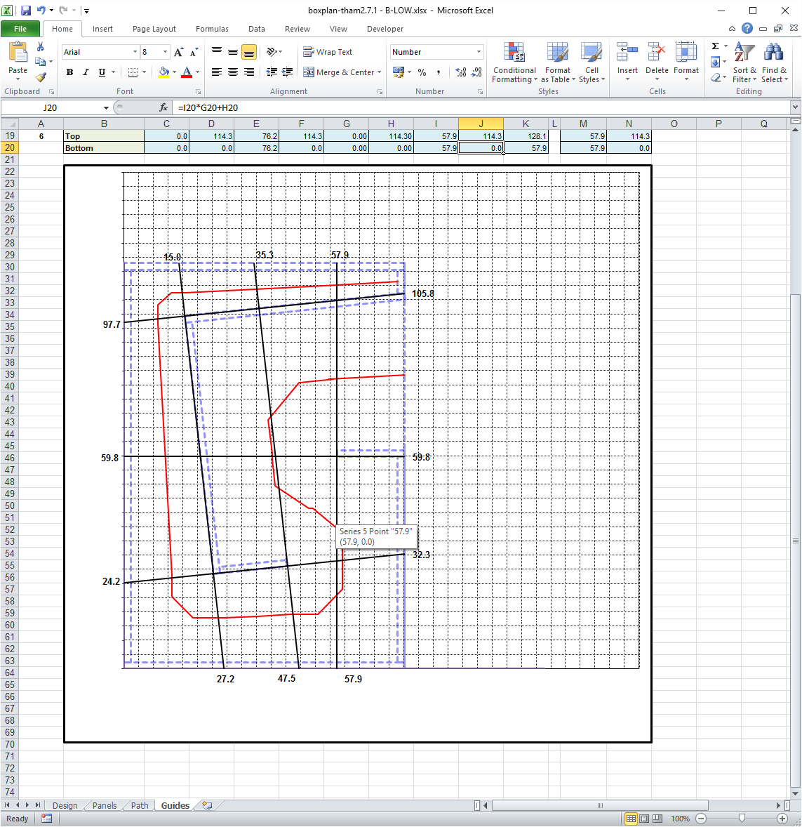

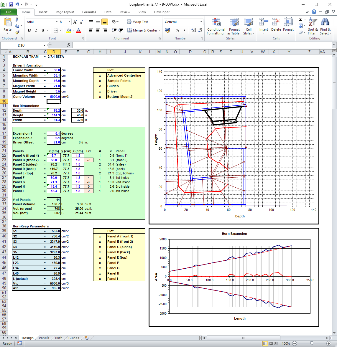

...and here is the correct version. The path length is now being correctly calculated. And while adjusting the spreadsheet, I found another minor bug in how it was calculating S4, which is now fixed. Looks like a pretty close to optimal fold, if the calculations in my spreadsheet are correct.
Well, a pair of the 2x15" B-Low Riders kept up well with four 2x15" +2" cabinets for the outdoor snowboard crowd of 1200 or so on their first gig....and here is the correct version. The path length is now being correctly calculated. And while adjusting the spreadsheet, I found another minor bug in how it was calculating S4, which is now fixed. Looks like a pretty close to optimal fold, if the calculations in my spreadsheet are correct.
Hah, at 50 cu.ft. in total it better keep up 🙂.
Anyway, just out of curiousity's sake, I tweaked the internal panels a bit and ended up with a slightly longer path length but also a larger mouth, so the change in FR turned out to be negligible...

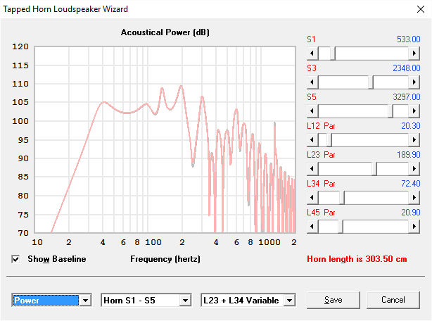

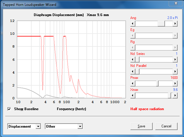

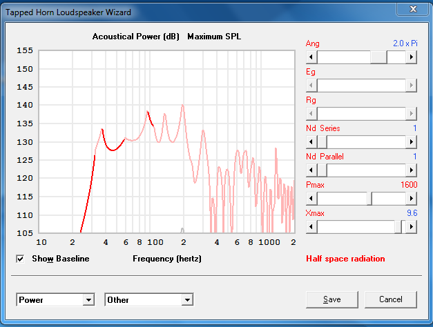

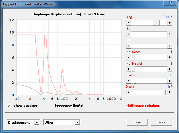

Hmm, you weren't kidding earlier about modding it just enough to fit the 18"; inputting a single BW18 into it as built yields an acoustically identical sim of your original dual 15".
GM
GM
GM,
Good to hear that the dual/single 18 version would work about the same- should have more output at 9.6mm excursion (Xmax).
Curious how my measurements compare to the simulation.
Could you post the input, output and excursion sims at Xmax?
Art
Art
Greets!

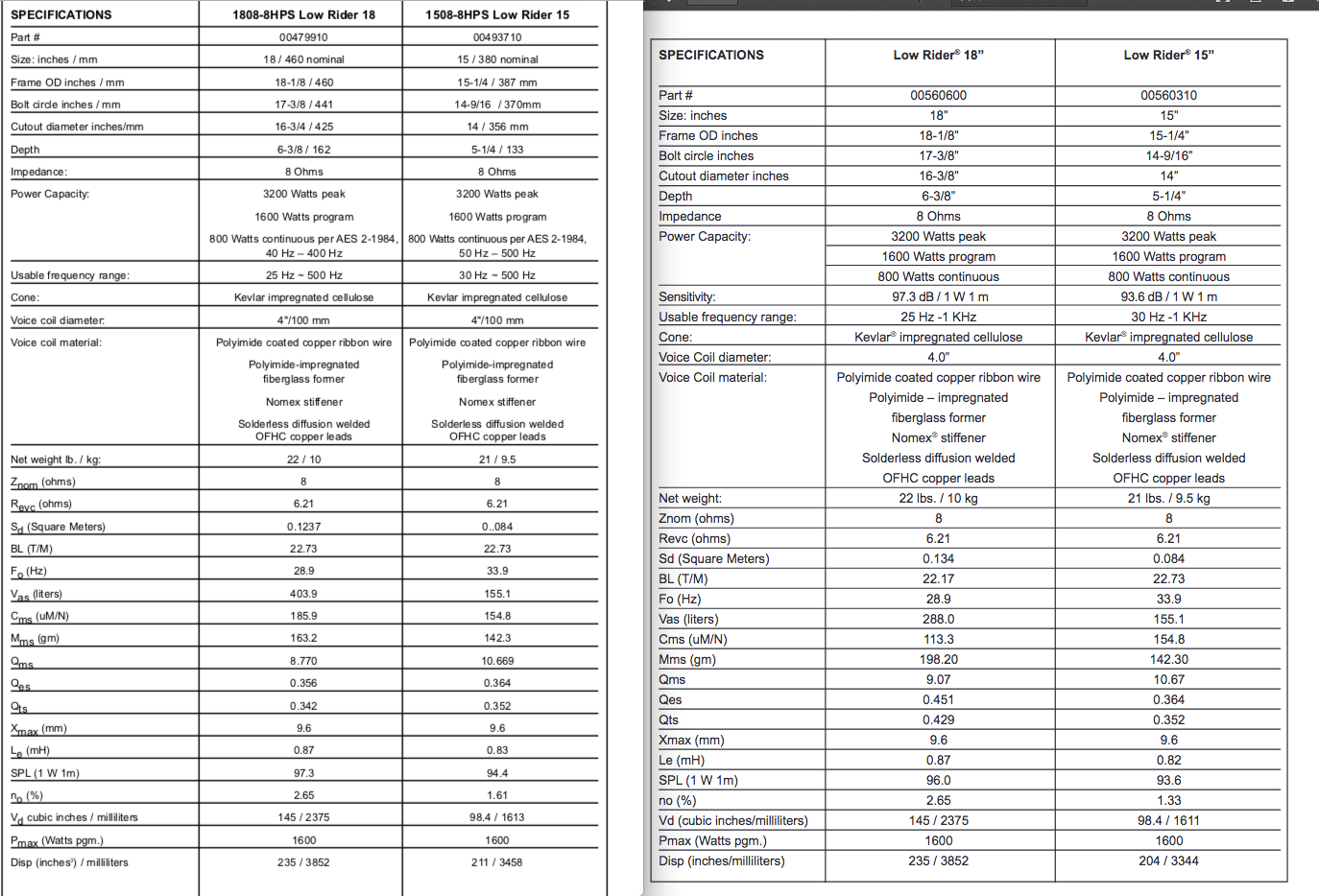

Hmm, apparently my LR 18 specs are either from an earlier version or somebody's measured specs with an 8.3 mm Xmax, so with the 9.6's specs from PE, it sims a bit under-damped due to higher Qt, but the as built cab will be a bit bigger to compensate, so hopefully still good enough.
GM

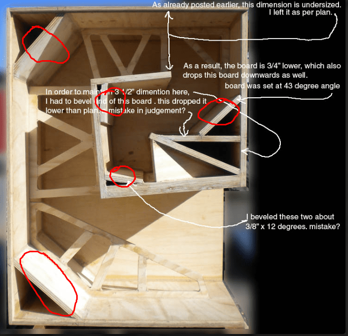

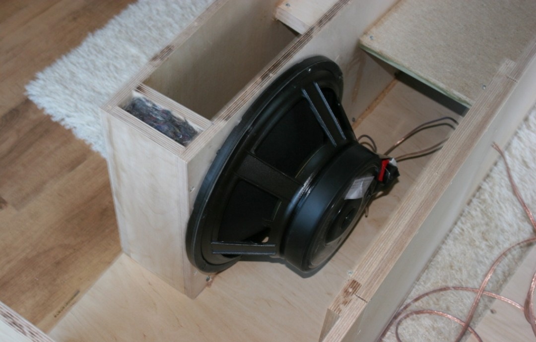

Hey, so reading a lot of threads on TH, the general consensus is that adding those 45 degree angles do not help the response and rob volume to the box
check the pic below from
anyway, what if you remove the pieces i circled in red.
https://www.diyaudio.com/community/threads/live-sound-specific-tapped-horn-thread.131852/page-36
post# 717
runrod1948
who built a furybox but says that there was some discrepancies on the plansanyway, what if you remove the pieces i circled in red.
post# 717
I have 2.3m long tapped horns with one 180 degree bend and a 90 degree for the driver and exit.Hey, so reading a lot of threads on TH, the general consensus is that adding those 45 degree angles do not help the response and rob volume to the box
runrod1948
post# 717
No reflectors.
Consensus was not needed at these frequencies.
No issues with sound, freq measurements etc.
Have build square ones with more folds since and no reflectors, same comments.
