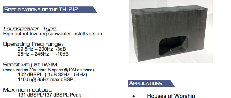

@ m R g S r: nah just buying something is boring isn't it? 😉. Your design looks promising. Would it be possible to move the mouth to the side instead of the front?
@ Art: isn't the TH-212 -3 dB at 38Hz?
I'm 'working' (as a hobby in my sparetime) for a small dance club in our town. It's more or less a family business and budget is always tight as you could imagine. In the next one or two years we're planning to do a makeover of the club and I want to improve the sound system. At the moment it consists of 2-3 15'' bandpass subs and 4x 12'' wedges for the dancefloor (~80 people, ~100dB(a) max). The club is in the basement so there are low ceilings and narrow walls. A nightmare in terms of accoustics. When the architects were designing it, no one thought about subwoofers with a depth of more than 24''... So I came across the THs with the horns mouth on the side so the whole thing could be sunk into a wall. This would be a perfect match for 1-2 TH-212s or DIY alternatives.
The TH-28 (or single 8) would be a nice one for a delay line on the ceiling for the rest of the club. The music that is mostly played is Top40 so 40Hz-ish low end would be absolutely enough.
I'd like to build and/or design the subs myself just to learn something. (BTW This forum is a great place for learning 😉 )
Fabian
Fabian,
There are actually several DSL TH-212, the one I referenced is attached.
Tapped horns do have more forward directivity in the upper range than front loaded subs, but at LF they are still omni.
Delaying a sub is not a good idea, the rear radiation will be (more) out of sync in the overlap zone, and may cause more damage than good.
Art

The TH212 that's much more familiar is this one
TH212 | Danley Sounds Labs | Danley Sound Labs, Inc.
which is -3dB at 38Hz -- I've never seen the one posted above.
