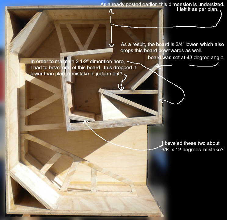

Hello everyone. This is my first post since I joined this site a few weeks ago. Two months ago I started to build a sub from that other site. A week or two after starting my build thread, the site admin locked my thread because of my unorthodox build methods. It was then that I started searching for other opinions on the real world use of his designs and found a pro sound site which wasn't quite as enamored with the performance of his cabs as his minions, specifically the response curve. A link on the pro site led me here and Screamers long TH thread. I've read both his and Jbells TH thread several times, soaking up as much info as I could, and I can't thank everyone who posted there enough for the knowledge I've picked up here, and your willingness to share ideas with others. When I discovered my recently purchased 3015LF's could still be used in Screamer's design, I dropped the other cab and built his. I finished the first one yesterday, broke in the 3015 last night and did an spl test on it this afternoon.
There is a couple discrepancies in the plan dimentions, so I guestimated as best I could. Hopefully, these results don't point to a build flaw. The test was done outdoors on asphalt pavement, using a ratshack digital meter, on the ground ,at 10 meters and 28.3 volts.
My QSC amp has a rolloff set at 50hz, so that probably accounts for the drop in db a 40 hz. I didn't want to disable it for fear of frying the speaker with the sine wave. Screamer made some reference to that possibility somewhere in his thread, I believe. So anyway, here are the results:

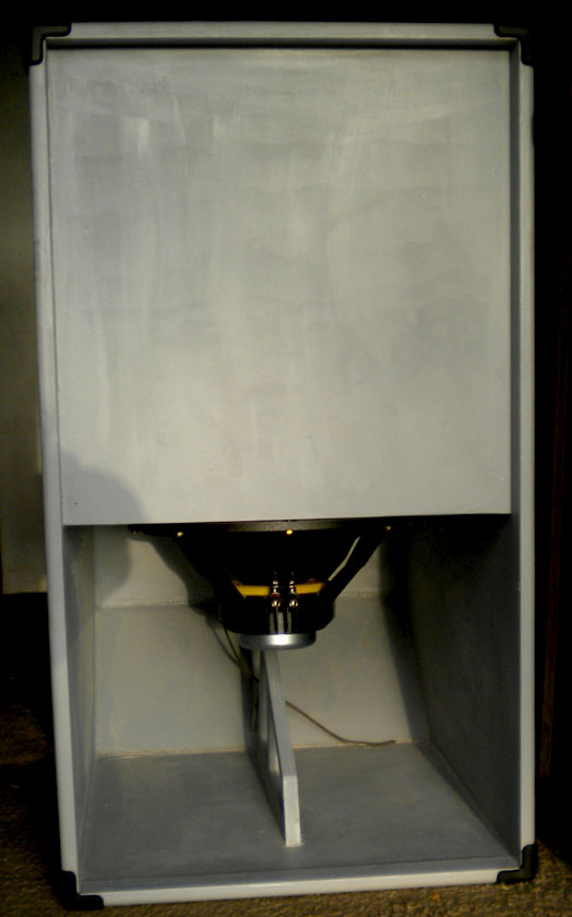

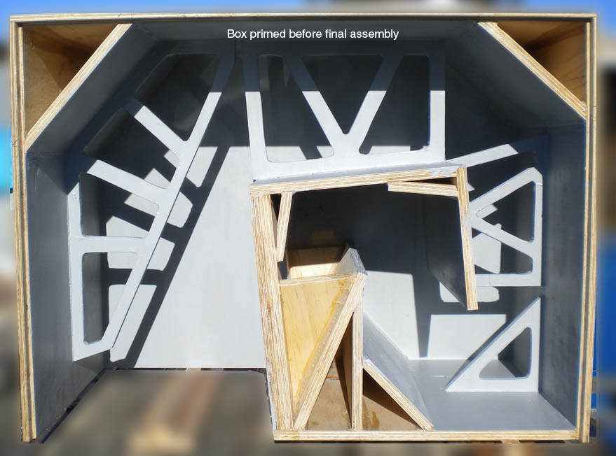

Here's a couple build pics and notes on things I did differently due too a discrepancy in the plans. (The 3 1/2" board up against the back face is what i'm referring too. seems it should be 4 1'4" for everything to work right.) The finished cabinet is now ready for Duratex. But i'll hold off till the next one is done. I've made it 1 1/2" deeper at the face to accomodate a grill cloth. Will a 3/4" wood frame for the grill cloth affect the responce, since it effectively makes the exit port smaller? 😕Or does it?
Just for fun, I hooked it up to one channel of my stereo (indoors) and played a cut from the soundtrack of the AVATAR movie. It sounded amazing, but as soon as the drums and low frequency instruments kicked in I jumped out of my chair reaching for the volume control, before the damage started. It was definitely a solid kick in the chest. 🙂 I know these are not supposed to be adequate for home use, but damn!!!....i don't think I could handle any more bass. I'm thinking JBells 24" cubes would fit the bill nicely. I'll knock one out soon and test it.

FlipC....yeah ,who knows what is causing it. Did Screamerusa ever post a response graph for his boxes. I looked for it yesterday but couldn't find one.
I'm going to build the next one exactly like his and change that 3 1/2" to 4 1/4" like it should be. (to be mathematically correct I mean). I won't bevel any corners either. then I'll do some testing with and without braces and see what numbers I come up with.
