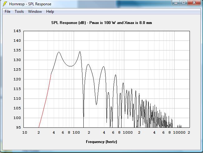

flip, what driver does the TH mini use?if i grouped 8 of them, it would give it more low end extension yes? every day i seem to like the idea of having 8 smaller horns, and just v-coupling(does that still work with tapped horns?) them together in this big awesome stack when i need maximum output.😱
so ive been playing with the goldwoods, they run out of xmas with a pure sine wave at 50 wattsbetween 50 and 60hz, but my past experiences with PA drivers is that theyre mechanical limit is around twice if not a little more their xmax, meaning that even if theres a little distortion introduced, it wont be bottoming out and killing woofers left right and centre. Danley also mentioned that hornresponse tends to be very conservative in their excursion plots, and that you can expect to put in twice the power and still be safe with musical program material(however i am not sure if this applies to me, as my musical material has lots of bass synth in it) so with this in mind 400 wrms delivered to a stack of 8 should do the trick. these would never be used in stacks less than 4 in two pi(for smaller rooms) or two in a corner for even smaller gigs(house party's and such).
heres a max SPL chart, to simulate 8 subs in two pi loading, the chart is done with .5pi, and the drivers are given double their actual excursion and power( i think this works out right). to me it looks not too shabby, but i dont work in prosound, so for all i know its not even close to what im looking for.
if i average the peaks it looks like about 130db from 45-120hz, so at 8 metres away, i should still be above 110db. according to my understanding, this should be sufficient to dance to. if i could stack 8 against a wall, or even v couple a huge stack in a corner, things might get even more interesting.

shame about the vplating, if it helps at all though(even 1 or two db) then i ll proabbly end up with a pair of plates, IMO $10 for a free db or two seems pretty worth it to me!
id tend to think the blowing of any woofers in this design wouldnt be a problem, considering that each driver is going to be seeing a maximum of about 50 watts, 1/4 of the RMS power rating, it should never get close to burning up, 50 watts shouldnt even be enough to drive the speakers to their mechanical limits if im reading my graphs correctly.
doing predictions the way flip c tells me to, i end up with a max output of a little higher than 130db(if i average out the "smile" curve that develops between the two peaks). to me, this seems like ALOT of volume, and that would be with 8 boxes in 2 pi, if i could find a wall or a corner things would start looking alot better too.
do you think this type of setup is going to give me the bass i want? comparing my plot for a single goldwood in 2pi, it still compares with a BFM titan 39(loaded with a 10...), and DJs have nothing but good things to say about those(although i have learned as a speakerbuilder first and a DJ second, that DJs often dont really know much when it comes to which gear is good and which isnt)

just when i was starting to give up on a pile of tapped horns, i found this CHEAP car audio driver on mcm, good power handling, alot of XMAX, cast frame, and less than $60 each. looks like itll take almost 200 watts in a TH without running into excursion problems, and beats the max output of any horn ive modelled and considred (excluding one 800 litre design for a hl10c that i couldn't get to fit through doors...) tapped or otherwise.
heres parameters, i run out of xmax before i hit pmax, but only just. id be using these in groups of 4, or two with a wall/a corner at house parties and small venues, and i wantt to build 8(at this price i can afford to!).
im more pleased with this design than any other ive modelled so far.
heres your input params, play around guys, if im not making a msitake, this thing is a steal for a mere 50$

a stack of four should have about 110db/1w at 1m from 40-200hz.
lets hear some opinions, car audio drivers for PA?:devilr:
