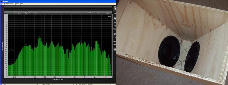

Here's a low tech approach that I was just testing... just to see what I could get.
I've found that impedance sweeps work really well to identify leaks that aren't there too. Definitely helped me figure out when my little TH was all sealed up (that and the fact that it just sounded a LOT better).
Cool looking concept. What's the intended use?
mike:

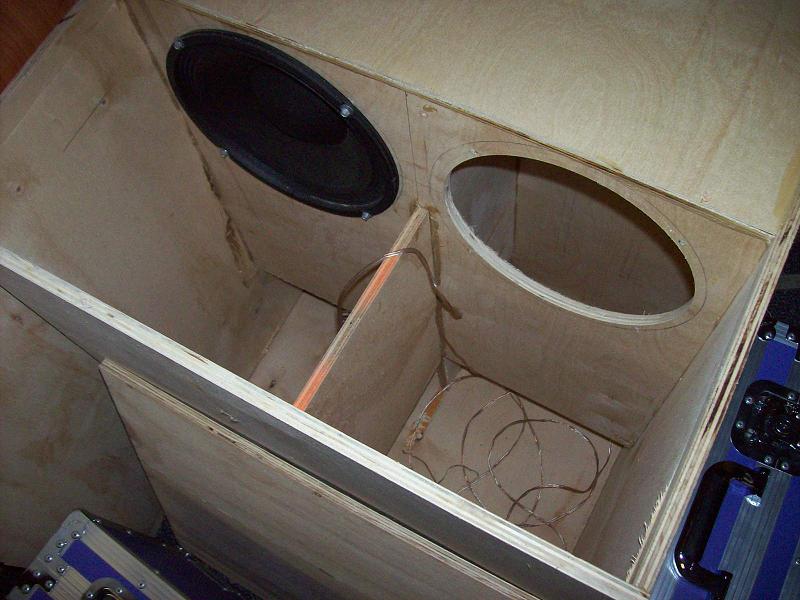

The thought on the cabinet I posted was, how can I make the simplest/cheapest cabinet possible that's usable for PA? I'm on a kick to try to put together PA/band in a box, that's simple/cheap, fits in an average sized car, and beats the average plasti-box system.
The smaart measurement was taken against (2) mcm55-1740's, (4) 1025 piezo's, (5) 12x24 and (2) 24x24 pieces of plywood, and a little fiberglass..
What was of interest to me, that required me to make sawdust, was my ports inside the horn. Ports inside dropped the overall response down lower than predicted. (because hornresp does not allow ports inside the horn) I had solid output to 60hz. So, I need to readjust the ports to raise tuning a little, and get rid of my small dip at 100hz. With 60hz output... wow, usable (not great, but usable) without subs!
Anyway, with the 1k dip and the little 100hz caveat's... not bad. I was expecting 1k to be really bad, due to the angle of the 55-1740's... but it really wasn't bad... It was really listenable, which surprised me. Once the top is acceptable, then I'll turn my attention to a sub... any good ideas for a <$100 PA sub (total) that'll do 120db 40-100hz in 2pi?
To your point -- measuring makes all the difference in the world. When you invest time and effort, that makes things 'sound' better... regardless if it really does or not...

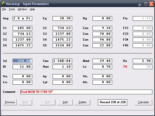

Something like this perhaps?
Two of your favorite $25 dollar MCM's in a pretty simple 250L TH.
Not a tough build, pretty flat response, but nothing at all below 40 Hz.
Don't run much more than 100 watts per driver to it either.
Achieves > 120 dB 40-100 in 2pi without exceeding 8 mm excursion above 40 Hz. Not a small box, but not that huge either. I know it would not fit in my car easily.
If you take most of the taper out, it gets as small as 170 liters. Still a bit big for two tens, but it actually flattens the response and excursion is similar, and it only loses a few dB.
I know it is not optimized - just a concept here....

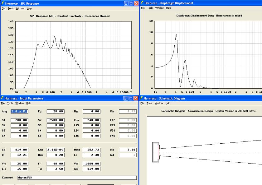

I've actually already tried some variations on that.. TH is what I thought I would want for this project... The 55-1740 looks great on paper.. but falls short on actually delivering... (back to that measuring thing??) Here's one of my attempts at a 55-1740 TH, stole one of the drivers for my latest top experiments.....
I know this sounds crazy, but a PE 295-470 In a FLH, 200-2500, 240 long with a 20liter rear chamber looks promising... Could do it up and back, 48" tall with driver in the bottom of the cabinet with the 45' reflector as the back of the chamber. that would be easy. (bass stick anyone??)
It has the advantage of not needing a HPF, and a simple 12db/oct cross would be sufficient, and it's 4ohm.

There are some drivers that work well in TH, and some that work well in FLH, BLH, BP, BR, TL, etc... not every driver works well in all designs, and picking a random "good quality" driver and choosing a style of cabinet for it without finding out if it's a good fit... is asking for trouble in my experience. I haven't modeled the dayton DVC in all those different designs, so I don't know for sure what cabinet style it's best suited for.
Yes for this project, I am primarily interested in designing a TH, due to my past success with TH. However, finding a suitable driver in this price range that will give the required output... has been challenging. (anyone have a good suggestion?)
On FLH, usually they have a peak that's higher in output than other designs, but once you eq them flat to 40hz... things change dramatically. Also, with FLH, I see that hornresp is again, usually spot on, when looking at FLH as well as TH, and other designs, and I have great faith in the math behind david's GENEROUS work for the community.
I typically take issue to undersized 1/4 wave FLH, and their ragged response, and especially their rising response as they approach 1/2 wave. Having a sub that's 13db down in response at 40hz vs 100hz is not my idea of a good sub. The $80 295-470 driver happens to look better in a FLH, than a TH.. The FLH also has the advantage of a small rear chamber, which does not require a HP filter that the TH does, when playing recorded music with studio stuff added in below 40hz...
So for my 120db goal from 40hz -100hz, at $100 or less, well the FLH dayton is close, but not quite, by the time you add plywood, finish, jacks and corners. However, for your needs, if you're willing to go a little over $100 for a sub, it might be worthwhile, so I'm attaching the hornresp sim.
im starting to wonder how important it is to stay within the xmax of the driver(to a certain extent). eminence gamma15a has 3mm of Xmax, but 11.4mm of excursion before it starts to become damaged.
people seem to say that horns sound very clean up until you blow the driver, so you should be cautious when powering them. this leads me to believe that maybe horn loading helps eliminate distortion caused by nonlinierities of the driver?
if you put the gamma in a 400 litre tapped horn you can get 120db with 100 watts in 2 pi from 40 to 120hz, if you highpass it at 40hz, the most it will ever see is 6 or 7mm excursion, how bad would distortion be at this level? it is still far from the stated mechanical and thermal limits of the driver, so presumeably it could achieve this all night, even though its not always staying within Xmax.
ive also noticed that hornresp predicts that excursion lessens as you decrease the radiating angle, would this same effect be observed in subs whose mouths are coupled?
try this out
s1=303
s4=2800
L12= 39
L23=252
L34=20.2
the driver will hit mechanical limits roughly at the drivers 300w rms rating.
