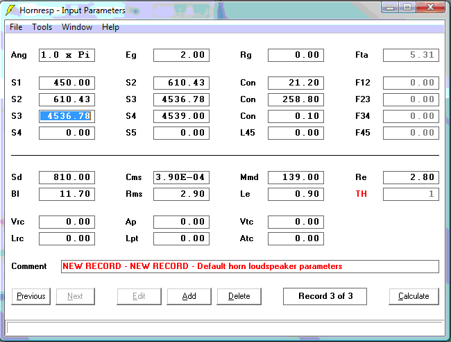

im really late into the TH game, and i think im doing something wrong, and if im not, i need to learn how to fold/build this thing! this was my attempt at implementing the driver from a home theatre style ported box i never use for home theatre, into something a little more house party friendly.
this is with an ascendant audio atlas 15 driver (no longer in production 🙁) on the low q setting, under 500 litre box(i think around 470 but for some strange reason the program isnt telling me anymore...help anyone?),
anyway, what am i doing wrong? cause this seems too good to be true( more than 105 db/w from 40-150hz in 1pi loading?!:hot:).
if im not doing anything wrong, how do i build it? :smash:

The inputted driver's specs are ludicrous for a 15" sub driver, especially when compared against these: http://www.soundsolutionsaudio.com/forum/index.php?showtopic=8323
It seems to be just some inputting errors though, so go back and input its Vas, Fs, Qes, Qms and let HR calc Cms, Mmd, BL, Rms to try again.
Also, the Lrc, Lpt, Atc inputs serve no purpose by themselves, so review the HELP file to see what you can do in the 'TH' mode with the bottom six fields.
Regardless, if you're pleased with your original sim, then it at least gives you a set of specs to try and find something 'close enough' to work as predicted. By extrapolation, it also gives you an idea what BW the Atlas works best in.
WRT folding, the object is to preserve the expansion through the bends. Otherwise, how you fold it up is your choice as there's no one 'right' way AFAIK.
GM
You're welcome!
Mmd was off too since you inputted Mms. 🙁
BTW, I forgot to mention that I don't see how you can physically build a TH that has a 0.1 cm distance from the center-line of the driver to the mouth since the driver's frame radius is around 7.5-8".........

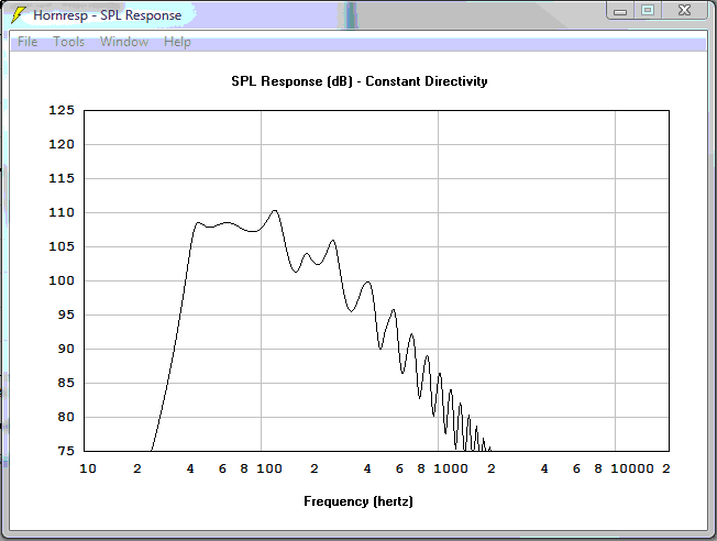

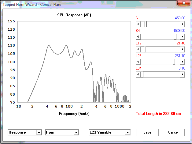

ok, i have another design with the type of response i would like to achieve. but i cant figure out for the life of me how i would design this on paper, how do i put a horn around a bend, and have it keep a smooth expansion rate? it seems every sub i design is a colume, i want more of a box, but folding the 1st half 2 times seems to complex.
this program told me how i can make a 285cm long tapered tube that will give me the performance i want.
the more i poke around in this program the more i feel this is all way over my head, help me out guys, what am i doing wrong?
check out that frequency response with 2v applied, i must be doing something that defys the laws of physics again, this just seems impossable.

That seems correct for the driver.
Not sure why this seems impossible.
That is a 600 Lt box with a 15" 13mm xmax driver. Thing would be to try to even out those 2 humps at least by half. Then if you corner loaded it should flatten out the rest of the way. Down into the upper 30 Hz region at 130 DB region. One hella house party sub. Though I go back to it being BIG. This isn't something you will throw into a car.
Van , perhaps depending on build.
Here's is a chart of a TH Mini clone I built
Mini Clone 2 The spike at the 200Hz isn't that profound in real life. I have 2 of those in my basement
and they sound great. That is 101 Lt each. Here is a 106 Lt version with inductance to get it flatter.Mini Clone
Th key to Live Sound is that of Max SPL
and you should measure at 2 Pi (which mine are BTW).

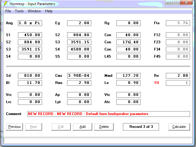

ahhhhhhh i read the hornresp help file a couple more times and now see that my thinking about this is very wrong, i seem to have a much better grasp of what the various parameters mean. and using a pen and some paper seem to have folded it to the best of my abilities (asked dad for some math help).
i will be building this unless anyone has anything else to add!

one extremely similar to that one, i dont know if its 100% right though, i doubt it is, started with a 545 litre box, chose my width, and made it 105x105cm, so about 550l, then proceeded to try and place panels inside so that the surface area/distance remained as constant as possable. pretty much just fancy trial and error.
i havent been able to find a site with a step by step of someone folding their horn, but im sure theres some tips and tricks im missing.
im starting to greater understand the parameters now! s1-s2 is distance from the throat to the centre line of the driver, and 23-24 is centreline-mouth(is this corret?), and then s2-s3 is the big distance i need to"fold" to fit my size and shape of box yes?

I simplify things by doing the throat and mouth to correct proportion and then just make sure the folds are expanding. I don't sweat that they are 100% exact. Also if you notice in jbell's diagram, corner wedges are missing. After lots of reading it just isn't needed. Though I would block brace those joints.
Also look up the Apache MK 1 and MK2.
Which JBells is close to.

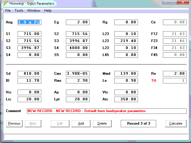

also, i see alot fo tapped horns have a plate infront of the driver, with a hole that is < SD, is that supposed to be the same measurement as s-1? or do i not need it? whats going on with that thing?

As far the "have a plate in front of the driver"
goes. In HornResp look at your schematic diagram. See the area at the throat?
See how the driver is partially covered?
That is what this is. Sometime also it will be a compression chamber
before actual horn. But that is up to your design. The schematic gives you the dimensions. Though I wish you didn't have to mouse over things to get them. The compression is part of the throat so must be correct as possible.
you lost me a little there 🙁 my schematic doesnt really look like that, the circles seem contained on either side. are you talking about how the "sides" of the horn create a chord going through the circle? and then the area of the opening infront of the driver would be equal to the area contained within the chords? this seems to be the only reasonable number i can generate out of that schematic 🙁
