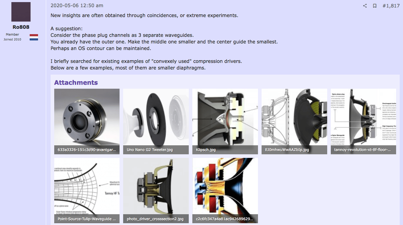

Hi Perry, did you ever try to leave the back cover from the compression driver off and attach a two inch CD horn?
It might spare the additional cheap PVR and would have the same quality back wave.
No, but I think it would be trickier than it sounds. I believe designing a phase plug for a convex diaphragm shape on the back side would not be trivial. I would love to see if someone has tried that.

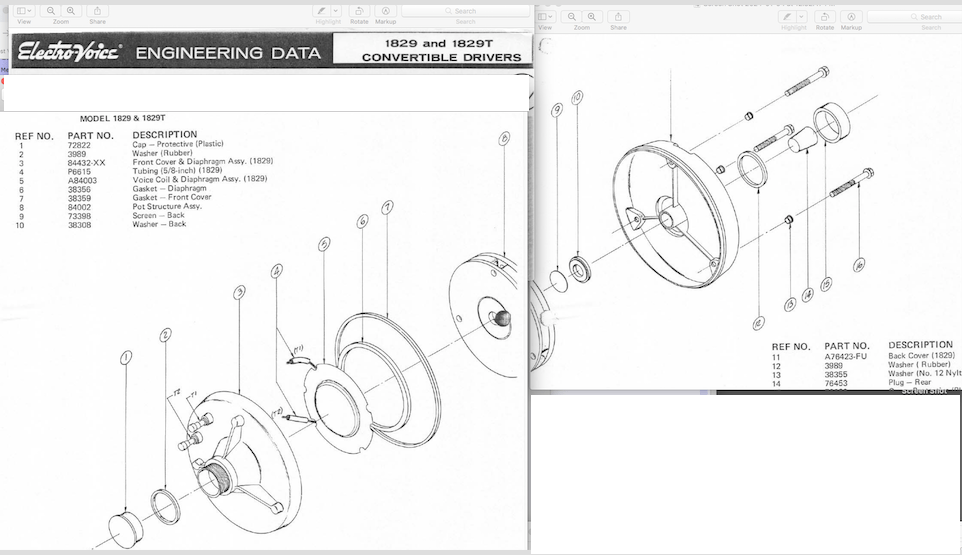

There have been many done over the years, the Electro-Voice T35, T350 (etc.) "Hoodwin Diffraction Horn" tweeters came first to mind, in production for over 40 years, Klipsch making similar designs after EV stopped.No, but I think it would be trickier than it sounds. I believe designing a phase plug for a convex diaphragm shape on the back side would not be trivial. I would love to see if someone has tried that.
Many designs have been done since:
https://www.diyaudio.com/community/...the-easy-way-ath4.338806/page-91#post-6193287

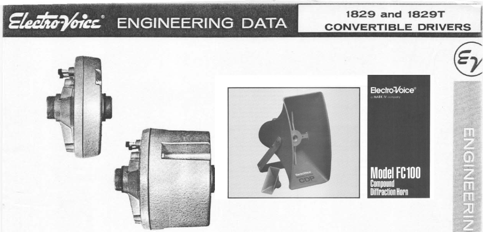

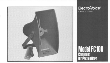

The EV 1829 driver actually was built to use both the front and back of the phenolic diaphragm:
I suspect the back side is an acoustic band-pass, little output above 3kHz, and the response of the front side drops about 20dB between 5 and 15kHz..
Virtually any thread on horn could be screwed on both sides, and with heroic levels of EQ could be made to sound passable on one of the sides 😉
I have heard these using the front side on EV 8HD horns in stage monitors (back side plugged), and both sides on the FC100 horns in gymnasiums and lunch rooms, they get loud!
