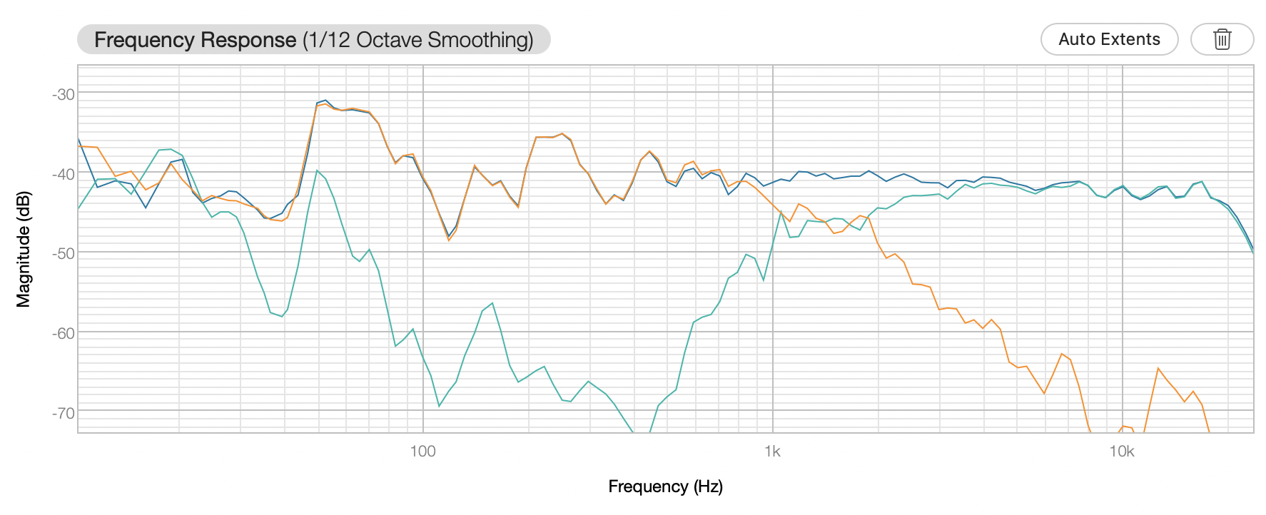

Good news! So I went to go do some sweeps separating for the Left High, Left Low, Right High, and Right Low. Everything was wired correctly. I even tried reversing the polarity of the midrange driver and also the front facing tweeter to see if that made anything better - it didn't. However, I noticed that on the high frequencies, the L and R channels were reversed! I checked my cabling and that was all correct. Turns out that I had reversed them in the MiniDSP software. I really hate how they have that set up, it's incredibly easy to do that. Anyway, that certainly explains why things sounded so "wrong" and why the imaging was so poor. It sounded so bizarre that I was having a hard time figuring out what was happening. This is not the explanation for the use of Perry's filters - that WAS extremely off - no question about it. The only thing I can think of is that the 14cxn88 must really be that different from the 15cxn88 that Perry's filters aren't even a starting point for me in this configuration.
I set everything up and ran Dirac again - much better this time. The sound was cleaned up and sounded significantly more cohesive (kind of to be expected when the 2 halves of the frequency range are reversed L&R). However it still sounded a little lackluster to me. So I played around with speaker positioning and toe in. I was limited as to exactly where I can place them because my NX-Treme's can't move, but I messed around with a wider speaker placement and a pretty significant amount of toe-in. That did it! They, for the first time, sound very good.

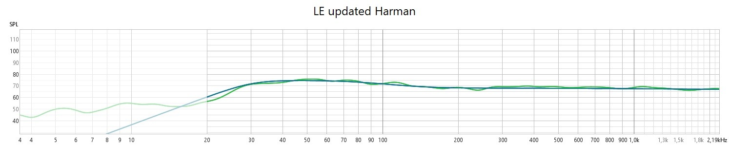

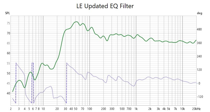

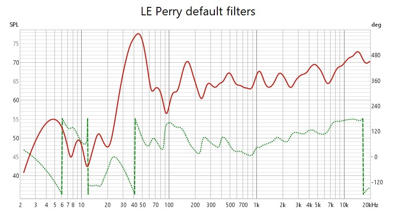

Some quick measurements in room with REW .
This is the orignal Filter response from the 2x4HD file you provided :
This is the response with updated EQ settings only. I did not go yet through the full circle with REW and Rephase. Only tried to update the EQ to fit the Harman curve.
Against the Harman curve
Apologies for the axis scaling, i am dealing with REW the first time. Before it was all passiv for me.

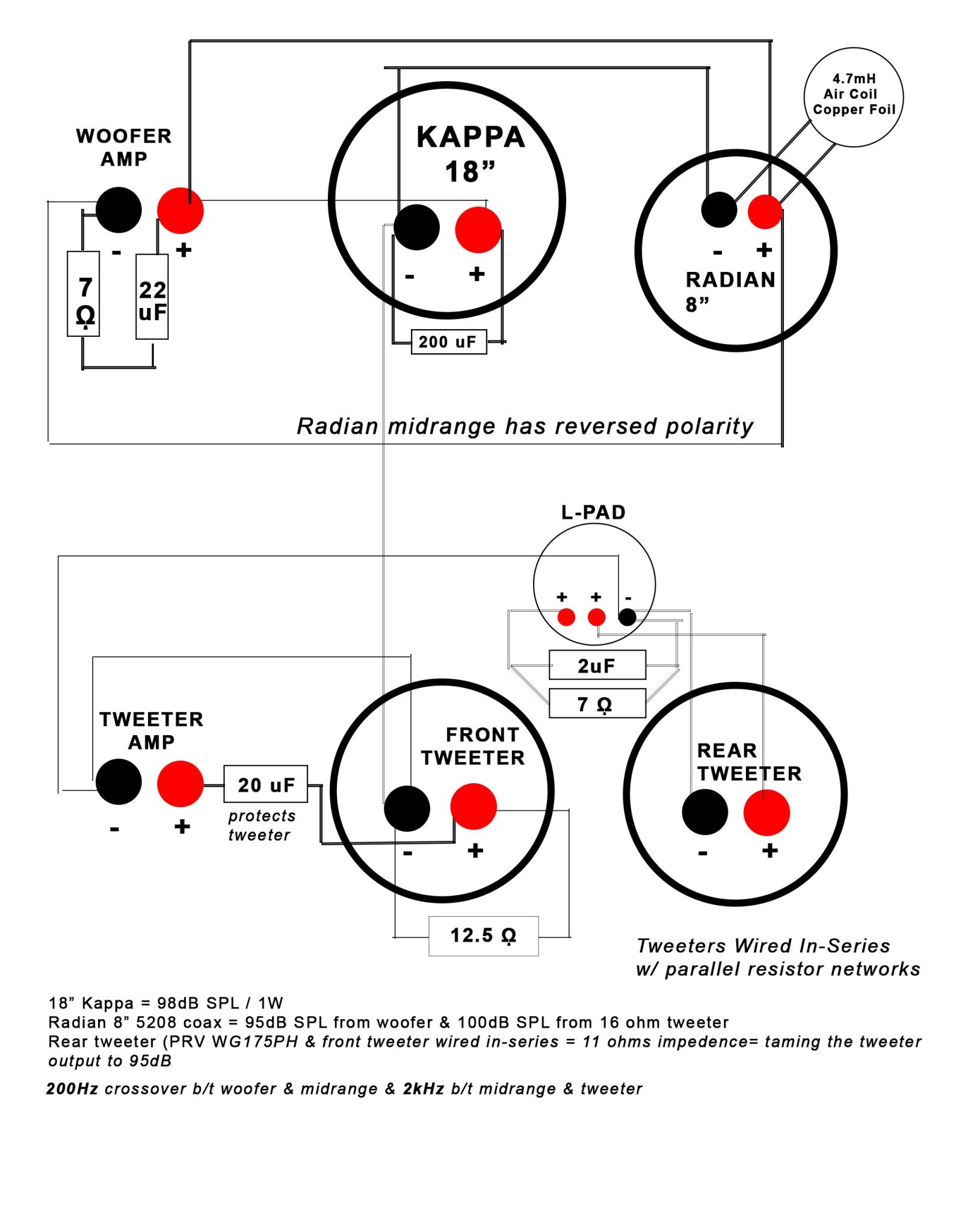

My schematic interpretation skills aren't that sharp, so I spent time visualizing the wiring of this design and have attached a visual of what I think is the correct wiring. I'm wondering if Perry or anyone familiar with the updated design can "proof" my interpretation??? I'm getting close to starting this project & do not want to cause any damage by screwing up the wiring in the tweeter section in particular - given the cost of these drivers. Thanks in advance for your expertise. I'm super excited to get this project started soon!

With all due respect, I think the diagram here is harder to read than the original schematic, it's more complex and it has some problems. See attachment.
As long as the 20uF capacitor is between the tweeter circuit and the amp, and as long as you're not sending high power signals, you're not in danger of damaging the tweeters.

Thank you!!! I was thinking I had some "problems." I look forward to sharing my progress. Mahalo from the Garden Isle.....
