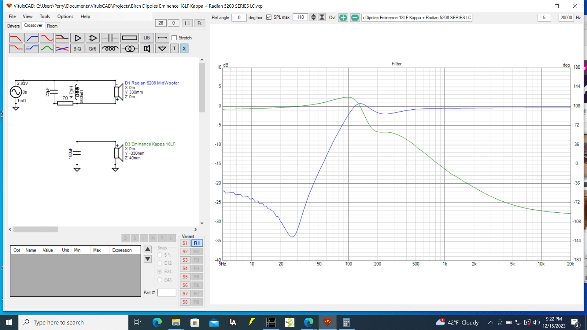

I ran a simulation just to see.That's interesting... I'd have guessed that Qts dropping from 0.61 to 0.38 would change things more... but I'm also not a speaker designer, so my guess is worthless. 😀
Speaking of which, I keep finding that I'm interested in different combinations of the drivers you used, but with zero skills, measurement tools, and knowledge beyond being able to build stuff, I'd better stick closer to the designs you've already proven out. I do like the Radian options for up top due to the lower cost of entry to get going on a budget with the Al membrane, with the Be as an optional upgrade path.

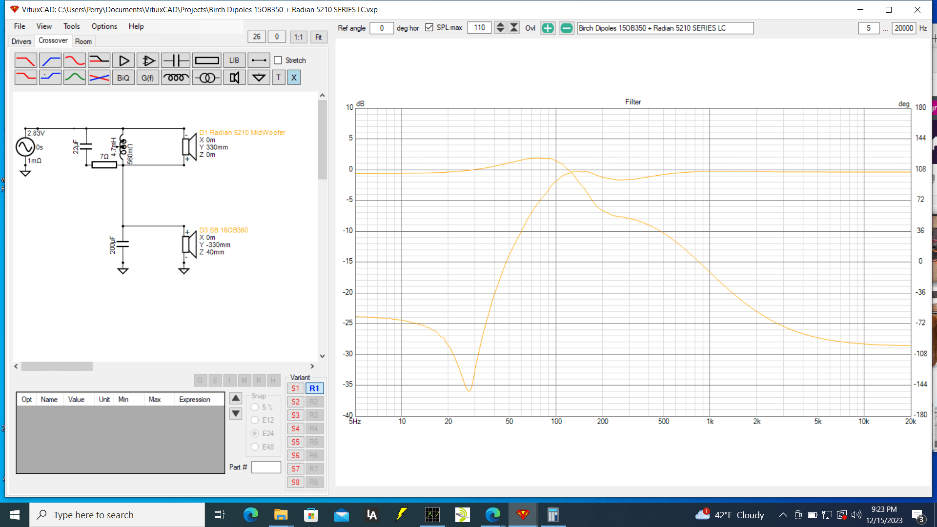

Below: Crossover signals at driver terminals, standard Live Edge Dipole, Eminence Kappa 18LF with 5208 8" Coax

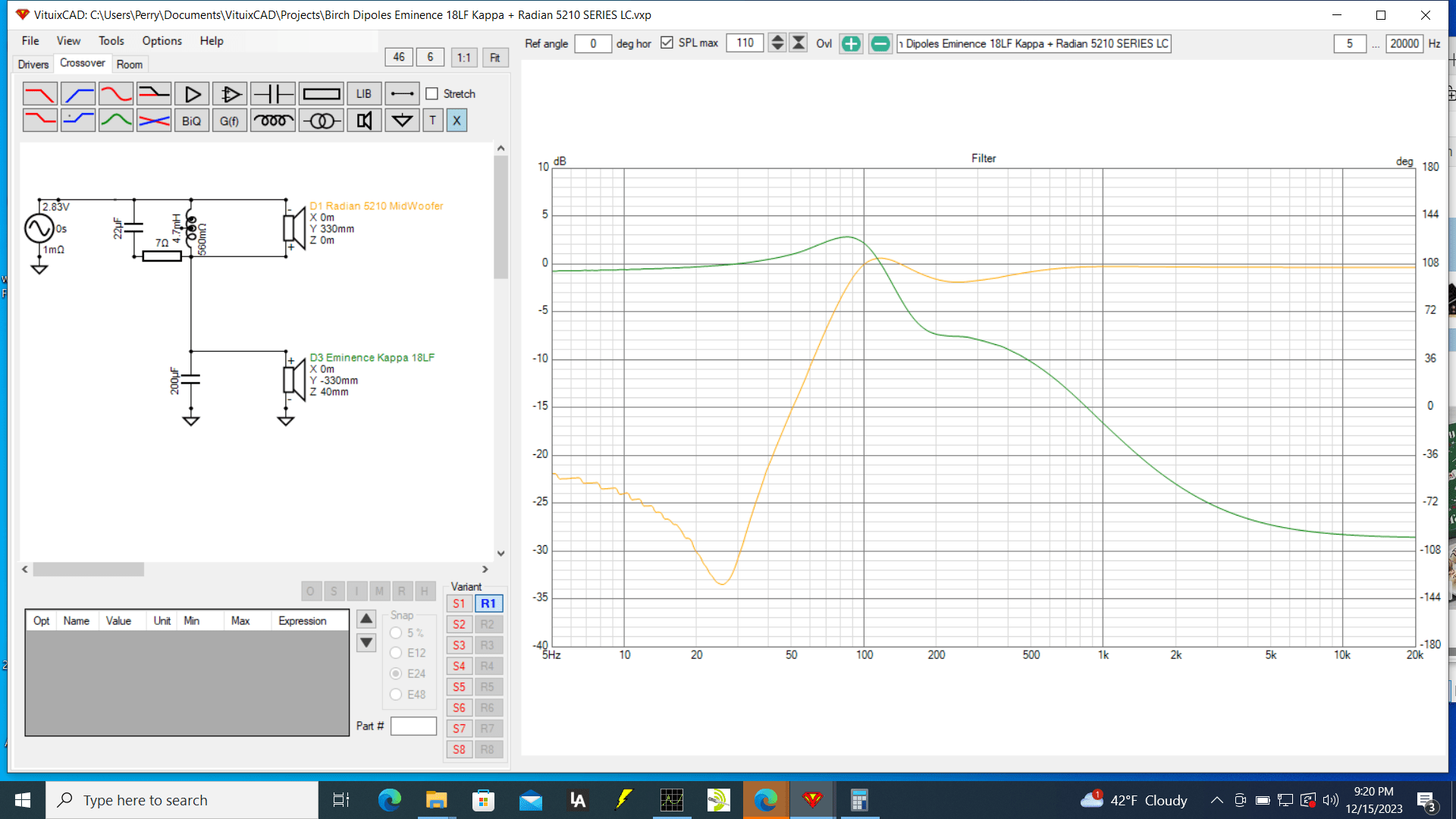

Below: Crossover signals at driver terminals, Eminence Kappa 18LF with Radian 5210 10" Coax
Below: Crossover signals at driver terminals, SB Acoustics 15OB350 15" Sub with Radian 5210 10" Coax
The three are nearly identical, despite the different Qs and impedances of the drivers. It shows how insensitive a series crossover is to driver impedance variations.
Thanks for running these simulations, Perry! Perhaps difficult for me to fully understand due to insufficient background for interpretation, but I can absolutely agree that these are remarkably similar-looking curves! At a guess, quite remarkable given the driver differences.
The combo of SB Acoustics 15OB350 15" Sub with Radian 5210 10" Coax that you suggested looks particularly mild-mannered.
The response of the drivers was not included in the simulations. So if the drivers do have different responses, then you don't want the simulations to be the same.. or you'll have to make up the difference in another way. This would involve the EQ we mentioned, ideally after measuring with the new drivers or at least simulating the difference between them.Perhaps difficult for me to fully understand due to insufficient background for interpretation,
