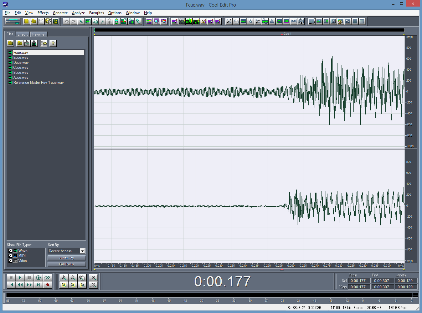

Here are the details of the timing error:
I examined each file using an audio editor and identified some characteristic waveforms that related to the start of the recording of the music. I marked each start with a cue mark, and then listed out the timing of the cue mark:
File reference: 0.259 seconds
File A: 0.103 seconds
File B: 0.103 seconds
File C: 0.103 seconds
File D: 0.355 seconds
File E: 0.258 seconds
File F: 0.256 seconds
Timing errors of as little as a few milliseconds (0.001-0.003 seconds) can be reliably heard by a well-trained listener (Me). Even if not cued to the existence of a timing difference of a few milliseconds, a skilled listener may pick it up, and it may be relevant or even crucial to the question being asked for the test.
Having found a fatal error, I didn't go further and check the timing of the ends of the files. They may also be in error.

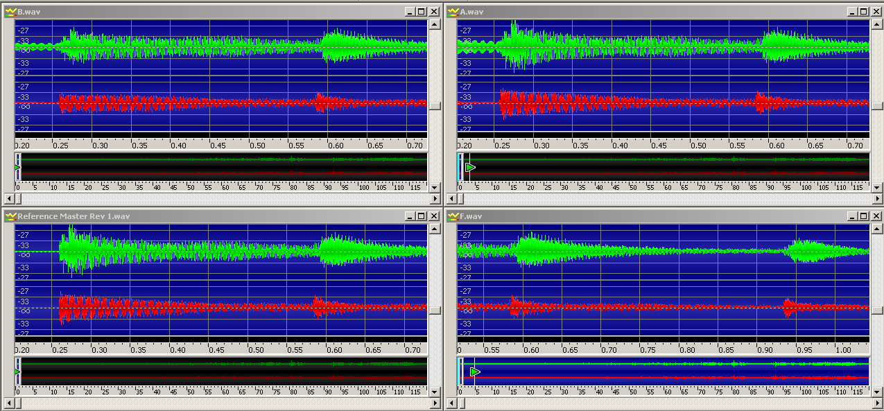

OK, I looked at the files in an editor. I don't find the same start times that you do, unless you were counting the noise floor. See below for what I found.
The waveforms do look different, tho. (notice the scale)

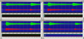

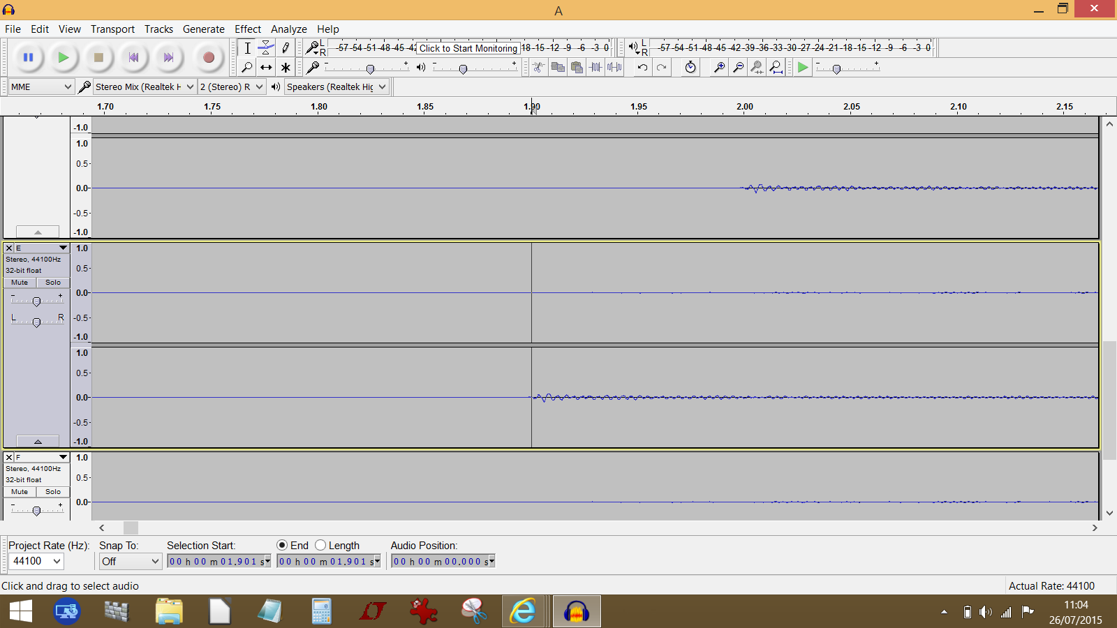

I'm just looking at them now and I can see what you are referring too. I lined all the files up visually by loading into Audacity and I can see the timing error you mention occurred and then carried over to the next files.
