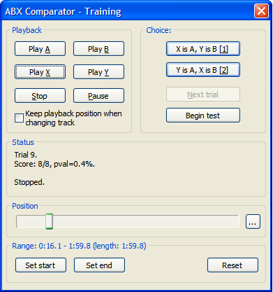

Played each of the files once through my mono laptop speaker, my first impression is that LM3900 is more musical and that the vocal sounds more like woman's voice.
Plugged in my headphone and indeed, LM3900 has stronger transient attack that gives it a more "foot-tapping" aspect. Just picked a certain musical note to ABX to show you that the difference in transient attack is obvious.
They are obviously different but I couldn't say which one is better at the moment. I need to hear/ABX the vocal (unfortunately I'm not familiar with Tracy's voice), then to listen through my speaker before I can say which one is better.
Add: I have a strange little feeling that LM3900 is not accurate tho. See later...

Ooops... BTW, is this LM3900 versus other opamp, or LM3900 versus DIRECT???
If LM3900 versus DIRECT, unless there is difference in sound level, it is strange how LM3900 has more transient attack. But if it is so, then I have learnt something new...
And it explains why I have a feeling that LM3900 is not accurate. This feeling is based on 2 things: (1) I could feel the instrument with the other file but not with LM3900 (2) The Tracy's vocal with the other file is the one I'm familiar with, which is like a male voice.

It is LM3900 vs a direct rip.
The LM3900 was configured for a gain of approx 4.5 and then followed by an attenuation network and then another stage of 4.5 gain. So all four opamps in the package are in use.
The differences here are very obvious and its easy to get 100% correct in identifying them. The performance of the LM3900 by todays standards is grim in the extreme (for audio) but it kind of puts in perspective how small the improvements in opamps have become. It is an interesting device to revisit though. In the early 70's it was quite something.
