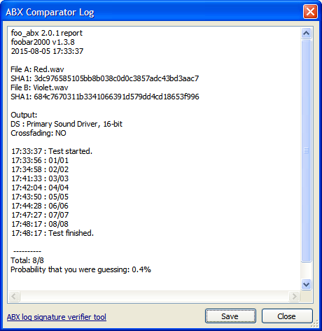

WTF !.Total: 8/8
Probability that you were guessing: 0.4%
Anything say 6/8 or better means that you are picking up fine differences......concentration span/boredom etc factors into the equation/results.
10/10 or 8/8 means an unequivocal result in my view.

I just came home from work in a very tired condition. When I listened the husky vocal in training mode I made no mistake. I did it several time (with no mistake, more than 10x for sure) until I was sure that I will not make mistake in the test mode. Then I hit the "Begin Test" button and that's the result.
You are correct about the 6/8.

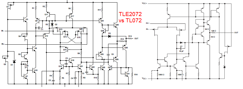

The reason I compared TL072 and TLE2072 was because I had a feeling that these 2 opamps had the biggest sound difference (in fact, I had no mistake in differentiating Mark Knopfler's husky voice either in ABX test mode or training mode). And because I have put TL072 on the top of my preference list and TLE2072 on the bottom of my preference list.
I'm a believer in amplifier topology and simplicity (see attachment).
The TL072 'ain't so bad after all, eh Jay !
Not bad at all. After looking at the PDF, I actually believe in the quality of this chip more.

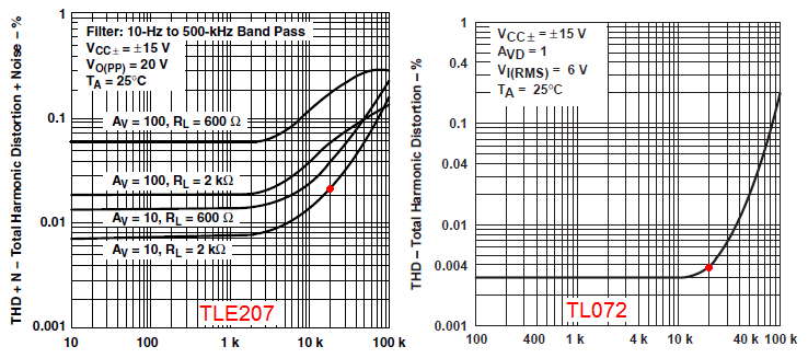

From my experience, and also from the listening tests (thanks Mooly), I found that the problem with sound has high correlation with an existence of undesirable distortion, and this undesirable distortion seems to correlate with high frequency, either intermodulation or very high order non-linear distortion.
CFB versus VFB for example, has trigerred a hot debate. But the fact is that everybody agree that CFB has better high frequency performance. It is just that less people realize how important the HF performance is.
NE5532 for example, if I'm not mistaken, has a not favorable THD above 6kHz. I think this could be the reason I found it fatiguing, while the general performance is outstanding. But then I will be happy to use NE5532 for bass duty, or before the AD conversion stage.
Here's TL072 superior THD at HF (see attachment). I believe NE5532 is not as good as this??
ADD:
The THD for TL072 is minus the noise (which is not so good), but the point is the non-linear distortion is flat up to 10kHz and more. Noise is not so disturbing imo, and to implement this chip I think the circuit should have a very good/low power supply noise.
