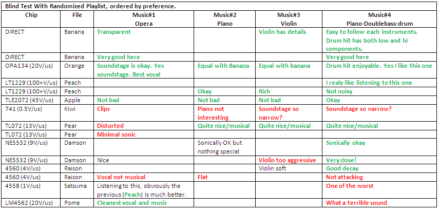

I re-examine my assesment of the opamps in Mooly's previous test (attached is the result). It was a blind test using randomized playlist of iPod. I haven't used or referred to a FoobarABX back then, and it was my first experience with music clip blind test. Regarding TL072, I found it musical in 3 musics and distorted in 1 music (opera/classic, where there was a high note shout IIRC).
the TL072 failed miserably subjectively prior knowledge or not, as did the others with the exception of the 5532 and 833.
Much better would be to run your multiple series stages with more realistic loadings. Even better would be to run the chain of opamps with gains (and attenuations) to better duplicate real world usage.
I found 833 was very good objectively, and no complaint subjectively. But I subjectively prefer the TL072 for it's musicality and because it's objective weakness didn't cause fatigue at all. I believe that TL072 is more suitable in BUFFER position (in earlier test it was in 2 gain stages). But may be this 5-buffers-with-390R-load is too difficult for it, I don't know. But I expect TL072 will perform better in normal buffer.
The music you chose is relatively sparse, relatively low average level and relatively clean.
Earlier test has 4 different music types. And it has the attenuate-amplify-attenuate-amplify stages. But like I said before, I would prefer TL072 in buffer position. Long ago, in my active crossover (I still have it), I decided to put TL072 in buffer positions, and other BJT opamps in gain/filter stages.
