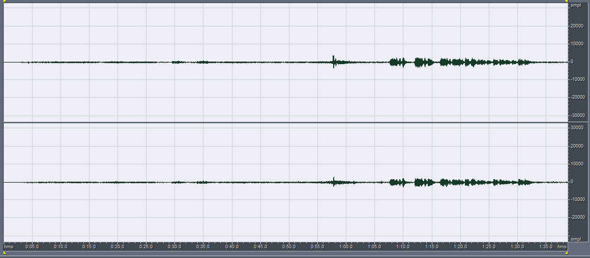

I am attaching a spectrum of the difference file, as a hint where to seek for biggest sound differences, however masking may play a role at high amplitudes.

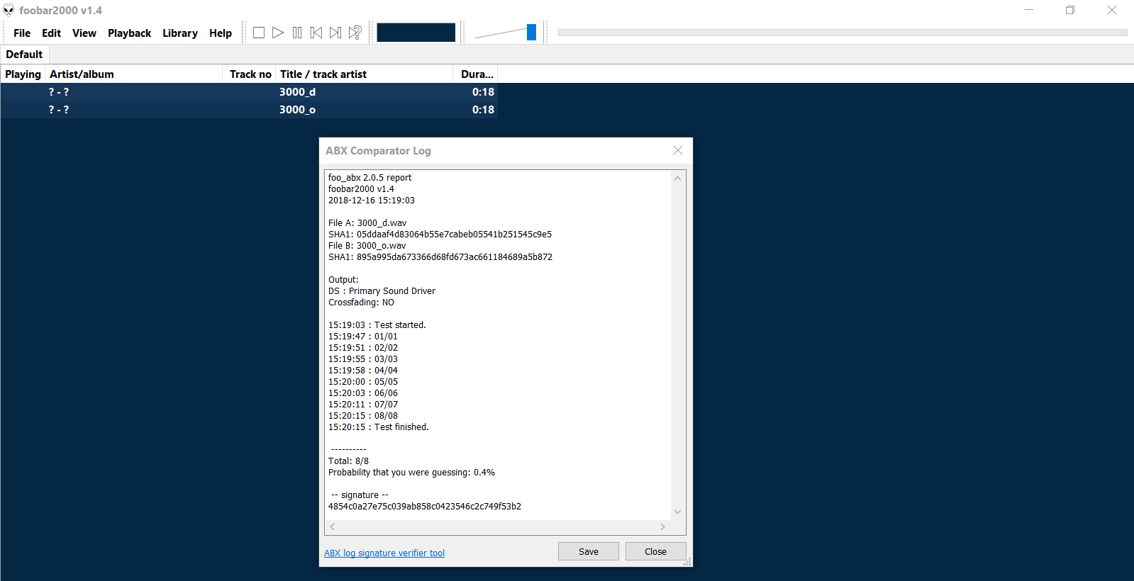

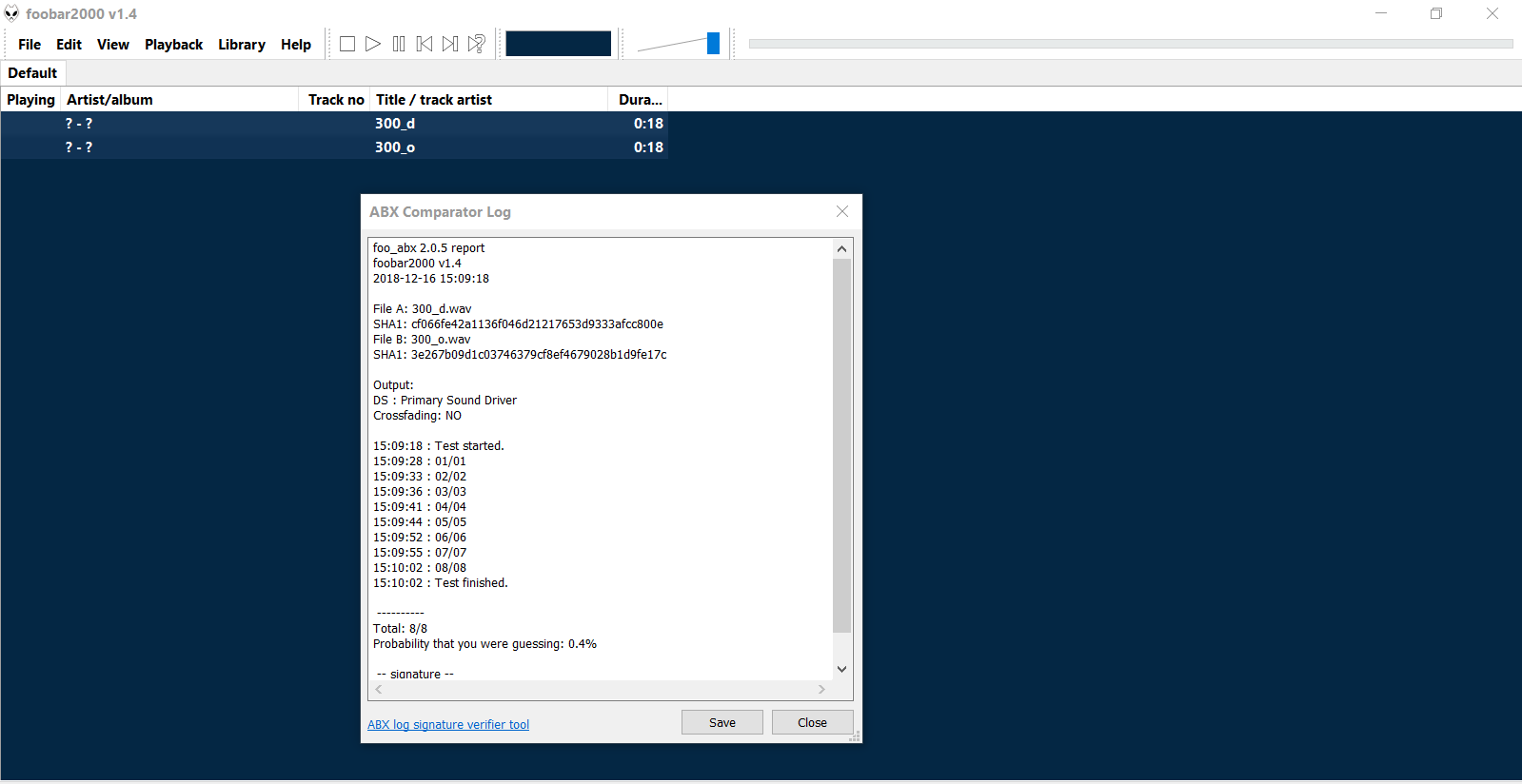

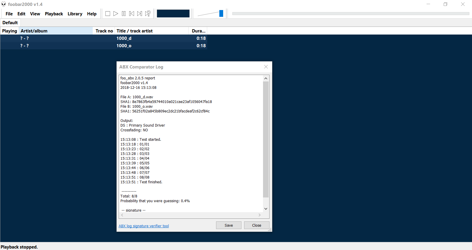

Did anybody try the new set of sine tones (300Hz, 1kHz, 3kHz)? I find it easy to hear distortion on 1kHz tone, but not on 300Hz and 3kHz tones. Again, in agreement with ear masking curves.
I've just tried the sine test. The 300 and 1k were quite easy using laptop speakers and low volume. The 3k one eluded me (a 3/8 and a 5/8) but switching to little earbud headphones and the difference was extremely apparent.

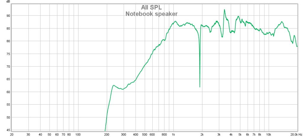

Hi Karl, thank you, yes I also hear difference between pure and distorted 300Hz tone on notebook speakers easily, but that is for the reason that the notebook speakers have troubles to play 300Hz 😀. With big full range headphones, it is not easy.

3kHz easiest for me, perhaps it's the tiny iem.
Code:
foo_abx 2.0.5 report
foobar2000 v1.3.12
2018-12-16 23:26:52
File A: 300_d.wav
SHA1: cf066fe42a1136f046d21217653d9333afcc800e
File B: 300_o.wav
SHA1: 3e267b09d1c03746379cf8ef4679028b1d9fe17c
Output:
WASAPI (push) : Speakers (Conexant SmartAudio HD), 16-bit
Crossfading: NO
23:26:52 : Test started.
23:28:11 : 01/01
23:28:36 : 02/02
23:28:47 : 03/03
23:28:57 : 04/04
23:29:05 : 05/05
23:29:13 : 06/06
23:29:27 : 07/07
23:29:43 : 08/08
23:29:43 : Test finished.
Total: 8/8
Probability that you were guessing: 0.4%
foobar2000 v1.3.12
2018-12-16 23:32:00
File A: 1000_d.wav
SHA1: 8e7863fb4a59744010a021cae23af1056047fa18
File B: 1000_o.wav
SHA1: 56251f02a845b809ec2dc21bfacdeaf2c62cf84c
Output:
Crossfading: NO
23:32:00 : Test started.
23:32:15 : 01/01
23:32:35 : 02/02
23:32:44 : 03/03
23:32:56 : 04/04
23:33:06 : 05/05
23:33:20 : 06/06
23:33:28 : 07/07
23:33:44 : 08/08
23:33:44 : Test finished.
Total: 8/8
