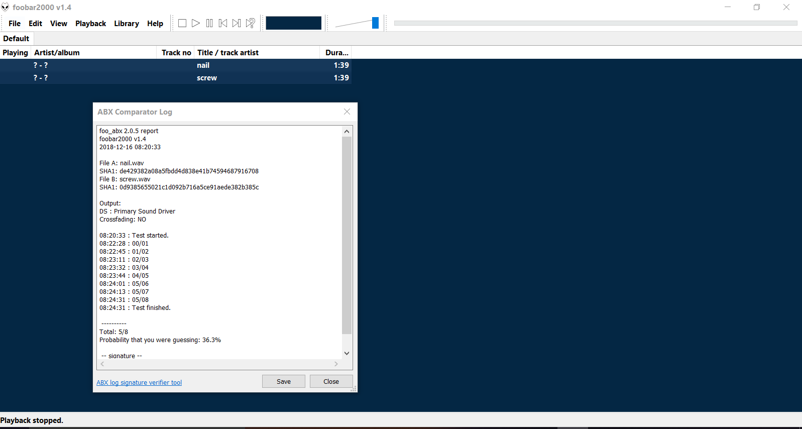

I did three runs. Lol, you tell me 😀 I feel one has a softer feel and attack to it, a bit less glassy but as always I can't get Foobar to agree 🙂
(I've got the full version playing now 😉)
Thanks for trying the files and posting the screenshots, Karl. I will try as well, but I am not very optimistic what I would get.

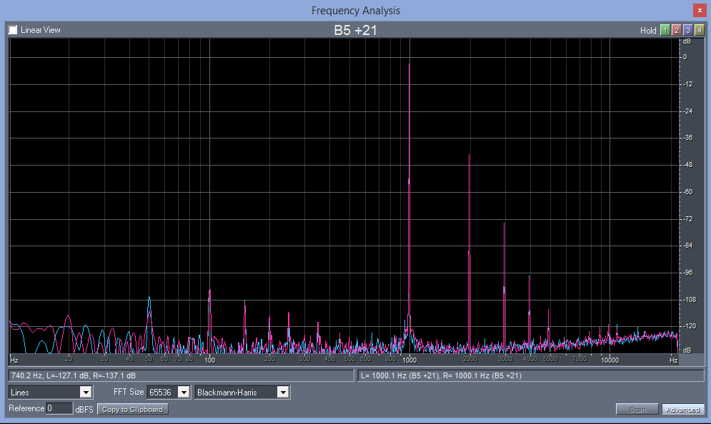

This time, distortion at peak amplitudes is up to 1%. However, 2dB decay at 20kHz was eliminated and frequency response is flat now. So we have almost "pure" harmonic distortion with profile already shown in previous tests.

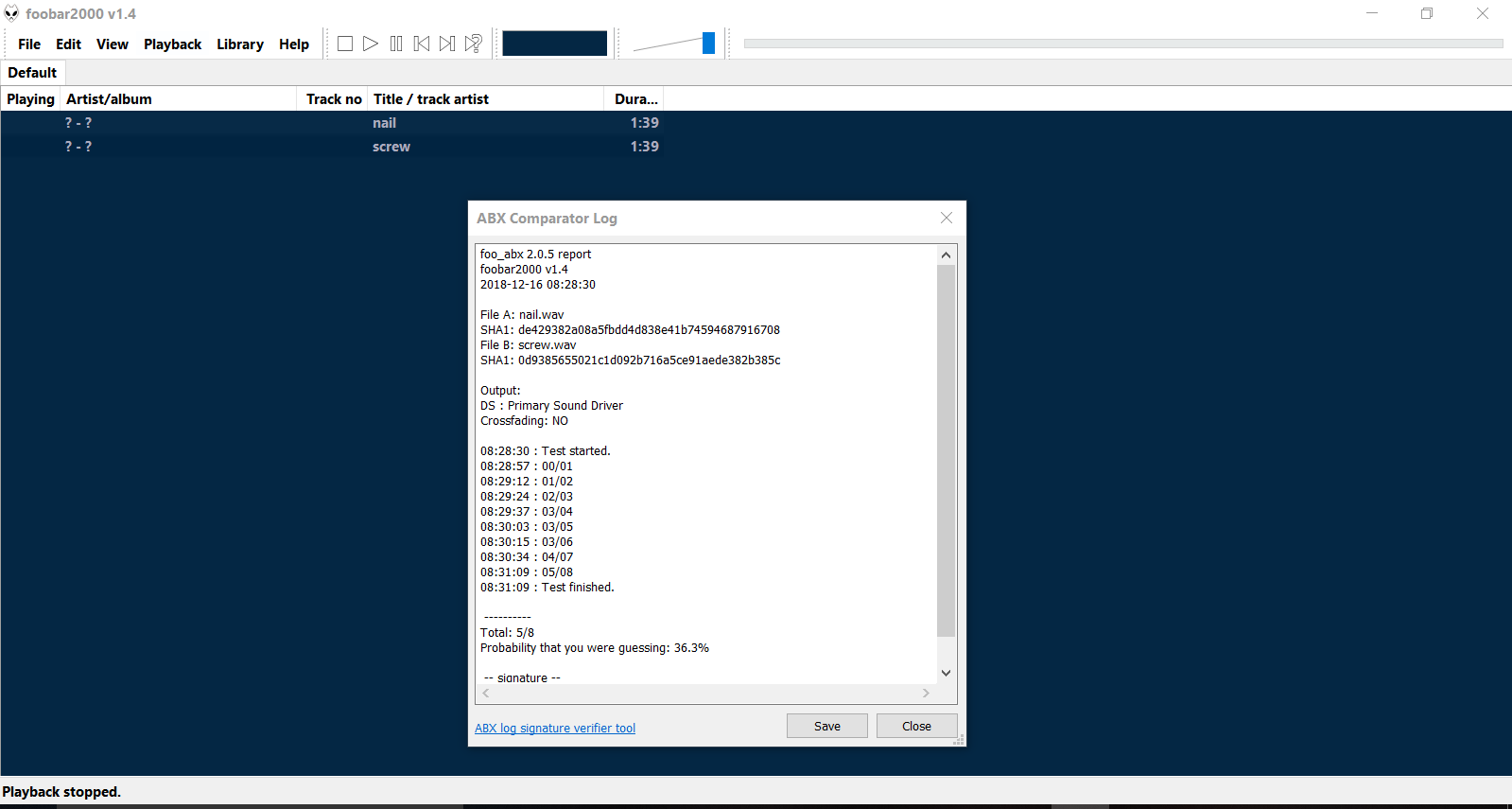

Another three.

I have prepared a set of new test sine tones.
http://pmacura.cz/testsinetones.zip
There are tones with frequency of 300Hz, 1000Hz, 3000Hz. Originals and distorted of 0.9% THD, decreasing harmonic profile. Tones have 18s duration and -3dBFS amplitude. The distorted tones were recorded through the tube amplifier under test, so they reflect peak distortion under real conditions.
