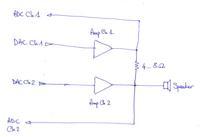

Since you guys seem to be interested by what happens in the output stage of the amplifier, here is a test suggestion.
Amp1 drives a current (through resistor) into Amp2's output.
Amp2 tries to keep its output voltage at 0V.
Measuring the voltage at Amp2's output therefore gives its output impedance.
A speaker can be connected to hear the signal. However, with no speaker connected, current will flow straight between the positive and negative supplies, without going through ground... potentially less problems with ground currents then.

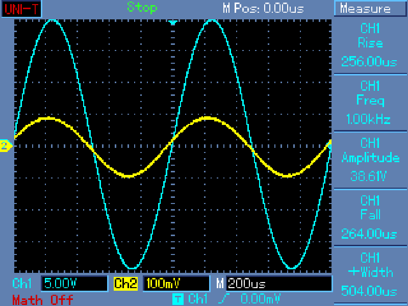

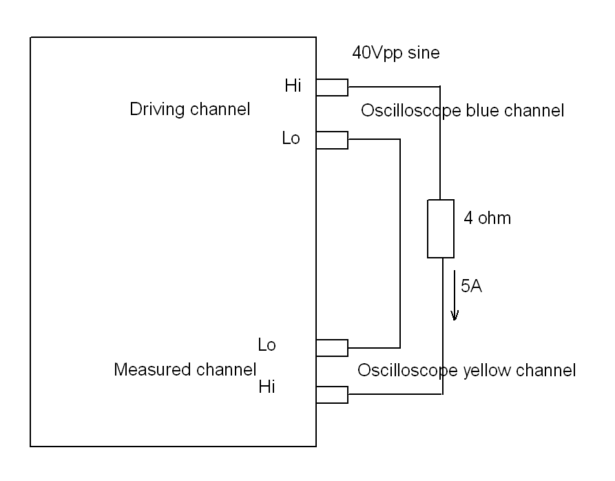

Hi pefeu, I do exactly the same thing, as a rule of thumb. From left channel I drive the right channel (or vice versa). As the power amplifier is dual mono with separate transformers, it can be done very easily.
Measurements at 1kHz and 10kHz are attached. The drive current is 5A.
But this arrangement measures as well a voltage drop on resistance and inductance (--> phase shift between waveforms) of the wires from PCB to speaker binding posts that are placed on the rear panel of the amplifier. Then, you can also imagine that wires from binding posts to speaker must be taken into account as well.
It is also interesting to make a FFT of the residual (yellow trace). You would not like to see nastiness of class B switching here, crossover distortion. I consider this test as one of the most valuables, for a real amplifier design. This test also shows how linear is your output impedance.

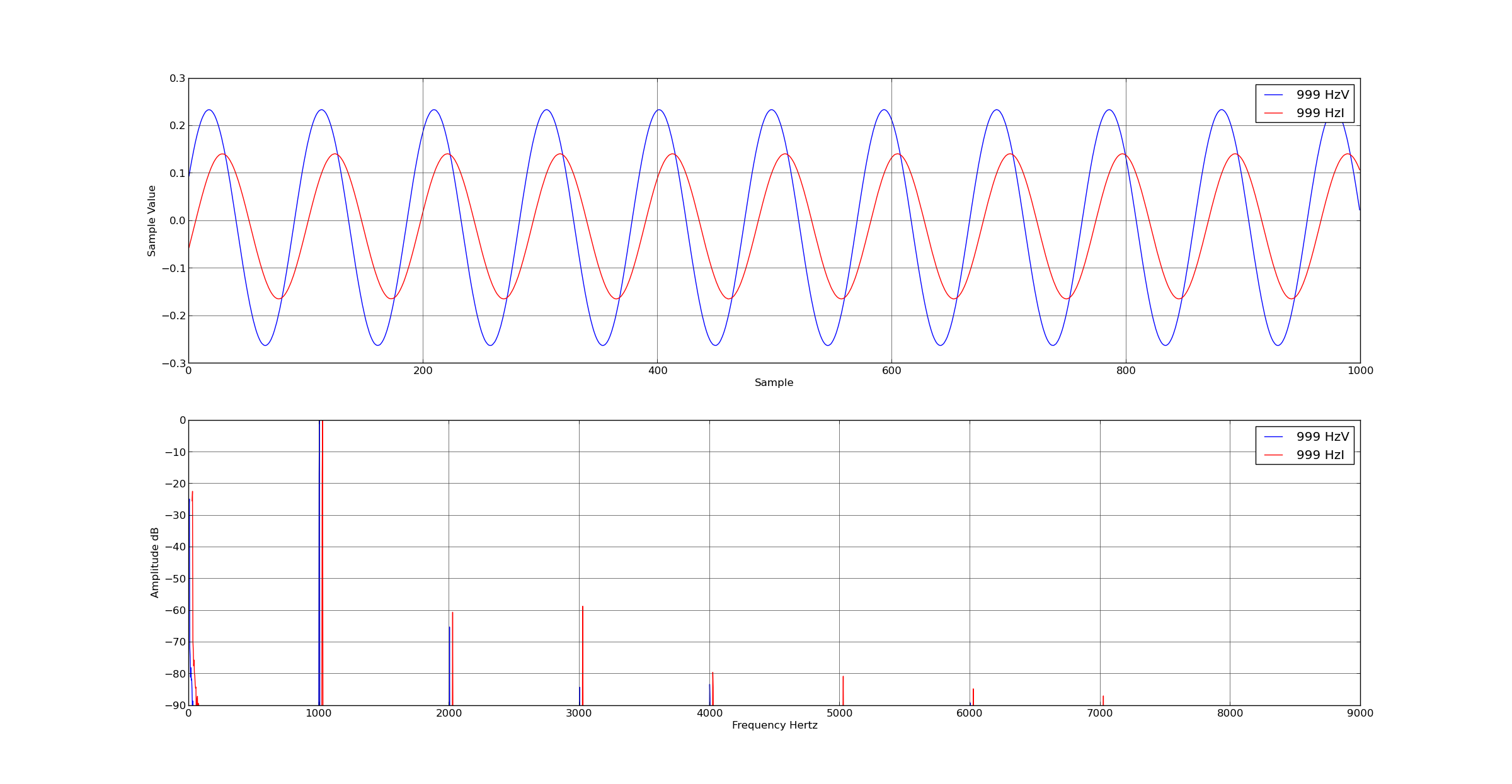

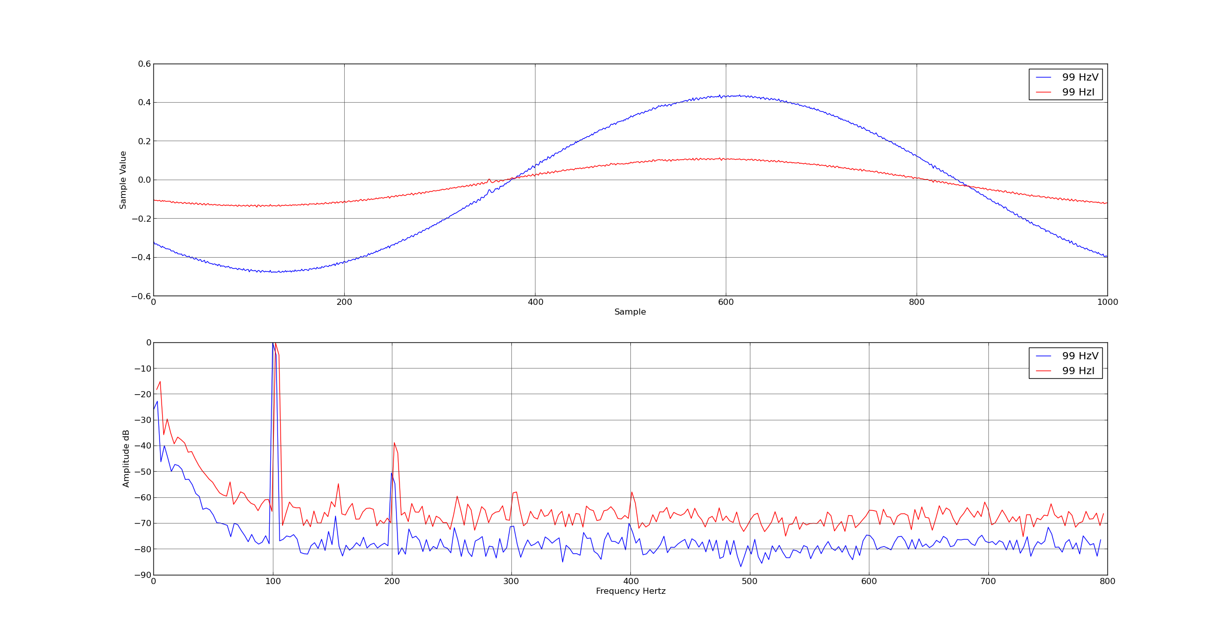

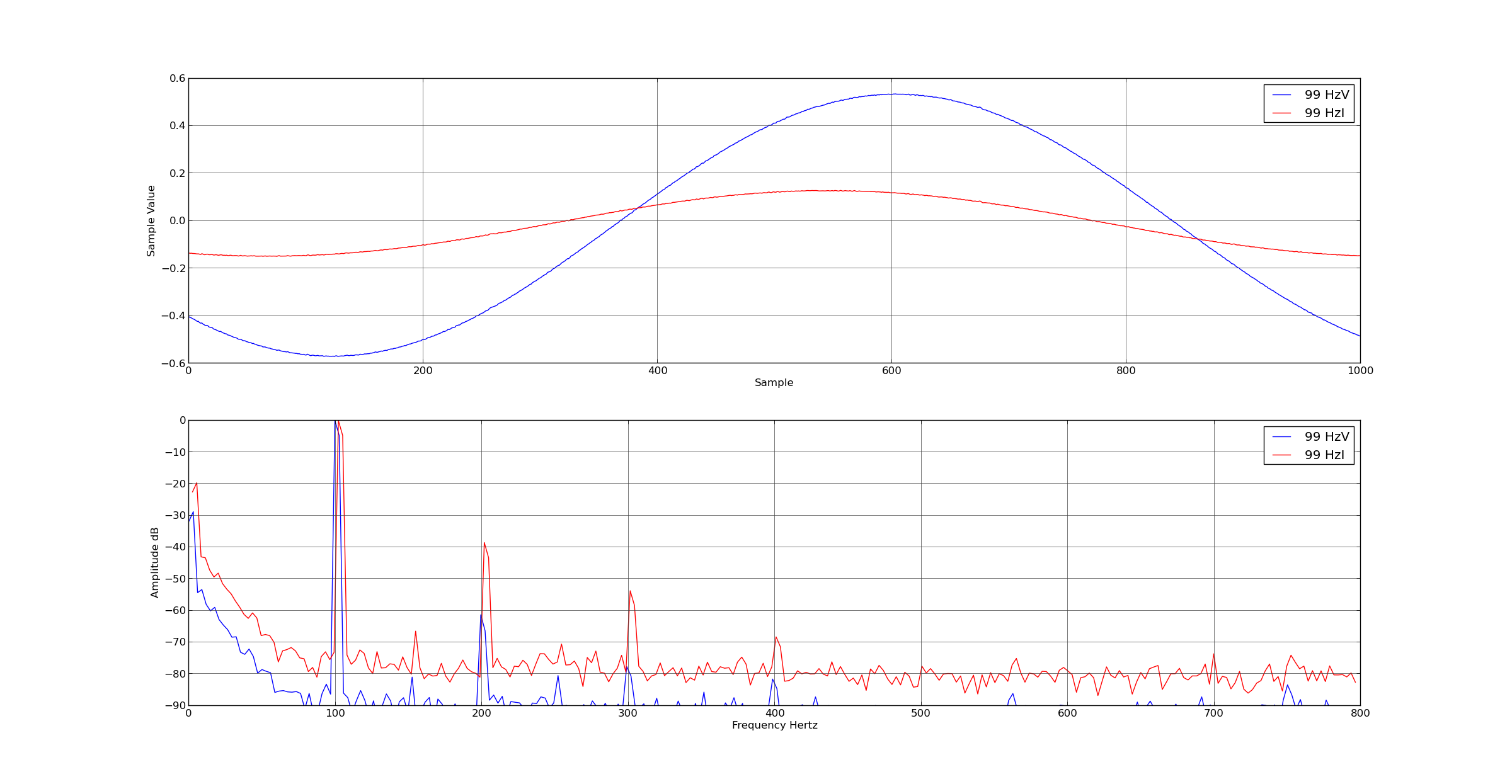

I made a measurement of loudspeaker current and voltage (using my soundcard, 0.5 ohm resistor for current, and divider for voltage) at various frequencies and amplitudes.
Top graph are waveforms of current and voltage. Y-axis is float sample value (-1 .. 1). Don't look at the relative amplitudes of Current and voltage since I used the resistors that came first from my parts bin to make the attenuator...
Bottom graph is FFT. Both current and voltage are normalized so that the actual signal peaks are at 0dB, so the distortion relative to signal can be read directly on the dB axis. The current FFT is shifted a few pixels to the right for readability.
I think the measurements were done at 0.1, 0.4 and 2.8V, according to my multimeter, which I used on the 100 Hz test. It should be reasonably accurate.
I did not go further on the volts since it was already extremely loud even with the ear protection I use for the hammer drill... These loudspeakers are my desk ones, not the ones from the living room, they are pretty good and efficient. I've used the scope to measure the peak voltage on normal (ie, loud) music listening, with compressed music 0.1W is loud, with uncompressed drums a few watts peak give a nice feeling.
On the 2.83V test at 100Hz the desk was vibrating a lot...
Anyway. So, the loudspeaker current has a large amount of distortion... especially at "high" power (1W, lol).
It is reasonable to assume that this distorted current, combined with the impedance of cables and amplifier output, will create a distorted voltage at the loudspeakers terminals, and the tweeter will happily reproduce the harmonics of the woofer current.
So, that could explain why some like bi-wiring, although the theoretical effects should be non-existent...
I also like the last test (intermodulation between two very close frequencies)...
